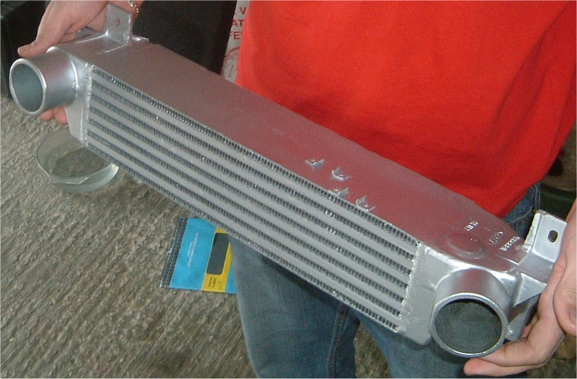

A not so cheap option
https://www.rtoc.org/articles/i/autof...14_150x112.jpg

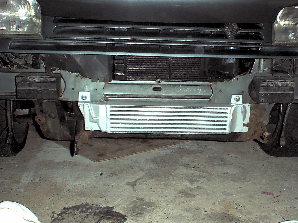

Cossie 2wd adapted for 5GTT by Brizza

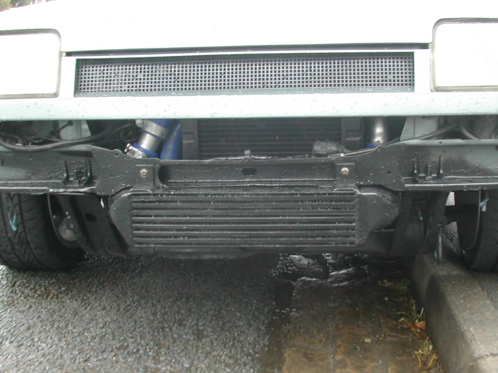

2wd Cossie cooler fitted to McQueens 5GTT

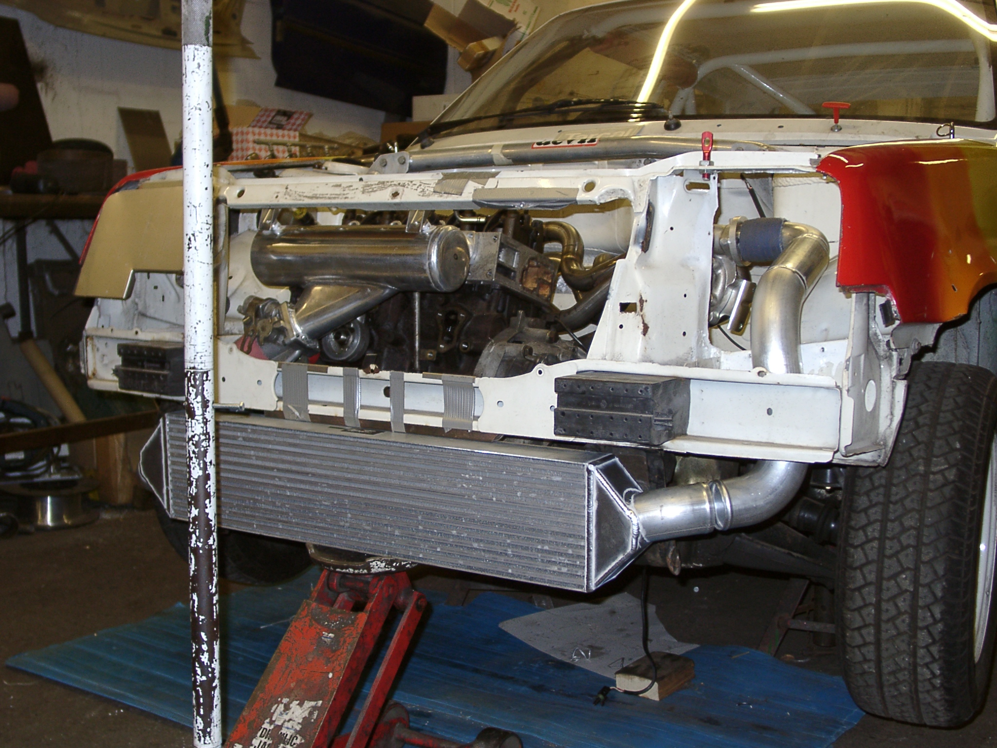

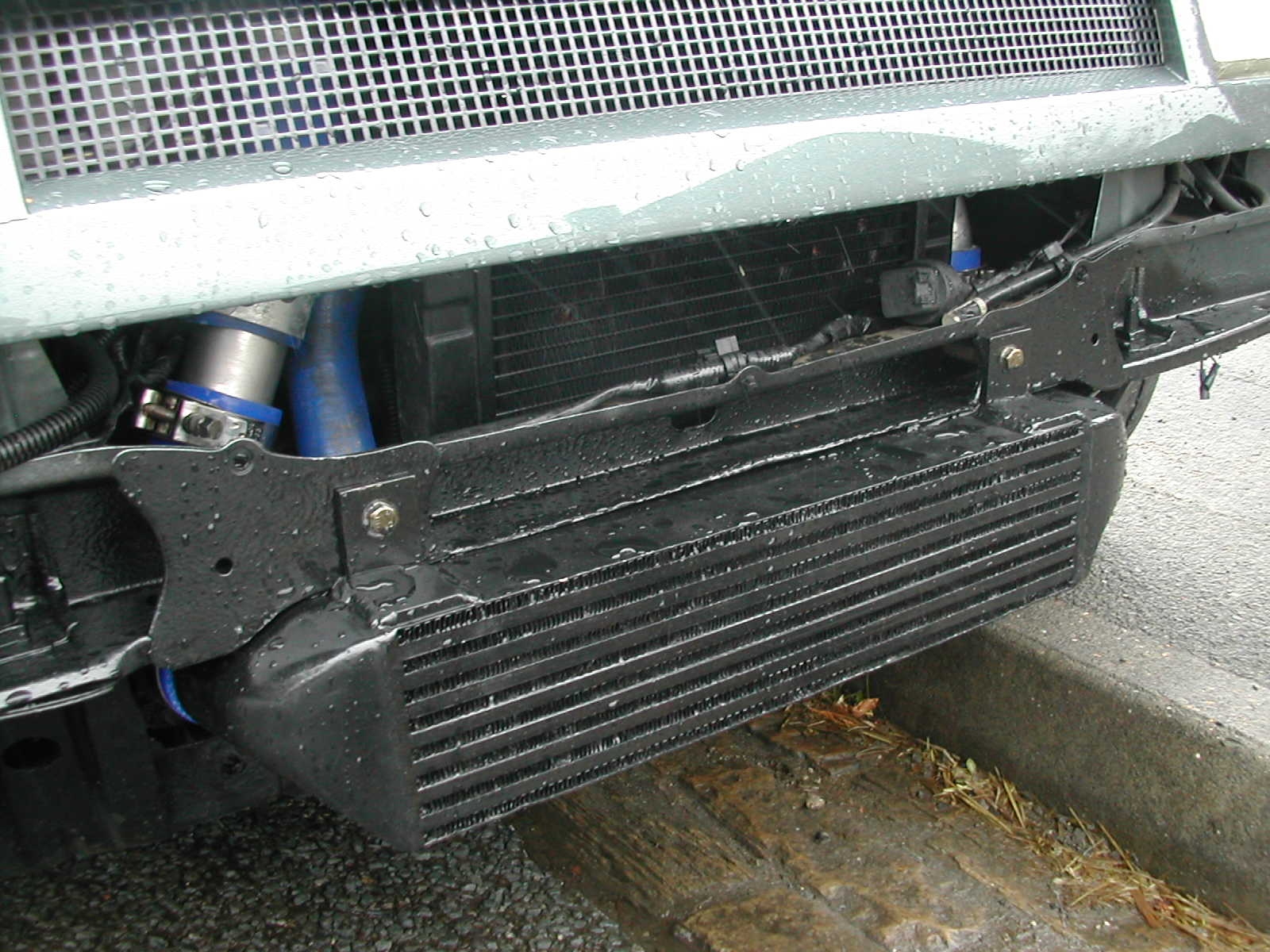

4wd Cossie cooler fitment by MC

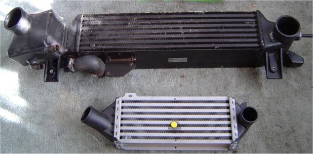

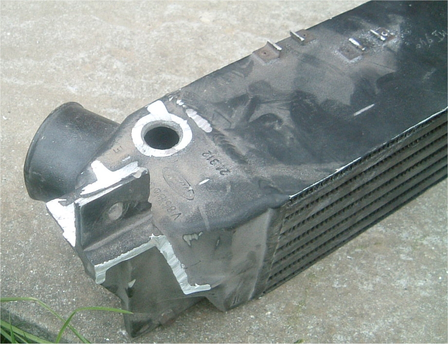

2wd Cossie cooler
https://www.rtoc.org/articles/i/autof...f14_150x73.jpg
Two coolers, top one is early Escort Cossie

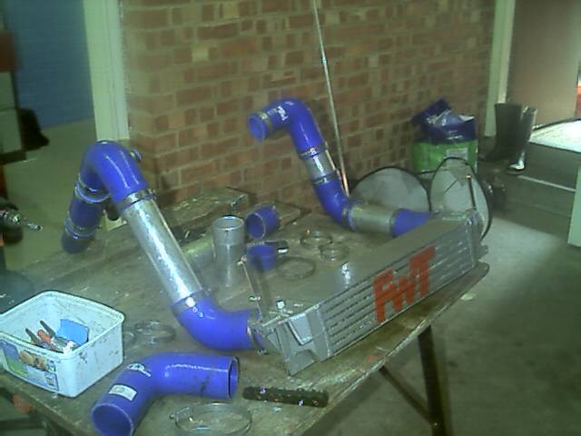

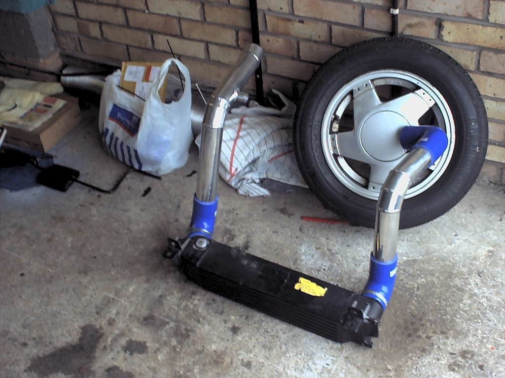

Cossie with pipes
