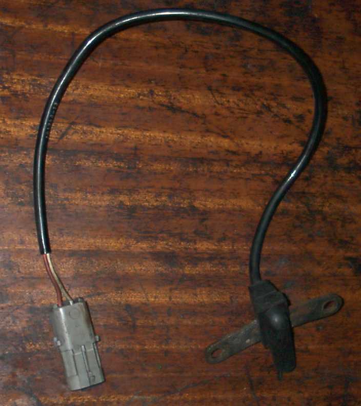

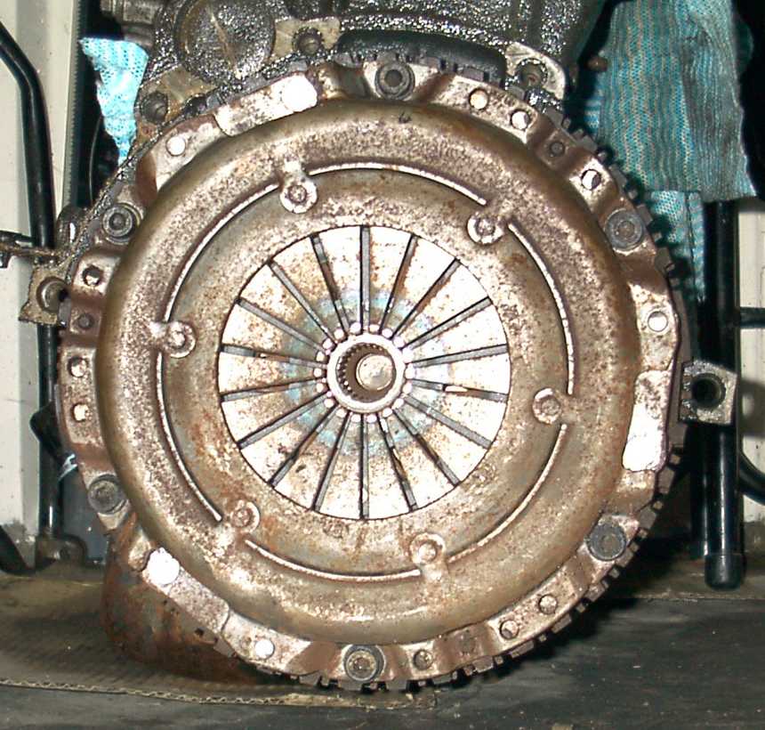

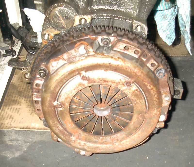

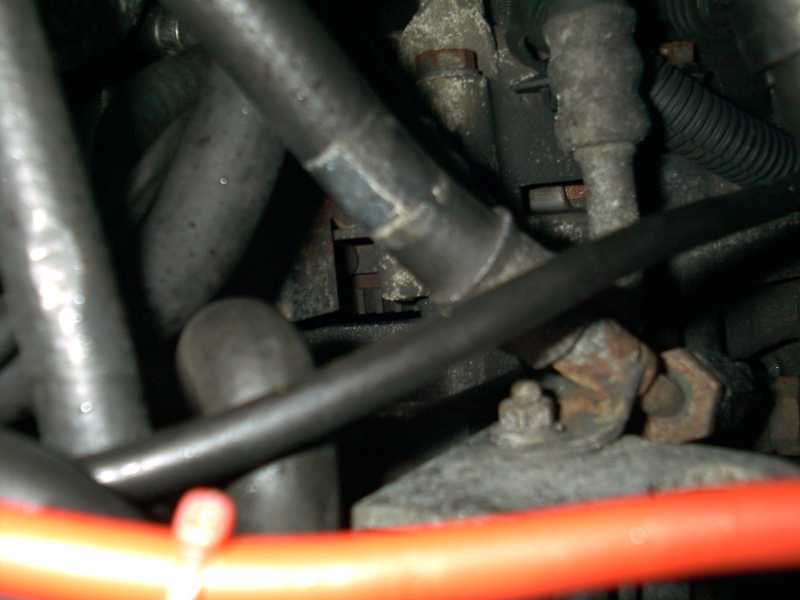

It determines the engine speed by means of an inductive sensor above the flywheel. The flywheel itself has a series of teeth around it's edge - 40 in all. As these pass under the sensor, a stream of pulses is generated, the number of which occur in a given time gives the engine speed (this signal is also used to drive the rev counter, and operate the fuel pump). The faster the engine, the earlier the spark is needed - ie advanced. The sensor for this can be seen in the second picture, removed from the engine, and it's location in the car above the flywheel in the third (not very well though!)

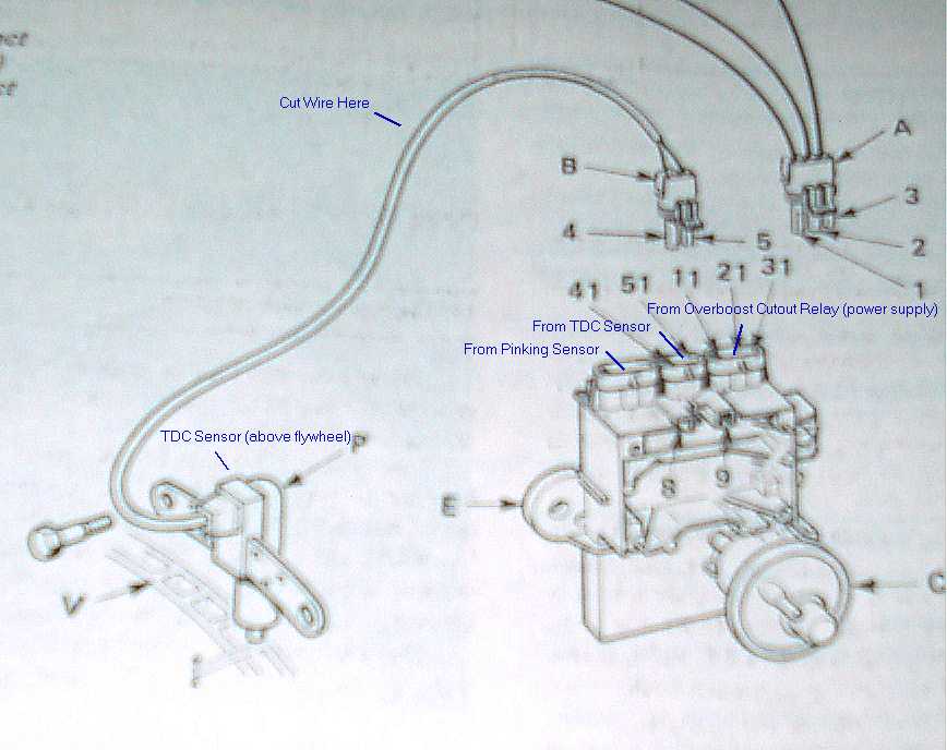

The GT Turbo also has a 'pinking detector' (basically a microphone on the cylinder head), which if the ECU detects this problem, will cause it to automatically retard the ignition 4 degrees for a short while to prevent it, at the expense of power. You can see how these are all connected to the ECU in the first picture.

In the Renix system fitted to the R5, it determines when TDC happens using the same sensor as is used for engine speed. The flywheel has two teeth that are longer than the normal ones. These represent 90 degrees before TDC and 90 degrees after. The ECU will expect a speed pulse to come, but there will be a gap at these two points on the cycle, so it knows from these 'missing pulses' that the engine is either at 90 degrees before or after TDC. In fact it doesn't actually matter which of these points it is at - because the timing advance or retard will be the same for all four cylinders, so as long as it generates a spark when it gets the 'missing pulse' (plus or minus the delay for engine conditions), and another 180 degrees later, all will be correct. The fact that there are two rather than just one marker for TDC is due to the fact that it takes two whole rotations of the engine to fire all four cylinders on a four-stroke engine, with a spark occurring every 180 degrees of rotation.
So each time a 'missing pulse' is detected, a spark is produced. You can see these teeth on the flywheel in the fourth and fifth pictures. Note there is a second toothed ring with smaller teeth behind the timing one - this is for the starter motor to engage.

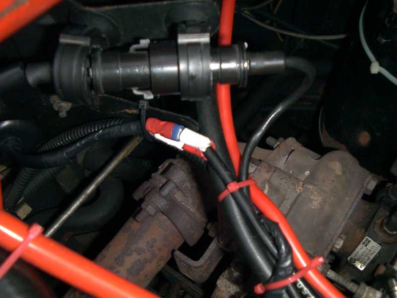

The easiest way to do this is by cutting the wire (shown in the first picture) to reveal the red and white wires within. Crimp/solder bullet or spade connectors onto the ends (and insulate well) - then you can swap the wires when you want to, but still have the option to swap them back if you have to run on lower octane fuel. See the sixth picture for this.
