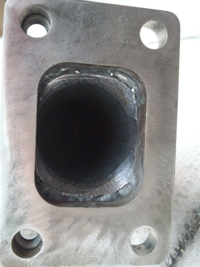

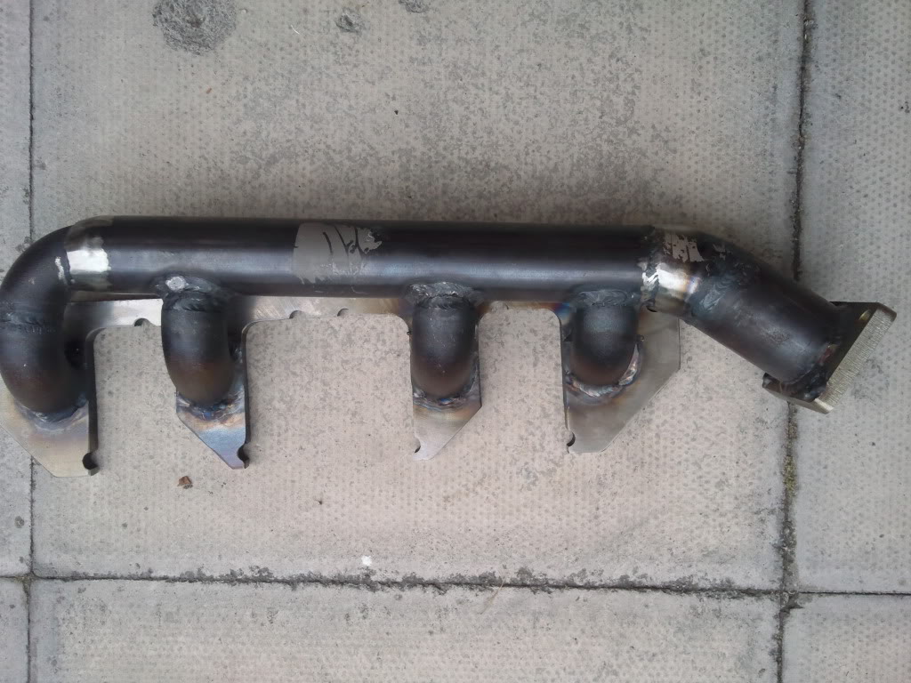

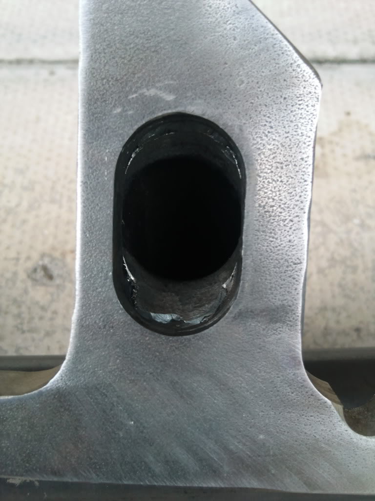

Hears a few pix of the log manifold big jim racing just made me, I know a few people wanted to see how it came out. In total it cost £225 inc postage which isnt bad looks nice and solid. What are peoples opinions on the finishing of the ports? is it worth cleaning them up a little?

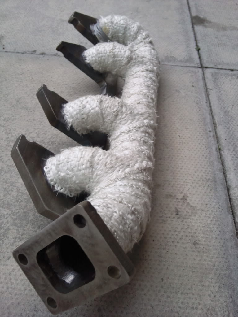

and how it looks after i wraped it.

is it all stainless inc flange? looks good, would be nice to see it unwrapped and on boost to see if there's any hot spots as the runners aren't angled. looks better quality than the prima one. very good price too. i'd leave as it is, looks like he's took most of the meat of and you dont want it to go too thin. tbh i dont think it makes alot of difference on a turbo'd car
no really power gains raj but makes the exhaust note change alot to more like a gtt but still unique, makes the turbo more accessable especially if a bigger unit, less heat soak into the inlet manifold and bulkhead, shorter boost pipe and airfilter run and makes the engine bay more even ;)

would only have polished the manifold if big gains could be had (which i know aint poss) so wont bother. The main reason for getting this than a tubular manifold was the price, and the fact that im not going for big power a tubular manifold isnt necessary, jim rekons this should flow enough gas for 250bhp so that will do me. this set up will also keep the turbo in the same place as on the c1j so i can use gtt crossover pipes and exhaust. I think the whole thing is stainless haz.

I wouldn't worry about the ports, they look just fine :)

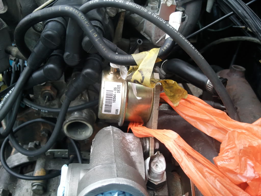

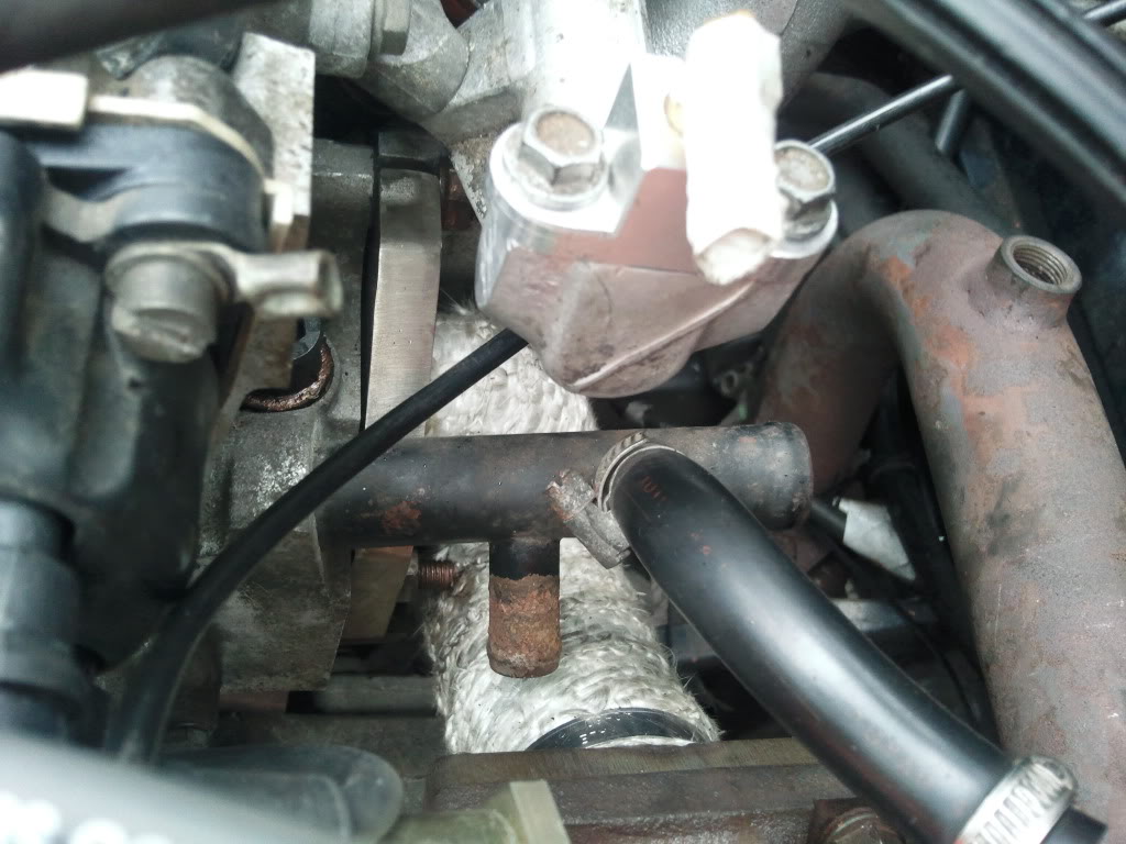

heres some pix of the manifold fitted.
not much clearance for the plumbing but there is just enough.
http://i773.photobucket.com/albums/y...Photo005-1.jpg
actuator fowls on ht leads so needs to be packed out to clear.

looks very similar to one of the earlier mock ups of mine, you find the bottom port of the pipe from the rear of the head doesn't even have enough clearance to bung up so needs chopping down, i ended up just cutting it bout an inch long, 2inch of silicon then bout 6in hard pipe with a small outlet in the middle to bleed/return to header tank. you also find the top rad hose/thermostat housing may foul on the turbo, you can fit a 90' version, i think from a gtx engine

no probs with the stat outlet i just used the c1j top rad hose as it has a 90deg bend. the bottom port from the back of the head did need to be chopped down but that now feeds the turbo. il get some pix up soon.
