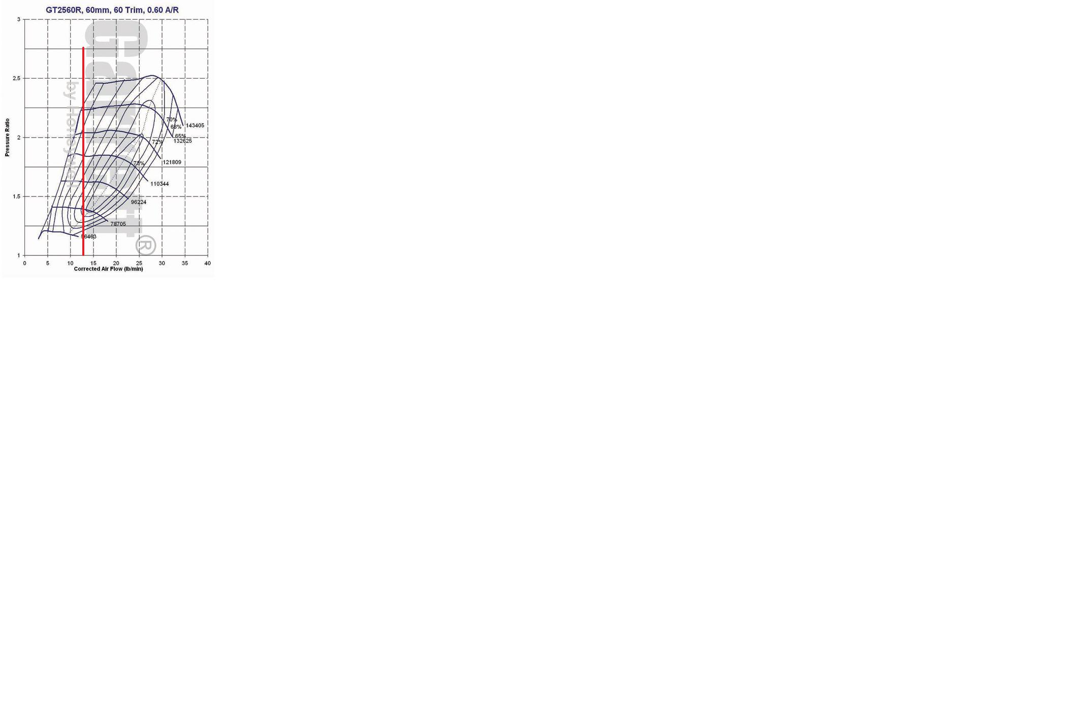

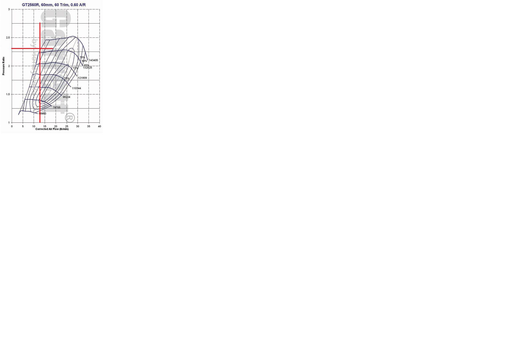

your forgetting this turbo is not the same spec you had , it went back to cr turbo for modification ,ie 200bhp and fast spool, which it is at a push.
compressor diameter is ok but could do with more trim, to maximise air flow,
but your turbine is small diameter and to smaller trim, as i thought, your just bottle necking all the exhaust gasses:(
and to be honest by the time youve had this turbo altered it would be just as well to sell it , and buy a new item:)
gtx28rs(53.86 turbine wheel diameter/74 trim) with 60mm compressor wheel, .63 exhaust housing....... will give you the power you want without lag.;)
although if it were me i would still get the internal wastegated gtx3071r,55.6mm turbine,and 71mm compressor, for bigger bhp output 250+:smokin:
