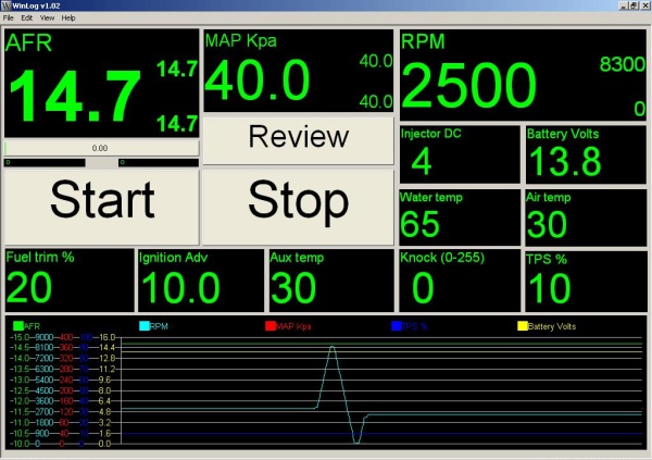

Hi Guys
I had a customer ask me if it would be possible to use the very handy, free version of WinLog with his Adaptronic e420c.
No one had written a device driver for it and since it would also be usefull to me I decided to write one.
I've included it here for download.
Its tested with some E420c's and an emulator. It should work fine with 440's too. It will not work with E420b !
Connect the laptop / PC running WinLog to the ECU in the same way you would when using WARI (for 440's it will be neccessary to connect a COM port to the Serial out jack).
What is WinLog ?
Go to http://www.devtechnics.com/winlog.htm to read about it, download it and so on.
Then download my driver bundle (for COM1, 2, 3, 4, 5 or 6) here: http://www.efi-parts.co.uk/downloads/Adaptronic_WinLog.zip
Read the included README.TXT. In short, you install WinLog, un-zip and copy the driver files (link above) in to a new directory (not the WinLog directory). Run WinLog, go to "File, Open Dashboard", navigate to the drivers directory and select "Adaptronic.dsh". Finally, go to "View, Device configuration" , "Add" , "Have disk" then navigate to the drivers directory and select the apropriate driver.
The dashboard is configured for the COM1 driver as default. You can right-click, then go to "Edit, Properties" on each of the gauges to set them to a different COM port driver if you wish.
You can fiddle with the dashboard (screen) layout all you like, I just included a basic one to get you going.
What can I log with this driver ?
RPM
AFR
MAP kpa
TPS %
Water temp
Air temp
Aux temp
Injector duty cycle (%) (a calculated average of the 4 injector outputs)
Ignition Advance
Fuel trim %
Knock (0-255)
Battery volts
Screenshot:
http://www.efi-parts.co.uk/images/adaptronic-winlog.JPG

Been playing with this data logging software great bit of kit once I figure how to get the graphs up. :ashamed: took me a while. :laugh:
One question Is there any reason why my car turns over but will not start while WINLOG is open?

Another question been data logging again trying to figure my fuelling issue out. I noticed my battery voltage is all over the place. Is this just the alternators regulator doing it's thing or should I be looking for poor earth's and loose wires. My in car gauge stays steady and is not showing this fluctuation.
Re: For users of Adaptronic engine management
Where is the ECU getting it's supply from ? Could be a crappy connection somewhere, bad ignition barrel or something along those lines.
If it only does it at higher revs then it could well be the reg in the alt on it's way out :)
1 Attachment(s)
I'll have a look at that tomorrow as it was ages ago when I put it in. but looking at the full graph it's all over the place. :cry: at least I know it's not down to an high sampling rate and to investigative some more. :)
12.6volts at 1000rpm is too low :(
It is altering very quickly it does look like maybe its the regulation of the voltage as it looks like its averaging around 13.6volts which isnt too bad. difficult to say, ive never scoped the battery voltage to see what the charge regulation looks like. maybe have a look on picos website they may have something
1 Attachment(s)
sort of helps but this is a variable aternator.
The peak-to-peak ripple voltage out of an alternator can be as much as 4 to 6V at high output currents.
