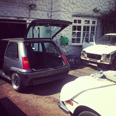

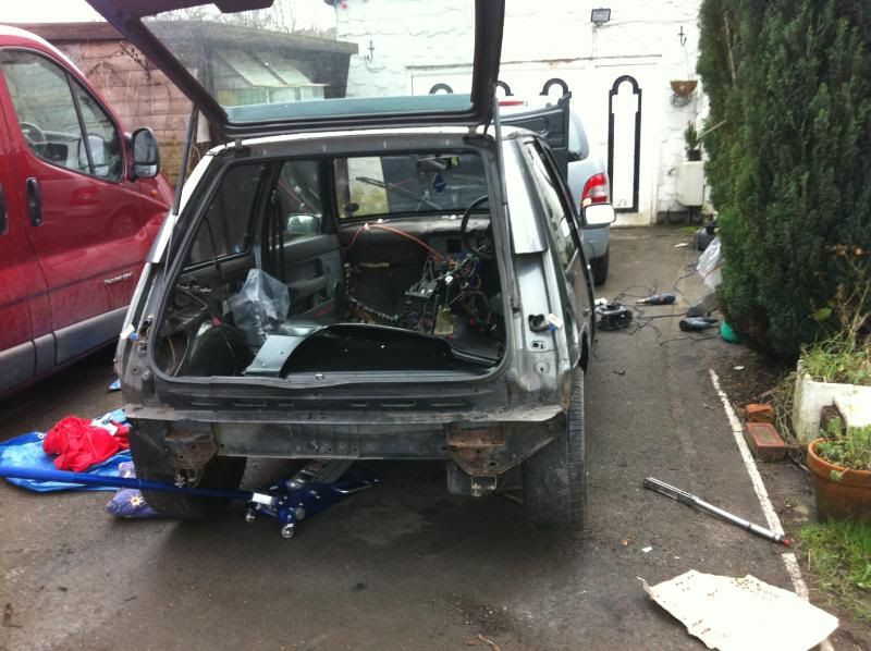

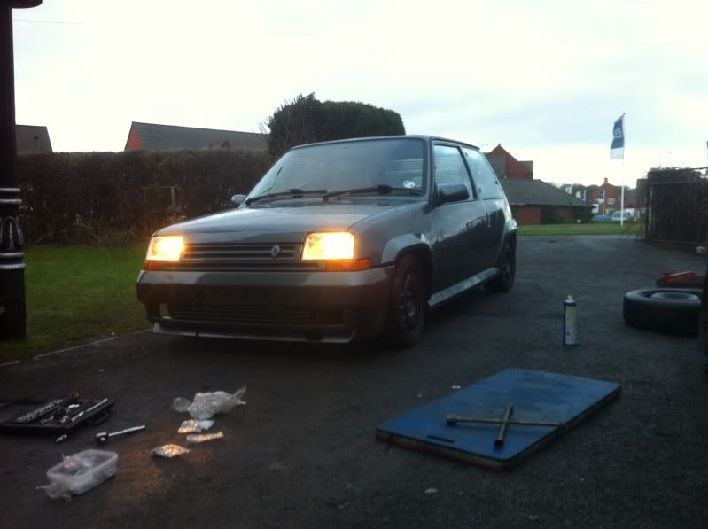

I did an insurance check and i can insure it for £16 for the week, so i decided id go for it to get it moted.

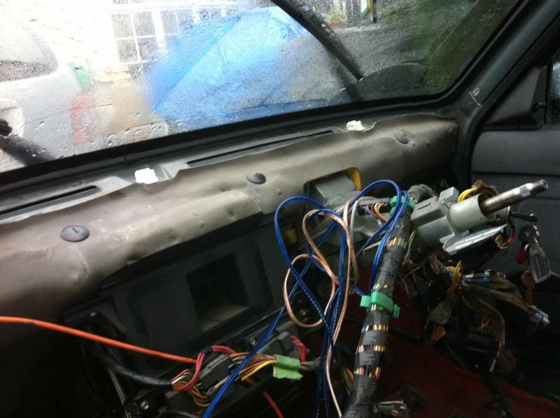

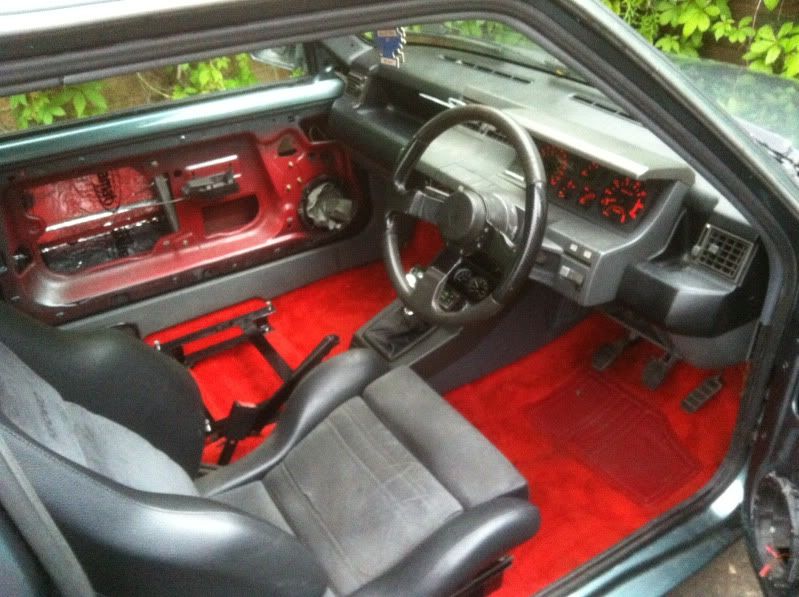

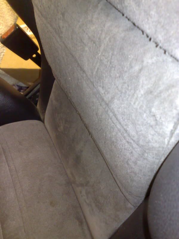

First job was to remove the interior, and throw in a red carpet as the grey orignal just didnt work.

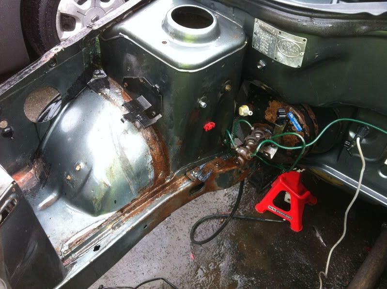

Whilst at it i took a look at the floor pan which was in good condition with just a bung to reseal.
http://i3.photobucket.com/albums/y98...9012008747.jpg
http://i3.photobucket.com/albums/y98...9012008748.jpg

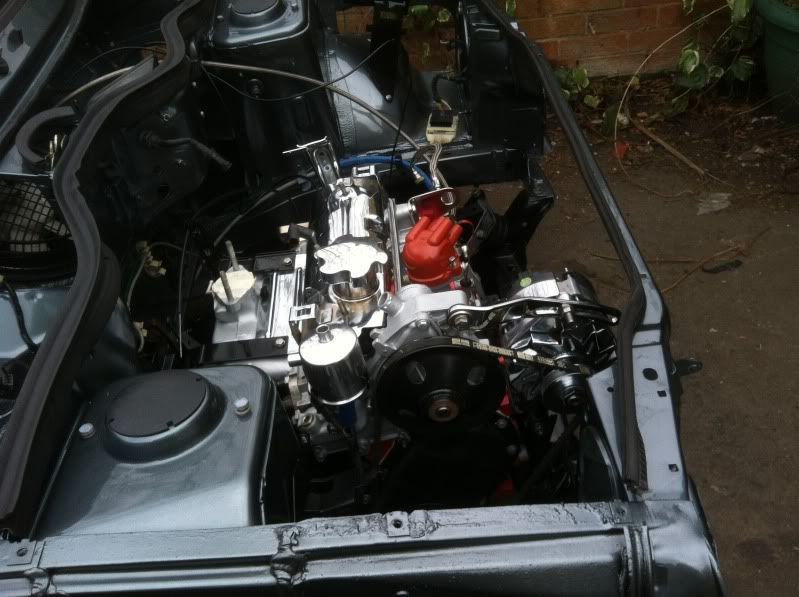

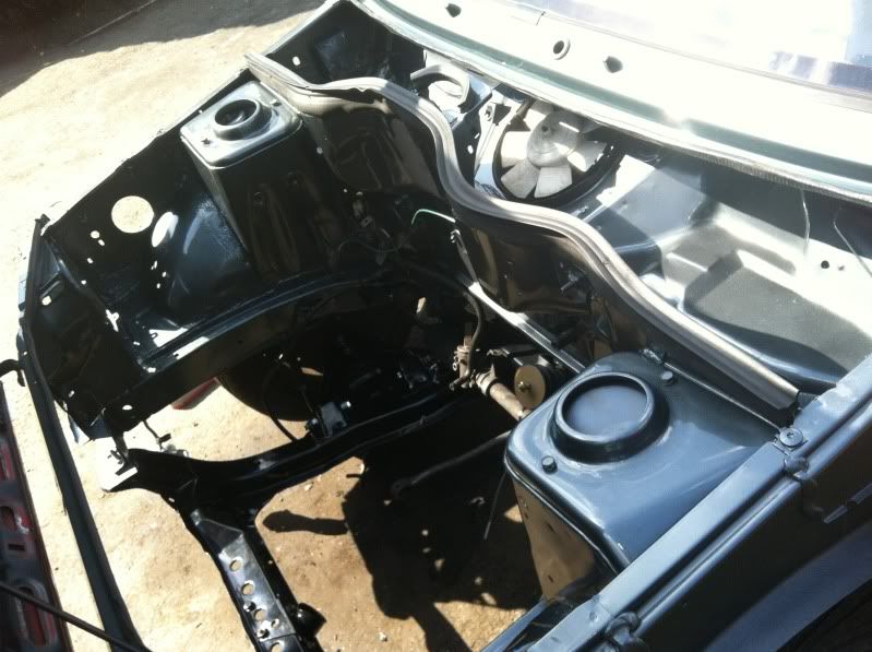

I also want to take some time to remove any unused brackets and tidy up the engine bay.
I attempted to sort out an earth problem which took ages on the rear back lights

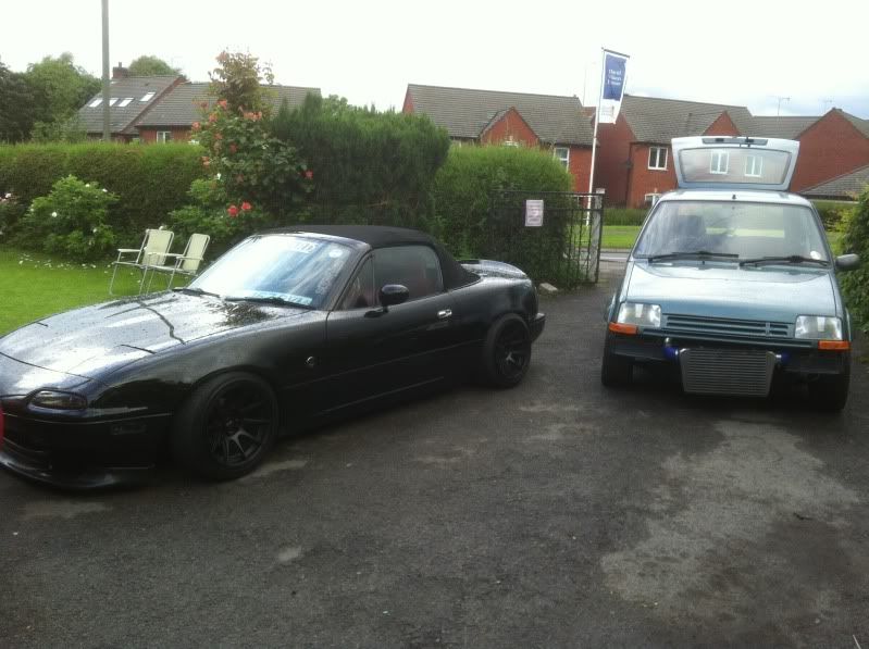

Pic of the garden complete with full r5 interior and the mrs chilling
http://i3.photobucket.com/albums/y98...9012008749.jpg

is that as close as the mrs is gonna get 2 drivin your new 5 dj??? :laugh::laugh:

Are you keeping the grey capert in situ or going for red ?
Re: Djs second R5 Tungy Jplate
haha, probably mate.. she loves her old cars but the r5s have a funny clutch compared to an r5 im told :P
Going red mate.. cant have a french 80's hatch with a grey boring carpet.
Its now in my old r5 and i gota say it looks pretty smart in there but still not my thing.

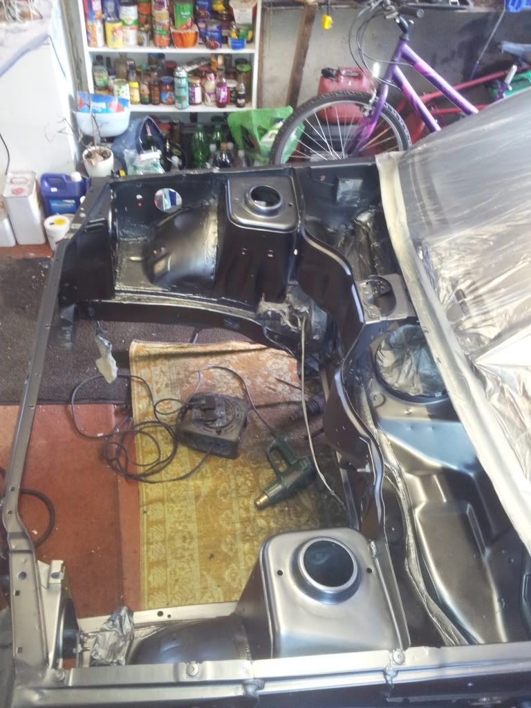

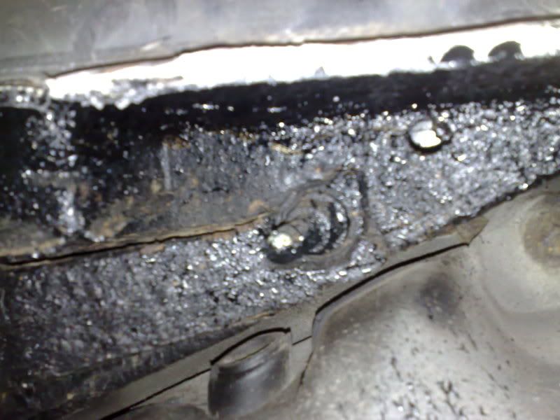

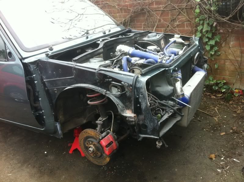

bit of an update, ive got the sills, just waiting to get them welded up, and ive robbed the garage for the week so decided to strip down the cooling system etc , have a mouch to see if everything is in order and also stumbled across a few things
http://i3.photobucket.com/albums/y98...0022008798.jpg

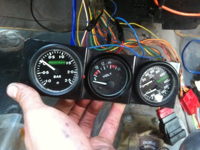

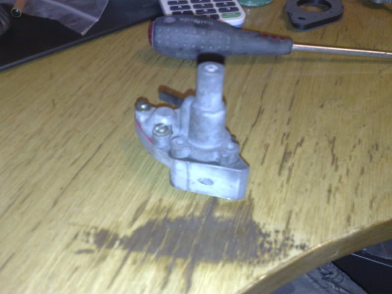

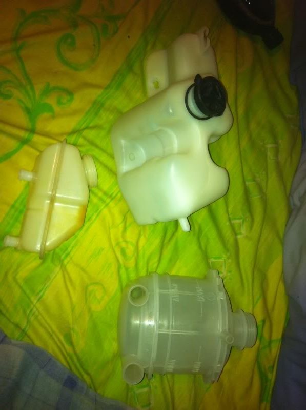

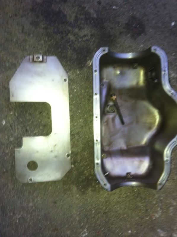

found this mocal plate, presume its to monitor the oil temp, its in the oil return from the turbo
http://i3.photobucket.com/albums/y98...0022008799.jpg
not 100% sure if this BMS pipe is the full on 2.5inch
http://i3.photobucket.com/albums/y98...0022008800.jpg

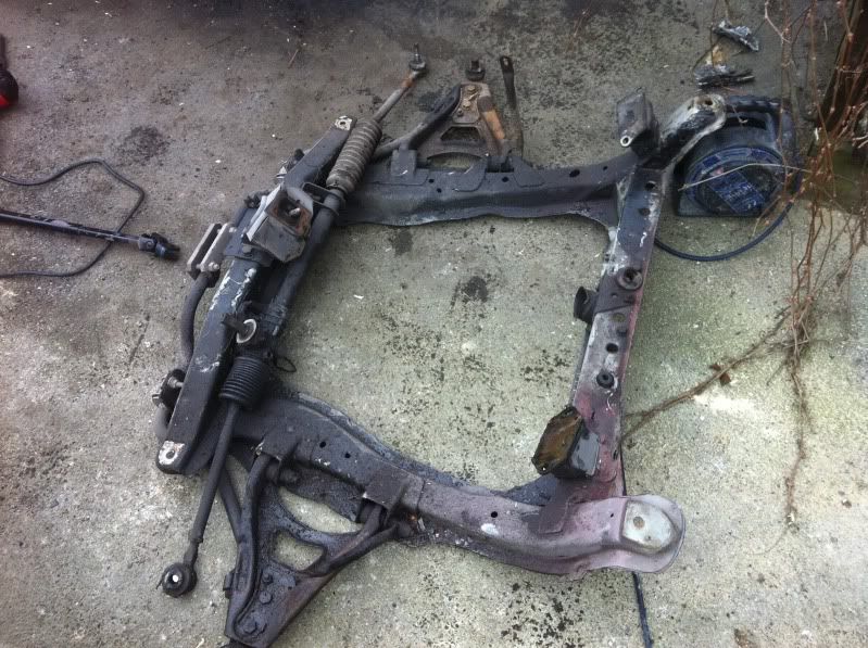

and the mint n solid front subframe
http://i3.photobucket.com/albums/y98...0022008801.jpg

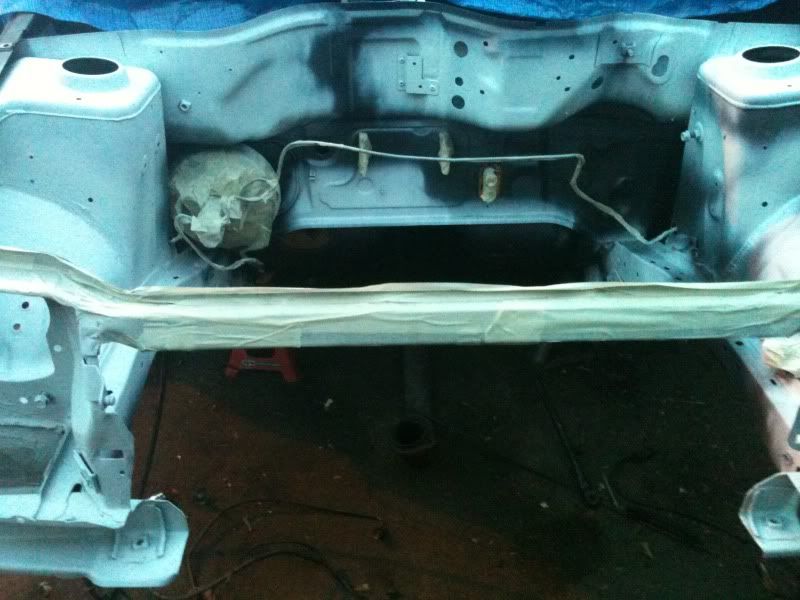

cheers rob.. small update..

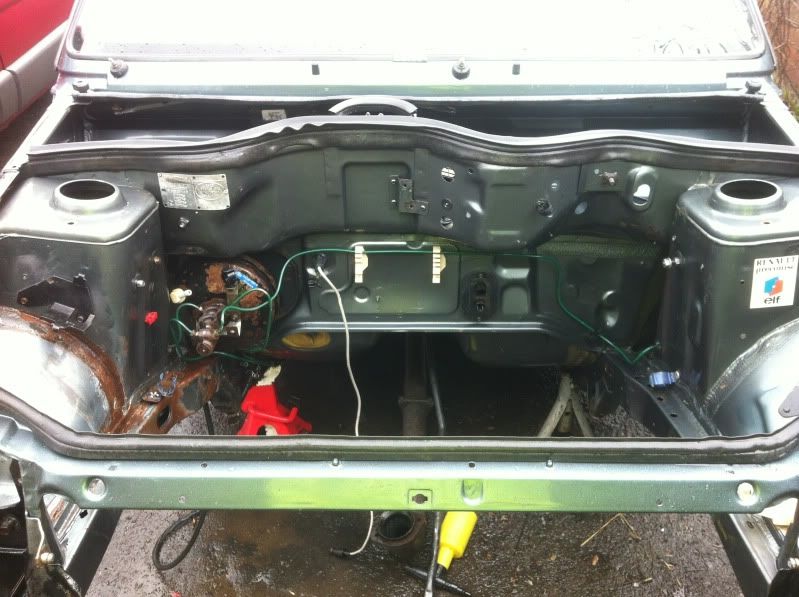

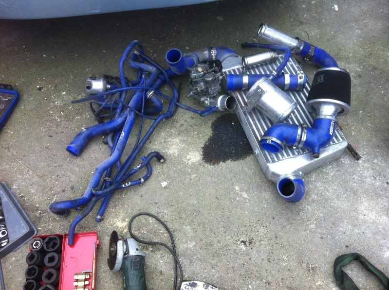

Diffrent carb top, removed some of the perc fan wiring, and brackets (unneeded) Started fitting some of the chrome scuttle panel.. poser i know... and fitted a braided inline oil filter on the turbo oil feed.
http://i3.photobucket.com/albums/y98...1022008803.jpg
http://i3.photobucket.com/albums/y98...1022008804.jpg

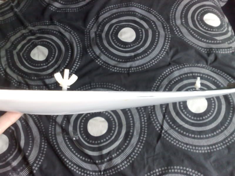

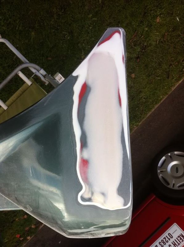

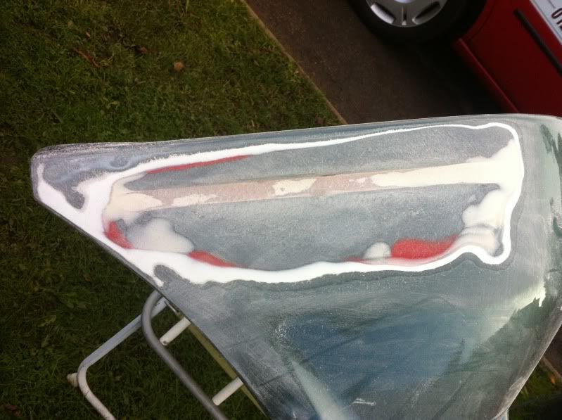

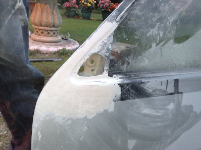

I began the rear bumper tonight.
Im no expert but this is how i tackled it.
First i removed the black strip and used a flap wheel on the grind to key up the inside of the recess and also the very close surrounding area, i also used some 80 grade paper to help do this around the edges.
http://i3.photobucket.com/albums/y98/djinuk/bumper1.jpg
I then masked up the surrounding area to not get p40/fibreglass bridging filler where it wasnt needed.
http://i3.photobucket.com/albums/y98/djinuk/bumper2.jpg
I then filled the recess making sure to not bring it 100% flush with the surface and instead leave about 1mm to fill
http://i3.photobucket.com/albums/y98/djinuk/bumper4.jpg
then once this had gone off i used 80 grade paper to remove any bits of p40 that came above the recess and also to key up the flat area that i would be filling. I also gave it a clean up with panel wipe to make sure the p38/filler adheres well.
http://i3.photobucket.com/albums/y98/djinuk/bumper5.jpg
I then filled the full area making sure to filler outside of the recess aswell whilst keeping waste minimal
http://i3.photobucket.com/albums/y98/djinuk/bumper6.jpg
next i will guide coat this and use a large block and 120 grade to get it down to around the correct level.

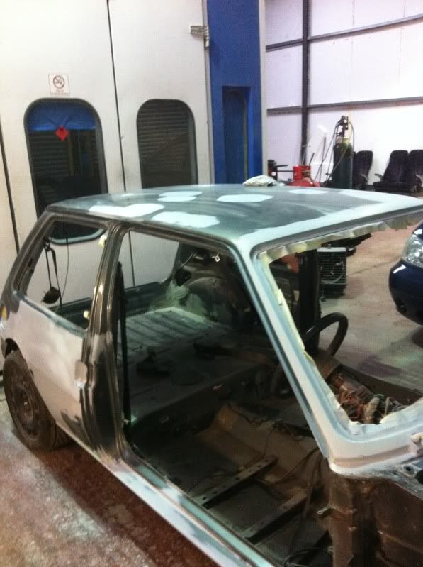

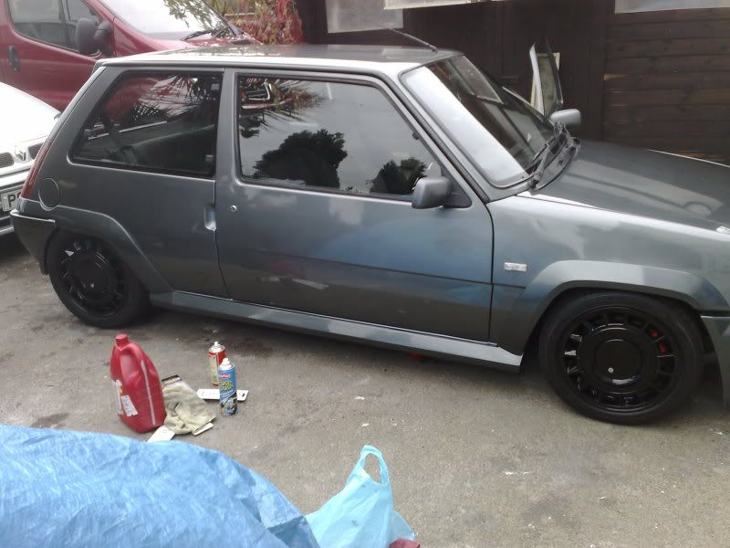

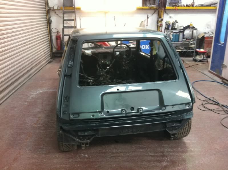

Well , ive taken the r5 to the bodyshop , now its just a case of waiting for it to come back with a pair of fresh sills
:( man its horrible when one of your cars is taken away.
http://i3.photobucket.com/albums/y98...0620081094.jpg
also made a start on the front bumper
http://i3.photobucket.com/albums/y98...0620081091.jpg
http://i3.photobucket.com/albums/y98...0620081092.jpg

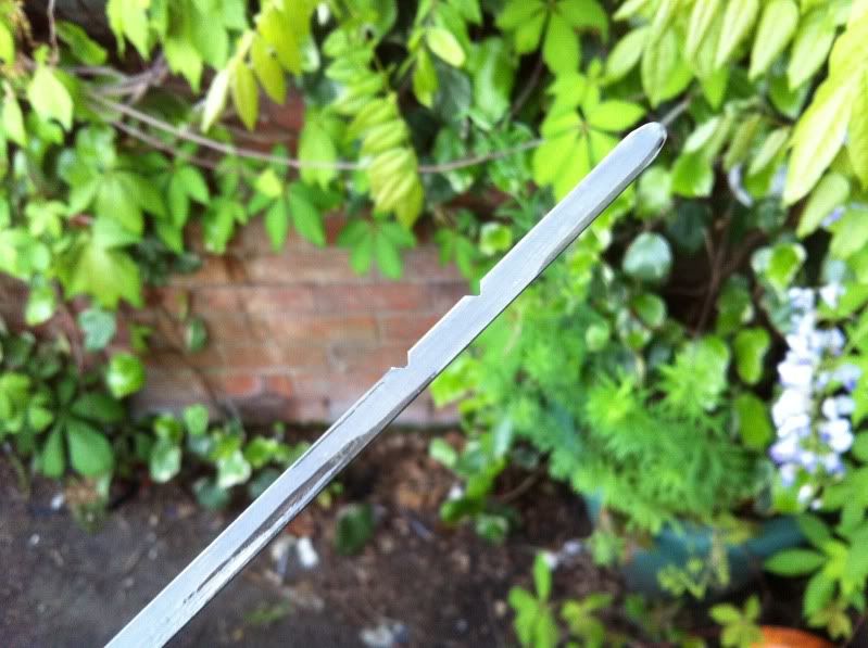

after many hours sanding i got the filler back to 400 grade and flat, got it mostly right on the second fill so all good.. blasted it up with high build and a guide coat and begain wet flatting with 800.
http://i3.photobucket.com/albums/y98/djinuk/bumper.jpg

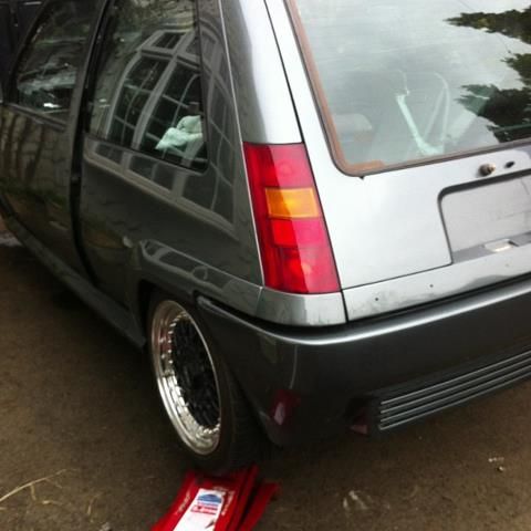

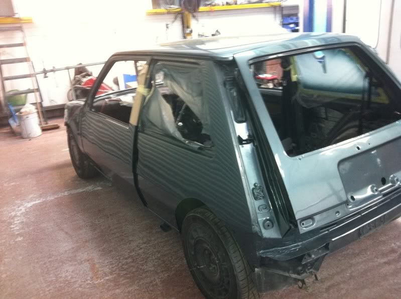

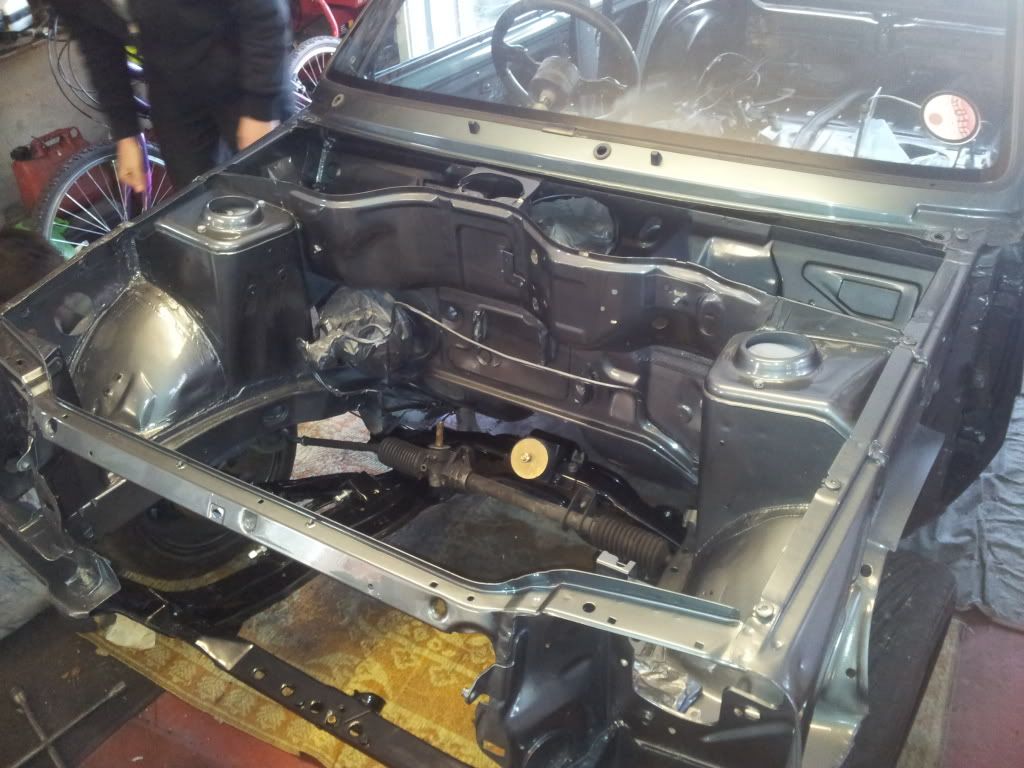

she comes home tonight
I was down there last nite and took a couple of pics.. This is basically at the stage where hes painted up to the character line, and has jst wet flatted it into the existing paint to around 3000 grit also along the sill hence its dull, it will be buffed up before i collect tomorrow.
http://i3.photobucket.com/albums/y98...0220071386.jpg
http://i3.photobucket.com/albums/y98...0220071385.jpg
http://i3.photobucket.com/albums/y98...0220071384.jpg

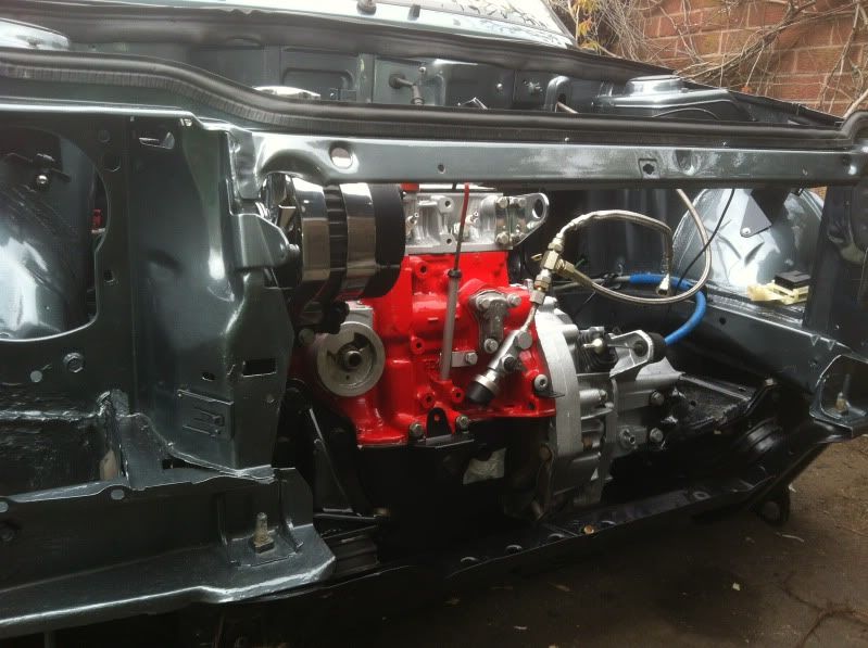

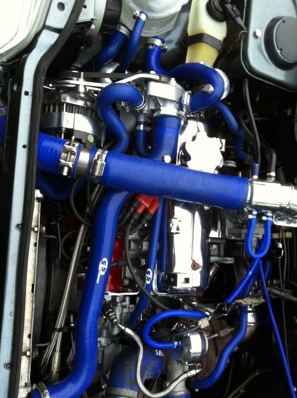

well i tackled a few of the jobs for the day, first being fitting of the front mount intercooler, and side exit exhaust system, also removed the remains of the bits of standard side sticker that was still on the car.
We also fitted the carbon bonnet although this requires more adjustment to get sitting better.
Few pics
http://i3.photobucket.com/albums/y98...0320071394.jpg
http://i3.photobucket.com/albums/y98...0320071402.jpg
the dolmon at work
http://i3.photobucket.com/albums/y98...0320071393.jpg http://i3.photobucket.com/albums/y98...0320071389.jpg
http://i3.photobucket.com/albums/y98...0320071395.jpg

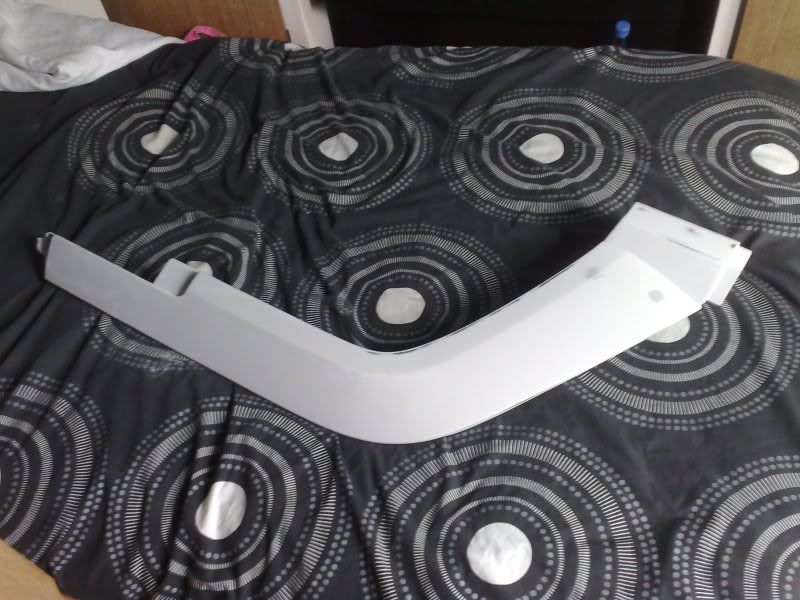

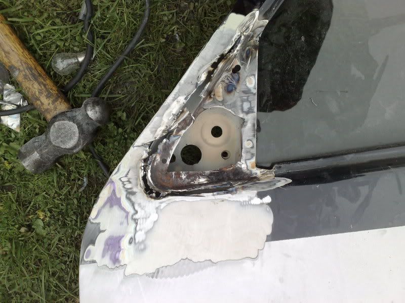

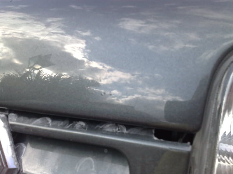

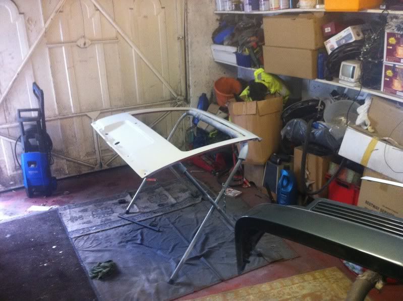

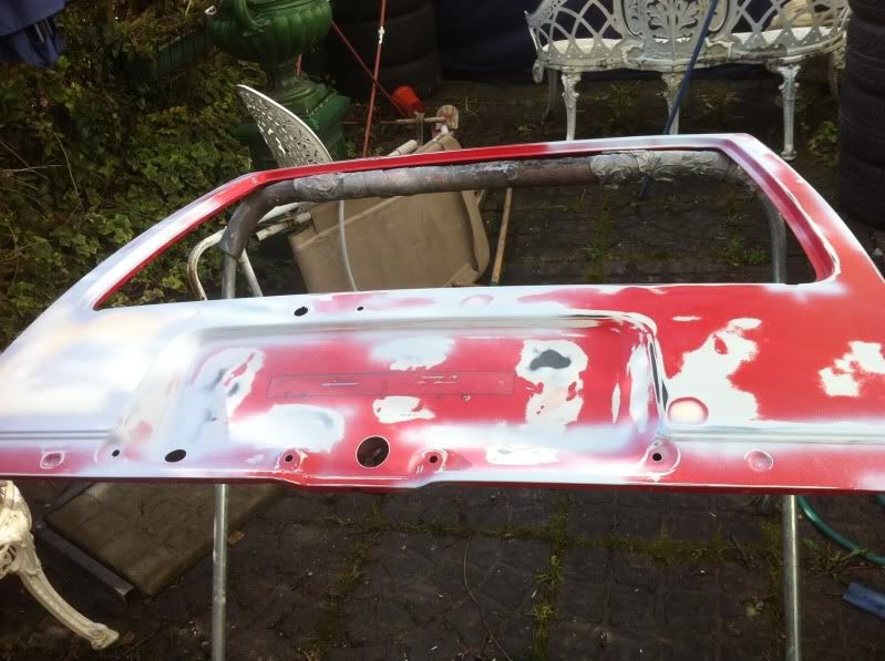

just been working away on repairing the preping the bodykit for paint.
one of the front arches had some very bad damage to the arch as through the car had a blow out and ripped a very large chunk out, I cut a section out of an old arch, fibreglass this in , and then filled the arch, there is also a few more cracks etc ive had to repair.. the photos are not great but give an idea.
http://i3.photobucket.com/albums/y98...0320071411.jpg
http://i3.photobucket.com/albums/y98...0320071414.jpg
http://i3.photobucket.com/albums/y98...0320071410.jpg
http://i3.photobucket.com/albums/y98...0320071413.jpg

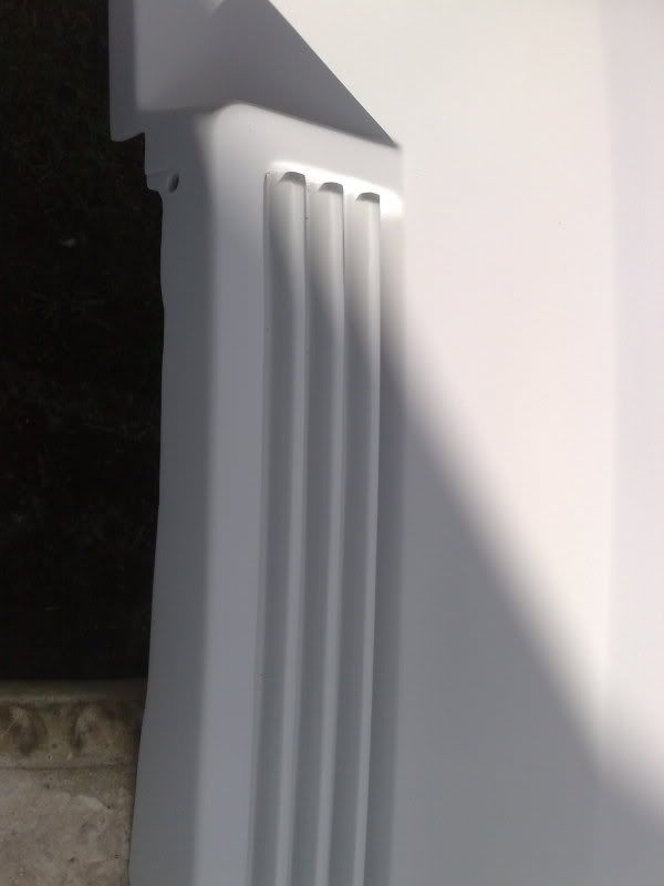

i finished all the repairs on my r5 bodykit over the last week (there was quite a few).
I high built them yesterday using maxmeyer high build at a 5:1 ratio, I decided to try somthing and rigged up my 2 pretty small compressors to give myself some mroe air pressure... the result was excellent, 2 motors about 70 or so litres of air , and my 29psi hvlp gun didnt have any problems, this made it so much easier, and the high build is going to be much easier to flat down.

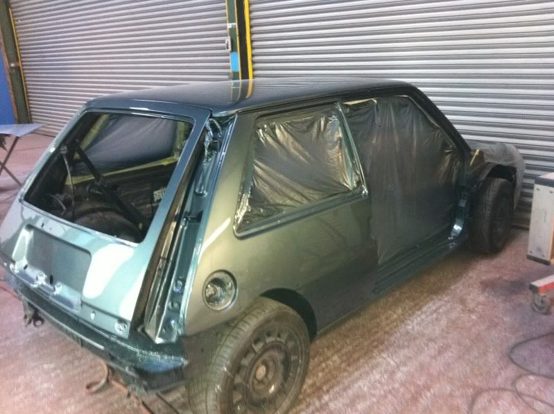

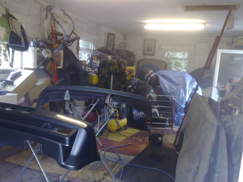

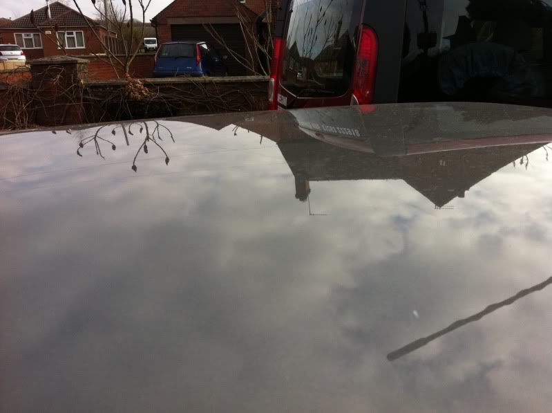

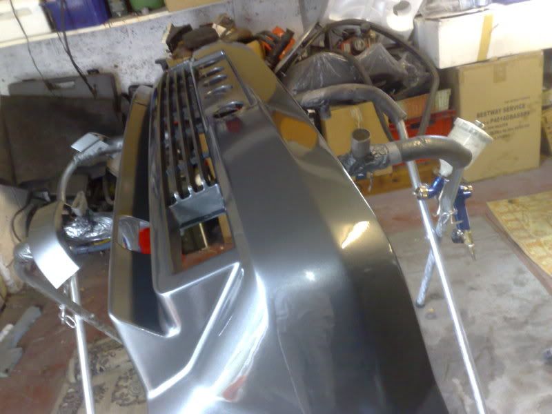

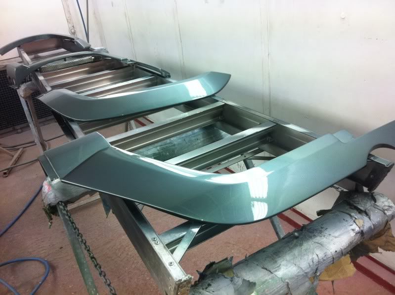

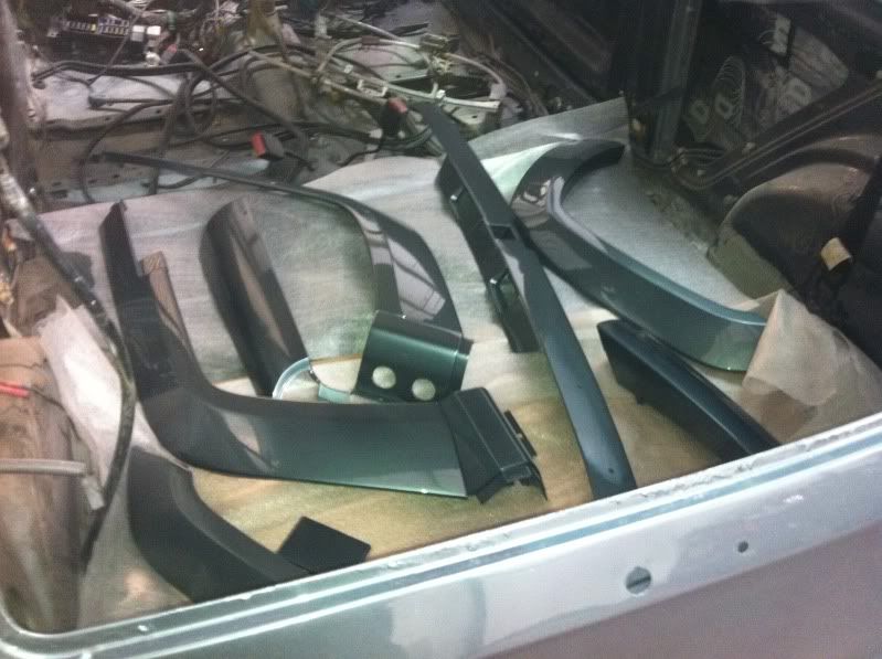

well today i set up my gazebo and compressors and set about doing my first basecoat/clear coat paint... to say i was a little nervous as i was doing my first metalic ever aswell, and the weather was hit and miss etc etc..
Had great help my my mrs in setting up..
arches , skirts and grill all paint, 3 coats of base, 3 coats of lacquer..
And im very happy with the end results ..
only 2 drips and these were caused by over filling the gun and when painting one of the arches it came out the top :(.
This is how the bits came out the gun..

fitted the front bumper with some new clips and screws but not happy with it so going to renault to get brand new fixings i think.+
Also fitted the skirts, i bolted the bottom and bonded the top however im not 100% kene on it, think at a later date im going to take them off and measure up exactly where the fixings need to be and do it propelly

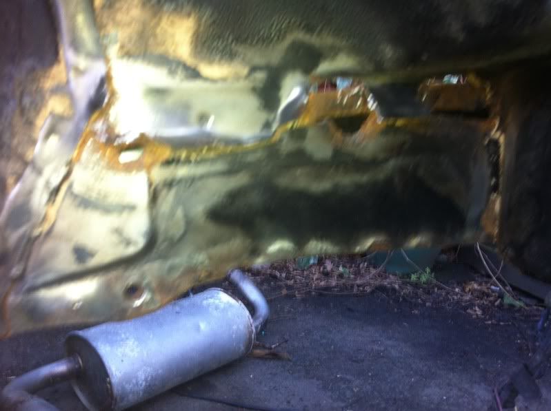

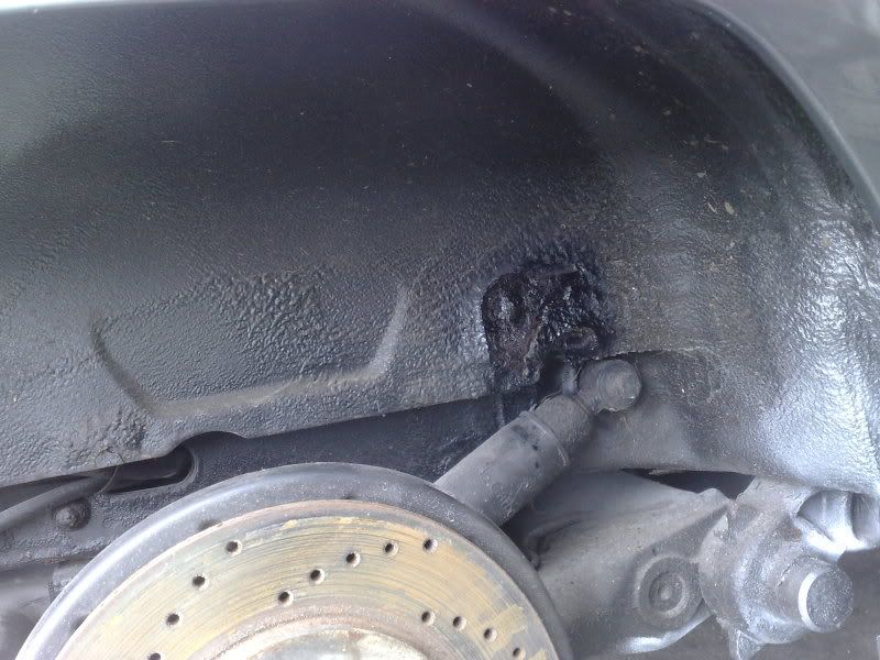

Also i found this bit bit of rust in the inner arch, ? common, looks like it may be a major job to sort.
http://i3.photobucket.com/albums/y98...0120071497.jpg
there are loads on classic rot places on a gtt.. sills, windscreen surrounds, behind the headlights next to the bumber mount, inner boot well behind the plastic trims as mud sits on a bracket behind the filler neck, rear quarter windows go under the rubbers, etc etc etc.. so many places..
you doing well tho, thats looking mint
if you look in my pics you can see some of the rot on mine.. the sill is rotting inside to out as the underseal was spot on, yet after i wire wheeled it off theres loads of holes and you can see the metal behinds shot to sh1t.. do be shy getting into these places if your putting all this effort in.. i want 99.9% of the rot gone on mine so i'm going mad man..

began working on the rust and found a hole the size of a 50p, bit of work later and its gone.
http://i3.photobucket.com/albums/y98...0220071535.jpg
Then i attached the rust on the underside, and etched primed the bits.
http://i3.photobucket.com/albums/y98...0220071542.jpg
then up went the gazebo/spraybooth and on went the high build, ..
http://i3.photobucket.com/albums/y98...0220071543.jpg
http://i3.photobucket.com/albums/y98...0220071544.jpg
then on with basecoat and clear,

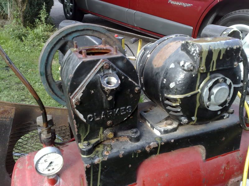

after finishing this the compressor made a bang and then rattles lots...!!!
the result
http://i3.photobucket.com/albums/y98...0220071547.jpg
http://i3.photobucket.com/albums/y98...0220071550.jpg
http://i3.photobucket.com/albums/y98...0220071548.jpg
ah well, it spray the bearing out that connects the conrod to the crank.. easy fix
Anyway , happy with the bonnet, will get flatted and compound and hopefully be nice and shiny

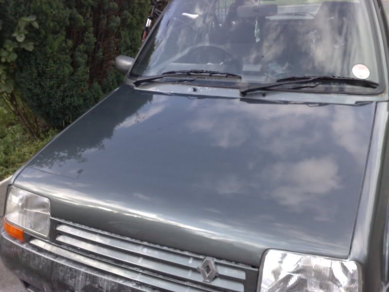

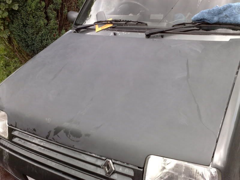

speant the best part of 4 hours wet sanding this morning.. the bonnet had a lot of crap in it as it was windy, lots of crap managed to land in it, i attacked it with 1500 and then 2000 , could of done with somthing a bit more brutal i think to speed things up.
Anyway after many hours the result, a nice matt bonnet, with 99% of the crap sanded out.
http://i3.photobucket.com/albums/y98...0220071555.jpg
I then removed the bonnet from the car and used a g3 polish with a hard compound pad and this was the result after 1 pass,
http://i3.photobucket.com/albums/y98...0220071556.jpg
then i went on with a soft polish and a softer mop head, the polish was very cheap and called encore , reccomended by the local bodyshop supplier, i really cant fault it.
http://i3.photobucket.com/albums/y98...0220071557.jpg
http://i3.photobucket.com/albums/y98...0220071558.jpg
I then fitted the bonnet to the very grubby car - dont worry its just lacquer run off from when i wet flatted it earlier on the car and all washed off.
http://i3.photobucket.com/albums/y98...0220071560.jpg
Unforunatly one of the repairs on the lower corner began to bubble though, i fear this was becuase i repaired the bonnet and painted it all in the same day :( , possibiliy sealing the filler in before it had fully cured, either way i will see if the problem gets worse, its barely noticable at min, however you can see the small bubbles here. If it does get worse im going to use the exercise to teach myself how to blow new paint into exisiting as its not somthing ive done yet.
http://i3.photobucket.com/albums/y98...0220071561.jpg
If at any point anybody wishes me to stop posting pics etc please say so, ive learnt everything i know to do with cars from the internet and unforuantly its very difficult to find the info so i like to try to make as much of it avalible to people in my threads aswell as detailed.

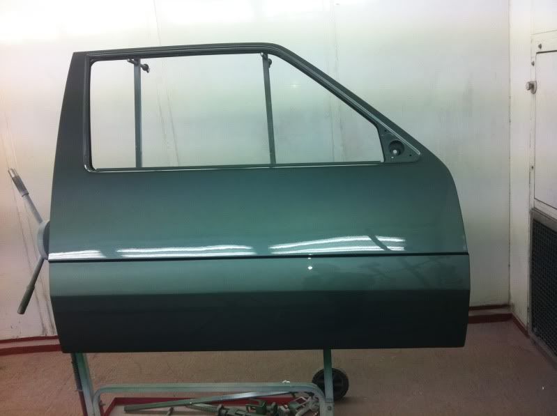

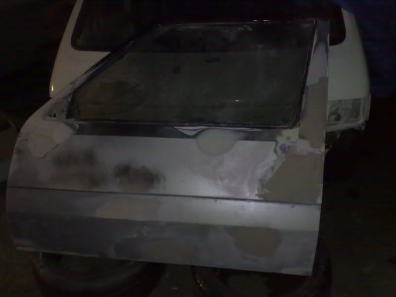

And the biggest ball ache.. I brought 2x delocked doors a while back, they had m3 carbon mirrors on.. I got one ready to flat for paint and then noticed the carbon mirrors didnt have a baseplate as such... and was surpirsed they bolted straight to the doors oirignal brackets.. then i looked again and realised a plate had been welded in and filted over the original.. I began the crap taste of grinding the welds back to remove it and the result was below
http://i3.photobucket.com/albums/y98...0220071564.jpg
http://i3.photobucket.com/albums/y98...0220071563.jpg
I was ready to scrap the doors but then like a fool gave myself the bodywork taste of seeing if i could rebuild them to accept the original mirrors.. I got a few spot welds in to hold the remaining now very week metal, and fibreglassed the holes remaining.
http://i3.photobucket.com/albums/y98...0220071569.jpg
http://i3.photobucket.com/albums/y98...0220071568.jpg
i will continue.

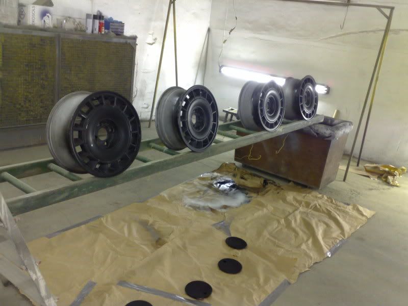

gota a few more hours in on the car.. Preped up a set of turbines and gave them some paint..
managed to borrow a room at my friends bodyshop as the weather was so hit and miss, with sunny spells with rain :S

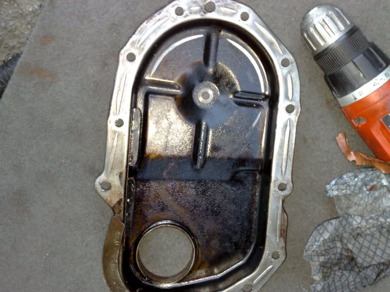

also removed the sump and timin cover to reseal, however had a nightmare.. first time round i found a snapped bolt, this took hours to remove and required the engine dropping of its mounts to gain access.. then i found i coudlnt get oil pressure.. anyways about 8 hours later and its back together..
noticed some pretty fresh marks in the timing cover.
http://i3.photobucket.com/albums/y98...0320071587.jpg

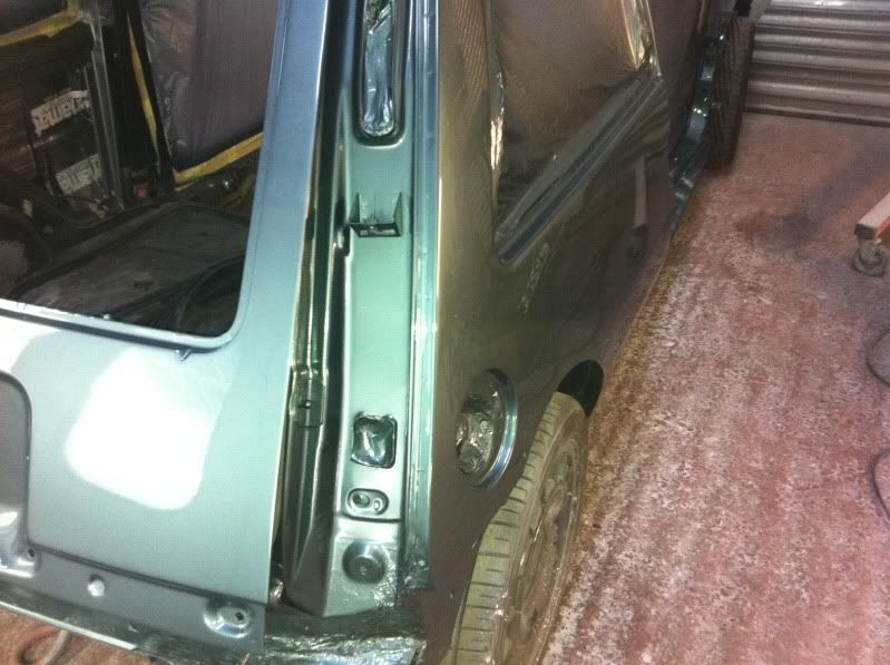

whilst pushing the car this morning my mum managed to catch the door, this bent it down... a bottle jack and 5 mins later i managed to bend the hinges to make it close again however theres now a huge dirty crease which made me push harder to get the doors prepped and ready to paint..
http://i3.photobucket.com/albums/y98...0120071589.jpg
http://i3.photobucket.com/albums/y98...0120071590.jpg
http://i3.photobucket.com/albums/y98...0120071591.jpg
http://i3.photobucket.com/albums/y98...0120071592.jpg
slowly getting there

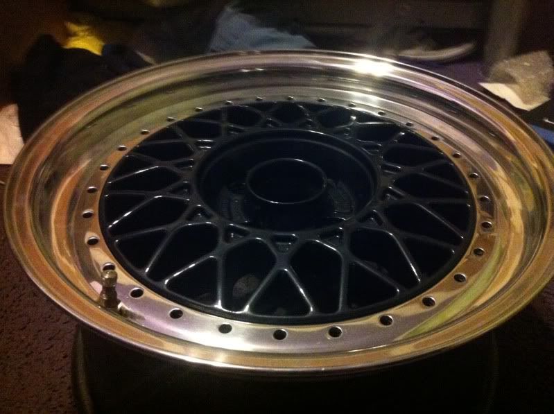

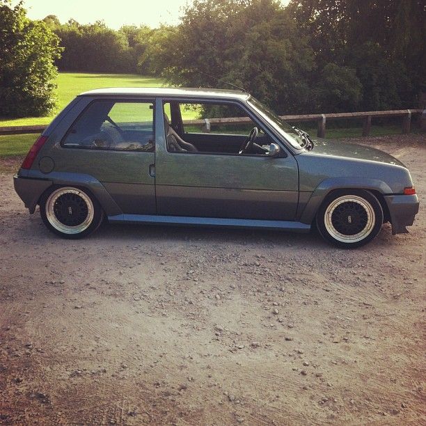

picked up somthing to try on the car..
bbs rms, 15 x 6.5
http://i3.photobucket.com/albums/y98...0120071601.jpg
the look lovely, in the right colour they should look wicked, and i think they grey they are already might just be the one..:cool:
Sy on here had polo gti split rims on his 5 and they looks great, im pretty sure these will look just as good:agree:
Looks like someone is stealing my idea of those wheels! :D
I do like them alot, am after a set myself.
Won't let too much of my plans out. ;)
didnt realise you were after a set of these mark, to be fair the onl reason i had them is i was after some splits , and these were very local (within a mile) and although not cheap, compared to the prices on ebay etc they were good..
Mark how serious are you about having a set.. reason i ask is a guy down near me gets through a lot of wheels (wheel whore) and he may have a few more special wheels..
bbs rm, oz turbo, that kind of thing.. hes not cheap cheap, but hes reasonable..
If they are the set bbs i seen for sale a couple of days ago you got them for a very good price:agree: If i had the ££ i would have bought them for the van.
djinuk
Its not at the top of my piority of things to get but if a good set come along i would be interested at the right price.
If you can get pics of any of the wheels that'll be cool mate if you find any for sale. ;)
yea ill keep ,y eyes peeled mark.. btw do me a favor and pm me your num, ive lost all contacts on my mob and not having your num to hand for when i next brake dwn outside pizza hut could be bad news :)

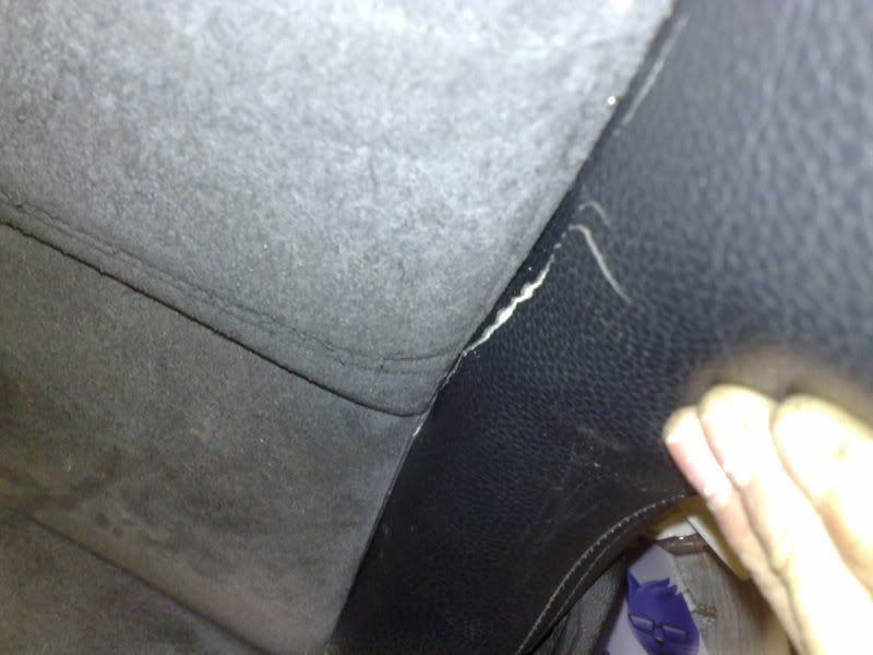

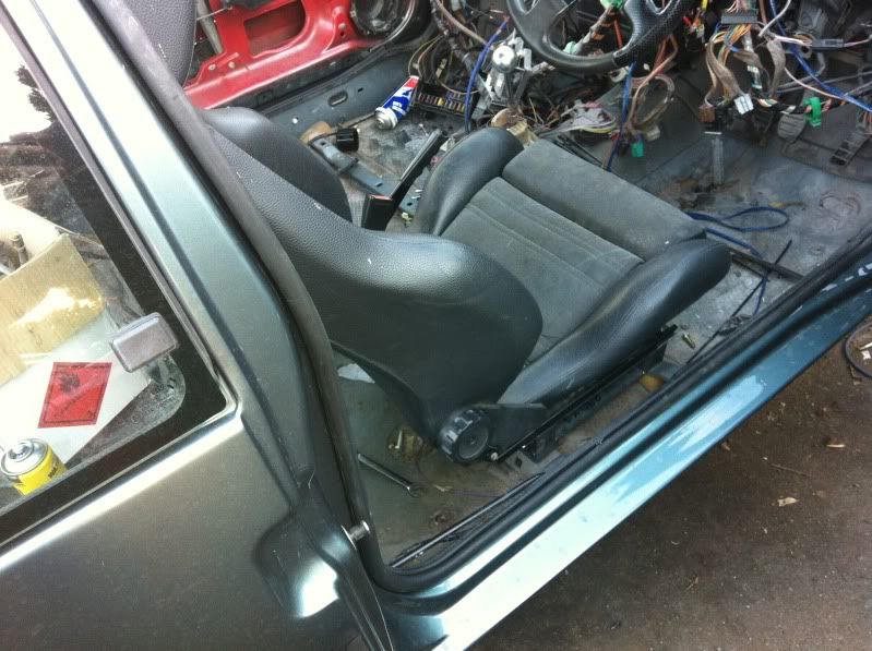

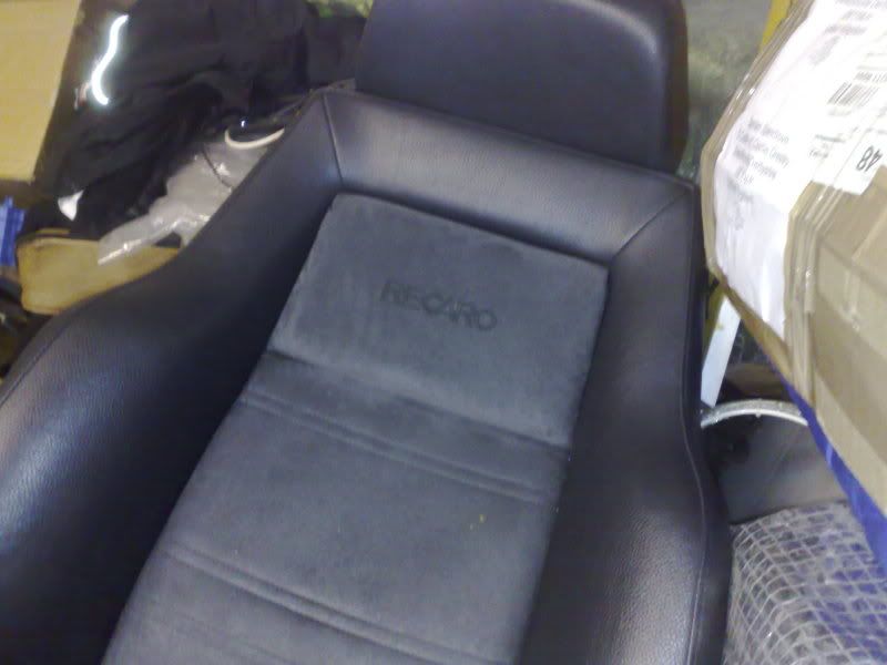

purchased myself another 2 seats 2nite, these ones are driver/passenger so the correct subframes..
Here are the repairs im going to attempt.. drivers seat
http://i3.photobucket.com/albums/y98...0220071721.jpg
http://i3.photobucket.com/albums/y98...0220071714.jpg
http://i3.photobucket.com/albums/y98...0220071715.jpg
bolster already off, just a sieres of silly clips, easy enough though
the main back peice needs swapping as its worn at the bottom also it has this saggness but ill work out whats up with that once its off.
http://i3.photobucket.com/albums/y98...0220071719.jpg
and also just a small wear hole
http://i3.photobucket.com/albums/y98...0220071717.jpg
so , bolster swap, rear material swap, and small hole repair, (not sure how ill do that one yet)
passenger seat is pretty mint
http://i3.photobucket.com/albums/y98...0220071720.jpg
just a saggy bolster ill swap but no rip
http://i3.photobucket.com/albums/y98...0220071718.jpg

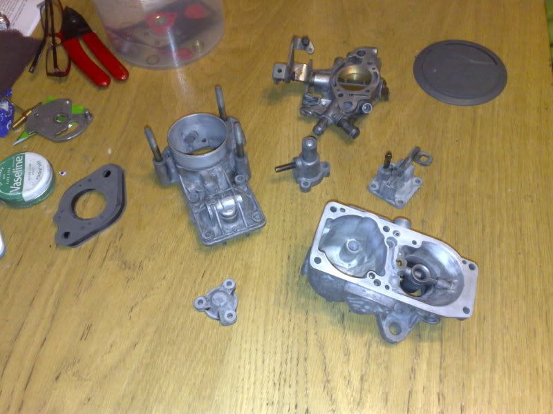

Decided to whip my carb off for a rebuild before i go into any finer tuning to help eliminate any possible problems im having due to hard gaskets etc..
1 cleaned carb, usinga bucket of vinegar , warm water and 15 mins.. plus a nice brush
http://i3.photobucket.com/albums/y98...0320071722.jpg
http://i3.photobucket.com/albums/y98...0320071723.jpg
http://i3.photobucket.com/albums/y98...0320071724.jpg
modified carb top, choke removed but cam still fitted so i can put it on fast idle in the mornings.
http://i3.photobucket.com/albums/y98...0320071725.jpg
http://i3.photobucket.com/albums/y98...0320071726.jpg
and done
http://i3.photobucket.com/albums/y98...0320071728.jpg

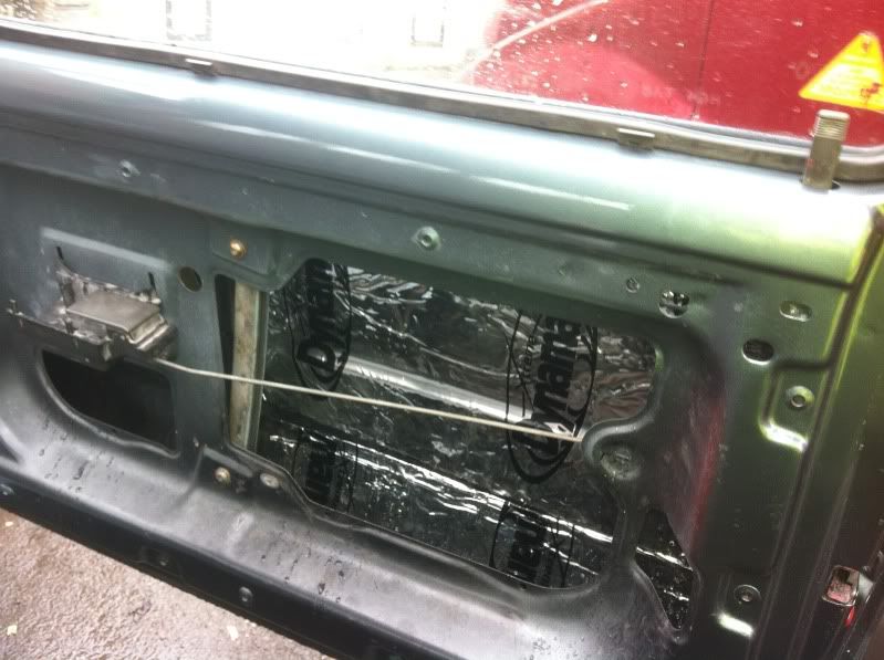

The bodyshop whom fitted the sills on the r5 pretty much allow me to do my own thing up that way ( a few sprays now and then) in return i help them prep a bit of work, ive been offered to do a few spray jobs, but instead i point them to the bodyshop and do some of the work and take a small cut, aswell as gaining invaluable experiance and as said being able to do my own little project up there is a bonus (this will be going up on a month or so).

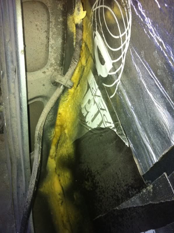

Im sure im coughing on the fumes from melting that sound deadening with the heatgun.

"Im sure im coughing on the fumes from melting that sound deadening with the heatgun."
I know that feeling, also got a blister in the centre of my palm.
ah yea thats the one, i remmber now you mentioned, these do have small nicks around the edge but hardly noticable. :) I did pay for them though to be fair :( no major bargain.
Indeed mike, i and tom both have that same blister, quite rewarding sticking it all in that bucket thoguh :( next job will be to weld in some plate and make in look damn near o/e spec welding.

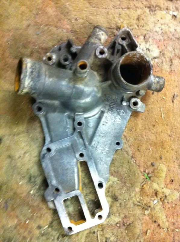

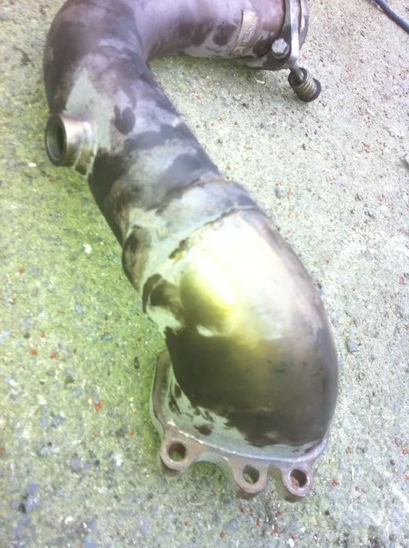

just a few bits ive picked up.. cheapo aftermarket water pump, came with an adapter for the outlet to screw in, almost removed the remains of the water pump bolts from the rear of the body, and began to clean it up.
http://i3.photobucket.com/albums/y98...k/IMG_0223.jpg
http://i3.photobucket.com/albums/y98...k/IMG_0222.jpg

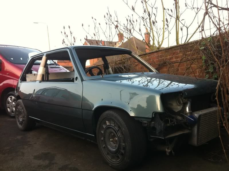

also grabbed a pic from last sunday night, this was the second time the car chucked the fan belt that night (alternator bush had gone), the first time it chucked it off at a less desirable place, needless to say i have 30 mins of conversations with coppers as they attempted to prove i was racing, even tried to give me a £30 fine for pushing the car onto the pavement, (sooner me repair it in the middle of the road).
http://i3.photobucket.com/albums/y98...IMG_0167-1.jpg

speant a bit of time tonight, removed the aux fuel tank and wont be refitting it.
http://i3.photobucket.com/albums/y98...k/IMG_0397.jpg
http://i3.photobucket.com/albums/y98...k/IMG_0398.jpg

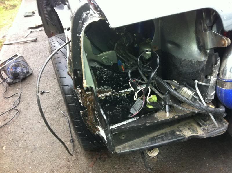

Ground back some of the rust to see the full extent, i think i now have a clear idea of how i will tackle this however i have somthing far more worrying.. this rot, caused from all the mud and crap stuck behind the filler neck, its very tight for access and im really not sure how to make a panel and weld iit in well up there.. Im half tempted to get it back to fresh metal, por 15 it, then do what i know how to do best and fibreglass it (matt/resin) , that way i can make the shape correct and i will be able to rust proof it well.. thinking this would probably be a better option than making a hash job of welding in a patch only for water to get back in at it.
http://i3.photobucket.com/albums/y98...k/IMG_0400.jpg
http://i3.photobucket.com/albums/y98...k/IMG_0401.jpg
http://i3.photobucket.com/albums/y98...k/IMG_0402.jpg
:crap: Good job you're keen mate, most people would of scrapped that shell by now! :agree:
lol i know dude, i think the fact im quite vigilant dosent help, if i see a bit of rust i will investigate it with a screwdriver, cant be living with that horrible crap metal attached to my minty paint.
I think a lot of the r5's out there are very rotton, its just that on most its either covered up or not noticied until its far to late.
hmm ive found this on the por 15 website
The fiberglass mat is used to span small rust holes that are too large for the putty but don't necessarily need welding. The hole is covered with the fiberglass mat, which is then soaked in POR 15 paint and allowed to dry. This transforms the flexible fiberglass into a rock-solid chunk of rust-proof flooring. This is a permanent repair, though it's not advisable to consider this a fix for those Fred Flintstone floorpans where there's more open air than sheetmetal; those are more often lost causes.
sounds very promising, so using the por15 as the resin itself rather than fibreglass resin, its an interesting theory but claims its a perm repair... I may have to try this.. 45 mins with the wire brush it is tonight then.. i have a feeling this stuff will work damn well for exactly what i need it for , and once covered in stone chip etc will look good as new.

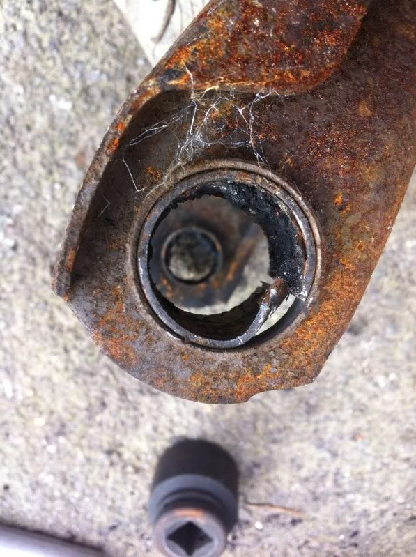

tonight i cut away the knacked old bumper mount, that had already been welded twice..
then i began lining up the panel made by ashy.. unfortunatly when the bracket was previously replaced the inner peice of steel was largely cut away and therefore it may be difficult to line up the centre holes onto it, however it dosent look far off there.
http://i3.photobucket.com/albums/y98...k/IMG_0407.jpg
http://i3.photobucket.com/albums/y98...k/IMG_0409.jpg
http://i3.photobucket.com/albums/y98...k/IMG_0408.jpg

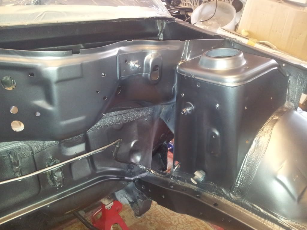

Well update..
I fitted the new bumper brackets, i started with the drivers which i struggled with , however after a bit of time i was solidly fitted..
then onto the passenger i blitzed it no proble,m, very easilly.. on the drivers i actually cut a little to high and have to glass it up slightly.
All the welding and repairs took the following order..
Zinc Etch, por 15, seamsealer, then strone chip...
My opinion on por 15... where you have loose rust/metal its brilliant, however dispite following the instructions on 100% fresh metal , i would avoid as its just so difficult to get it to chemically bond, instead id just stick to a good quality etch primer for this followed by a top coat.
Currently just waiting for seam sealer to set.. a few pics here

When you say the POR-15 wouldn't bond to bear metal.........are you sure the metal wasn't contaminated??
I only ask because when i painted my block, i used the marine clean, then metal ready as they advise....
But when i applied the first coat of Por-15 it didn't take! - So i stripped everything down again.......and PROPERLY!! cleaned and dried the block once more, applied the first coat again- hey presto:wasntme:
Don't get me wrong, you obviously know what your doing, but just bear it in mind - a surface that i originally thought was preped and contaminate free - just wasn't!!:mad::D
hehe cheers walace, ill be honest theres still areas (back of the inners sills) which need work, however to do them propelly would mean pulling the outers off etc and just simply will mean this car wont be out again this year, which id be pretty upset, so ive sorted the main areas, and this winter ill probably get it on some ramps and have a set of fresh inner sills and any other bad areas sorted.
As for the por 15, i dont think it was contamination, i feel more it was because the metal didnt have a key , was very shiny, where as a engine block is obviously cast so has a fair bit more to bite onto if you, It didnt stick etc, just not really aswell or anywhere near aswell as the rusted areas.

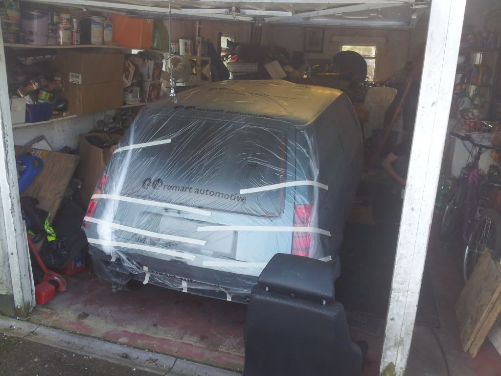

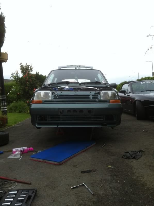

little update.. I purchased some new bits.
Fresh bottom end, new pistons, liners , oil pump, etc...
new indiactors , grill badges, leads, chrome brackets etc.
Finished stripping the car down and hooked it onto the Aframe to take to bodyshop. dosent it just look at state.
Oh also got hold of a fresh boot lid as mine was showing signs of rust.
Its been a very expensive past couple of weeks.
http://i3.photobucket.com/albums/y98...k/IMG_0525.jpg
http://i3.photobucket.com/albums/y98...k/IMG_0513.jpg
http://i3.photobucket.com/albums/y98...k/IMG_0512.jpg
and masked for storage
http://i3.photobucket.com/albums/y98...k/IMG_0514.jpg
http://i3.photobucket.com/albums/y98...k/IMG_0515.jpg
http://i3.photobucket.com/albums/y98...k/IMG_0511.jpg

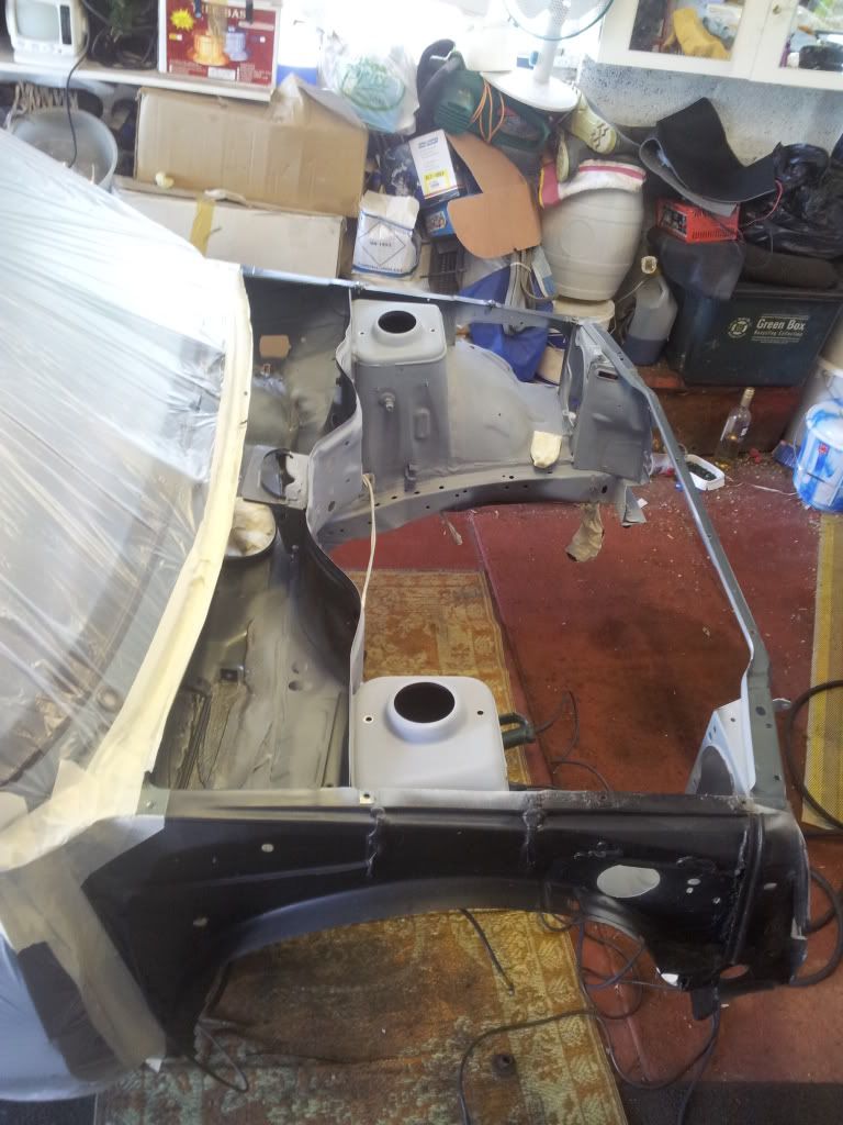

went down to the bodyshop today..
not started yet .. :dearme:

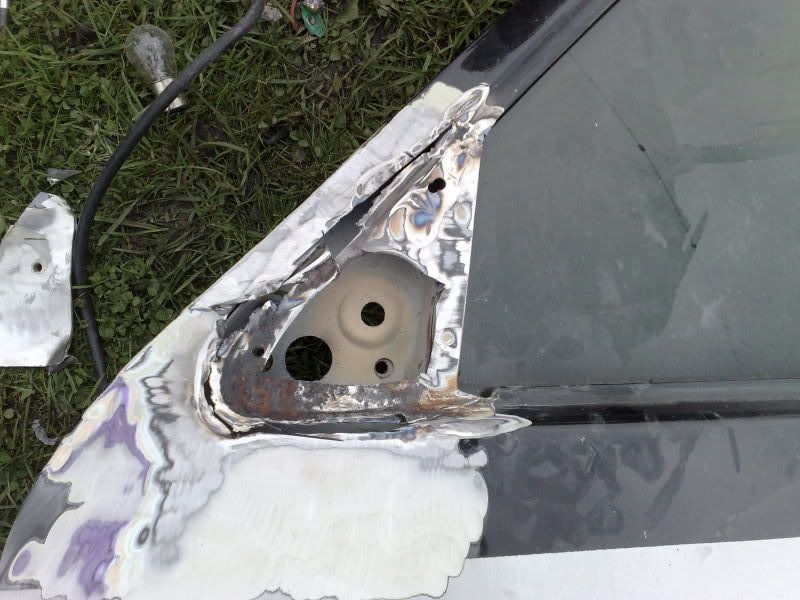

popped to the bodyshop on my way back from the dentist.. the screen has been removed and the filler and bodge around the screen ground back, a few holes but far better than i expected.. phew!
http://i3.photobucket.com/albums/y98...k/IMG_0679.jpg
http://i3.photobucket.com/albums/y98...k/IMG_0680.jpg
http://i3.photobucket.com/albums/y98...k/IMG_0681.jpg
Looking good :agree:
That's not too bad really, guessing mine will look like that, will you repair it or put a new panel in ?
Lewis
just goings to be welding a couple of bits in matey, defo not worth replacing the panel its actually pretty damn good :).. just want it back.

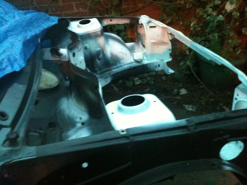

went to see the car yesterday, all the screens been welded up etc, door locks gone, he wasnt happy with the doors , so he took them all the way back to metal and started from the ground up with getting them straight, i told him previously how much i hated seeing ripply r5s considering they are weight boxey 80's spec cars.
Few pics but nothing to special
http://i3.photobucket.com/albums/y98...k/IMG_1178.jpg
http://i3.photobucket.com/albums/y98...k/IMG_1177.jpg
http://i3.photobucket.com/albums/y98...k/IMG_1175.jpg
http://i3.photobucket.com/albums/y98...k/IMG_1174.jpg

got quite an issue at min.
Retrim prices on just the rear bench to match the fronts are coming about between £500 and £650.
Im going to shop about a little more but i just cant help think its a bloody lot of wonga, but then again it would finish the car.
then this little devil sat on my shoulder keeps uttering about a pair of decent bucket seats and a harness, but im really just not sure.. grrr.
Any thoughts and opinions.
Buckets & harness's all the way :)
I know what you mean, just not sure if the car will look complete so to speak afterwards, im not really after the fastest car in the world, nor the meanest track car.. just after a complete all rounder if you catch my drift, although if i could make it look well and turely complete even with a pair of buckets i may be tempted.
Do you ever use the back seats? I know most people dont, i used to but doubt i will in the future (infact the red 5 is going to be stripped & caged)
£500 to have rear seats look the same is alot of money..... I would leave them till last, then decide on what you want... Buckets seam to hold there money atm, where as spending £500 on the rear bench to match will just cost you that... You wont get much of it back if you sold them or sold the car..
i was just about to ask if you actually get use out of the back seats but mr penfold beat me to it;)
if the answer is no then go for bucket seats etc :agree:
thinking im going to get EVERYthing , else done on the car, then look at the interior, its a difficult one.. although im good for buckets, its just hard a feel to make it looks correct and finished, which is really what im after with this car.
I know there is that one tungsten on on the other renault 5 forum who pulled it off really well.

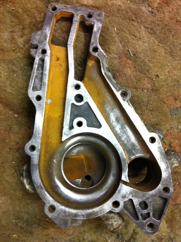

decided to crack on and get some stuff done i could do in the garage.
First off i wire brushed down the reverse side of my water pump (id purchased a new front), the front was no matter how much cleaning it undertook it was never going to look as fresh as the front.
With this in mind i sprayed both the halfs with Halfords VHT. It went on quite well but still rubbed off if u rubbed it hard enough after it cured.. I used a heatgun over the object quite close, usually paint would lift under this treatment. My conclusion is that the paint goes on almost like a powder and require the heating of the object to actually cure.
http://i3.photobucket.com/albums/y98...c/IMG_2363.jpg
http://i3.photobucket.com/albums/y98...c/IMG_2364.jpg
http://i3.photobucket.com/albums/y98...c/IMG_2367.jpg
I messed up the reverse side of the water pump , managed to clean the thread out but using the wrong tap!.. doh..
So had to do another one, also degreased the inlet and a few other bits and started giving them a paint up so its nice and fresh, think im going to grab some vht lacquer as im finding halfords vht paint always seems to scratch of, its stays almost like a powder, strange.
http://i3.photobucket.com/albums/y98...c/IMG_2384.jpg
http://i3.photobucket.com/albums/y98...c/IMG_2382.jpg

Also etch primed a few bits to go black, these will get a gloss black coat followed by some clear coat.
http://i3.photobucket.com/albums/y98...c/IMG_2393.jpg
Also popped to the bodyshop, he noticed a tiny ripple in my door when flatting so he put some more filler in , however hes also put sound deadening in to try to strenghten it for when hes sanding to get it 100% flat.. mmmm
http://i3.photobucket.com/albums/y98...c/IMG_2390.jpg
http://i3.photobucket.com/albums/y98...c/IMG_2391.jpg

finished the inlet, you may notice i have removed some brackets, as hopefull with my water and breather setup i wont require these , leaving a cleaner engine bay.
This is the intended appearance im after on the majority of the build, o/e looking with easy to clean being that its lacquer, also stainless steel fixings where possible.
http://i3.photobucket.com/albums/y98...c/IMG_2431.jpg

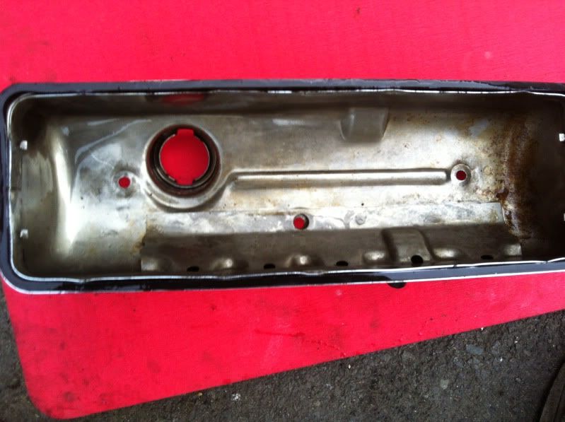

finally managed to source an head with plenty of meat on it so i stripped it down, ran a tap down all the threads to check there clean, stripped it down, gave it a good degreaseing and im currently putting it back together with some fresh stem seals, the valve seats all look in very good condition so a quick valve lap and jobs a gudden.
I plan to mask up the head and give it a coat of vht silver and clear coat.. I know i could clean it however being clearcoated will make it far easier to keep clean.
http://i3.photobucket.com/albums/y98...c/IMG_2479.jpg
http://i3.photobucket.com/albums/y98...c/IMG_2482.jpg
http://i3.photobucket.com/albums/y98...c/IMG_2483.jpg
and done.. pleaes note this isnt the rocker cover that will be one, however my chrome one is currently still on the car at the bodyshop.
http://i3.photobucket.com/albums/y98...IMG_2493-1.jpg
http://i3.photobucket.com/albums/y98...IMG_2491-1.jpg
http://i3.photobucket.com/albums/y98...IMG_2490-1.jpg

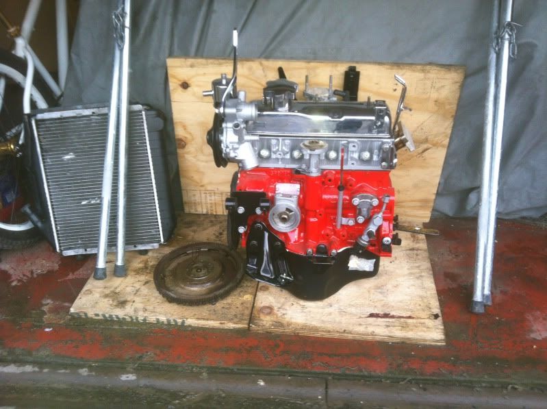

decided to fit the head to the engine yesterday, removed the masking that that id fitted to stop crap getting in it, and it had left a right sticky mess, going to guess it somehow mixed with the assembly lube etc..
Anyway with that all cleaned off.
http://i3.photobucket.com/albums/y98...c/IMG_2505.jpg
The head went on.
http://i3.photobucket.com/albums/y98...c/IMG_2508.jpg
Also ordered some nor por15 products, these products so far for me have worked beyond belief and in my opinion offer a BETTER soloution to powder coating, purely because the finish is just as hard and strong as powdercoat , however you dont have to reply on the numpty spraying it to do a good job and not leave edges that seem to be prone to chipping away. Saying that im yet to try either of these products from the range but i will report back.
http://i3.photobucket.com/albums/y98...c/IMG_2503.jpg

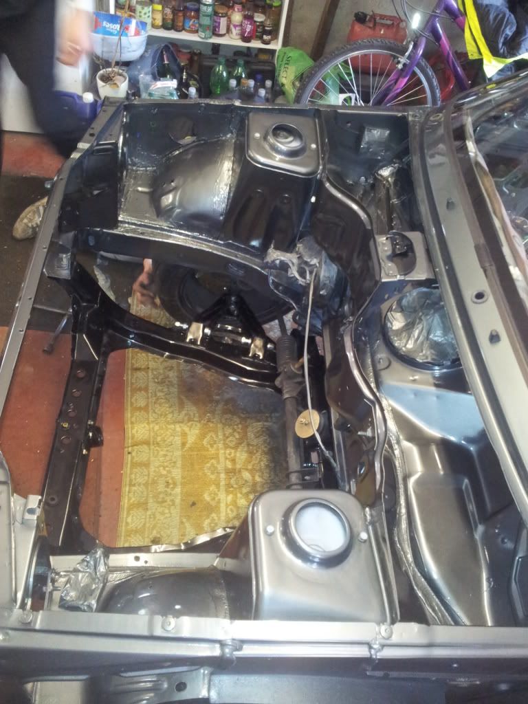

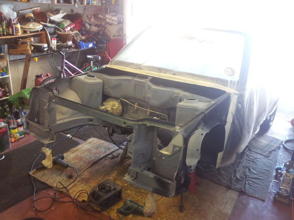

No rest for the wkd and all that i missioned on.
Degreased all the box using the POR 15 Marine Clean
http://i3.photobucket.com/albums/y98...c/IMG_2517.jpg
Then applied the Metal Ready, this is basically a spray that you allow to etch into the product, now the insructions say to put them on , then wash off... however i spoke to a guy at frost who seemed to really know what he was on about and he said dont wash it offer as it will give it far better adhesion...
Nervous i took his work for it.. here you can see the etch working.
http://i3.photobucket.com/albums/y98...c/IMG_2518.jpg
I applied the first coat after giving the pot a good STIR (important not to shake), this paint is silly silly thick its scary.
http://i3.photobucket.com/albums/y98...c/IMG_2519.jpg
sources on the net say it brush strokes dissapear.
I really do hope so as this looks terrible.
http://i3.photobucket.com/albums/y98...c/IMG_2521.jpg
I have confidence in these products though.
I got bored so gave my oil catch tank a lick of paint.
http://i3.photobucket.com/albums/y98...c/IMG_2560.jpghttp://i3.photobucket.com/albums/y98...c/IMG_2561.jpghttp://i3.photobucket.com/albums/y98...c/IMG_2562.jpghttp://i3.photobucket.com/albums/y98...c/IMG_2563.jpg
gearbox is also finished, the finish i would give 8/10, its definatly not as good as the por in black, i put it down to the pigment in the silver seperating, kinda hard to explain but lets say you get a run, they are very noticable because the black sort of seperates from the silver, also its a very matt finish with no gloss at all, i guess thats to resemble a cast alloy though so can be forgiven.. however the finish is rock hard and i certainly not see it flaking off.
http://i3.photobucket.com/albums/y98...c/IMG_2564.jpg

I had a strutbrace that had seen better days, and also had some large chips missing, i spoke to dave about welding some metal in to grind down and polish, he explained that welding the metal in wasnt an issue however before polishing it needed dipping to remove the anodised coating..
I felt i had done enough polish for a while with my wheels, and dave offered to sort the lot out for me, i took him up on the offer and im delighted.. , unfortunatly i have no before pics but..
http://i3.photobucket.com/albums/y98...c/DSC_0350.jpg
http://i3.photobucket.com/albums/y98...c/DSC_0349.jpghttp://i3.photobucket.com/albums/y98...c/DSC_0347.jpg
hopefully some nice stainless bolts and washer will hide the bits of damage where they clamed down.

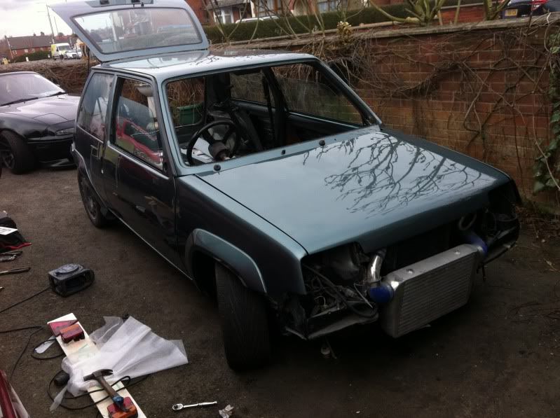

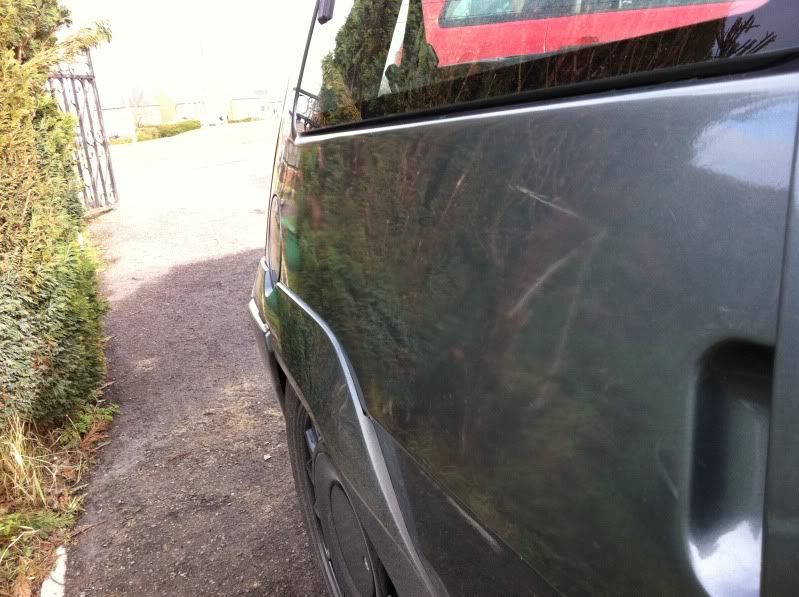

as she stands at the moment, wings off ready for engine out job.
http://i3.photobucket.com/albums/y98...s/IMG_3443.jpg
Gutted though as noticed this, no idea at all when and how it happened, but theres a right chip out the paint, and unfrotunatly andy its more towards the top :(, going to leave it until the whole cars done and have to get it repainted..
http://i3.photobucket.com/albums/y98...s/IMG_3444.jpg
http://i3.photobucket.com/albums/y98...s/IMG_3445.jpg

stripped subframe down today ready for powder coaters, and burnt out the bushes.
http://i3.photobucket.com/albums/y98...c/IMG_3497.jpg
As its raining and my arms ****ed (not sure what ive done exactly) , i just began degrease a few bufty bits outa the bay.
http://i3.photobucket.com/albums/y98...e/IMG_3502.jpg

Looks good, but get that fibreglass bridge filler removed from the front bumper mount area and weld the hole up with an insert! The cars looking good mate - keep up the good work!;)
Alastair
funny you say that as i did that exact bit of welding last night, although the hole was a bit bigger by the time i had done, couple of bits of plate and its mostly there..

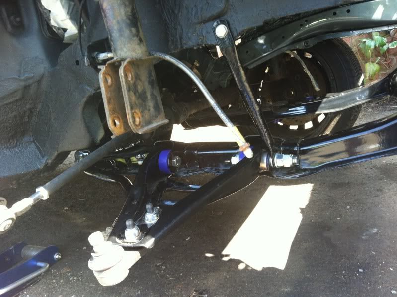

recieved all my subframe etc back from the coaters.. currently however i do not have a phone so photos are difficult.. but... heres a few .

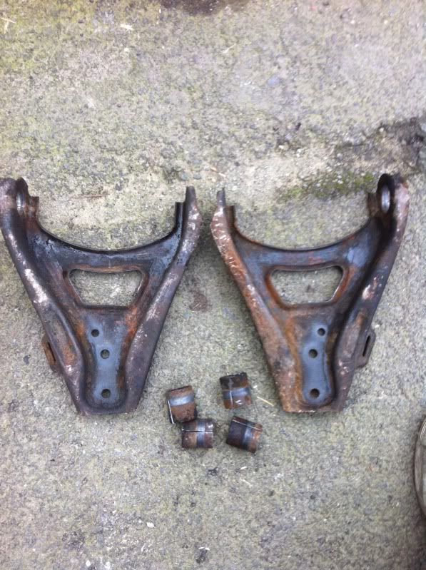

Got my wishbones, and some new Powerflex bushes.. with the help of skid and his vice we got them fitted.
http://i3.photobucket.com/albums/y98...r/IMG_0148.jpg
http://i3.photobucket.com/albums/y98...r/IMG_0146.jpg
http://i3.photobucket.com/albums/y98...r/IMG_0147.jpg
http://i3.photobucket.com/albums/y98...r/IMG_0152.jpg
colour coded bushes to my hoody ;)
http://i3.photobucket.com/albums/y98...r/IMG_0151.jpg

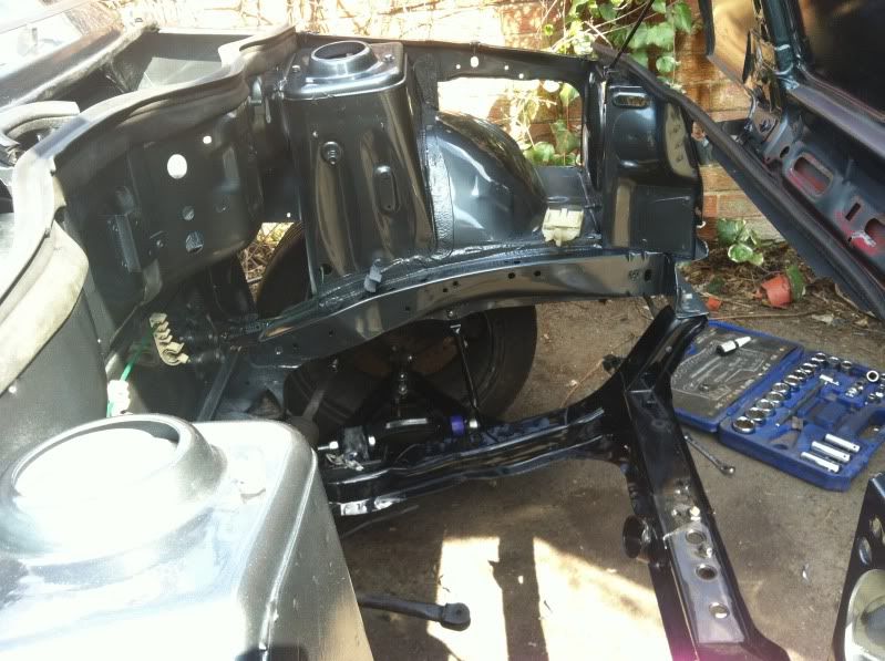

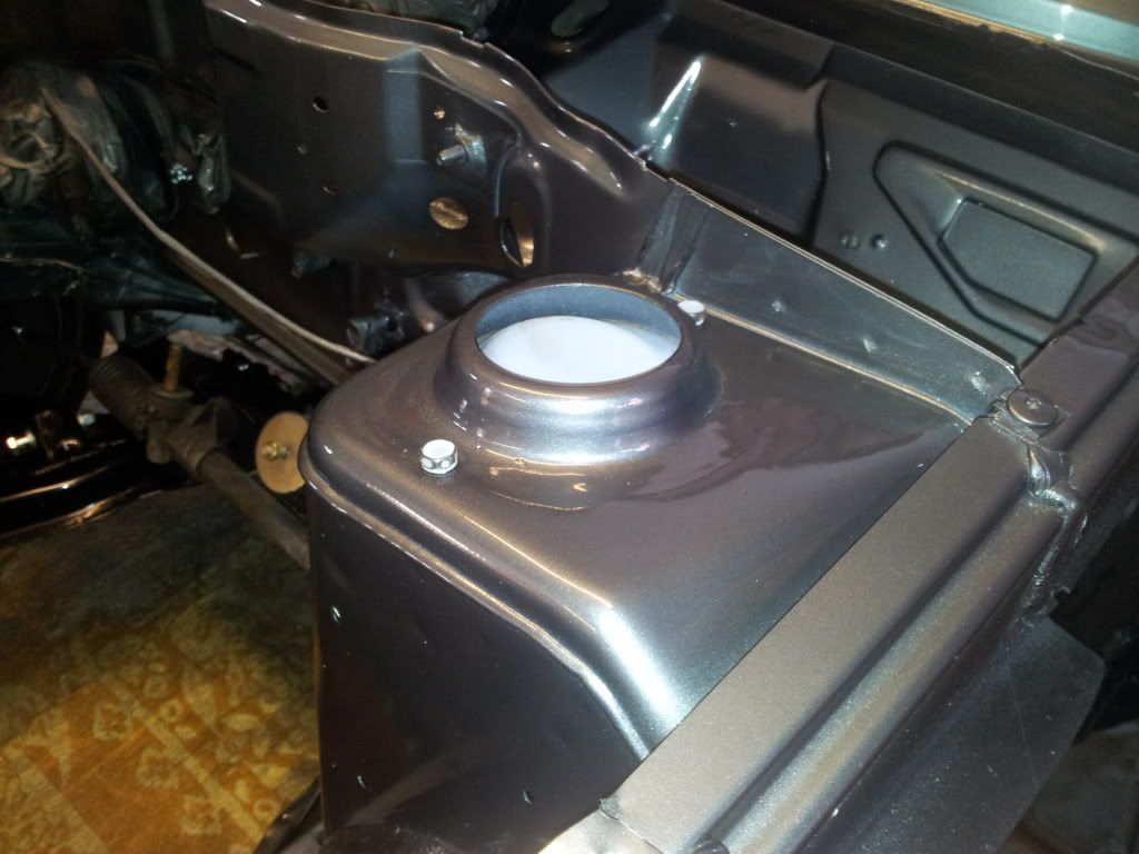

Masked etch primed & primed the bay, tonight i will flat the bay back and aim to get subframe, hubs suspension and wheels fitted so its just above movable into the gargage fro friday when it will hopefully see paint.
http://i3.photobucket.com/albums/y98...r/IMG_1031.jpg
http://i3.photobucket.com/albums/y98...r/IMG_1028.jpg
http://i3.photobucket.com/albums/y98...r/IMG_1027.jpg

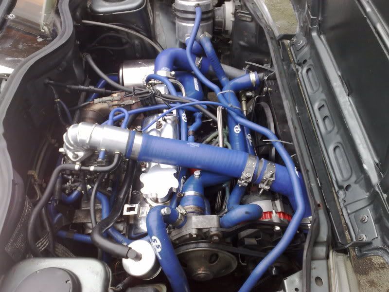

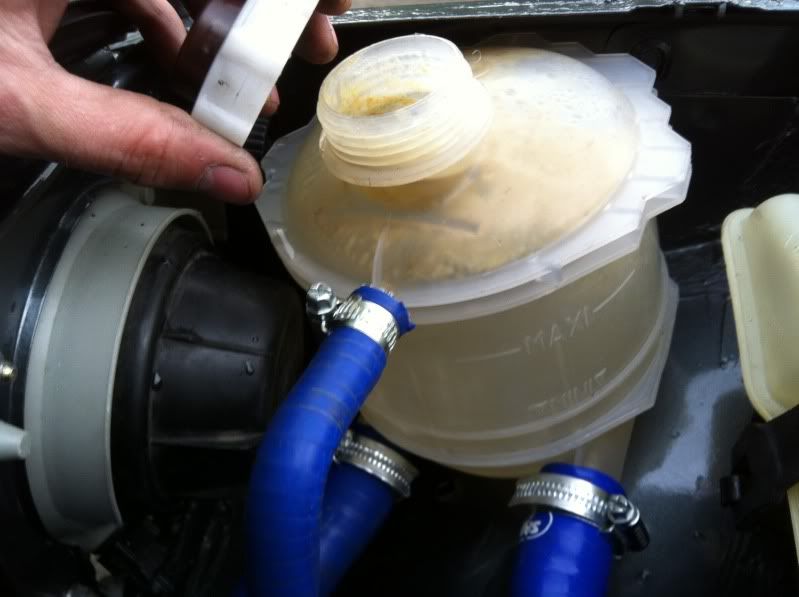

Well , i got the coolant circuit (modified) , and the carb/fuel lines and vacume lines all fitted up, I ordered lots of oil from halfords (gbox holds 3.4litres!!).. I primed the lump got it all turning over.. and then eventually fired it .. and she runs :)..
http://i3.photobucket.com/albums/y98...r/IMG_3872.jpg
http://i3.photobucket.com/albums/y98...r/IMG_3857.jpg
http://i3.photobucket.com/albums/y98...r/IMG_3854.jpg
however....
5 mins on idle as we have.
http://i3.photobucket.com/albums/y98...r/IMG_3873.jpg
http://i3.photobucket.com/albums/y98...r/IMG_3874.jpg
http://i3.photobucket.com/albums/y98...r/IMG_3875.jpg
http://i3.photobucket.com/albums/y98...r/IMG_3876.jpg
http://i3.photobucket.com/albums/y98...r/IMG_3879.jpg
http://i3.photobucket.com/albums/y98...r/IMG_3877.jpg
to sum up.. oil in header tank but no where else.
After brief discussion it could be residue in the lines etc.
it could be a cracked coil in the rad (as they also cool the oil),
or it could maybe be a potential cracked head ( however the head comes from a good source so id be surprised).
Ive cleaned out the header tank and will run it back up tonight to see if it happens again and if so how badly.
Well good news.. Swapped the rad and the oil issue seems to have gone away :),
Also adjusted the tappets from 0.20 - .0.25 to 0.15 / 0.20 and the results below.

Also as we had good weather last night i got the gauges all wired up , , the breather setup finished, and even chucked the strutbrace on , courtesy of dave richard.
http://i3.photobucket.com/albums/y98...r/IMG_3918.jpg
http://i3.photobucket.com/albums/y98...r/IMG_3924.jpg

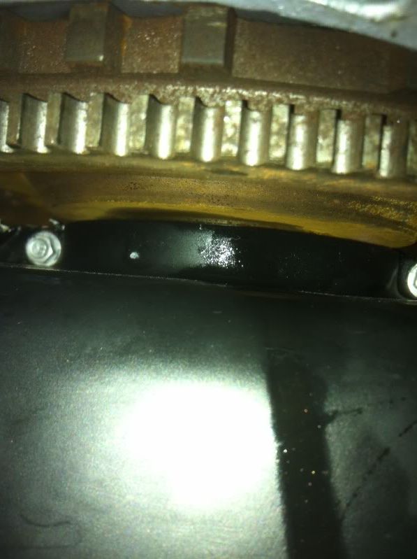

However.. issue..
Leaking oil from between the gearbox and the engine
Worst case crank seal.. engine out.. gearbox off
Best case leaking sump.. still not a nice job at all.. worst part is im gona have to drive it to bed in the rings before i can sort it.. As soon as i know more i will be letting the company that built the engine know about it.
Got lots done on the r5 today, however spotted an oil leak between the gearbox and the engine .. gona guess either the sump half moons or at worst the crank seal..
grabbed a quick pic also
http://i3.photobucket.com/albums/y98...IMG_3962-1.jpg
http://i3.photobucket.com/albums/y98...r/IMG_3966.jpg
http://i3.photobucket.com/albums/y98...r/IMG_3967.jpg
http://i3.photobucket.com/albums/y98...r/IMG_3968.jpg
Will see if it cures the oil leak, if not then its crank, which means ill be hauling the whole engine back out ! again.
Decided since i had to take the sump off ill at least make it worthwhile and fit my baffled sump back on.
http://i3.photobucket.com/albums/y98...r/IMG_3977.jpg
theres now no signs of oil ... yet, and the car has a fresh 12 months mot :)
