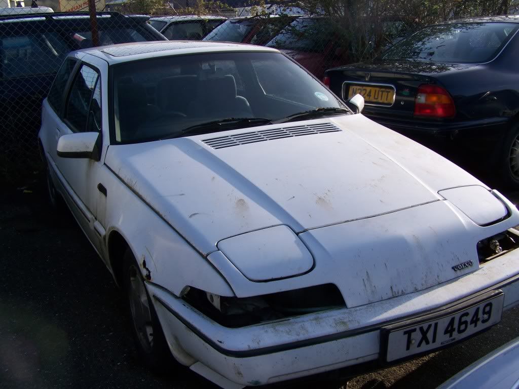

Managed to buy a whole volvo 480 turbo for £10, which then gave me a idea of putting it into a clio, then week later i got offered a standard mk2 on a s plate for £200 with a popped lump. Perfect for my volvo lump to sit it..
Been on the project now for a few weeks, got the volvo lump out and cleaned off, also got the clio engine out now aswell but worried if the volvo lump will fit the mk2 clio like it does in the mk1 clios .
Apparantly it's fit like for like into a mk1 clio, just using the rsi drivers engine mount?
Can any one deffo confirm that the volvo lump will fit the mk2 clio's ? Buggered if it don't lol...
Heres a few pics of progress

Donar car

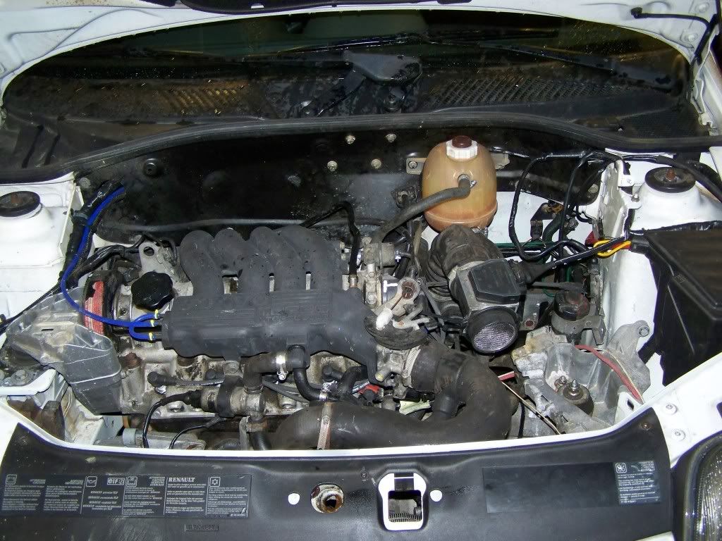

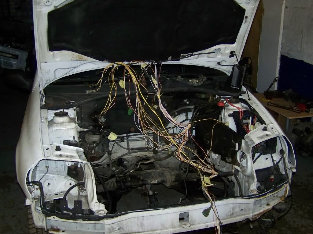

Loom out and finished
http://i168.photobucket.com/albums/u...i/100_0886.jpg

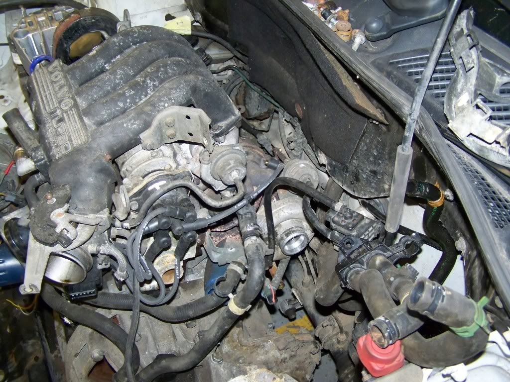

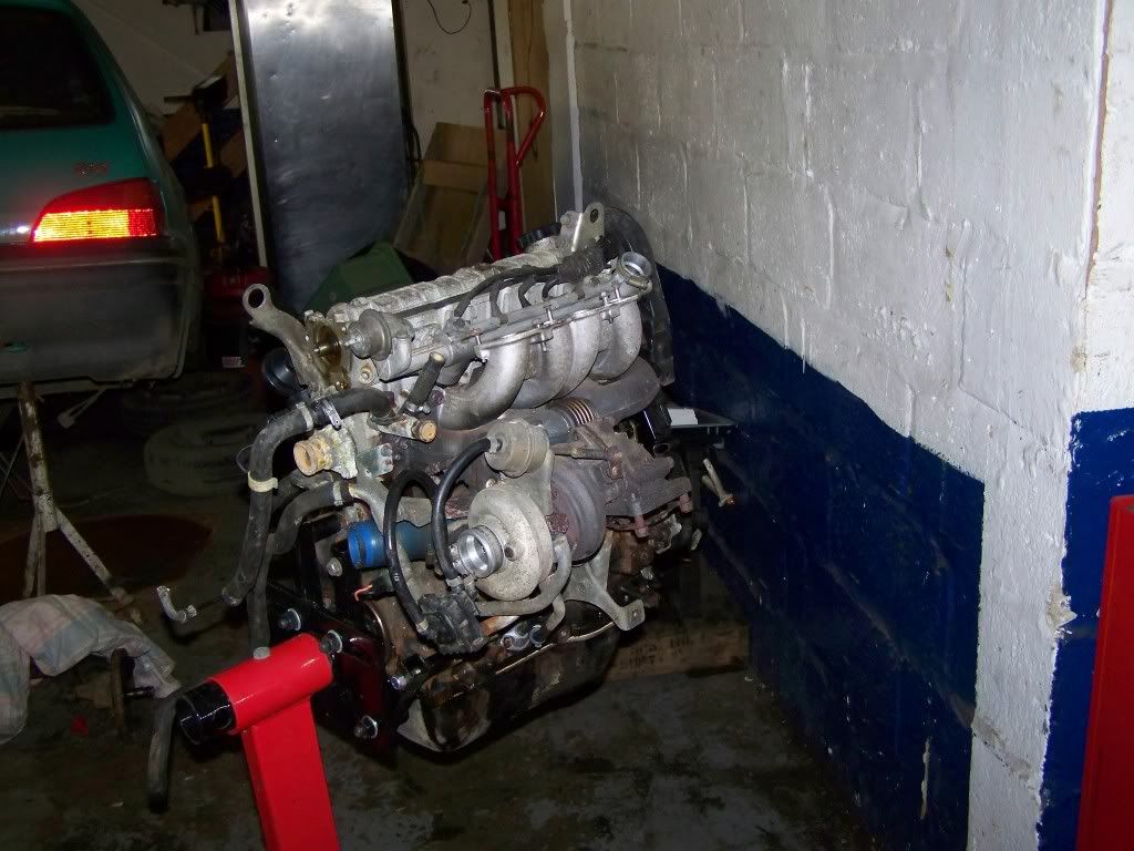

Engine out

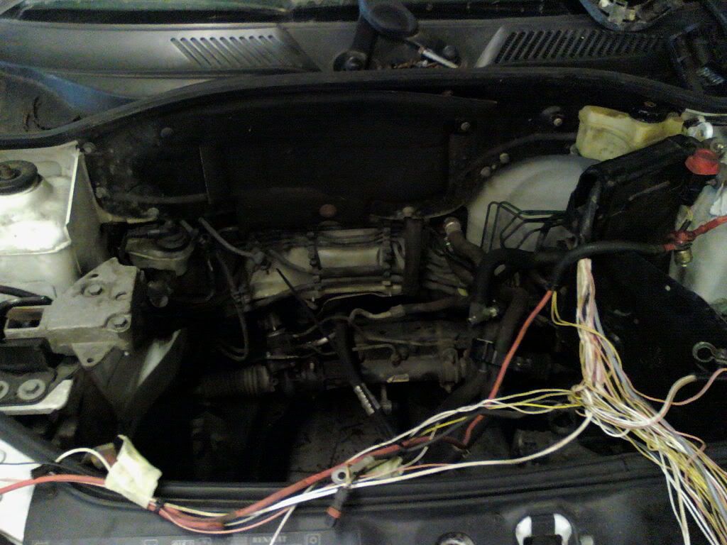

http://i168.photobucket.com/albums/u...i/100_0898.jpg

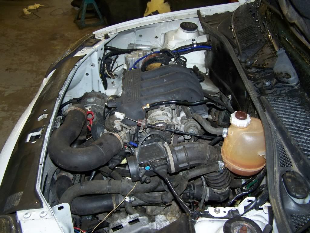

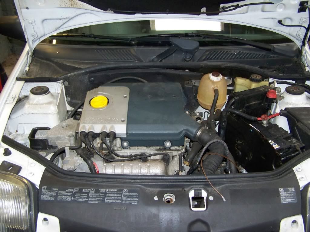

Standard clio bay

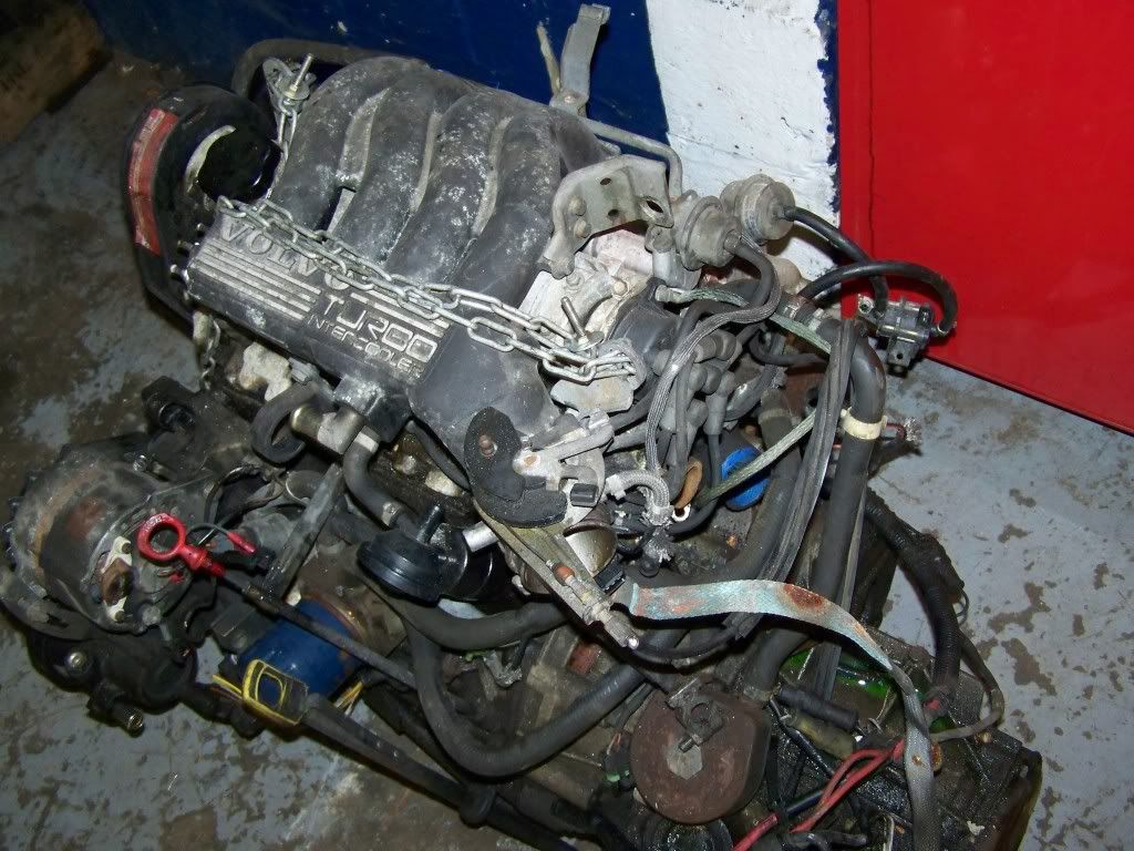

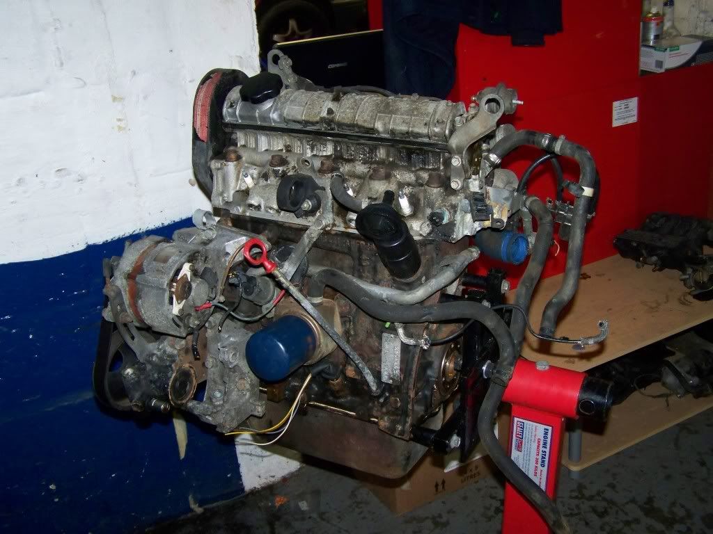

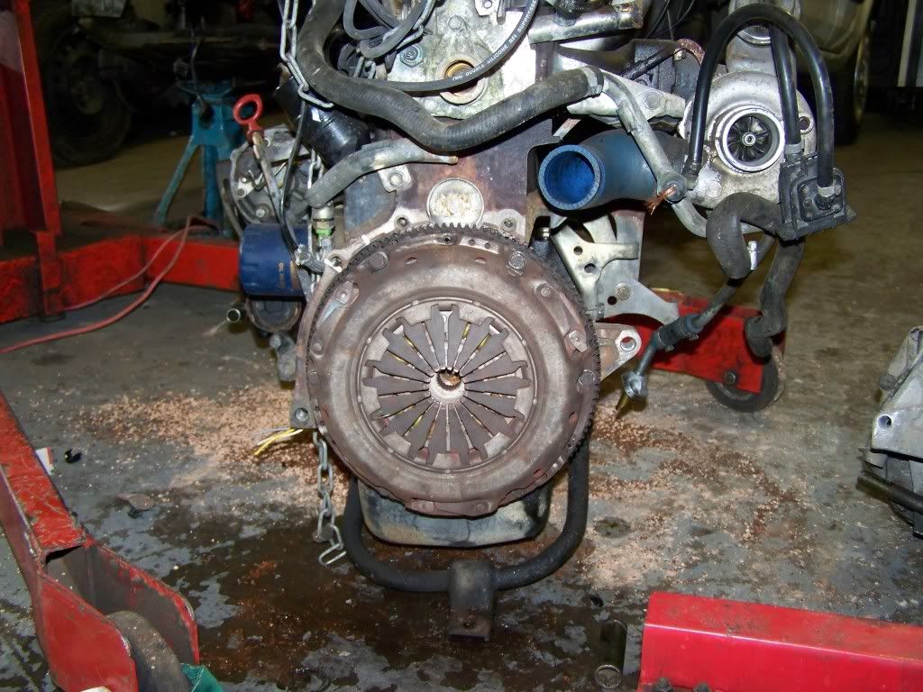

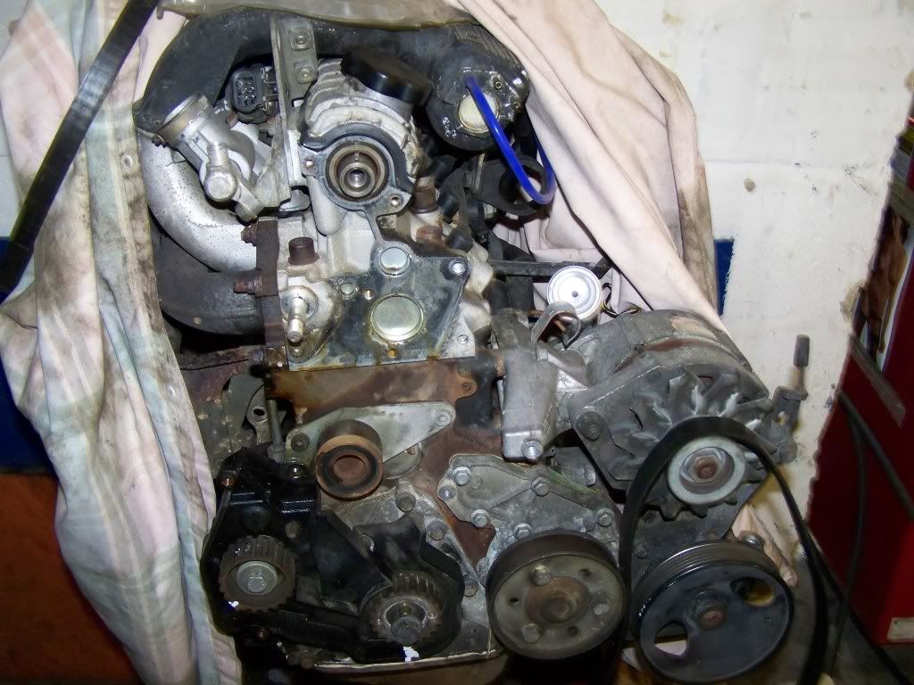

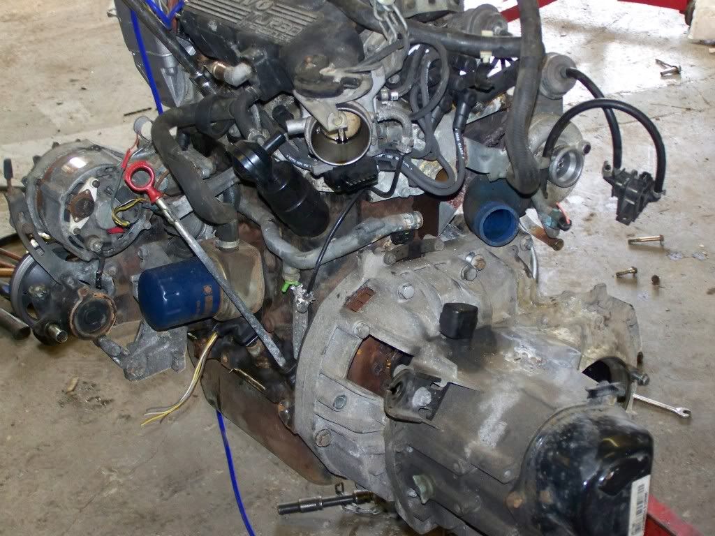

Engine cleaned off and on stand

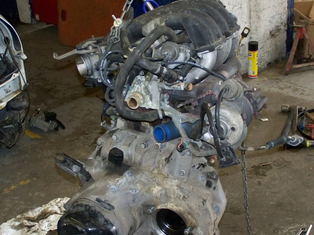

Rear of engine

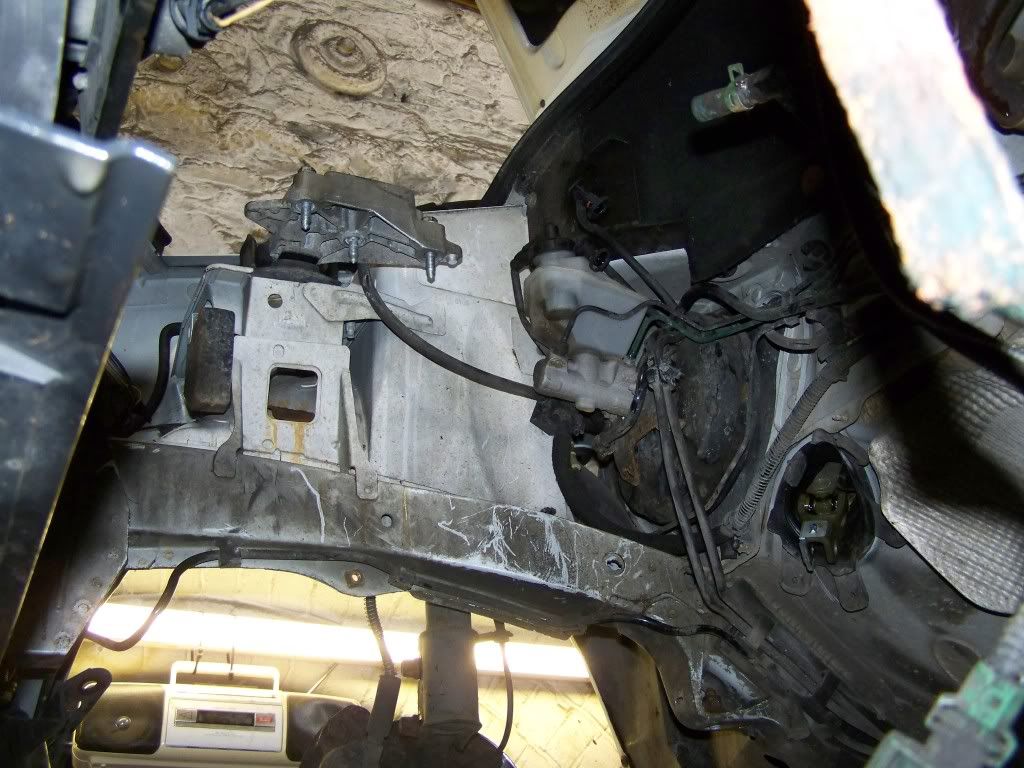

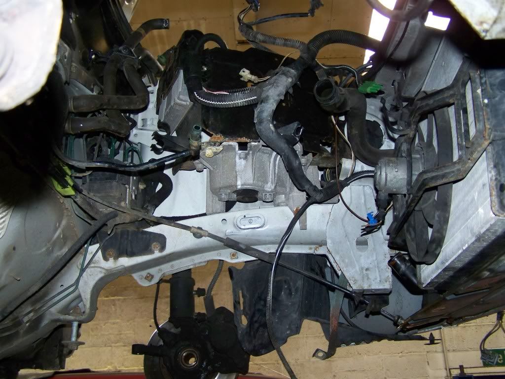

Stripped out clio bay ready for cleaning and lump fitted

The engine doesent mount on the sub frame any where, just a stabaliser mounting at the back of the engine i beleave i need a Rsi clio top drivers mounting which basicly goes over the cambelt cover and the mount bolts to that then on to the car..
Gear box mount sits under the battery tray and if i use a renault gear box all mounts will be the same, and finaly there is the back support which bolts on to the gear box and its like a support to stop the gear box and engine tilting back but i can't see that being a problem either if i use the renault gear box...

Talking of which, trying to work out which one to use my 1.4 box is no good it's far to weak to have turbo power running through it, it would explode.
I was thinking clio rsi, or a 16 valver one.. Beleave some one said a 172 box will fit aswell..
But it must line up on the mounts, one on top of the box and the dog bone mount which joins the box to the frame.. Looks like in ur dialogys pic that the 172 has that front mount aswell, Would that mean drilling the frame to take that mounting if i used the 172 box...

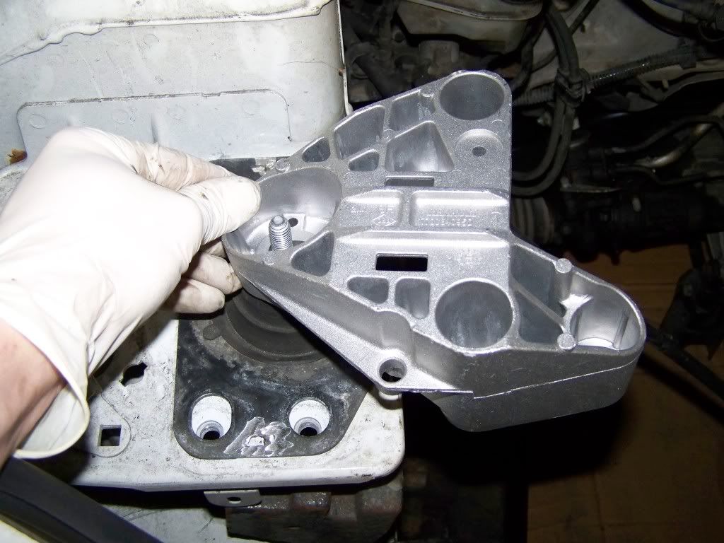

3 Attachment(s)
Re: Volvo Turbo Powered Mk2 Clio
some mount pics:
mount on it's own
hole in the 172 subframe
mount sat in place

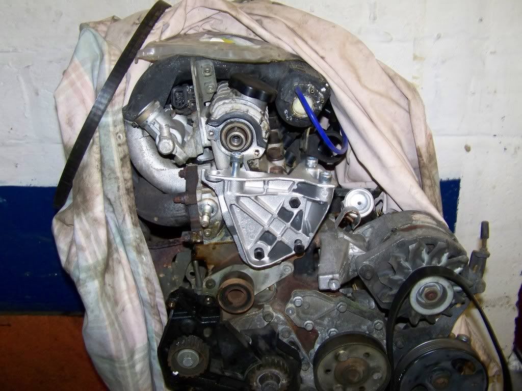

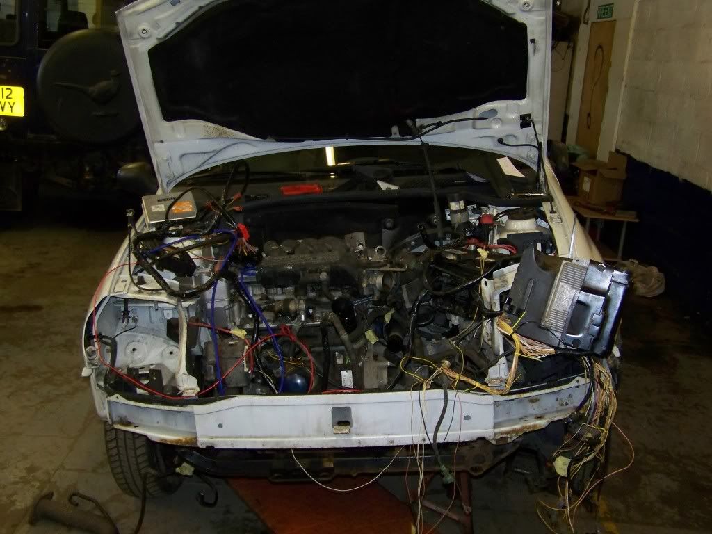

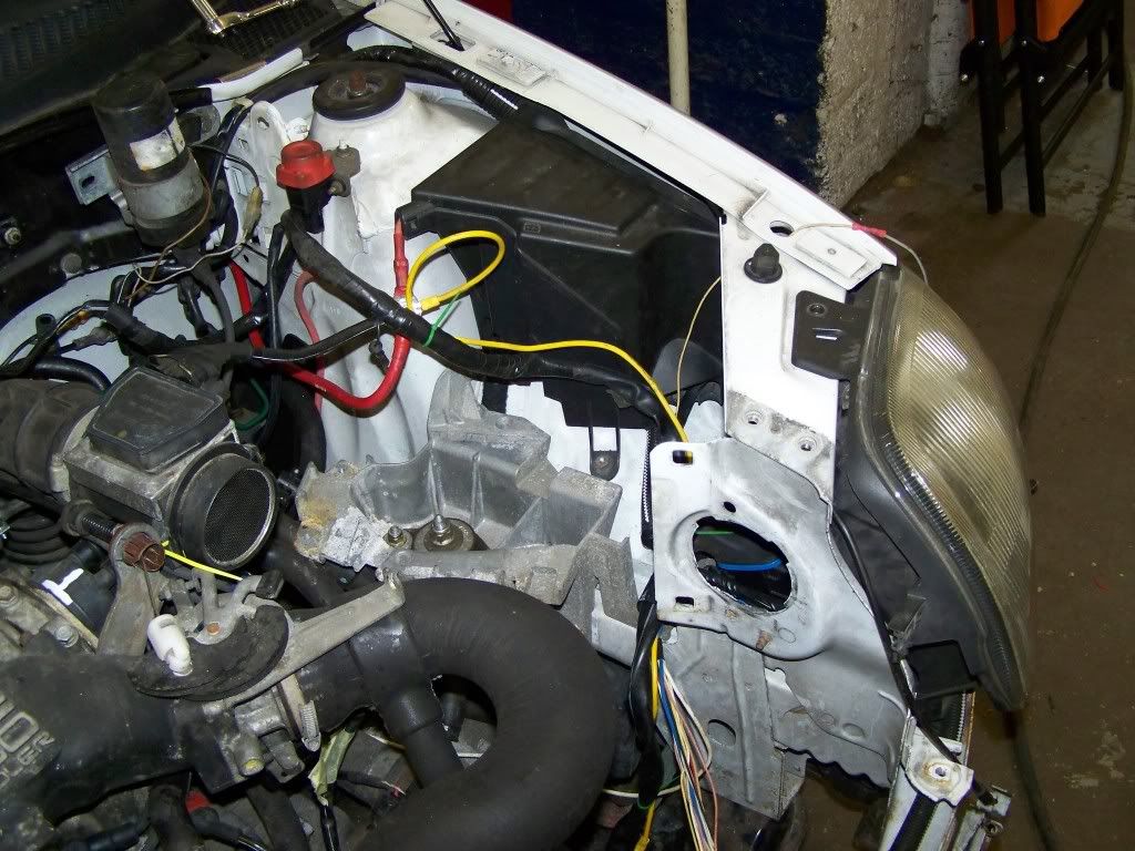

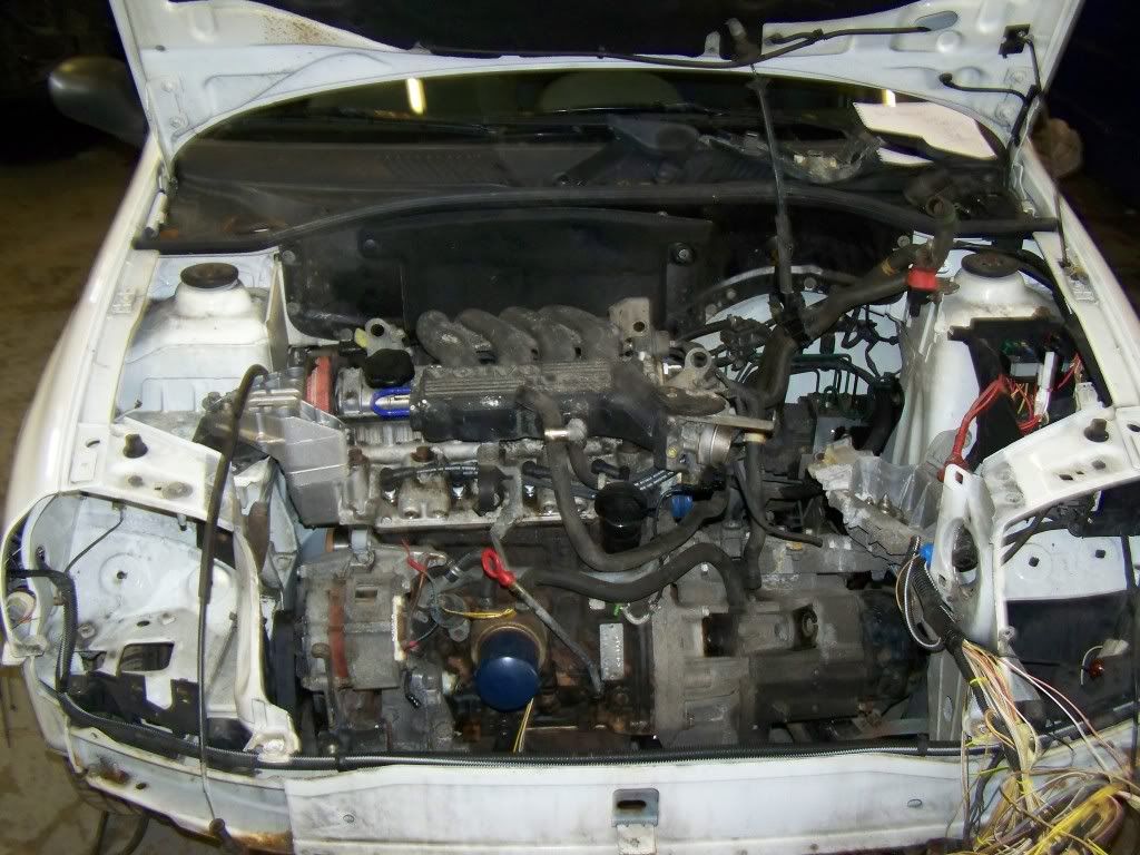

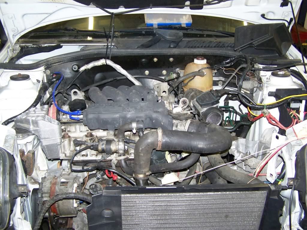

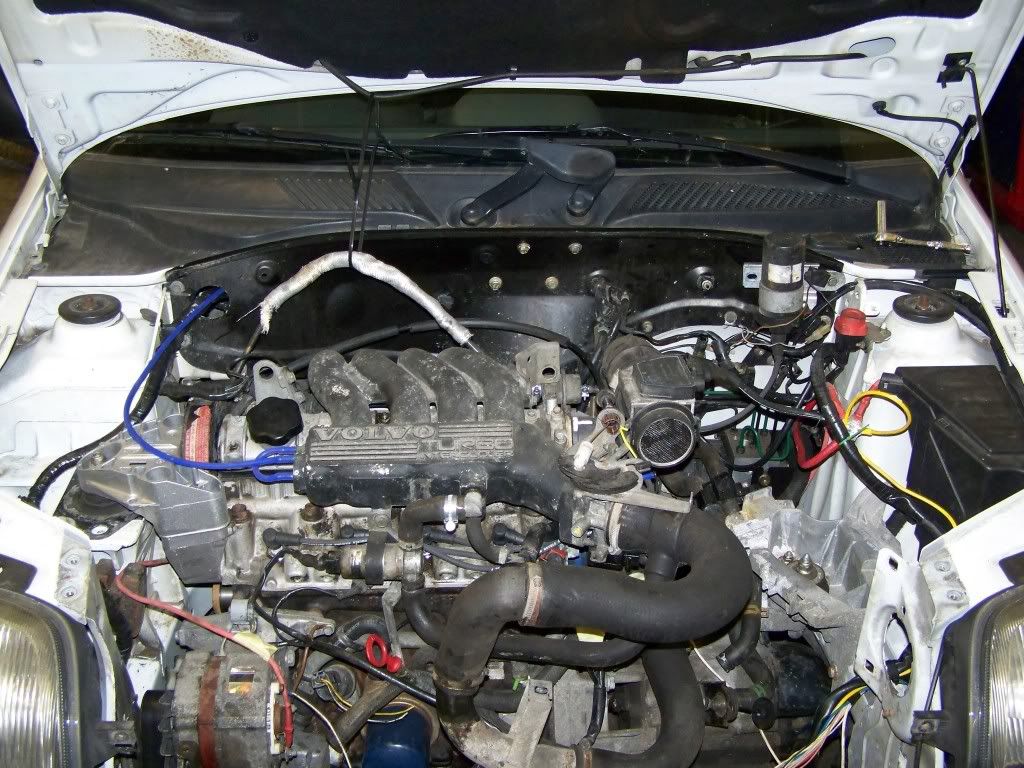

Finaly a day of progress..
Got my mounts ordered today, one top mount from ebay for £28.99 and the head mount from renault direct which was £44, not to bad really plus these mounts are the only thing holding me up so now i can mount the engine and see how it lines up...
Becasue im missing a strong gear box and clutch and fly wheel im going to wack the auto flywheel back on and bolt my 1.4 box to it, i know i wont have gears and i wont even bother fitting the drive shafts or subframe. I just want the engine on it's two mounts so i can sort out the wiring once and for all ( still working with diagrams but pretty sure ive cracked it) i wanna hear it run and tidy loom up, then ill rip it back out and prob rebuild the engine with new shells and rings, head gasket etc etc...
Fitted new leads and plugs as old one's where shot to bits..
http://i168.photobucket.com/albums/u...420_171619.jpg

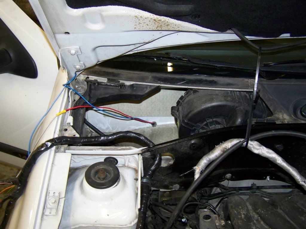

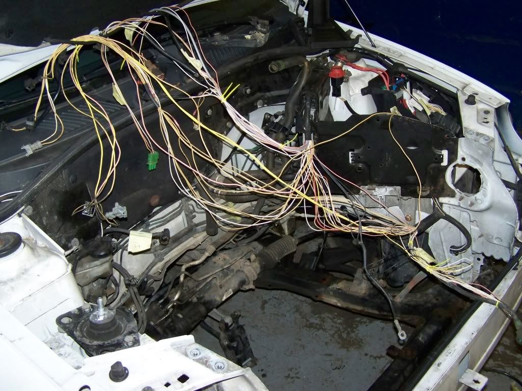

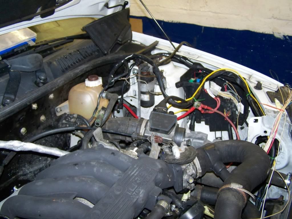

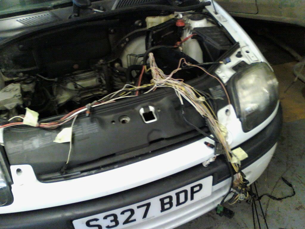

And i started to strip back the renault wiring loom, keeping to one side the wires i need, and to the other side is all the stuff left to be coiled up and put out the way
http://i168.photobucket.com/albums/u...420_171634.jpg
http://i168.photobucket.com/albums/u...420_171654.jpg
Sorry about photo quality compared to other i forgot me camera and had to use me phone...
Comments and ideas welcome chaps.... :coffee:

I got the 1.4 box off the clio today and every thing lines up against the volvo engine same bolt holes etc...
Andrew - would that 1.4 rt box take the stick of a standard volvo turbo, volvo prob has 40 bhp more and alot more torque..
But if it would do untill i get a proper one sorted then i'd be happy.....
run it for a while, there are no guarantees with any of these boxes, I've run ones from scrapyards with no problems, and spent a fortune on fancy stuff to destroy it in 10 miles.

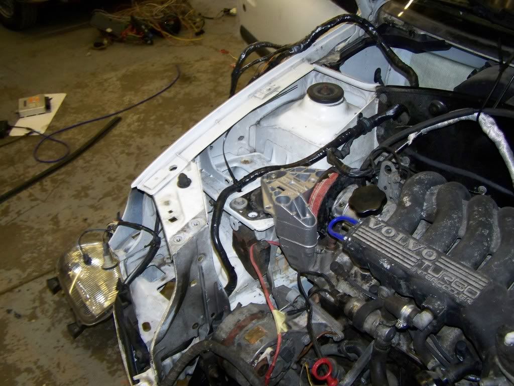

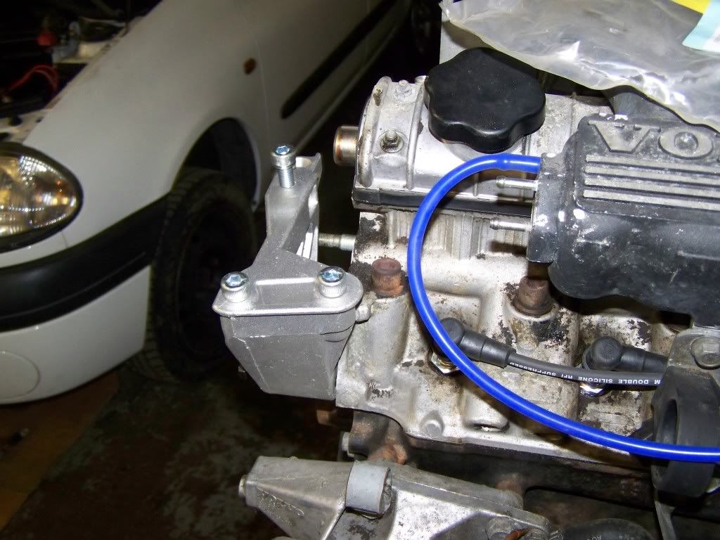

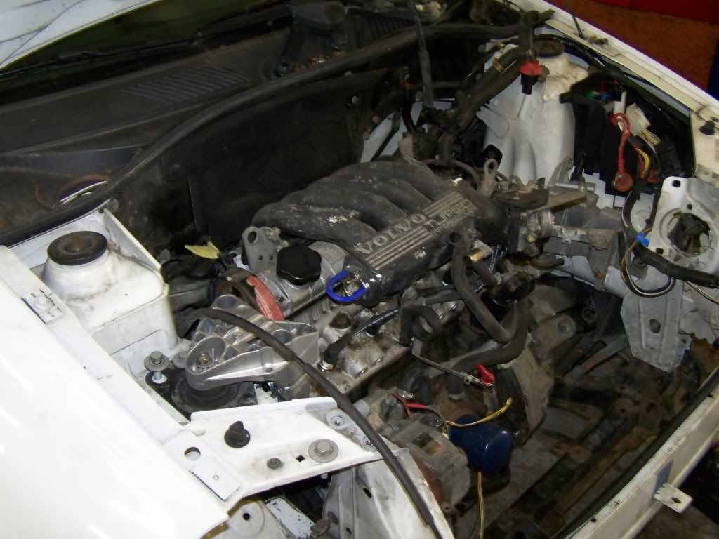

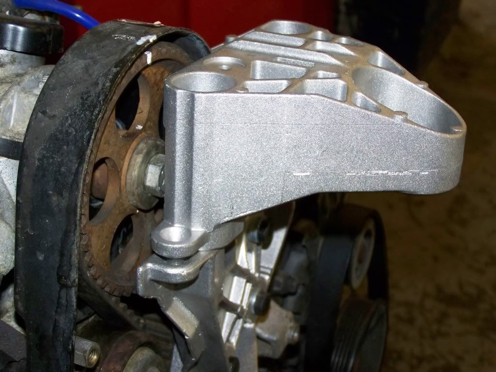

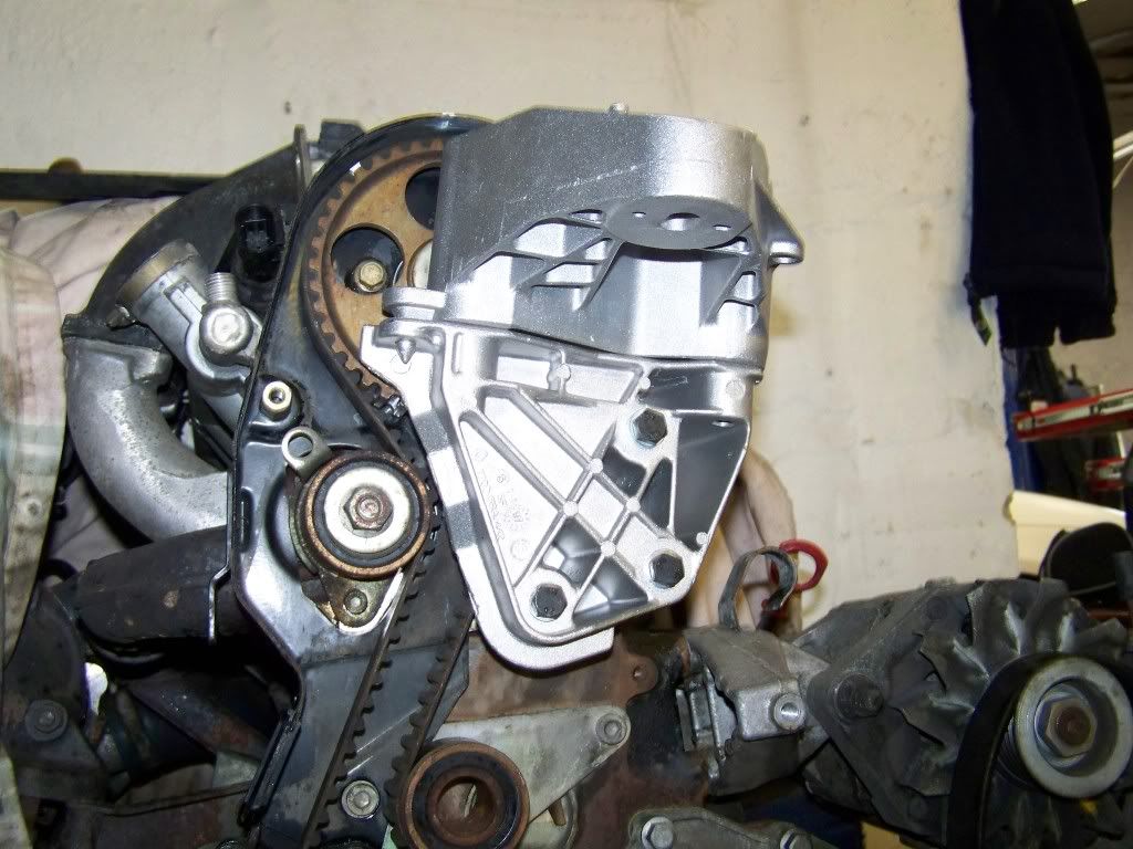

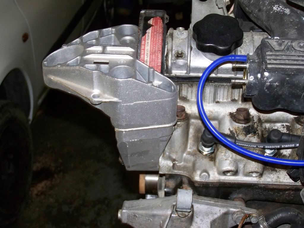

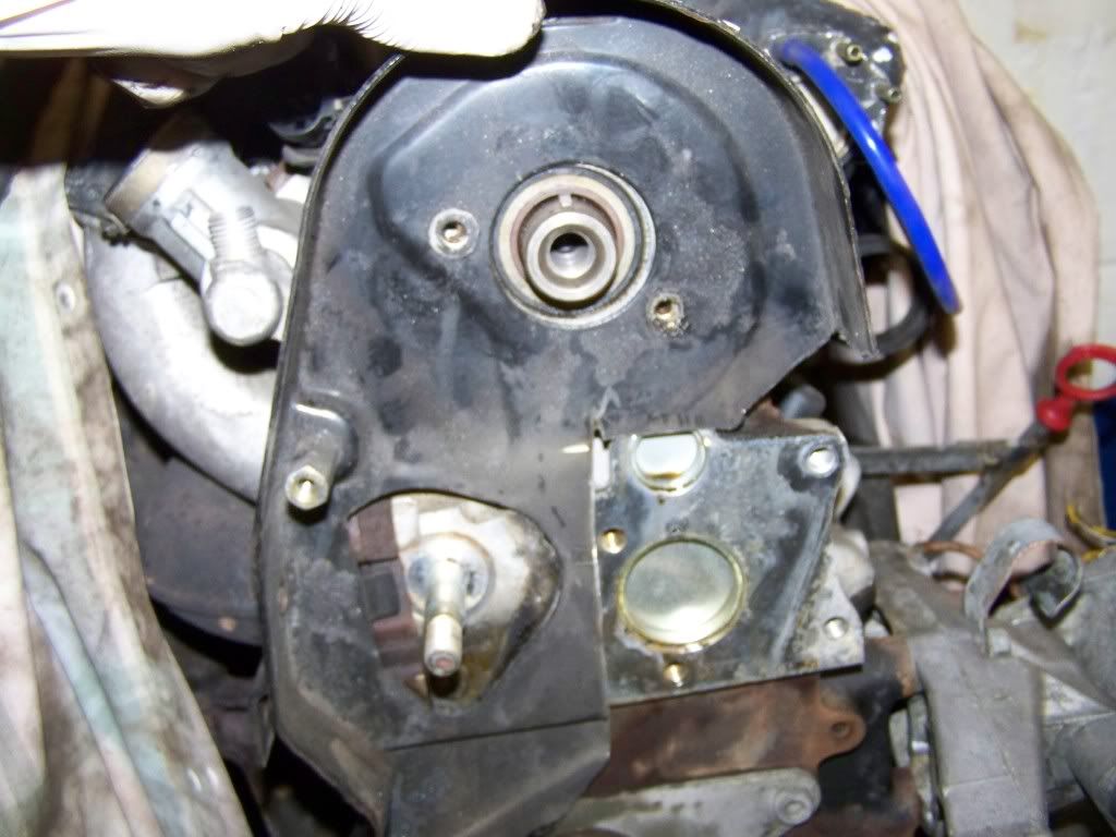

Well after alot of thinking, sleeping, measuring and a closer look at the mk1 clio I'm going to stick with my original plans and keep this mk2, it's newer and cleaner than the mk1 and like some one else said MAKE IT FIT lol...
Lot's and lot's of progress today, both mounts turned up from renault today and ANDREW thanks alot for those epc pages helped out no end when i was on the phone to them...
Removed the cam belt, tensioners and metal cam belt cover (inner one) and luckly i had 3 holes in behind my cover ready to take the rsi mounting i was told that some only had 2 so i was well pleased..:wasntme:
http://i168.photobucket.com/albums/u...i/100_0909.jpg
I shot of to a nut and bolt war house at lunce time and bought some proper bolts for the mounts, got 3 m10 8 mm head allen bolts for the top mount, and 3 high tensile bolts to hold it all to the head..

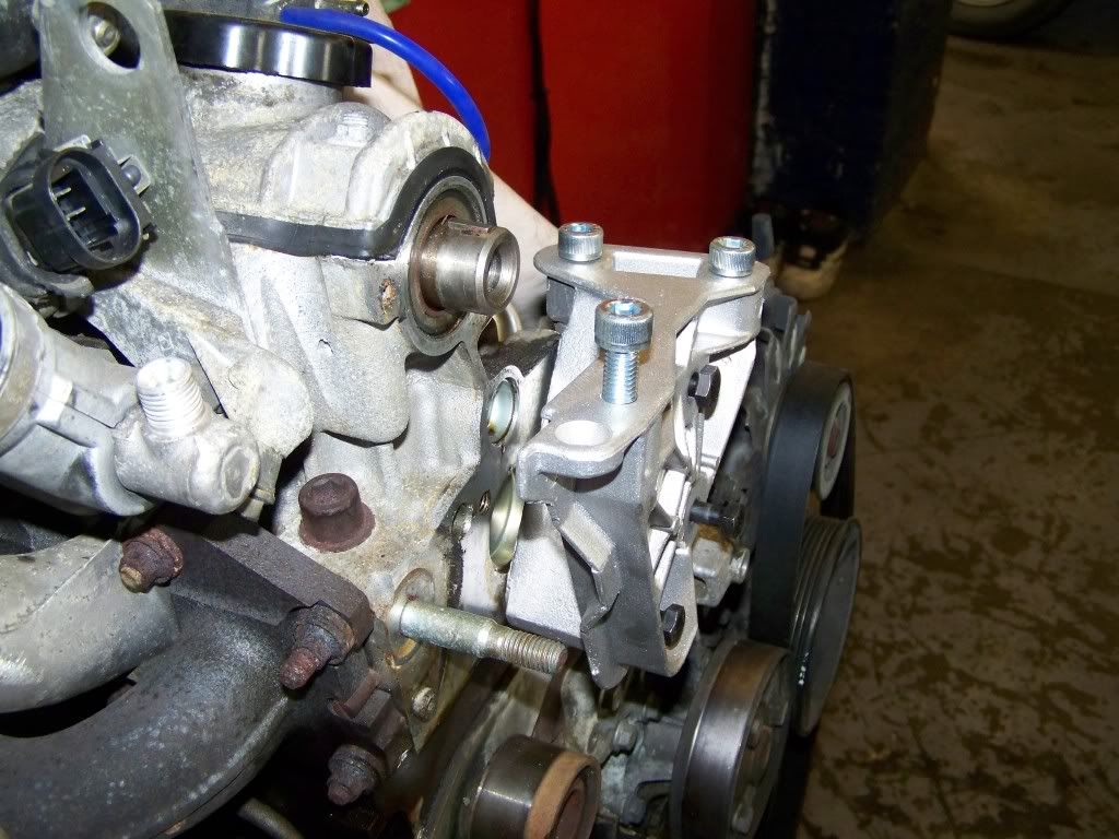

I offered the rsi mount up on the head to see where it sat ....
http://i168.photobucket.com/albums/u...i/100_0911.jpg
http://i168.photobucket.com/albums/u...i/100_0912.jpg
http://i168.photobucket.com/albums/u...i/100_0913.jpg
Perfect fit, very tight and no room there but it fits.. I then cut off the crappy surrounding plate that goes around the wing mounting on the car and offered up the rsi top mount to it...
http://i168.photobucket.com/albums/u...i/100_0916.jpg
Just got about a inch over hang so that engine is gonna sit close to the inner wing (if it does fit) but I've made a few measurements and all seams good...
I marked where the Rsi mount sits against the cam belt inner cover, some people run them with out covers on but I'm not as I've seen to many cam belts jump teeth, i then cut out the cover and offered it back up to the engine
http://i168.photobucket.com/albums/u...i/100_0918.jpg
I then bolted the cover on and re fitted the cam belt and mountings, I am going to fit a complete cambelt kit when its ready to roll but for time being ill just keep what it has while the lump goes in and out the car testing and what not..
Finished item looks quite good i think.. :coffee:
http://i168.photobucket.com/albums/u...i/100_0919.jpg
http://i168.photobucket.com/albums/u...i/100_0920.jpg
http://i168.photobucket.com/albums/u...i/100_0921.jpg
Now the big decider is if it all lines up in the car, this weekend I'm gonna slap the box onto the engine and put it in the car and bolt it all up just to see where it all fits and if it fits... Just hope it all lines up and it dont sit at a slant or summit? I'm pooing meself.. lol

Wee bit more progress ready to take the lump to (so hope it fits), finally sorted every wire in the loom, all the ones i need from all the ones i dont...
Tested a few just to double check i had the correct wires as haynes diagrams don't add up on the colours :dearme: but i think i'm pretty much there now...
http://i168.photobucket.com/albums/u...i/100_0922.jpg
http://i168.photobucket.com/albums/u...i/100_0924.jpg
http://i168.photobucket.com/albums/u...i/100_0925.jpg
And all finished, the wires on the top tucked under the washer jet hose are all the ones to be coiled up and put out the way..
http://i168.photobucket.com/albums/u...i/100_0926.jpg

Load's of progress today....
Got the clio gear box on, had to use auto flywheel for mo as mine is being delivered on monday.. Gear box fitted like for like just had to swap 3 dowls over...
http://i168.photobucket.com/albums/u...i/100_0928.jpg
http://i168.photobucket.com/albums/u...i/100_0929.jpg
Engine fitted in a treat :cool: so pleased, every mount just fitted perfect...
http://i168.photobucket.com/albums/u...i/100_0930.jpg
http://i168.photobucket.com/albums/u...i/100_0931.jpg
Turbo clears the bulk head by about 1.5" :laugh:
http://i168.photobucket.com/albums/u...i/100_0932.jpg
So knowing that it fitted i thought about hearing it run, i sat there for weeks working out which wires go where so now was the tester...
Looks a mess but i know where I'm going with it, renault ecu on one side and both volvo ecu's on the drivers side, few hoses here and there...
http://i168.photobucket.com/albums/u...i/100_0933.jpg
http://i168.photobucket.com/albums/u...i/100_0934.jpg
I changed a bit of wiring, i decided to use the clio fuel pump circuit as opposed to the one in the volvo loom, seams to work fine so i might keep it that way...
Comments welcome, and also i'd like to say thanks to every one that has helped me out on this, advice has been great.. :agree:

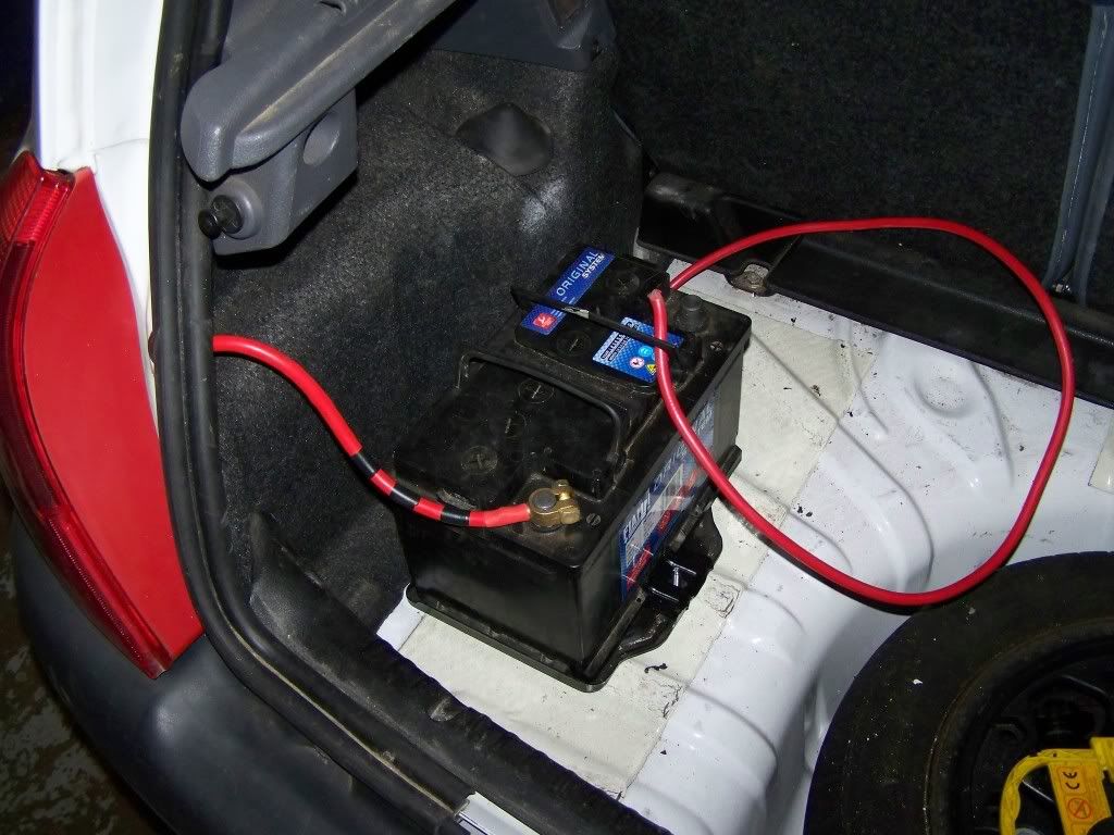

Got the battery fitted in the boot today, i used a corsa 16v bolt in tray and clamp cost £16... Got a heavy duty earth lead and bolted that to the floor, i then ran a 38mm squared power cable down the inside of the car, i clipped it all along the passenger side under the plastic trim so you can't even see it's there, only took a hour and I'm pleased with the out come..
http://i168.photobucket.com/albums/u...i/100_0940.jpg

Bit more progress..
Got all the wiring loom sorted today decided to mount the two volvo ecu's under the scuttle panel out the way and clipped the loom in place down the inner wing...
Just made a hole in the bulk head panel for the wires to go through and i also fitted a ignition feed to the loom and put a direct feed to the fuel pump from the volvo loom, decided against the idea of keeping the clio fuel circuit as it kept cutting out and restarting, i'd say it's summit to do with half the renault ecu being dissconnected lol...
http://i168.photobucket.com/albums/u...i/100_0951.jpg
http://i168.photobucket.com/albums/u...i/100_0952.jpg
http://i168.photobucket.com/albums/u...i/100_0955.jpg
When panel is fitted it looks perfect i think..
http://i168.photobucket.com/albums/u...i/100_0953.jpg
Moved all the renault ecu to under the head light on the chassis rail, all water proof and all the dead wires bunched up..
Also extended the main live on the volvo loom and roughly posistioned it where i need it to be..
http://i168.photobucket.com/albums/u...i/100_0957.jpg
http://i168.photobucket.com/albums/u...i/100_0958.jpg

Slight progress..
Managed to source a volvo fly wheel,clutch and later spec better ecu's Maroon labled...
Got engine back in now and running just trying to plumb up all the water hoses in a tidy manner then i need to source a intercooler from some where and try get that to fit...
Where abouts do i start with the intercooler hoses, i haven't got alot of room down there and i havent really got any pipe work other than what volvo used which is pointless to me really..
Any body good with from mounts ? :agree:

Had alot of progress but not much that pic's can explain really..
Got my new volvo flywheel and 215 mm clutch fitted
http://i168.photobucket.com/albums/u...i/100_0975.jpg
Got all the loom in and cabled tied in nice and neat around engine and rad etc.. Got all the coolant system sorted and a nice warm heater inside..
http://i168.photobucket.com/albums/u...i/100_0984.jpg
http://i168.photobucket.com/albums/u...i/100_0985.jpg
I got alot more dun today but havent got round to taking pictures yet.. Got the exhaust and drive shafts left to fit now i have a question about the exhaust but ill ask that in the tech section as im unsure which route to take...
Comments and thoughts welcome

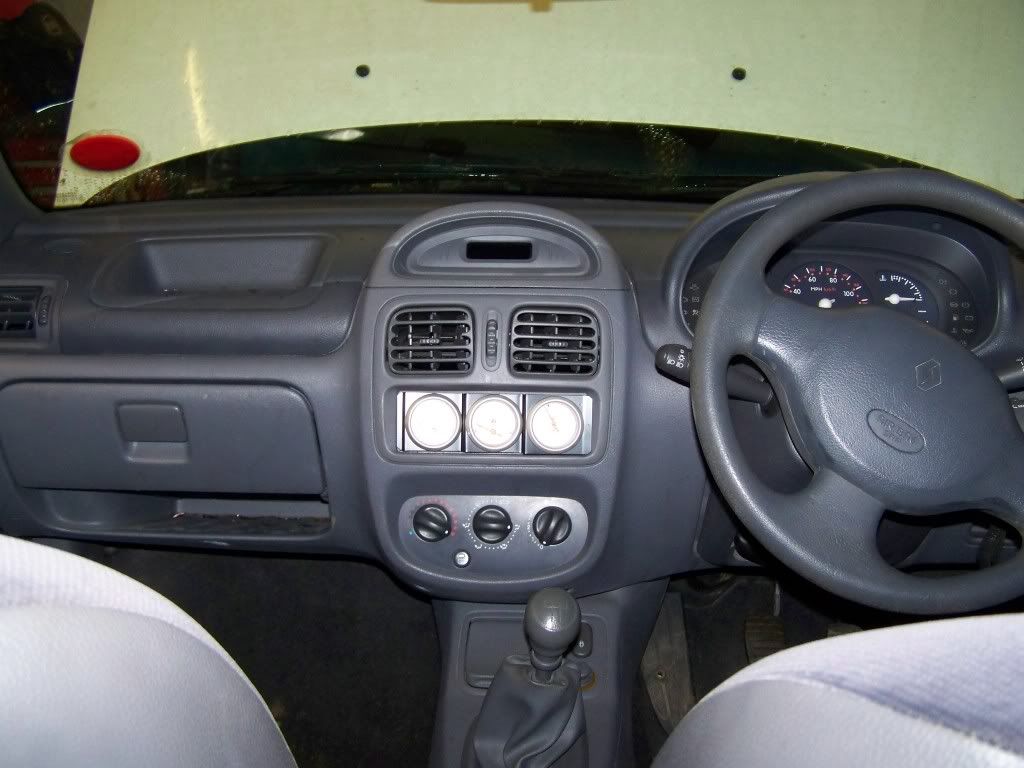

Plenty of progress, i removed the top half of the dash and wired all my gauges in and rev counter wires..
http://i168.photobucket.com/albums/u...i/100_0994.jpg
http://i168.photobucket.com/albums/u...i/100_0995.jpg
And all finished
http://i168.photobucket.com/albums/u...i/100_1001.jpg
