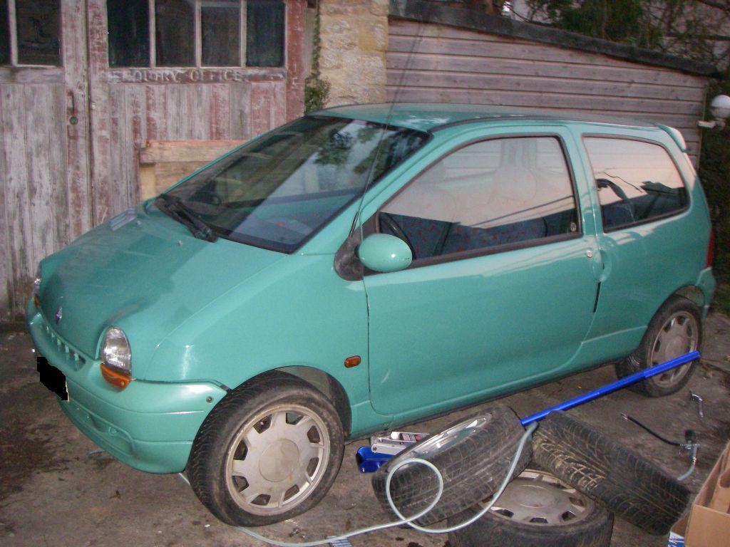

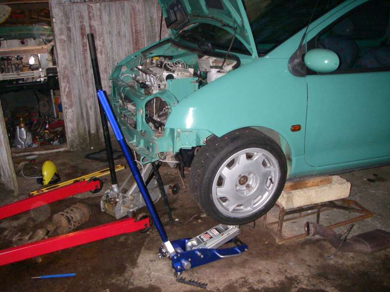

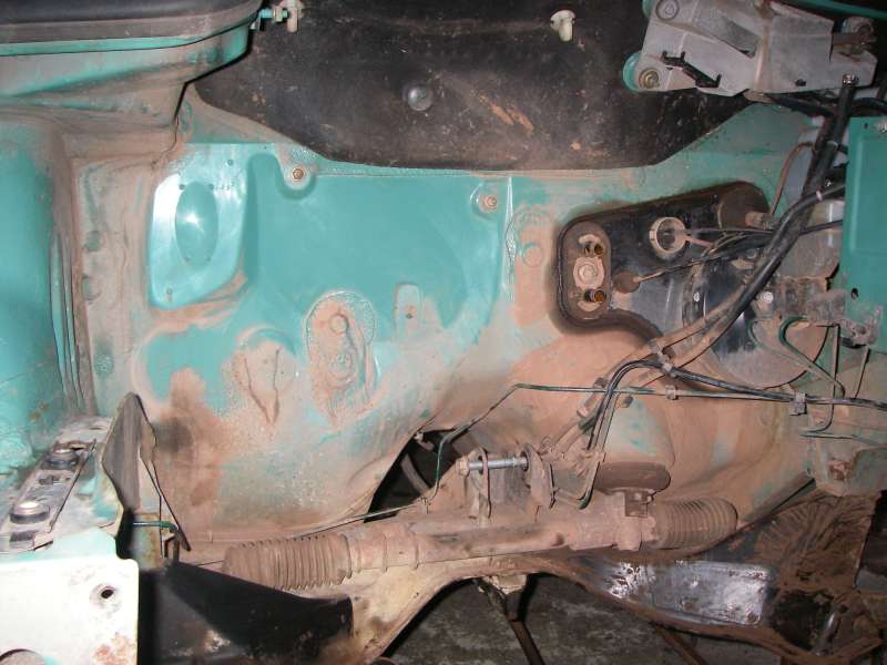

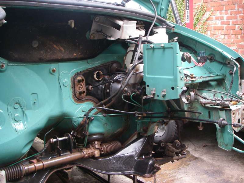

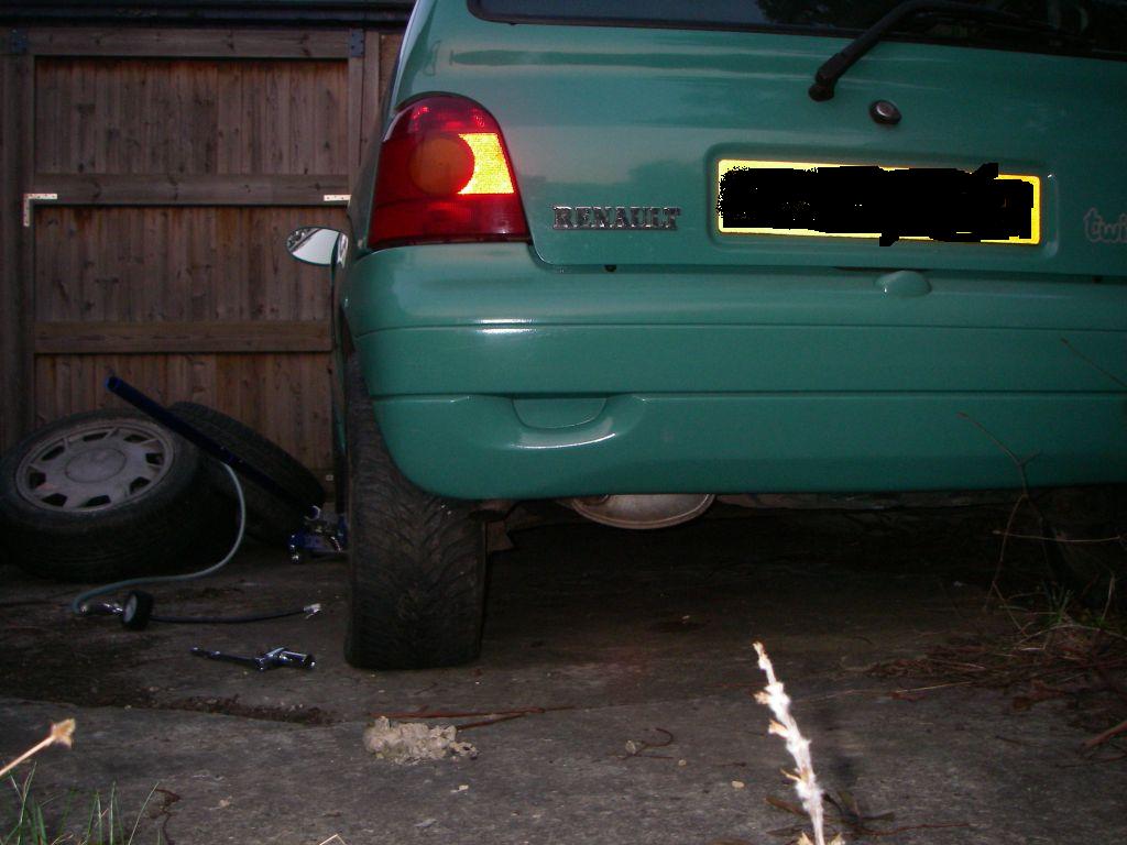

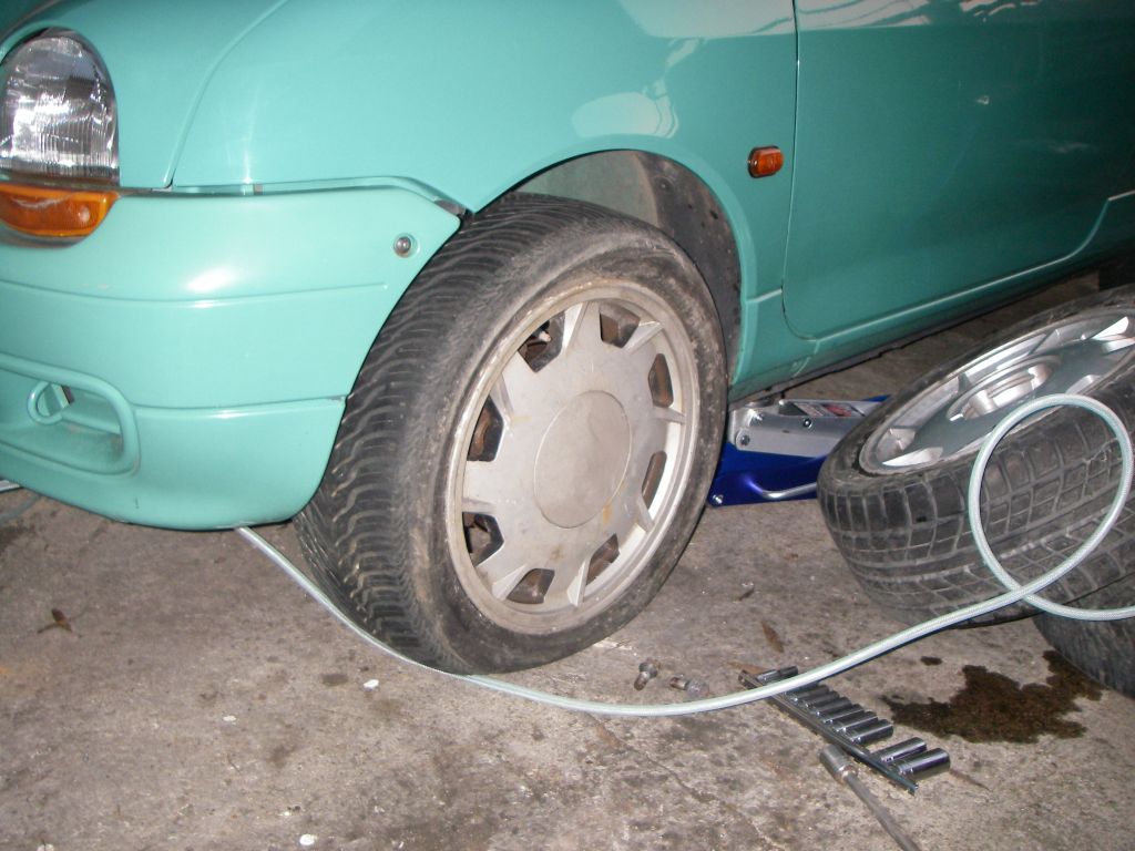

Stripped off the original brake pipes first thing, then managed to mount the clio cup brake pressure regulator under the servo, it actually looks quite at home there. Made up the new brake pipes, fitted with the new braided hoses, bled the brakes, adjusted the handbrake. Job done.
The Twingo now has a fully working 172 Cup braking system :cool:

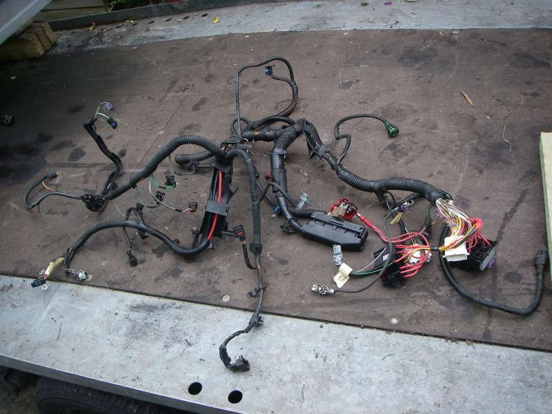

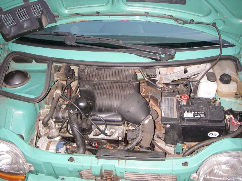

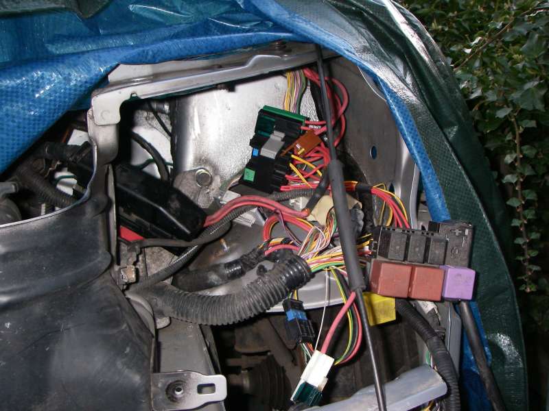

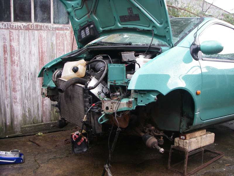

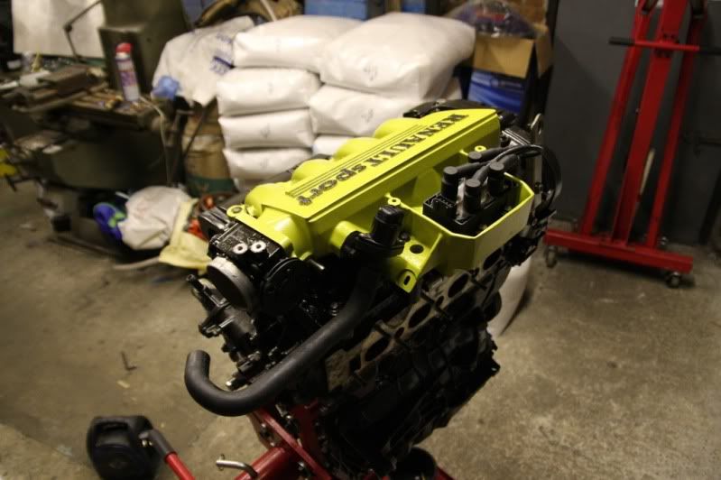

I spent a few hours tidying up the PH1 engine loom last night, it's almost done, and I can fit it now that the brake pipes are fitted. If all goes well I'll start the engine next weekend :laugh:
