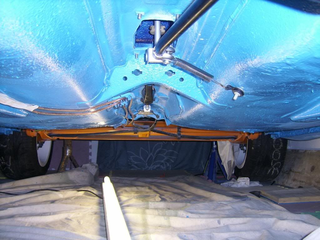

Nice project, looks good all painted underneath, I doubt you will get blasted maybe for the wing and side skirts:)

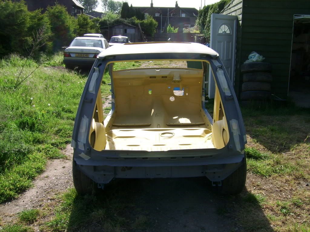

I think its a very good car, good to see somebody flatting the inside before paint.

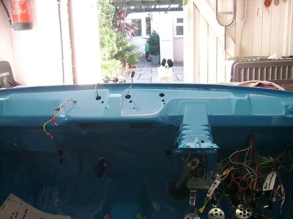

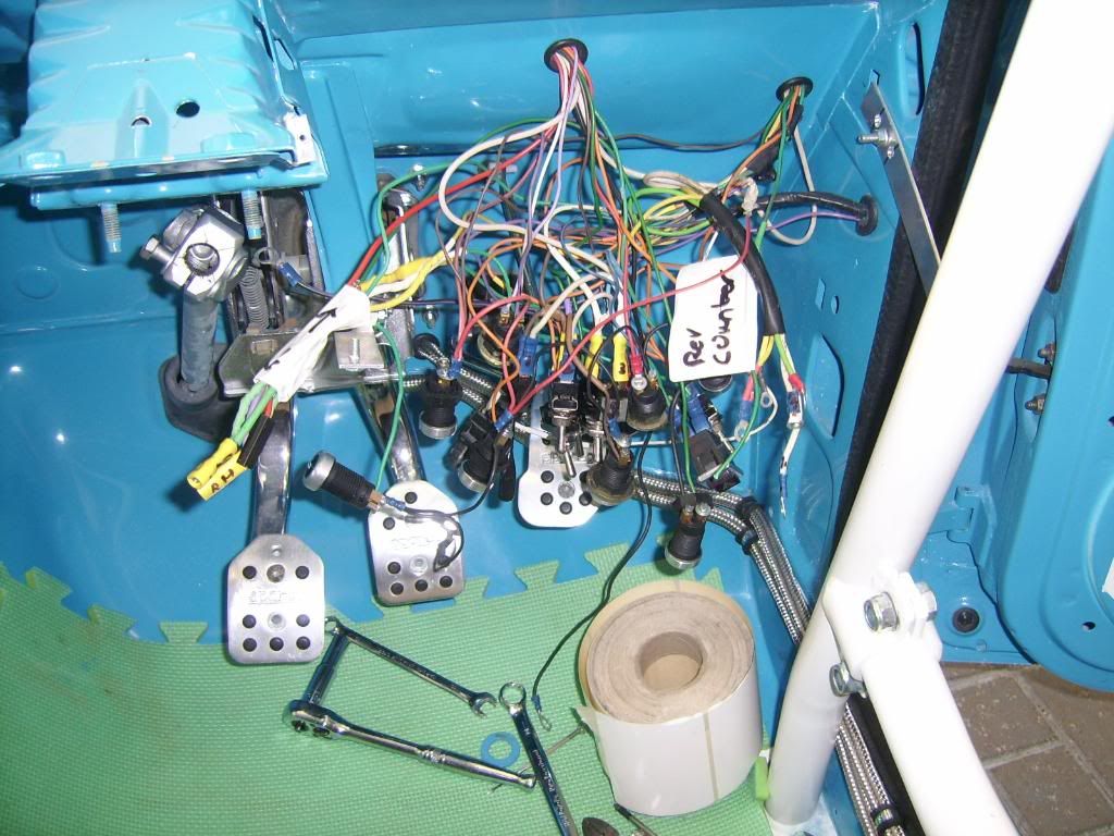

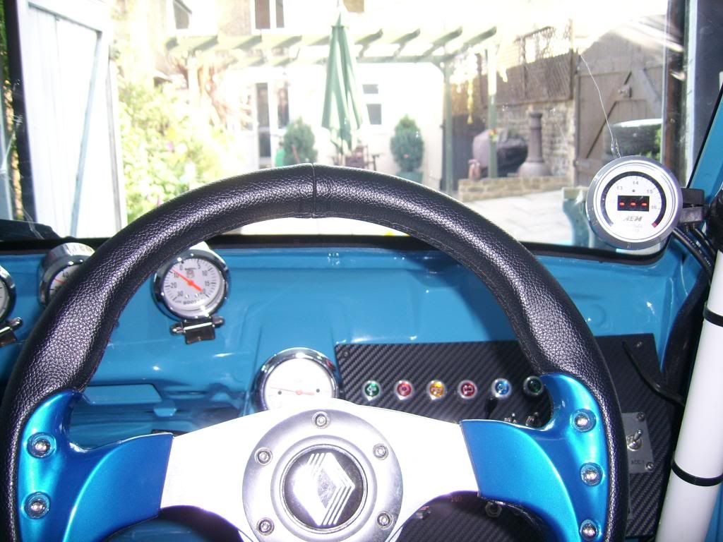

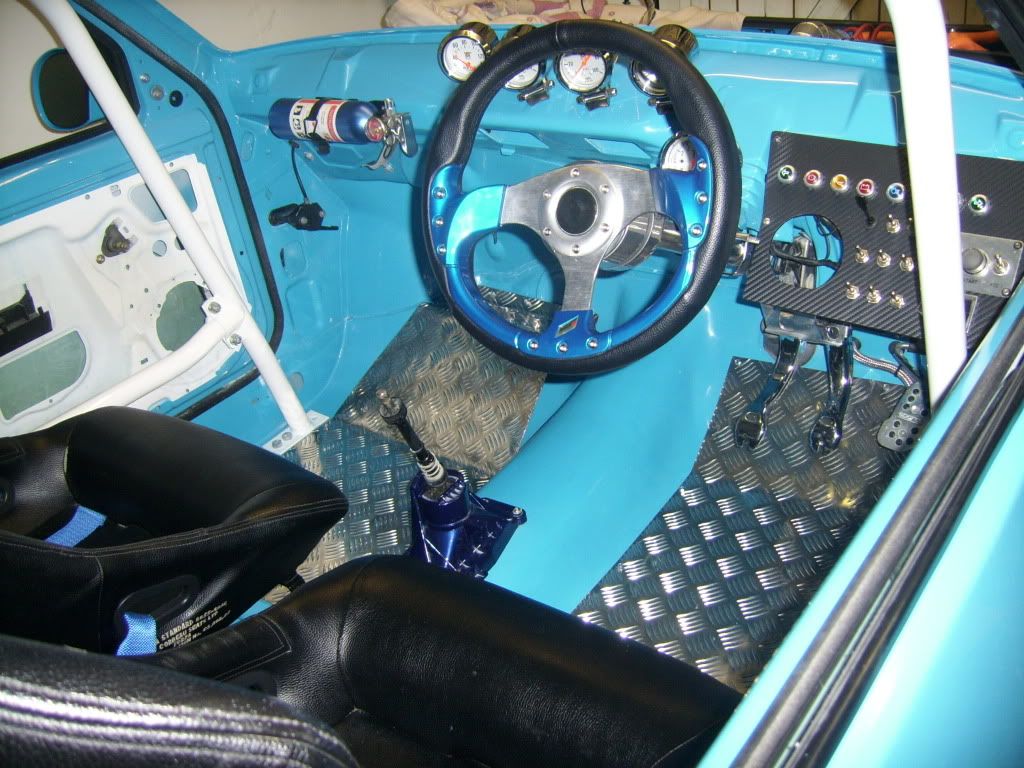

personally i like the dash - or lack of it, and the hidden wiring.
i know that takes a great deal of work to sort.

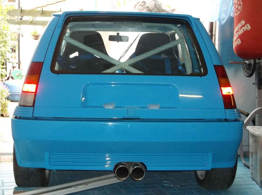

Gotta say (neck on the block here) ive always like'd the aggressive kits for the 5's if done well.
imop if it were mine id loose the rear lights/skirt's...Get some bigger wheels on it, with maybe a cheekie gloss black coat on them to give a more Moody look, touch lower all round for a more level stance and it'd be right up my street them :agree:
these kits really need monster rims to pull the proportion's off imop..
Gotta say though that apart from the above(all my taste oc and no disrespect to your's at all :) ) and going from the pic's, the effort/finish is absolutely superb, a real credit to you and all involved, id be well proud of it, its one of the cleanist 5's ive seen OE or not...
Cheers Sparkie, ye the dash is my favorite bit of the car:agree:
all the wiring that came out the car filled a 40ltr storage box, i then used what i needed to make a new wiring loom and it barely made a dent in the pile:)

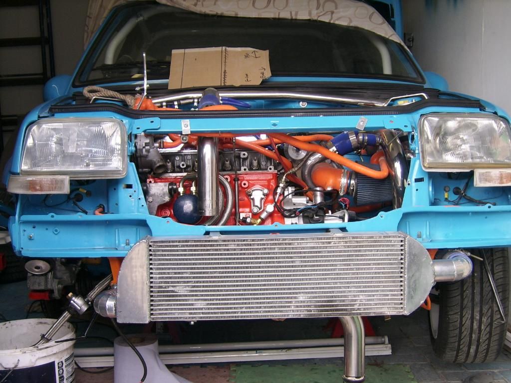

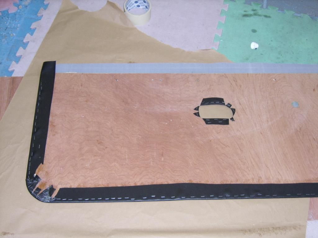

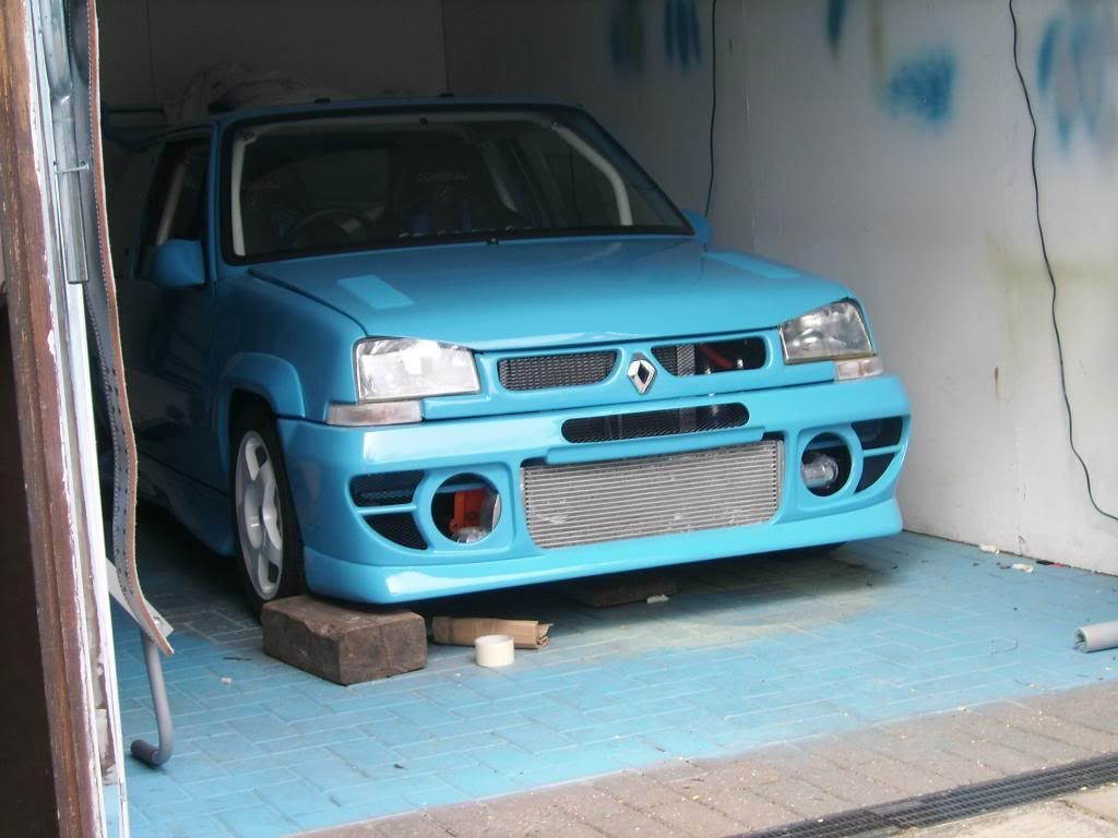

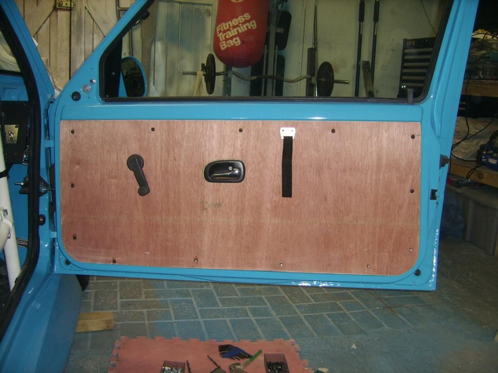

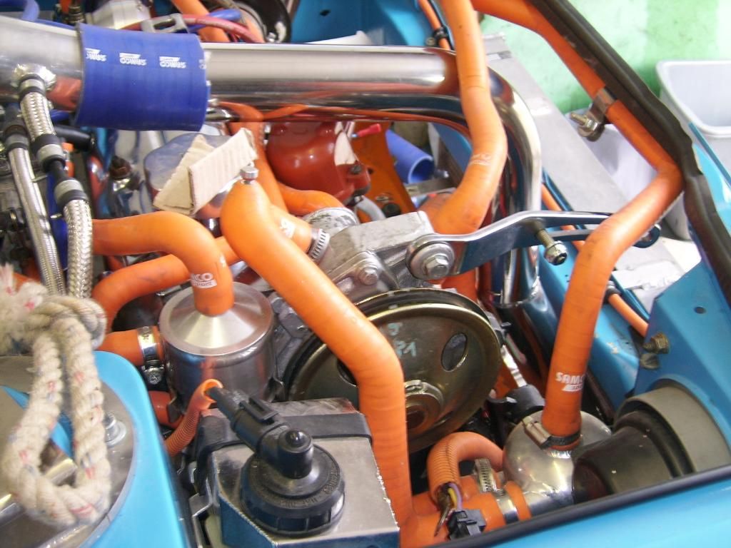

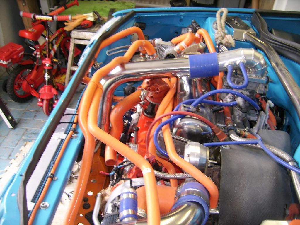

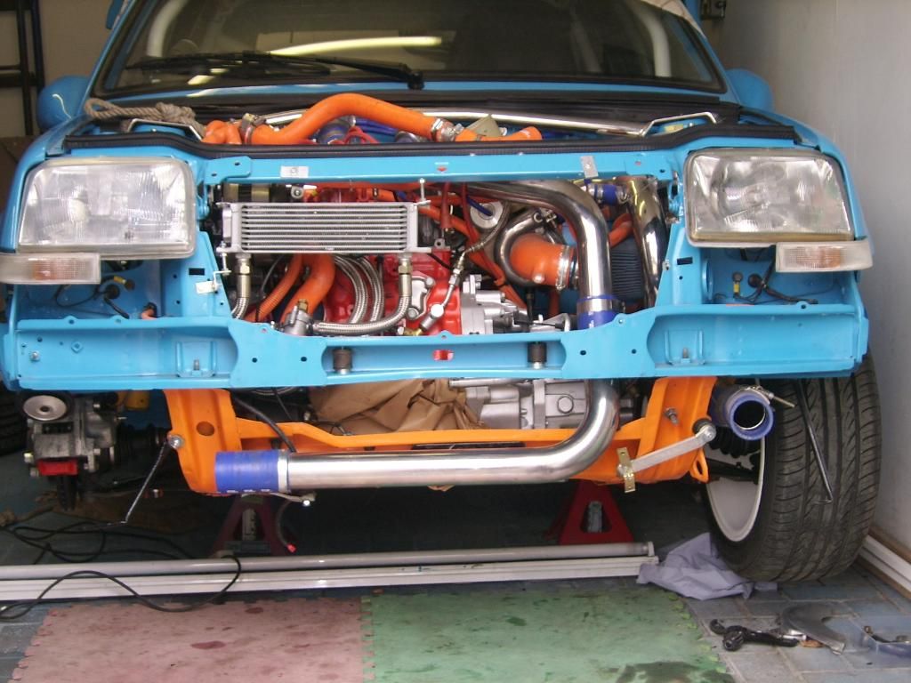

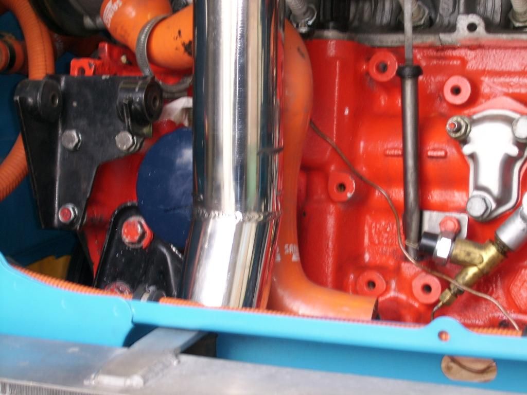

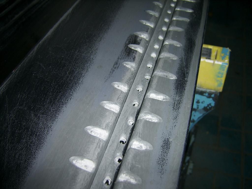

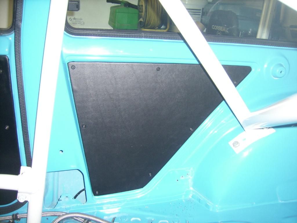

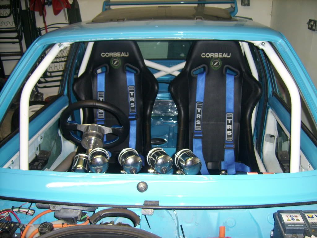

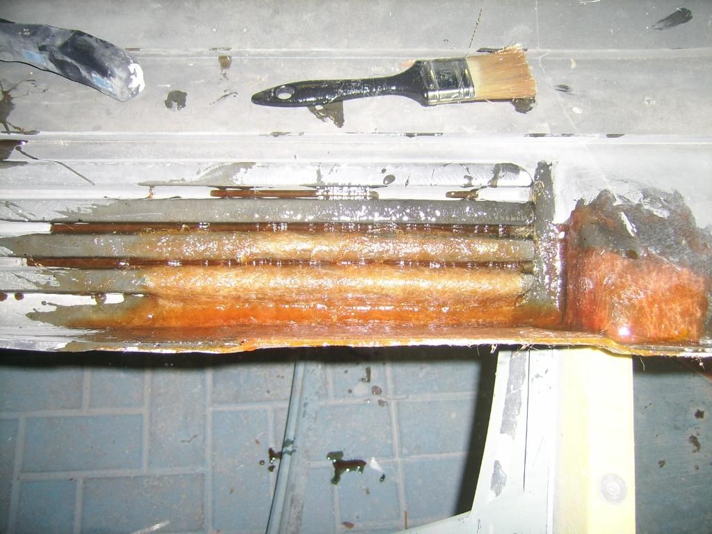

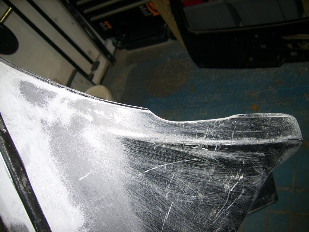

Its been a while since ive even looked at the car let alone worked on it, so i took it out and gave it a wash. Im still in the i cant be bothered to work on you mood though, still got lots of jobs to do around the house, to much time at work, looking after the kids etc and im then struggling to find time to work on it:crap:
My list of things to do are, drop sump again then fill oil pump up with vaseline or similar, ive got no oil coming through the turbo oil feed.
Find out and make sure it is me turbo thats smoking,

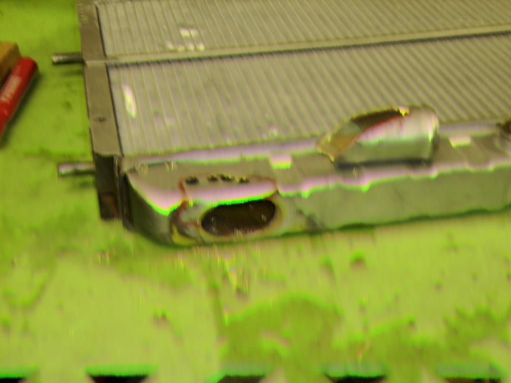

Do a pressure test on the boost circuit as i think ive got a leak in the i/c, anyone got an easy diy way to test this.

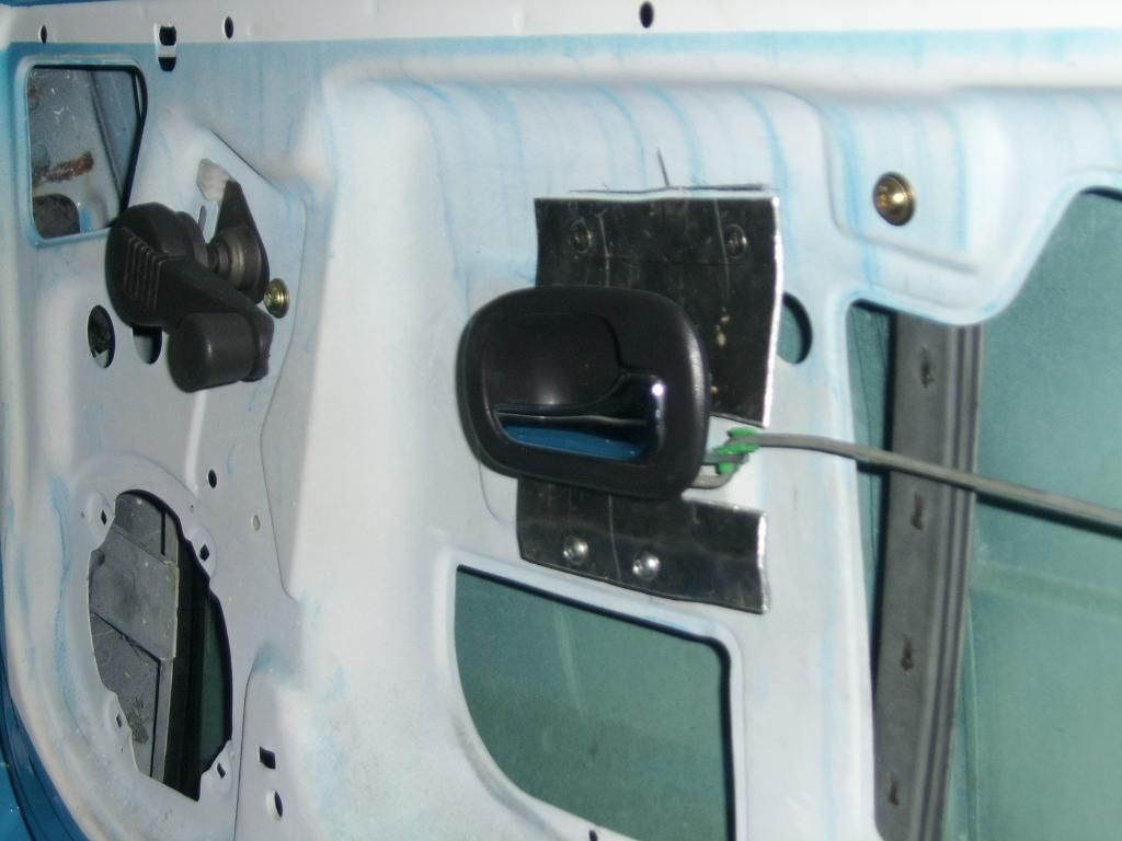

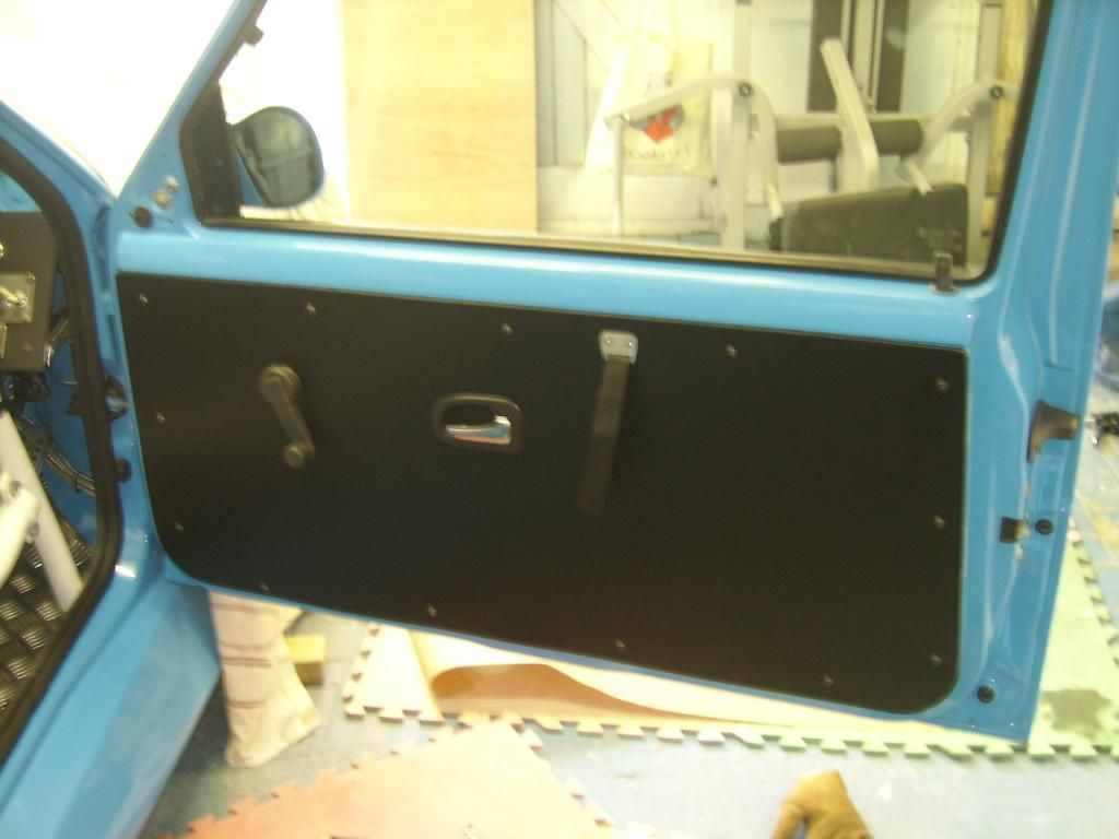

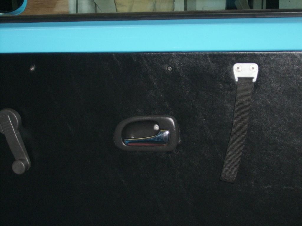

Make some doorcards up in black vinyl.
Got to make a cover for my fusebox,
Theres probably a few more things to do but cant think now, im not going to get the car on the road till spring so got plenty off time.
Took a few more pics

http://i813.photobucket.com/albums/z...enault/108.jpg

Wow! I love this!! Great job! o.e bores me personally, it's deffo a one-off! :agree:
Only things I'm not that keen on is rear bumper/rear spoiler/tailgate and that steering wheel!

Cheers Rebel, what you dont like my super cheap bulgarian steering wheel:laugh: neither do i really, money was getting abit tight and once id got it there was no turning back:cry:
As for the rest of what you said you dont like id totally agree, but id include the skirts. But as with everything it boils down to money, not that im skint but how much do you plough into a renault 5?
Im definately thinking of getting rid of the spoiler, but then ive got to get the holes welded up then buy the paint etc, or do i go for a standard tailgate with oe spoiler and paint that but then ill have to get oe rear bumper which isnt a problem but then ive got the pain of having a centre exit exhaust:scratch:
Would a standard bumper (it would have to be smoothed though) look ok ish with that centre exit exhaust, because if it did then i would be tempted to go oe spoiler, tailgate and bumper, what your opinions peeps.

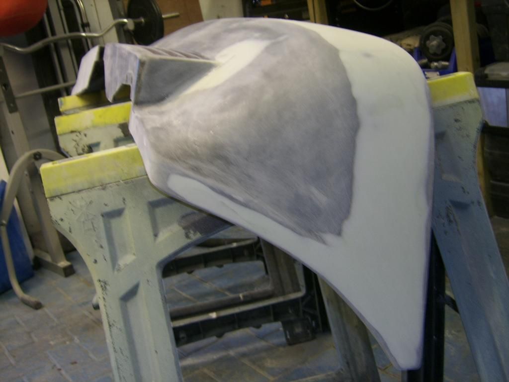

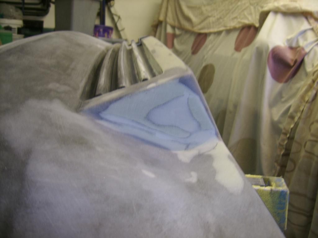

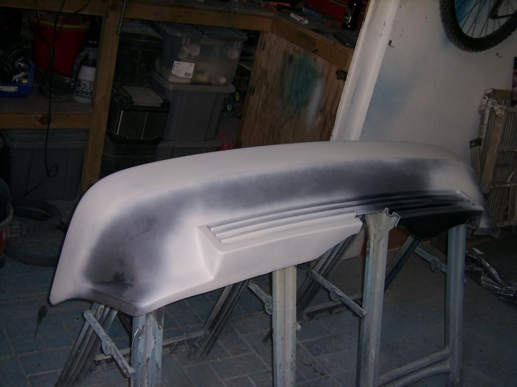

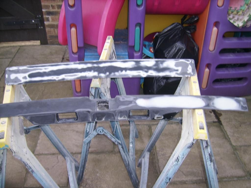

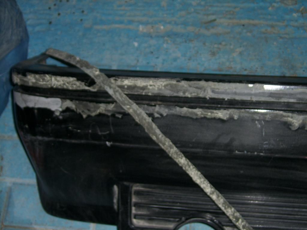

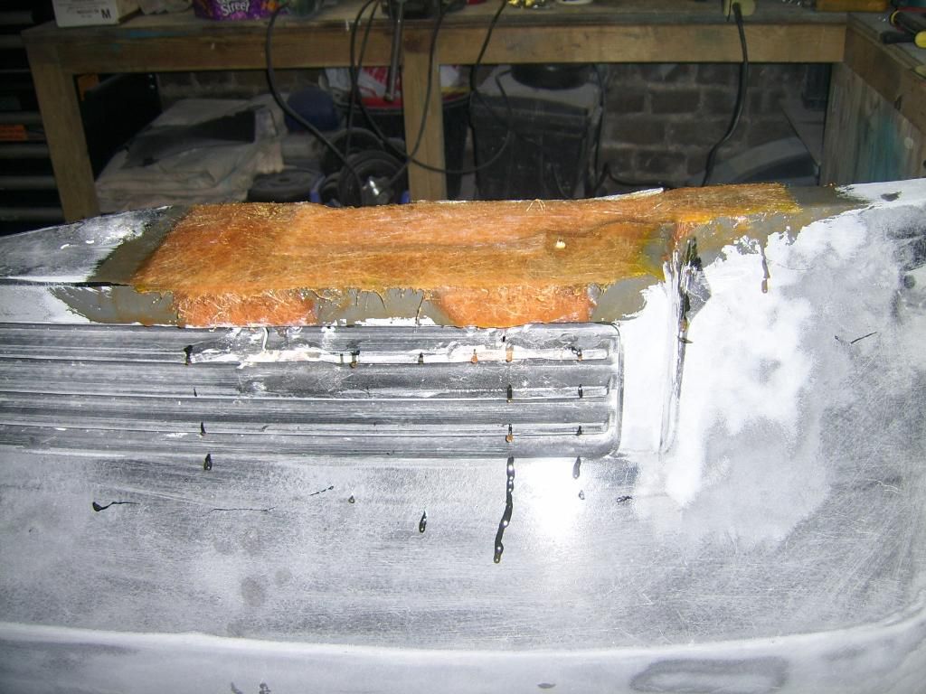

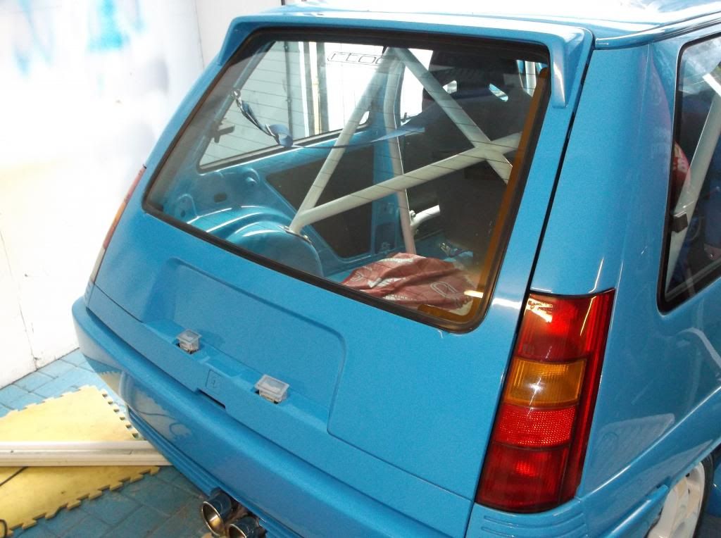

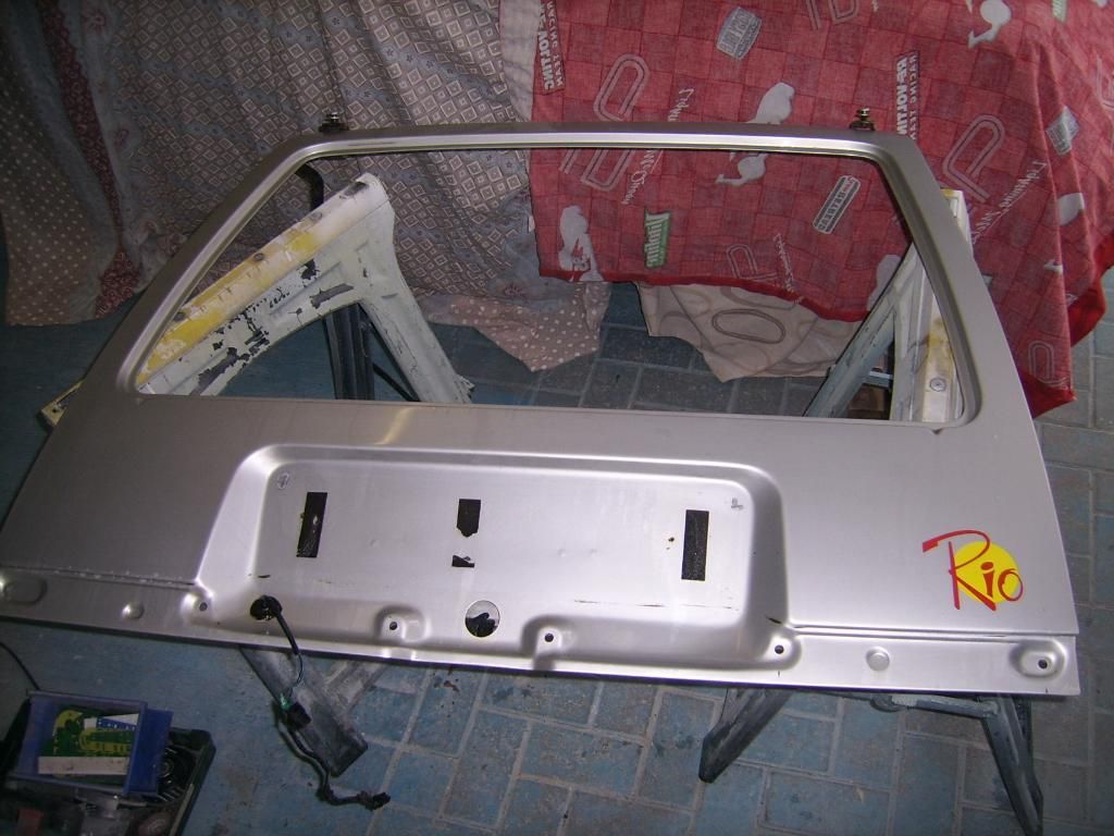

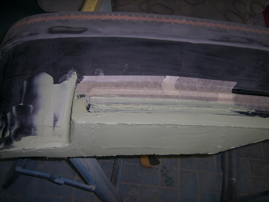

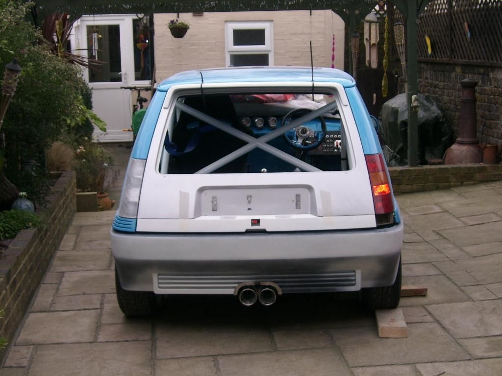

Not been able to do alot to the 5 just lots of 30 min stints here an hour there so progress is slow:crap:
I got a standard rear bumper, tailgate and spoiler to try and tame the rear end down;) only paid peanuts for the bumper as it needed abit of work, so thats what ive been working on mainly.
Pics,;)
http://i813.photobucket.com/albums/z...ault/002-9.jpg

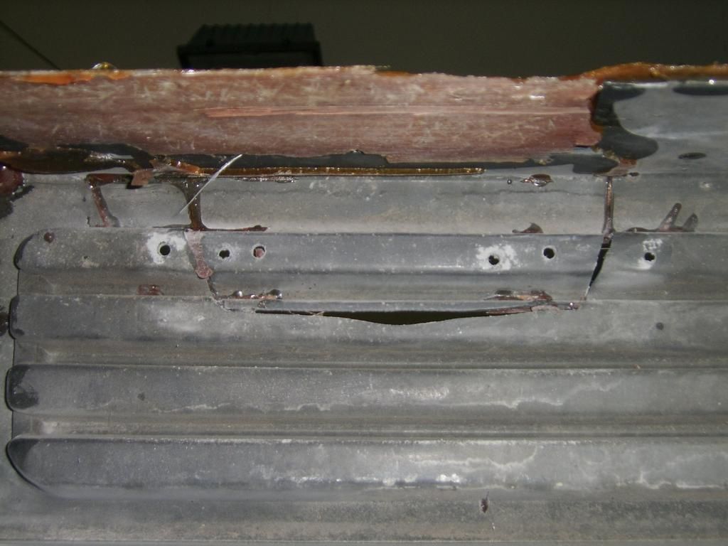

Someone had tried to fill the bump strips in but had done a less than impressive job, i dug the lot out with a screw driver:scratch:
http://i813.photobucket.com/albums/z...ault/003-9.jpg
i also found this which i had to repair, and a few hairline cracks
http://i813.photobucket.com/albums/z...ult/007-10.jpg
http://i813.photobucket.com/albums/z...ault/015-3.jpg
http://i813.photobucket.com/albums/z...ault/027-1.jpg
http://i813.photobucket.com/albums/z...ault/016-2.jpg

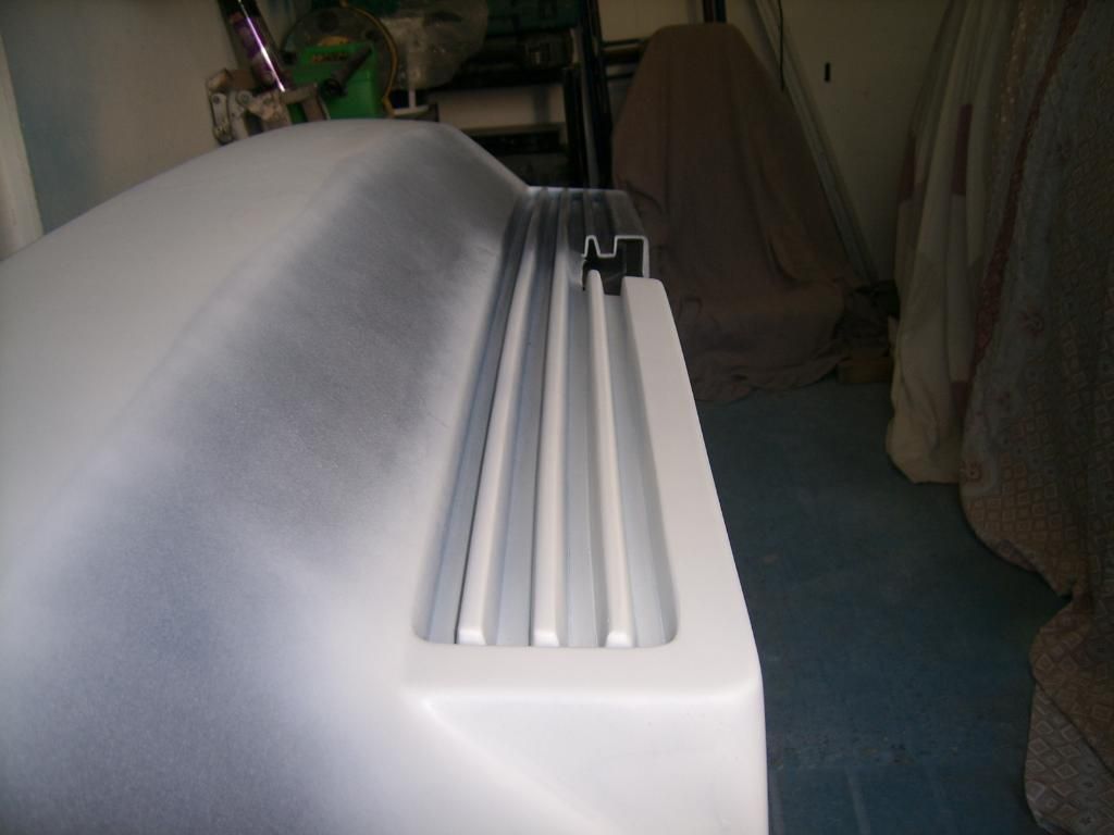

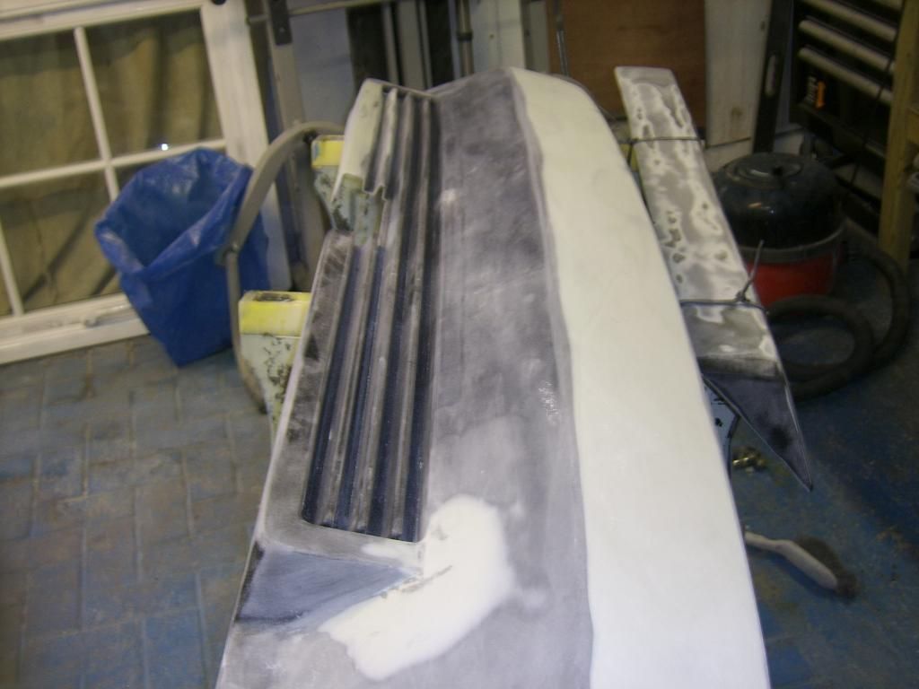

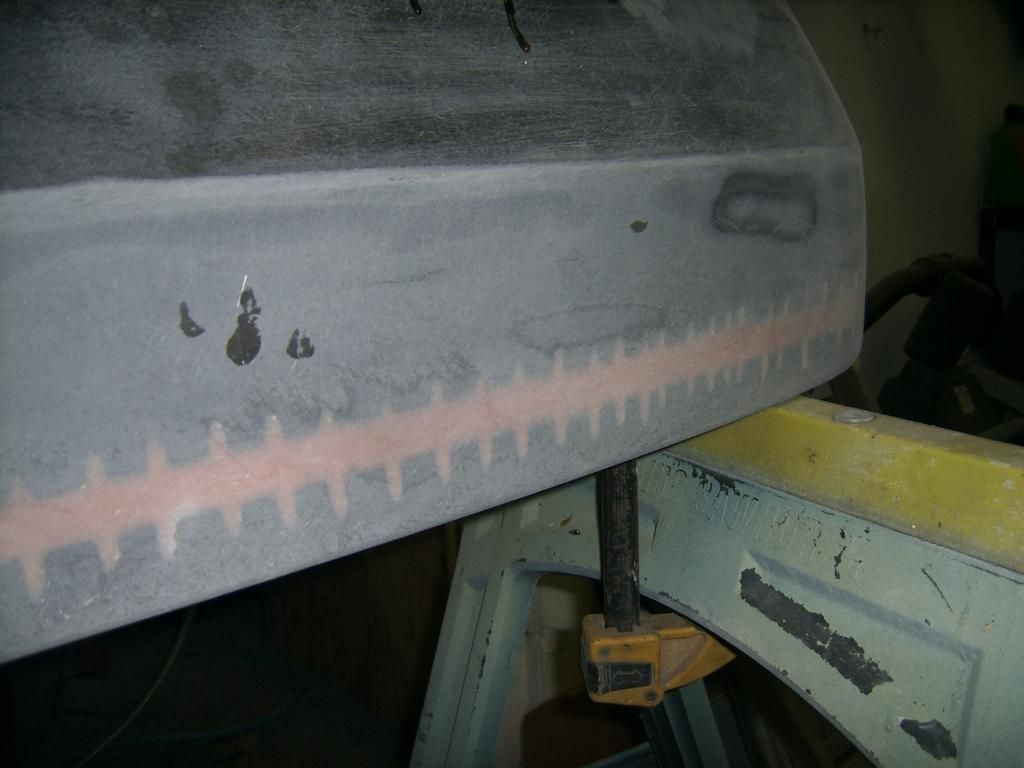

Im not going to ditch the centre exit exhaust so i had to cut out the middle and transfer it over to where original exhaust hole was.
http://i813.photobucket.com/albums/z...ault/017-2.jpg
http://i813.photobucket.com/albums/z...ault/014-4.jpg
http://i813.photobucket.com/albums/z...ault/018-2.jpg
http://i813.photobucket.com/albums/z...ault/028-1.jpg
http://i813.photobucket.com/albums/z...ault/026-1.jpg
It seems like ive spent an age on this bumper, but im 90% done on the fillering/shaping, then got to prime it then block that down then prime again then paint. On a plus side ive found ive still got all the paint ill need plus thinners, hardners etc so ive not got to spend anything on that side:D
Soz about the num of pics.

Looks great already good work. Its really satisfying just takes so damn long lol(well without power tools it does)
Re: lagging behind by a few years!!!!
Tony Walker
Cheers Tony, ive killed me 50mm DA sander whilst working on this bumper and i can only use my 150mm DA for about 30 seconds before i have to stop and let me 50 litre compressor build up enough pressure to go again for another 30 seconds :mad:, so most of it is by hand:(

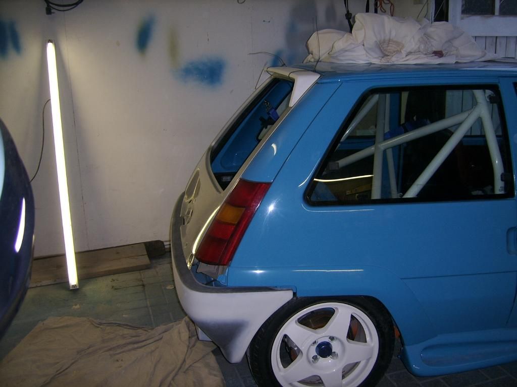

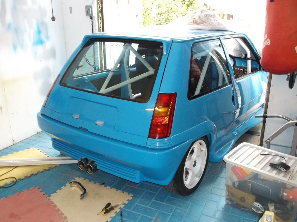

Cheers for the comments Steve L, Jrp & Alan:)
Been to see Mike 16v this week, got a few bits to aid me when i shorten my i/c pipe run and also some new number plate lights, also got a standard campus tailgate.
Finished the shaping of the bumper just got to give it a lick of high build primer hopefully next week at some point. Spent a few hours today cutting the bumper to fit the exhaust, got to find someone that can weld me in a piece of s/steel into me heatshield :scratch:
As always lots of pics:D sorry.

Massive improvement, will look mega once finished!

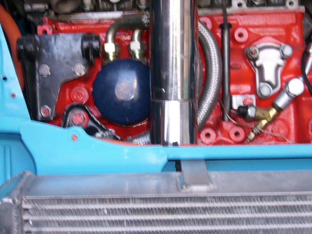

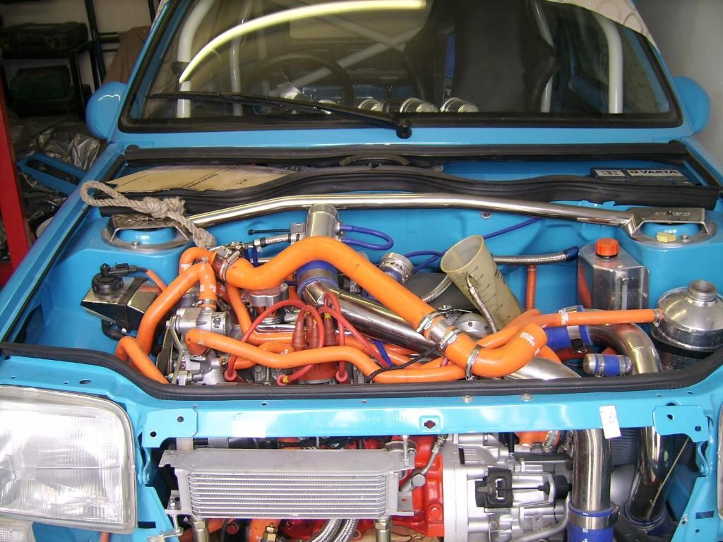

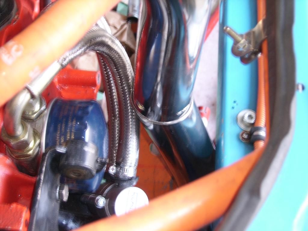

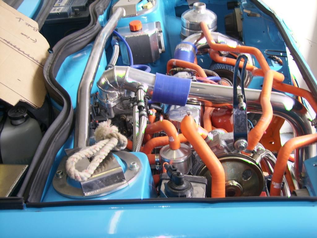

Small up date with lots of pics:D. ive shortened my boost run frm intercooler to carb, moved my rad over then got stuck in cutting the pipes to shape. Then when i put rad back in id completely forgotten about the outlet hose on rad it was bang in the way:ashamed::mad: so i cut this off and shaped it to fit the rad but on the corner. I had the boost pipe welded today, but the man couldn't do the rad right away so ive got to wait a few days.
Pics, soz camera is dying:sad2:
http://i813.photobucket.com/albums/z...psb5563c73.jpg
http://i813.photobucket.com/albums/z...ps74c39082.jpg
http://i813.photobucket.com/albums/z...ps22c5e98a.jpg
http://i813.photobucket.com/albums/z...ps0c6c97a8.jpg
Yes i will be replacing the rusty washer:cooter:
http://i813.photobucket.com/albums/z...ps90b1b5a2.jpg
http://i813.photobucket.com/albums/z...ps4502e3e3.jpg
:eek: not what i wanted to do, but needs must:scratch:
http://i813.photobucket.com/albums/z...pscd0ea964.jpg
http://i813.photobucket.com/albums/z...ps61741563.jpg
http://i813.photobucket.com/albums/z...psfff95da5.jpg
http://i813.photobucket.com/albums/z...ps50b3a77d.jpg
Heatshield now fixed:)
http://i813.photobucket.com/albums/z...ps678264bc.jpg

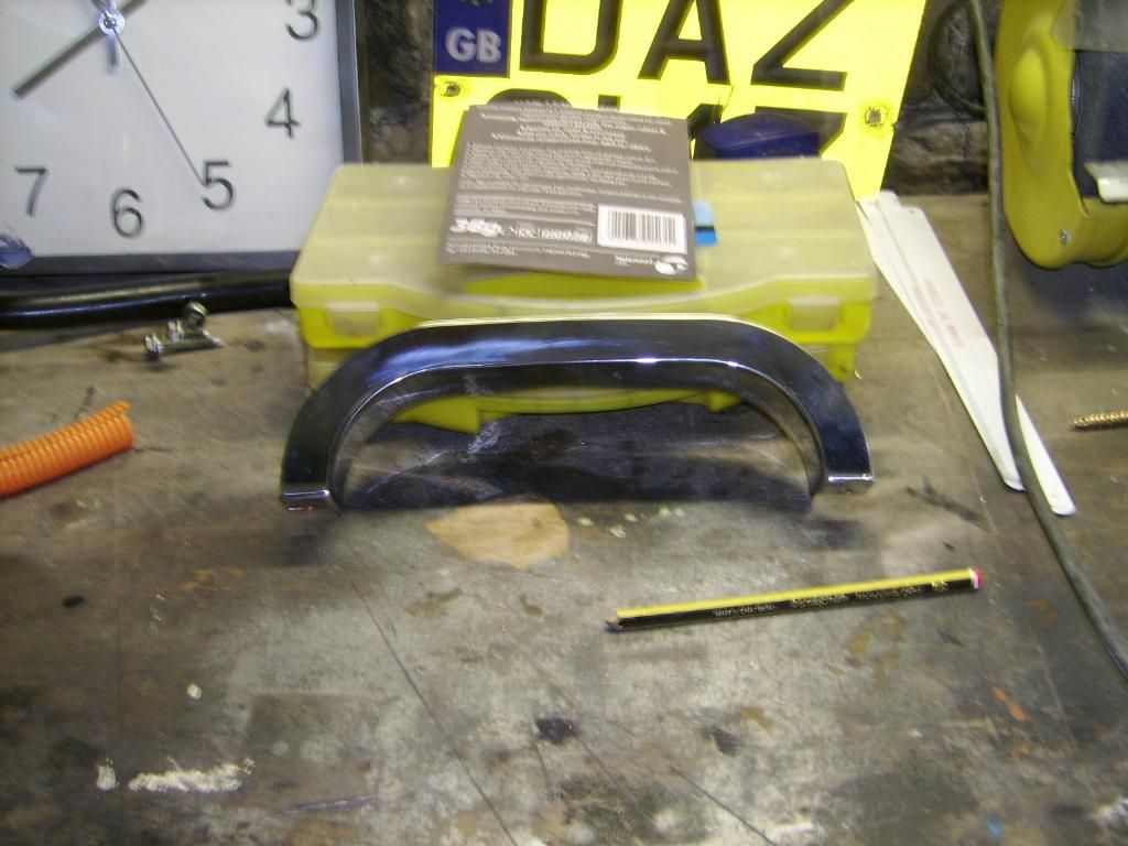

My fuse box cover, got to polish it up still
http://i813.photobucket.com/albums/z...ps5e744a4f.jpg

:eek: didnt realise the pic of rad was so shocking, dam camera
cor blimey guvna......u dont f about :-):-) if weather holds out we still on.for saturday my son...:-):-)
Got enough orange in there ;)
I need one of those boost pipes in my life!!!
Kentraider, yep still on for sat, please dont let it rain else im going to a girls 4th bday party :cry:.
Jonny 5, i reckon i could squeeze some more in there :laugh:
Nottswoody, got to have some bling in your life;)
Definetely needs a Tango catch tank :agree:

We're cam I get one? Did you make it up?
Tony Walker
Don't go giving me ideas fellas. It doesn't look so orange when your up close, with the bonnet down that is :laugh: Nottswoody i utilised the pipes I already had to make it smaller then got it welded up. I've ordered a 90 degree elbow off ebay to tidy the pre intercooler side, I want to get rid of as many clips as I can.
Is it 51mm pipe? I need this :)
Nottswoody
lol every thread i read i seem to see you buying something off it????:laugh:

That is one tidy engine bay. Top work fella!!!!
Nottswoody
Mines 57mm dude stainless steel is better than ally unless u like polishing alot.
Cheers bud, gotta love the bling:)

About time I updated here, not alot going on just plodding along when I get time :) rad is now finished and painted, had to move it over another inch as the return was to close to the oil lines for my liking. Had to use a bit of flexible pipe from the return pipe and join it to the samco up to w pump. Had some new oil lines made up with 45 degree fittings to clear the front cross member away from cooler then tidied up and fitted oil stat and sender housing using brackets and p clips. I've fitted alot of heat protection sleeving to protect me wiring, tidied up and shortened and extended some wiring where needed and have just been cleaning tidying as I go along. I'm hoping to send the turbo off for a rebuild early next month, then I've got to paint the back off the car if weather let's me:rolleyes: I'm aiming now to get finished ready for mot by early June. Pics to follow. Thanks for reading
Just had a few hours in the shed, I ordered a 90 degree stainless steel pipe to join onto the inlet side of the I/cooler pipe so I've set about cutting and shaping it to fit perfectly before I get it welded up, I'm 90% there so should be able to get that welded next week if I get chance.
Nice build mate.. Seems a bit if a job reducing the boost run. I have the same fmic as you and I've had no trouble with the length of run in regards to pressure lost.
And as for how it looked before with the big wing and rear bumper I don't know what the fuss was about. I thought it looked spot on. If I never inherited the wide boot spoiler on mine I'd have that clothes line on my five with no hesitation. Not enough originality in the five world nowadays.
Plus my 5 also where's a set of carisma skirts and I love them. Gives the car a wide look IMO and they look awesome.
Plus you know the young boy racers are crapping it when a modded five pulls up. A stealth is under rated. Wear the mods with pride and let the world know your comming and your going to be the first to leave the lights....:)
It's not the pressure loss I was worried about, it was how long it took to go from turbo to carb. But ye it is a lot of work to do what I've done I have thought this myself many times :laugh: but I actually enjoy mucking about with the old girl, and I can say it's not just a bolt on ktec jobbie now:D as for the body styling, I'm just to old for it bud it was ok when I was 20 but now ten years on its not for me if you get me drift ;) thanks for the comments though bud and get some pics up of yours:)

Finished the boost hoses now:rolleyes: took a while :D I thought I had to remove front gearbox mount though to fit the pipe under the chassis so I cleaned it up and painted it while it was off, only to find that I could have just moved me header tank a few inches and it would have passed through ok:crap: just had the girl running for a good 30mins and oil pressure is ok now, last time it was flickering the oil light:eek: it has still got its smoking issue though, which I new it would. Going to take the turbo off tomorrow then run her up again and hopefully it won't smoke. Must get some pics up soon

2nd attempt at posting a few pics pics and still none, must get a new laptop soon. Anyway sent me turbo off last week and have been told that it's dead due to oil starvation something about a bronze colour somewhere in there, this ties in with the low oil pressure I had that's now sorted. Fingers crossed I'll be able to have a bit more fun in her when it's on the road this time:D I've also visited my local paint suppliers and got all me bits and Bob's ready to paint the rear end, if the weather clears up anyway:crap:

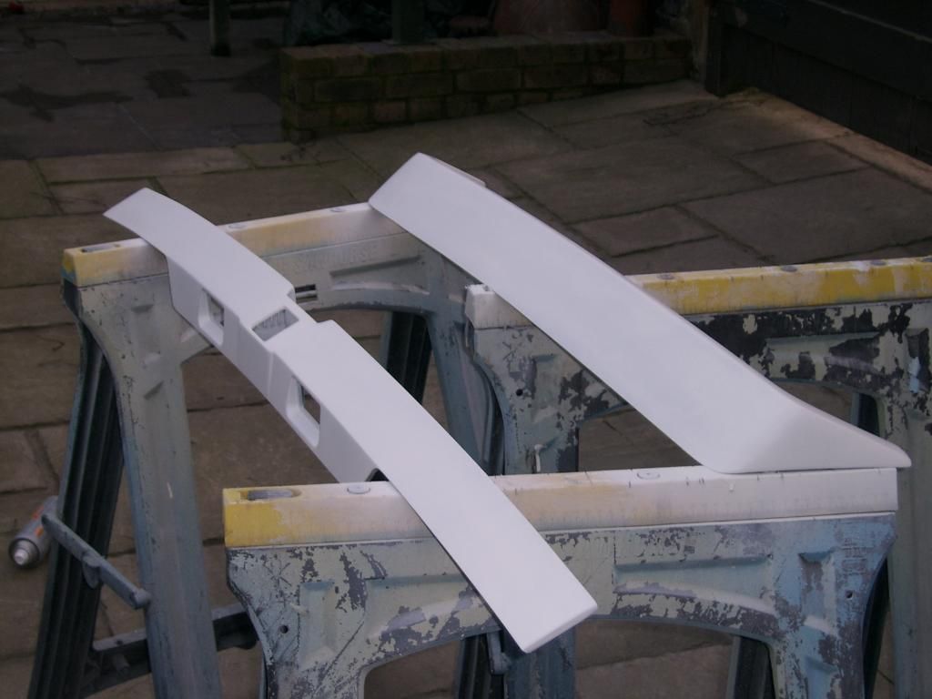

What a beautiful day it's been, perfect spraying weather :) got the parts primed, going to sand out probably most of the primer Tomoz night to make sure it's flat and true, then the final coat will be put on Sunday and then for the top coat I'm aiming for tues poss wed :yeah:.

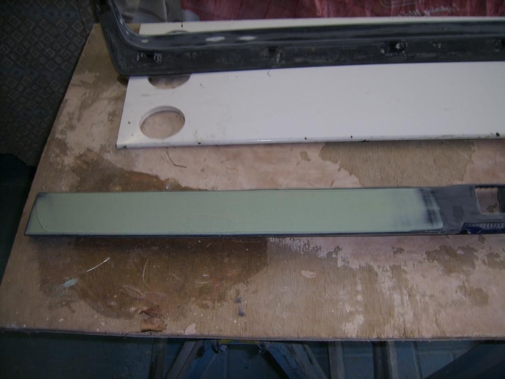

Just finished wet sanding the bumper, tailgate, spoiler and tail trim and put a bit of putty filler where needed. Started at 8:30 tonight and now I'm off to work for a rest err I mean to graft :laugh: God I'm going to be tired timid, better be worth it.
Put another coat of primer on all the parts, pleased with it so far. Going to nib it all back tomorrow then put the top coat on Tuesday if the weather behaves. I'm aiming to go for an mot around the 21st of this month, which should give me a few weeks to iron out any niggles before the Retro show.
They say the key is in the preparation, I bloody hope so I'd hate to think off how many hours have gone into this rear end:eek:

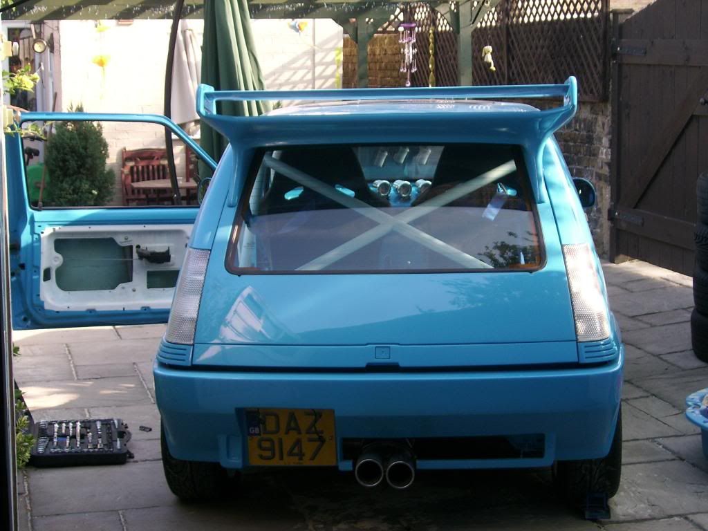

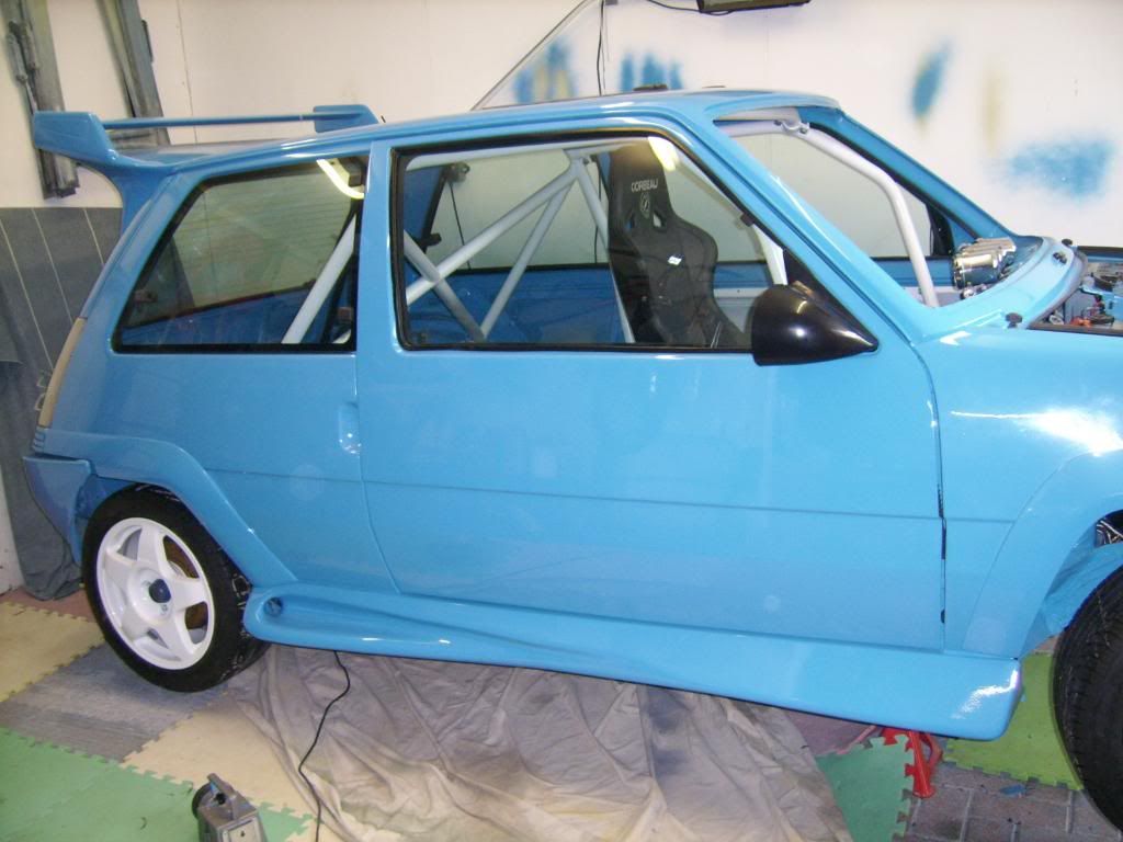

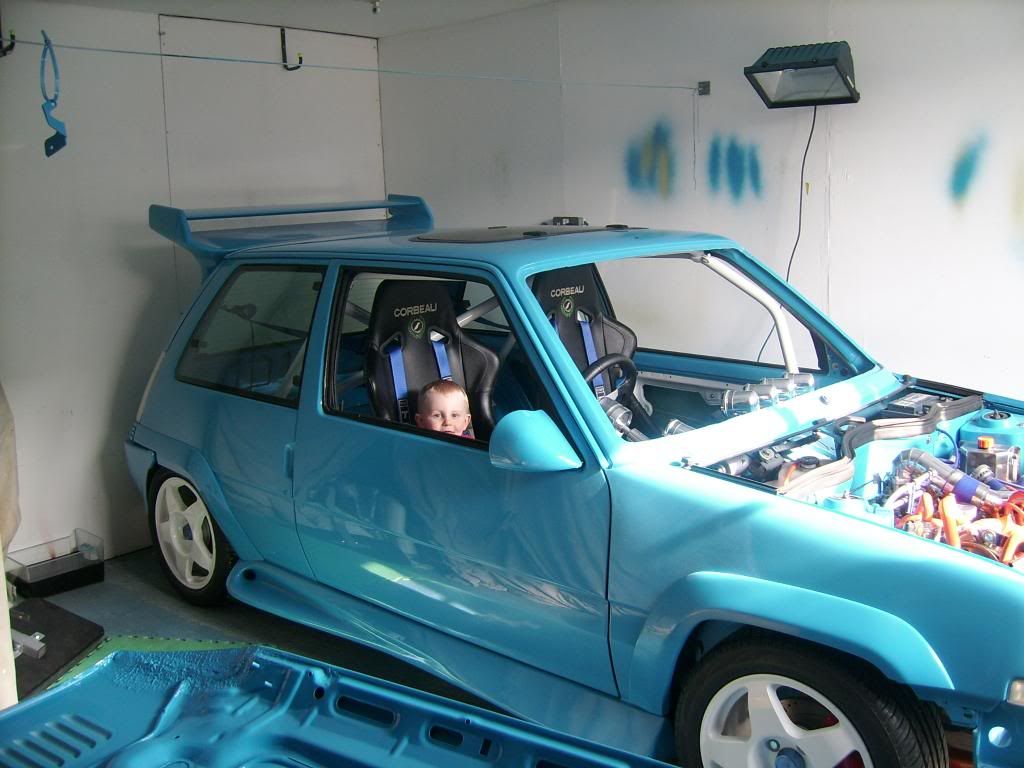

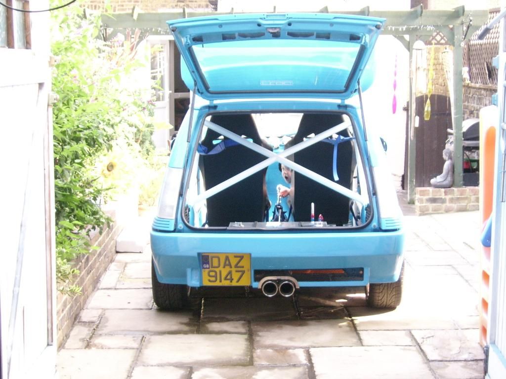

Ive colour sanded all the freshly painted parts now and have bolted it all back on, im very impressed with the new look rear end even if i do say so myself :D to complement the new number plate lights im going to buy new oe lights but probably go with the euro near side to tie it in with the other.
http://i813.photobucket.com/albums/z...psbe5ea227.jpg
turbo is off hence drunk tailpipes
http://i813.photobucket.com/albums/z...ps1dd6bb1a.jpg
http://i813.photobucket.com/albums/z...ps7a24a347.jpg
Looks a million times better, completely different car almost. :agree:
Looking much better now matey :agree: Well Done. You changing the side skirt's?
That looks :cool: Much better mate, you've done yourself proud with the build :agree:
Cheers Tony, James and babyblue these comments really spur me on. I do have a tendancy to wander off so these keep me on track most of the time:D. All in good time me old fruit Rome wasnt built in a day :laugh: but yes i will change them, when i really dont know......... i really want to enjoy it and take it about for now though.
Just ordered the lights from Mike unfortunately he just sold the euro fog one:crap: im an impatient git at times so rather than wait ive gone for the uk spec both sides, a pleasure as always dealing with Mike.
Now that is a bit of me its all about a reem machine mate ;) that looks the bo****ks it looks sweet mate :agree:

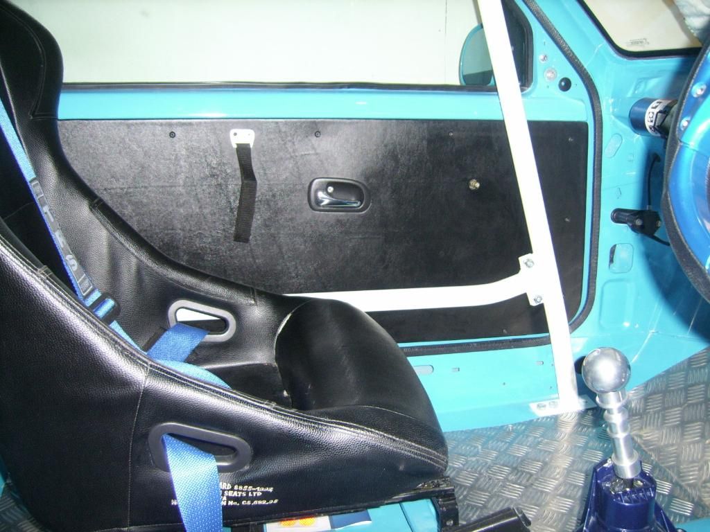

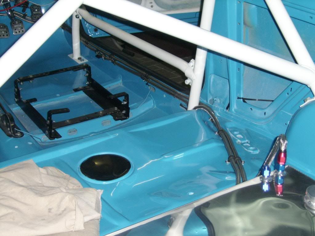

Top work! :agree:
What make roll cage is that? :confused:
:cool:
Looks miles better mate:agree:
Massive improvement! Keep at it dude!
Goobie
Top work! :agree:
:cool:
Cheers Goobie :) the cage is a safety devices jobbie, but I made the cross piece and got a m8 to weld it in.

I'm bored so thought I'd throw some pics up, I've got kentraider coming round Sunday to hopefully assist me in finishing everything off, I've got to put turbo on, exhaust, oil temp gauge sender etc, front bumper, bonnet. Fill up with coolant, change oil, turbo heat shield number plates bla bla bla I should be able to get turbo on later and maybe a few other bits so it shouldn't be too much of a challenge. Attachment 16554Attachment 16555Attachment 16556Attachment 16557Attachment 16558 just had an attachment welded onto my exhaust as the old flange leaked like a sieve, and I got the turbo elbow milled flat as it had a bit of corrosion. New turbo and rear lights.

And my new pressed metal number plates:cool: oh and my repaired oil temp gauge :) Attachment 16559 Attachment 16560 Attachment 16561
You have ph1 trim under the rear lights. So I'd say, whatever you do, make sure you match up. Either add ph1 arches, or use ph2 arches and change the rear trim to suit :agree:
Trevhib
:laugh: I actually forgot about this, you may have made my mind for me :agree:

My radiator had developed a weep, so I got a new rad from eBay and set at it with me hacksaw I had to get the outlet pipe to come out from the corner and at an angle to clear my boost pipe and for ease of draining it I added a bit more so I can reach it easier ;). Also had to cut the corner down to sit snuggly on the subframe where I've moved the rad over. I'm hoping to drive the old girl this Sunday weather depending :worship: it's only been over 3 months since I last drove her :crap: a few pics

Well as my clutch is slipping like me on an ice rink I've decided to pull it to bits a bit earlier than I thought :D I was bored also:dearme:
I've made a cardboard template to house my filter, this will be made from aluminium with a heat proof mat on the inside. I'm slowly taking stuff off ready to lift the car over the engine.
Other plans are too learn how too weld and then attack the subframe for some more strength then re paint. Might weld some more oe holes that I don't need in the engine bay as I'll be painting it again. That's it for now apart from my other plans in the above post. I think this might be my last semi big fling with the old girl, maybe I will part with her one day or maybe not :scratch: some pics
Yet another hour spent on the car :rolleyes: Wednesday I've got chance for a semi long day on her for the first time in a long time :).
As I'm going to be welding bits and pieces and painting the bay I thought it would be easier if the wings are off, so I've just taken the drivers side off. I'm glad I did because the part of the wing that is tucked in behind the side skirt has started to rust. This is my fault because I primed the wing then bolted/stuck it on then I painted it but the part behind the sideskirt is still in primer and primer is porus :ashamed:.
Oh and I'd sealed the exposed wing to the side skirt many years ago, so I ran a Stanley knife through it and then it slipped right into my alloy :sad: it's not that bad but it's very annoying.
Oh and most of you will be pleased, I've started to cut the side skirt off to be replaced with oe ones I only did this bit to get the wing off easier.
Anyway here's some pics.
Well I've just got a bit carried away with taking the old skirt off, I wasn't planning on doing this till after I'd got the engine etc out. Anyway I was itching too see if I had issues with rot so I got cutting, all was going fine from the front till halfway down, then I noticed a big load of filler :mad: it wasn't even sanded down just slapped in and job done. I dug it out and yep I've got holes :cry:. It's the only part of the car I've not seen in the 11 years I've owned it. Looks like ill be needing some new cills.
Pics
Its annoying but not the end of the world mate doesnt look to far gone either so hopefully just outers should be fine. Keep the updates and pics comeing :agree:

Right I'll warn anyone who hates shiney things too not look any further :D but for those who do like a bit of bling then enjoy.
Some parts I've collected from the powder coaters :cool:
I've also got a few things that I wanted black ie suspension parts, wishbone etc but on closer inspection they have got a dusting of very fine glitter from another job they done today. Somehow it floated onto my stuff aswell:sad2: should get that tomorrow. I'll pop some pics up in a moment.

Some pics essentially, always seems to take me three attempts :crap: it all looks miles better in the flesh as well :D
Are they silver coated or you polished them up? Look good either way. :agree:
They are a chrome effect powder coat, didn't even realise they did such a thing untill I walked in for a quote. There not proper blingy like chrome but more like a polished aluminium, which is ideal.
They defiantly look chrome/polish in the picture. :cool:

I've just braved the neighbours moaning and got the grinder and powerfile out :D: my intercooler pipe has been rubbing against the chassis rail and had taken the paint off and slightly dented it too.
So I thought I'd cut and shape in a piece off pipe, I think it was an off cut of stair hand rail I had kicking about. I'm 70% done with it, I just hope it's in the right place :scared: pics to follow, as you can't have an update without pictures :agree:

Hell yeah, nothing wrong with a bit of picutre whoring. :agree: :laugh:
That is one tidy job you done on that sneaky mod! Need a like button. :laugh:

I've finally finished all welding to the engine bay, all cellulose paint is stripped back to bare metal and I've just chucked a lavish coating of rust inhibitor everywhere :yeah: I'm so pleased because I was starting to get to that pissed off point during the stripping part. I don't think It will be dry tomorrow to put a primer over, but I will be primering my shocks, servo, steering rack, driveshafts, gear box, timing chain cover and water pump. Maybe I might just pull this off :cool:

How much? :D
Wasn't joking about filling every hole was you. :laugh:
You should seam weld the front whilst it bare! :cool:

My workload is getting bigger :cry: I've just ground away the rest of the aftermarket side skirt and offered up the oe skirt and it sits lower than the aftermarket one :crap: so I've now got to sand away a load of paint/filler where I'd blended it into the door shut. Which means I've got to blend the new paint into the old :crap: something I've not tried before. Oh well good job I've got next week off, hopefully I'll get alot done.

Brilliant work in recent weeks, well, brilliant work always tbh.
This side skirt and filler business, it will have been worth it once you've done it. :)

:ashamed: sorry mate forgot to reply. I think it cost £14 a litre. And I used half a litre for the front end, wasn't shy with it :D.

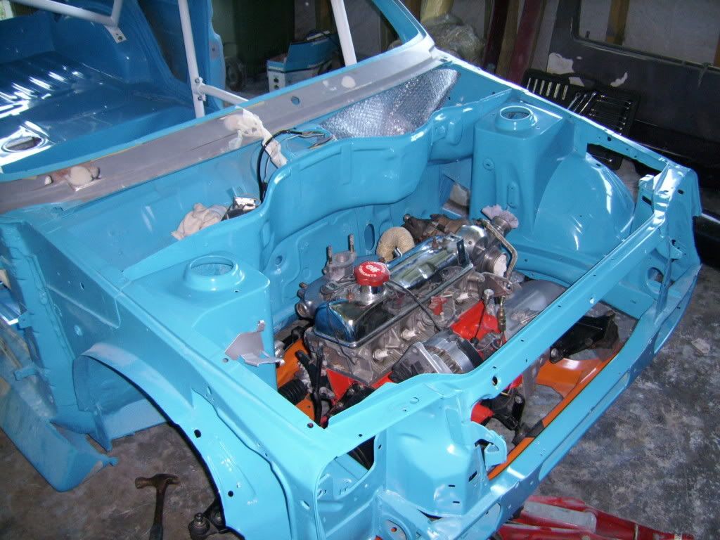

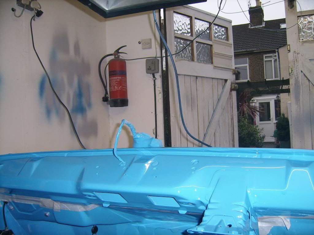

I've managed to prime the front end, gearbox, steering rack, driveshafts, timing chain cover, water pump, gear selector and the shocks today oh and the brake servo. I've just put a dust coat over the top of most of the items, so I know when to stop sanding. Anyhow the obligatory pictures that should follow any update are coming up next:D

Go Nad!!!!! Erm that sounds like gonad.... :D
Good work matey :) it's coming together nicely!

Yep it's very relieving now it's in one colour. I've still got to do some filler work over some of the holes that I've welded in, then put seam sealer over the lap joints, then stone chip where's needed, then another coat of primer and then I can put a top coat on :eek: and that's without welding on new sills :cry:
Smooooooth! :cool:
Love it!

Today I made a start on repairing the drivers side sill. It wasn't that bad only a 5pence hole right on the underneath and the start of some surface rust right near the end. So I thought I may as well just cut out from the joining gap to the back.
Then I found that my inner sill has started to rot :crap: underseal can cover a host of disasters and so it seems bodges by previous owners. Anyhow it wasn't that bad, so I've cut out the bad and have welded in some new metal. I didn't have any thicker metal so I made two identical pieces and plug welded them together.

And the extra plate to spot weld over the top,

Cheers Liam. Practise makes perfect, I've only been welding since January but have picked it up fairly well although it's not always perfect. Get back on your project and you'll get better ;) yep won't be long and you can come round for a gander.

Sill is now fully welded in position :D tomorrow evening I'll get back on the bay, seam sealing, filling bla bla bla :laugh:

I managed to get a coat of primer on yesterday but unfortunately it will need another as I didn't sand down enough in places and you can see sanding marks. I've just put on 4 layers of rubberized anti stone chip all under the arches, underneath the chassis rails and along the drivers sill. It's supposed to be white but is more a cream, never mind once the top coats on it shouldn't notice. Pics to follow

Top coat is now on :yeah:, just a few drips oh and I backed into the back off the front cross member :rolleyes: didn't do much damage though just some fibres from my overall stuck too it :D. Will get some pics up later

Just got a 2nd coat of por 15 engine enamel on the block, annoyingly it needs a third :crap:, sorry Goobie no pics untill it's finished :cooter: as you would expect I've gone for a subdued colour :D anyone want to guess it

And the winner is Phil :D I plumped for Chevy orange out of there choice, although on the internet it looks more red than orange. But in the flesh it's definitely orange :laugh:

I was hoping to get alot done yesterday but unfortunately it didn't happen, it took me 30mins just to find my timing chain oil seal :crap: anyhow I did manage to get the timing chain cover, sump, manifold, flywheel, clutch and the gearbox on and a few shiney bolt on parts :D had to cut the dayshort as I had a 12 hour night shift to do. Day out with the kids today and after only having 3hours sleep I doubt I'll go out there tonight :coffee: some pics
Woah, I do like that painted block. :cool: Bet that's some serious colour in the flesh. :agree:
Your right there Goobie, it changes colour depending on light conditions :scratch: I've booked lieu leave tonight and tomorrow night so I'm hoping to get alot done.

Webber, the colour is Chevy Orange :)
Liam, I reckon that tin could put four coats on 6 c1j engines, I've hardly made a dent in mine. Pop round whenever you want. Either text or pm me

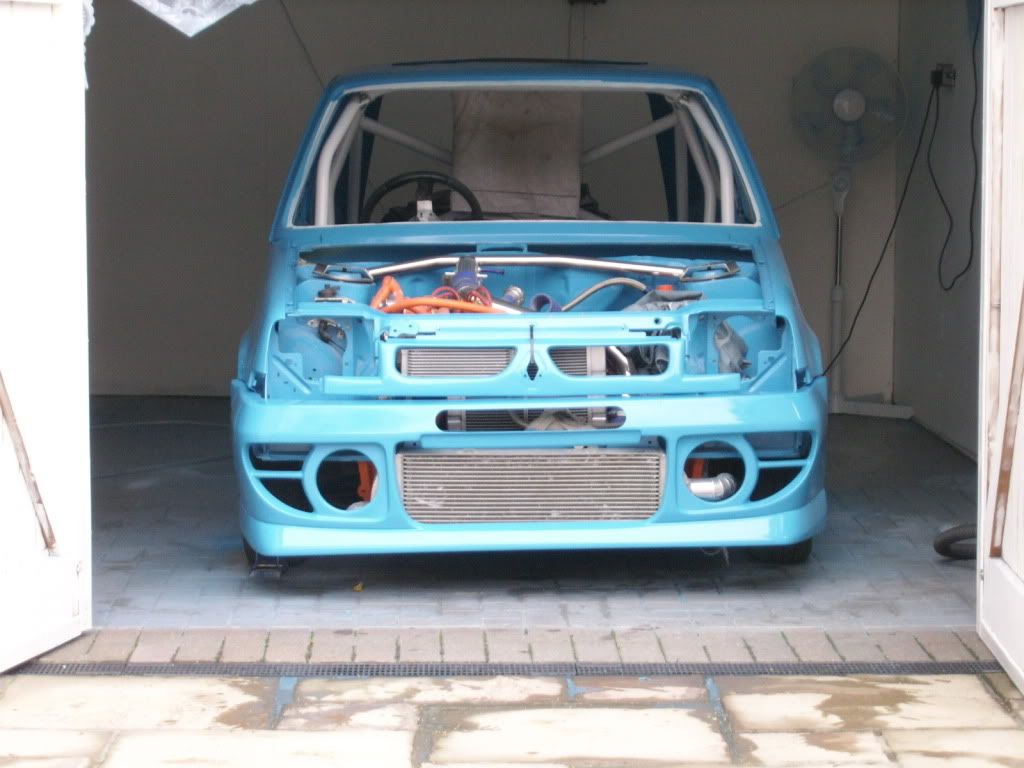

Just rolled in from the shed, yawn. Still finding things to bolt on including the horrible poly bushed wishbones.
I had to lift the engine up Then place the wishbones where they looked like they would line up and then drop the engine down and hope that they slipped into position which it did but I've only finished one side. Anyway mainly a picture update as I'm off to bed :D
5 Attachment(s)
When you have a job/family/house you have no choice but to turn nocturnal....just without the sleep during the day.
Looks all worth the effort, it's immaculate :agree:

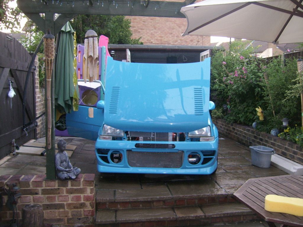

Just a few update pictures. Slowly getting there.

Electric blue from top to bottom:cool:
Some serious progress here :) Love all the pics, keep em coming :agree:

Cheers chaps, did want it done for the weekend show but never mind.
I must say, now i dont post much! but that looks :eek: good job!
To many things I like with the latest picture whoring Nad that I can't single out one particular part I like most. Love theses DIY builds, car just looks mint at every angle in every picture. :cool:
It's to clean to be a Renault 5! Please let me throw some dirt or a few specs of dust over it at lest! :laugh:
Goobie i was going to say that!! needs oil dirt and rust to fit in with everyone lol
good to see you sat mate at last. great weekend. shame you couldn't bring her along. also i doubt i can make Santa pod as im working lates unless i pull a sicky that is :sad2:
Lovely clean build. Love all the colour coding and attention to detail, makes me want to pull mine apart and start again!

Just had some new oil lines made from a local hydraulic company. Have now got these fitted, so I can now start putting all the water hoses on etc.

I would have been inclined to mount that oil cooler vertically (next to the side tank on the rad) and block the rest of the hole up so you get as much air through the rad/oil cooler as possible. Your rad efficiency will be massively reduced how you've done it.
Looks minty fresh though fella, keep up the good work :agree:

Dave, you make a good point, but when you think of where the bumper and grill sit, it's probably better where it is?

Cheers for the comments Dave, I've never had any cooling problems before. But with your experience I'm not going to say your wrong either ;) the oil cooler has maximum flow to it through the grill where it's positioned.

:agree: but I would wouldn't I :laugh:

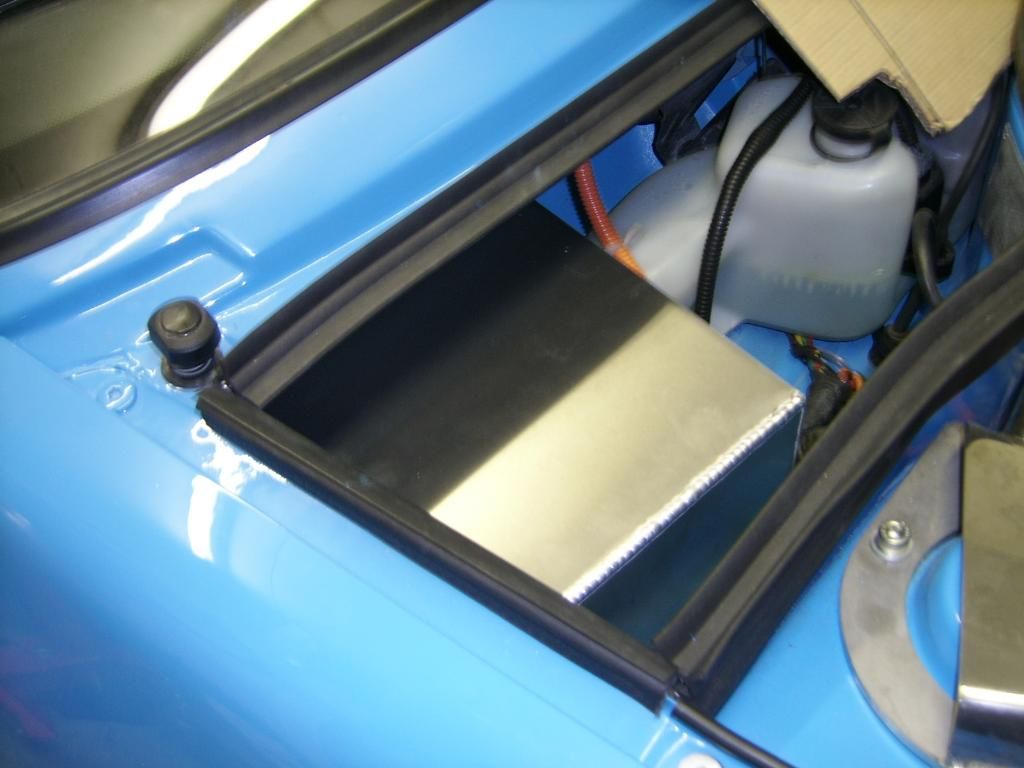

Electrics are now sorted :) I've also moved the header tank over behind the drivers headlight. Had too cut 20mm out of the tank and get it welded together again as it sat too high and would have touched the bonnet :crap: I'm going to try it first without the swirl pot as its so much neater, but I can revert back to the pot if I need to. The 13mm hose joiner has just literally turned up so I can now complete the water circuit, unfortunately my missus works every Saturday so I'm with the kids and I'm not going to get much time tomorrow due to fathers day :cry: some pics for you

Ye it will get flow, but not maximum as it's not got a shroud around it to force the air through ;) . If you got a fan and some smoke you would see that hardly any air would pass through the oil cooler or rad.. Air always (like water) takes the easiest path possible.
Although you didn't have any problems dosen't mean to say its working 100% efficient :cooter:

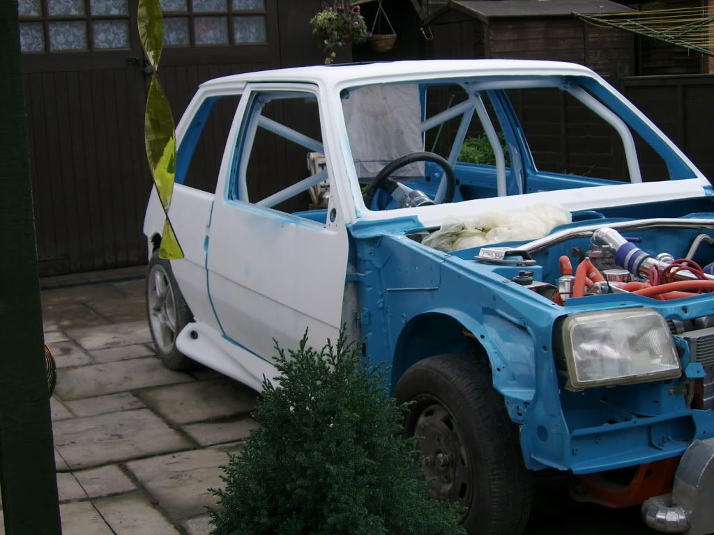

I have recently had to put my Springer spaniel too sleep :( and have been scouring old photos off her.
Anyway I stumbled over some pics off my 5 when I had just bought it back in 2002 I think :scratch: there a picture off a picture hence the crap quality
I can't tell if it's just the angle of the photo or is there a huge amount of camber in wheels?
Perhaps you were the first person to start the euro scene!
:laugh: no I was holding the photo and its curved as I'm holding it. It does look like it's got mega camber going on :laugh:

Just hung the door back on, and the colour match is spot on:cool: I've now turned the car around ready to cut out the rot out I uncovered on the passenger sill.
