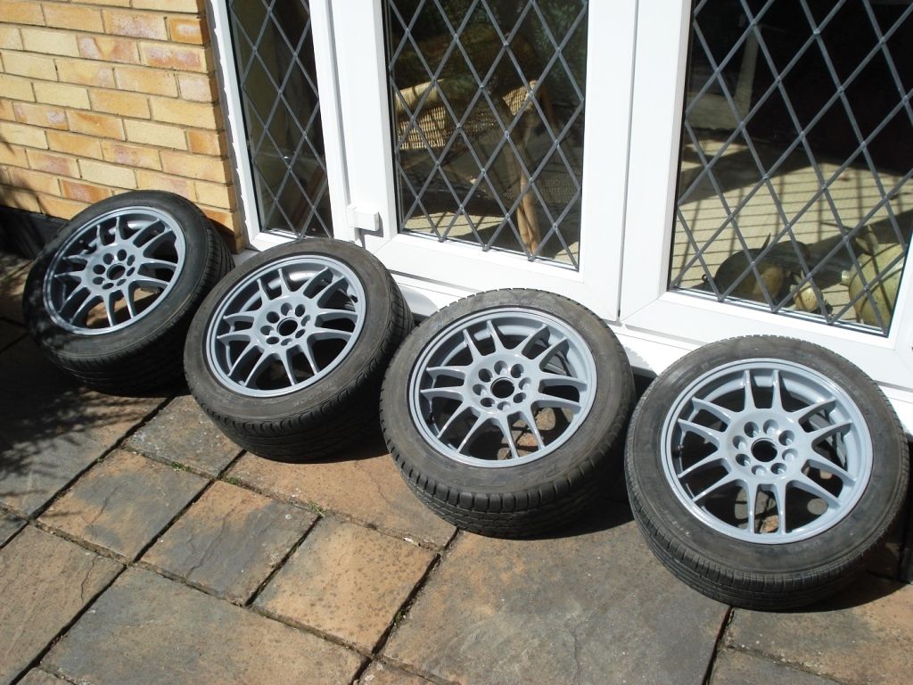

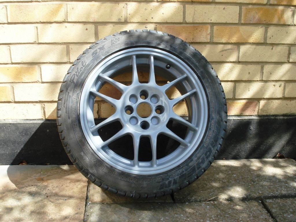

They're changing colour and should suit the racing blue colour
Painted 1 wheel today

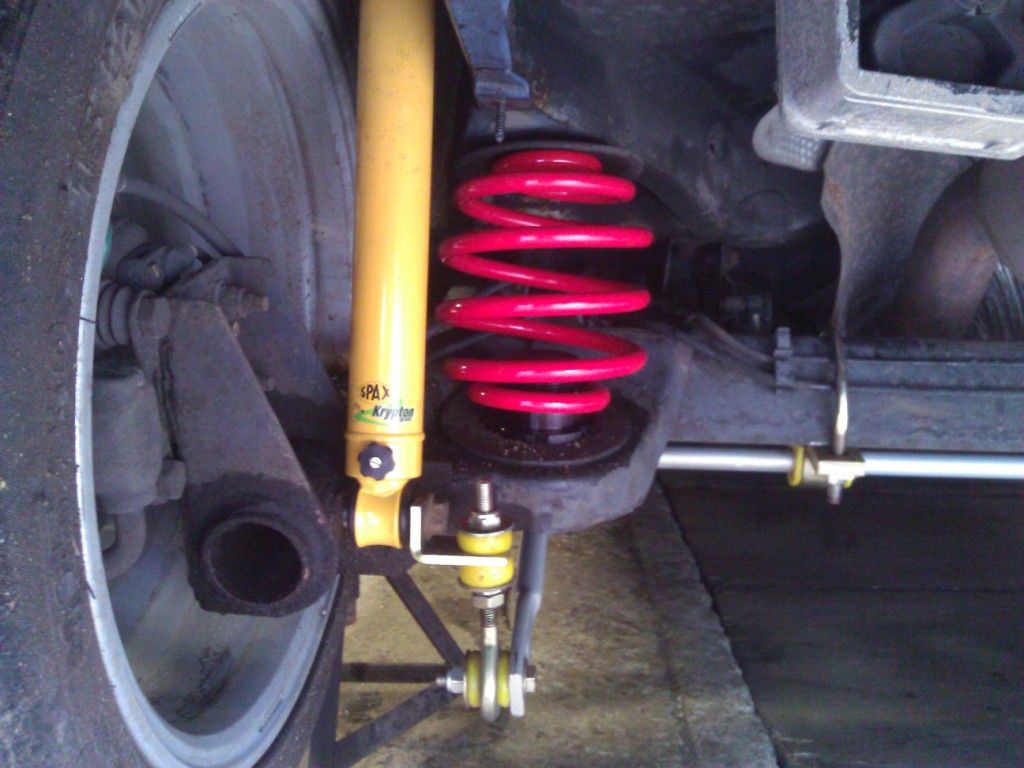

Another job done after work today, the GAZ rear damper lower bush insert had worked its way loose so the damper was knocking on the lower bolt. Thankfully a 2nd hand set of GAZ dampers came up for sale for £30 the pair so i bought them as an interim solution while the Spax coilovers are on order.

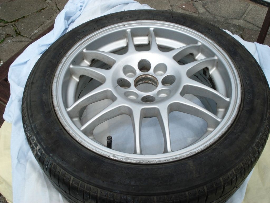

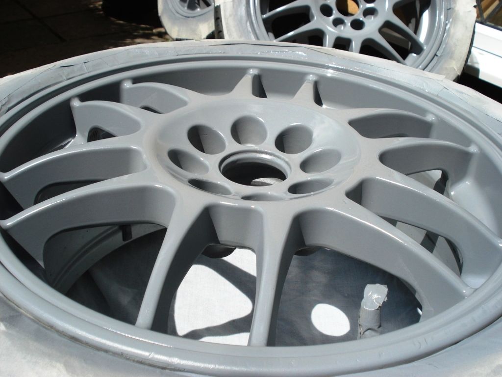

I also said to myself, never, NEVER will i spray a set of wheels AGAIN! :wasntme:
These are just for track so whats the point............... Until i was having a rummage in the store room and came across some primer cans :ashamed:
I flatted them back but wasn't really bothered about the kerbing on the rim edges, i liked the primer that much i ended up lacquering them afterwards. I think they'll look ok next to the Racing Blue. So, Spax on, geo setup and its ready to go for Blyton
http://i323.photobucket.com/albums/n...1974/RB025.jpg
http://i323.photobucket.com/albums/n...1974/RB031.jpg
http://i323.photobucket.com/albums/n...1974/RB033.jpg
http://i323.photobucket.com/albums/n...1974/RB034.jpg

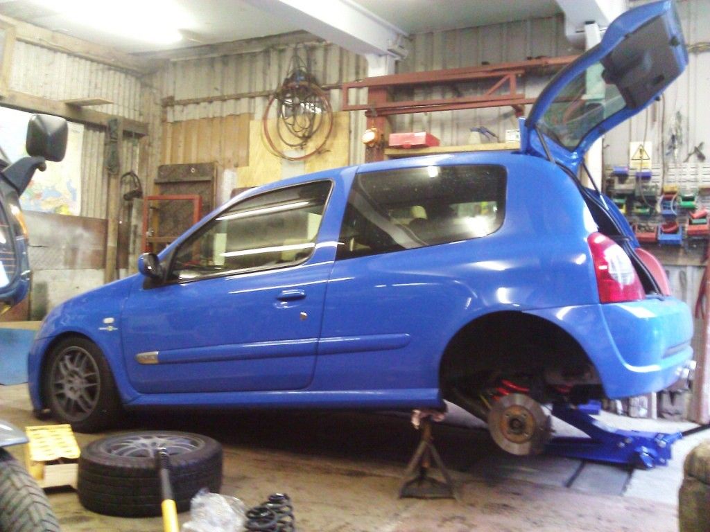

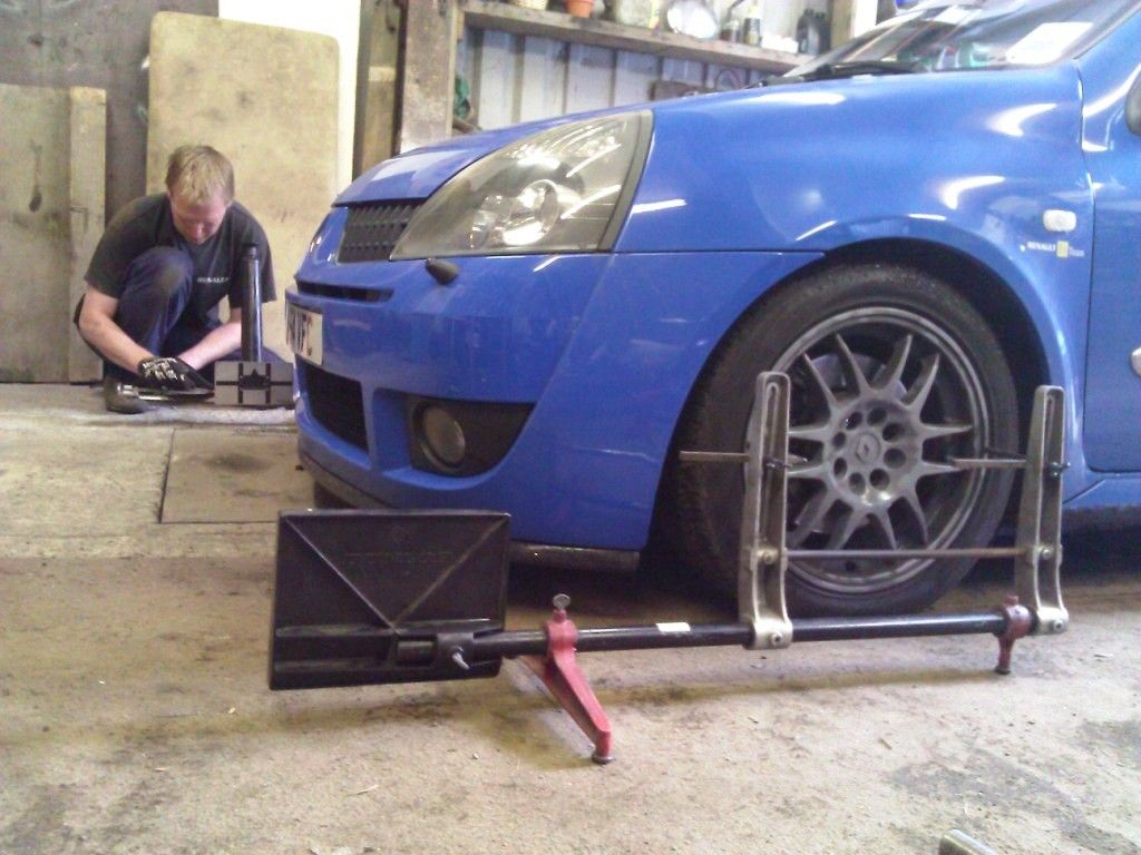

First, apologies for the crap quality pics (taken on the HTC phone)

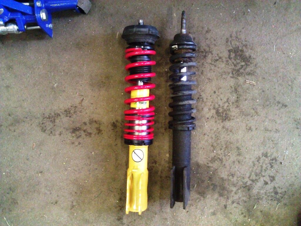

A big thanks to Matt at Codered, i went to his workshop today to have the new Spax RSX coilover kit fitted along with the Whitline rear anti roll bar.
http://i323.photobucket.com/albums/n.../WP_001050.jpg
Grubby, seized GAZ compared to new, shiney Spax :)
http://i323.photobucket.com/albums/n.../WP_001059.jpg

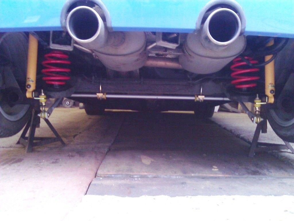

Rear dampers, adjusters and springs fitted
http://i323.photobucket.com/albums/n.../WP_001052.jpg
Whiteline fitted, then realising the bracket bolted to the bottom of the damper needed pivoting 180 degrees. In doing so it brought the roll bar more in line with the rear beam
http://i323.photobucket.com/albums/n.../WP_001056.jpg
Ride height all sorted, the rear adjusters are on their lowest setting. Even with this it sits higher then the GAZ setup, the Spax springs are slightly longer. All done with half a tank of petrol.
The Spax front ride height is set to 10mm higher than the GAZ. The top hole on the front damper is elongated for negative camber, with the hub set to max negative camber the wheel rubs on the adjuster so the hub is pulled back the other way. It's still only millimetres away so the plan is to fit a set of 5mm spacers just to clear the damper.

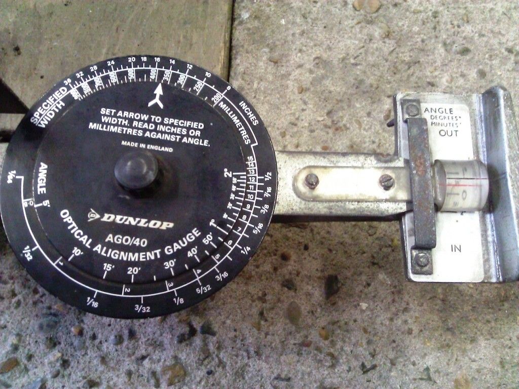

Geometry time: Once the front and rear dampers are on its then time to set the tracking and check the camber. Now the coilovers are on i'll hopefully book in for some trackdays along with hopefully sprinting. With this in mind Matt's tweaked the toe to just over a 1mm of toe out to start with, pulling the hub on the elongated top hub hole has given it 2 degrees of negative camber. This should be a good compromise for both track and everyday driving to and from work. The dampers also have over 20 settings on the damping rate so as a start off point they've been set to half way.
Old school setting up
http://i323.photobucket.com/albums/n.../WP_001060.jpg
http://i323.photobucket.com/albums/n.../WP_001062.jpg
Initial feedback on the drive home is positive, with the damping set half way the ride feels good and not too harsh. Found a few country roads earlier and have to say the turn in feels a little sharper, overall a definite improvement. Bring on Blyton :)

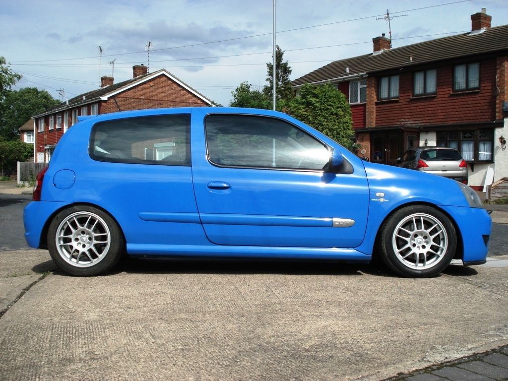

So, gave it a wash and took some pics. I don't think i can improve on things now, mechanically it's done. New brakes all round, new suspension, 2 sets of wheels to choose from. If anything it will be minor changes as i go along.
http://farm8.staticflickr.com/7140/7...141b3f98_z.jpg
RB 053 by Ricard o1, on Flickr
http://farm8.staticflickr.com/7273/7...b786e060_z.jpg
RB 055 by Ricard o1, on Flickr
http://farm8.staticflickr.com/7253/7...137203a3_z.jpg
RB 047 by Ricard o1, on Flickr

your toe out settings, is that total toe out or each side?
Re: Its new, and its blue (182)
Adey aka Ewok
Hopefully Matt will be along to answer that :ashamed:
I'm sure it was half a turn on the track rod each, I think

1mm total on the dunlop guage, this thing needs to be driven on the road most of the time (trying not to eat the tyres every 100 miles) but needs a spot of decent turn in on track.
Adey, it's been set up on the 15" wheels btw.
This is a base setting to work from, plus it's easy for me to remember.:laugh: I'm getting old....:mart:
