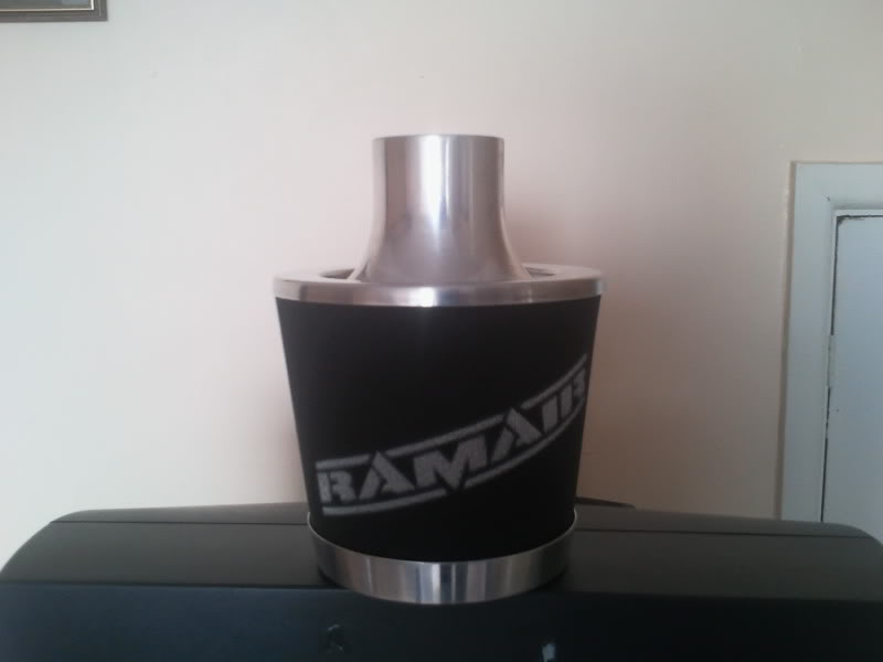

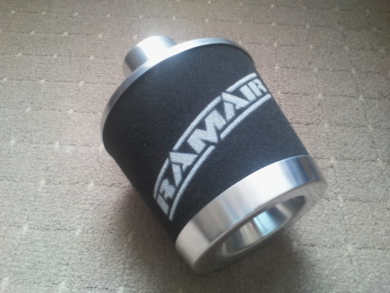

pipercross viper induction kit mounted behind the grille

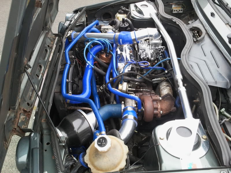

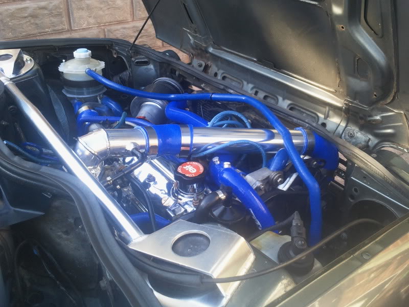

Loving the bay mate looks nice an clean, only thing that would drive me crazy is the yellow tinted header tank.
Thanks Mat
Re: plans for spring/summer
thanks fella i know its bloody driving me mad that is i might have to invest in a new un or get mine cleaned up

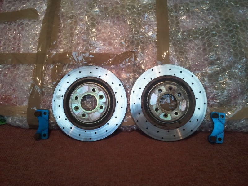

my new much needed investment ktec big brake conversion £82 all in not bad at all
http://cgi.ebay.co.uk/ws/eBayISAPI.d...T#ht_500wt_715

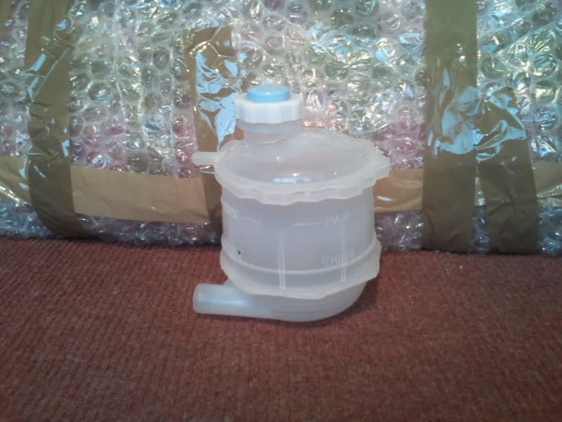

and also have treated the car to a new header tank and cap

couple of updates for you all
received the ktec big brakes and new header tank last week
http://i428.photobucket.com/albums/q...5-08192331.jpg
http://i428.photobucket.com/albums/q...5-08192406.jpg
should help me stop better and that header tank will tidy up the engine bay as mine was tatty as you can see from pics

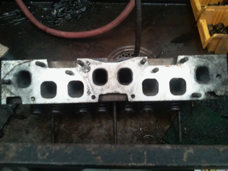

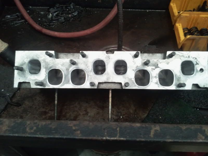

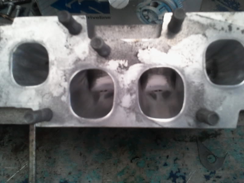

few updates for you all cant say how happy i am with the headwork and inlet work thats been done by justin at am motorsport
before bb tuning poor work head
http://i428.photobucket.com/albums/q...5-11154023.jpg
after am motorsport bw head
http://i428.photobucket.com/albums/q...5-11154056.jpg
http://i428.photobucket.com/albums/q...5-11151700.jpg
had alot of work done to it also the inlet has been really ported out and also had the exterior flatted down and mirror polished ill get pics asap. also taken the opportunity to clean all the samco hoses whilst all off the car they have come up really well and look like new
will be getting car back this week with a bit of hope we did find that it needs a new passenger side wheel bearing so one of them will be going on

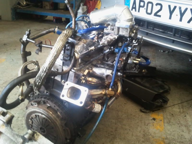

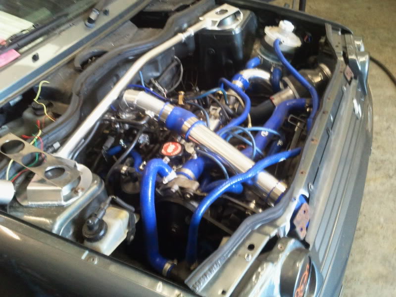

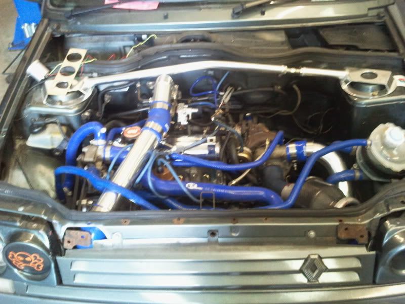

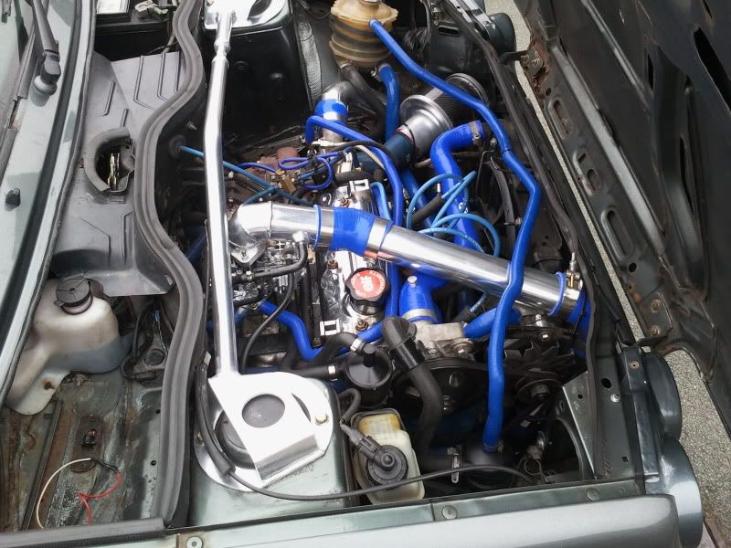

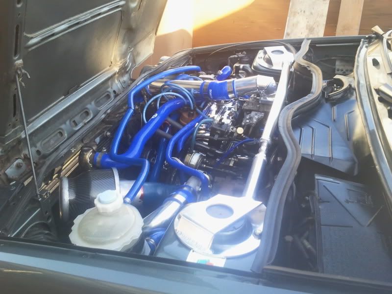

engine is now all built back up with the tubular manifold fitted just a case of dropping it in the bay now and then the fun begins,
http://i428.photobucket.com/albums/q...5-17133150.jpg
not the best of pics but you get the idea :laugh:

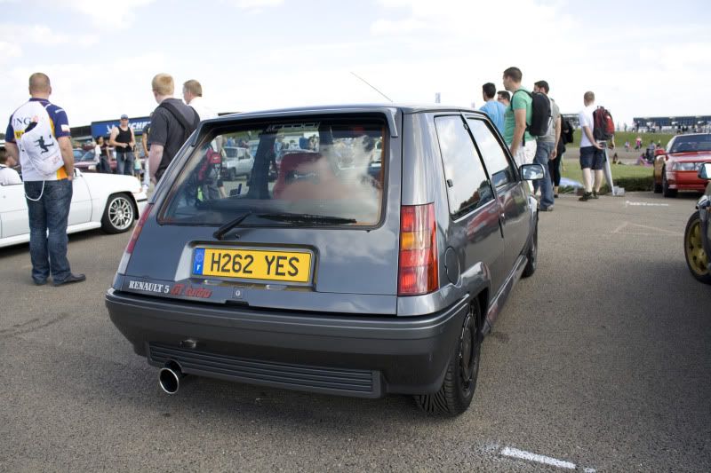

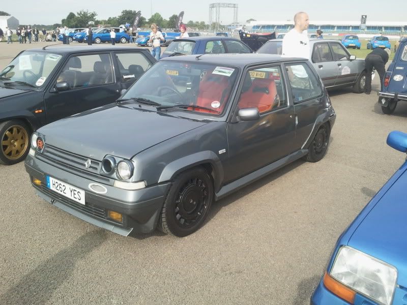

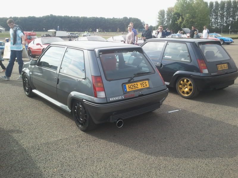

well guys had a good day out at the national day was good to finally give my car a pretty decent run out 130 mile round trip ;) it performed brilliant didnt miss a beat and used half tank of fuel had a few :burnrubber: there and back my god it bloody flies hehe.
couldnt believe my eyes on the way back as something appeared in my rear view mirror which was only a jag xj220 how big are them things :laugh:
took a quick pic of my car at mallory
http://i428.photobucket.com/albums/q...forlife009.jpg

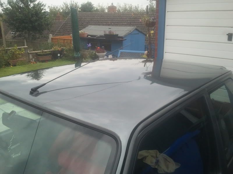

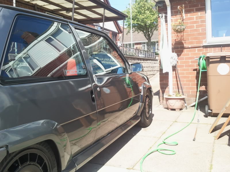

got a few pics of my car from earlier all nice and shiny
used poorboys black hole glaze and dodo juice supernatural hybrid can say the combination beats ag srp and ag hd wax by quite a bit. sorry bout pic quality light is rather poor, good old british summertime eh lol
http://i428.photobucket.com/albums/q...7-21174402.jpg
http://i428.photobucket.com/albums/q...7-21135126.jpg
http://i428.photobucket.com/albums/q...7-21160930.jpg
as you can se it rained whilst i was doing this luckily id just finished my last panel on the car.

just received my new induction kit to replace the pipercross viper (now for sale). ramair kit bought brand new direct from them £40 which i think aint too bad :)
I bought a Ramair for mine, fantastic value! :)
Defo agree with you there mate i just wanna try it see if it flows better than the viper

little update
turbo is now removed from my car and off to have the new turbine wheel machined into the .63 t2 housing and its not a t25 tomcat turbine im going for ;)
also a bloody brand new wheel bearing gave up on me after only 225-230 miles so mike is sorting me one for half price which is a great gesture by him :agree:
