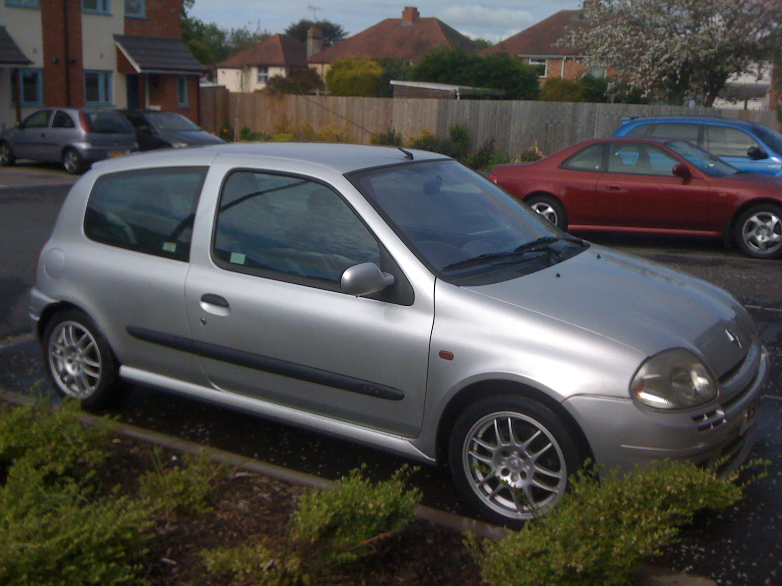

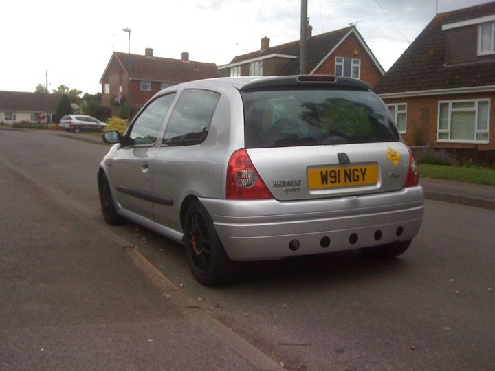

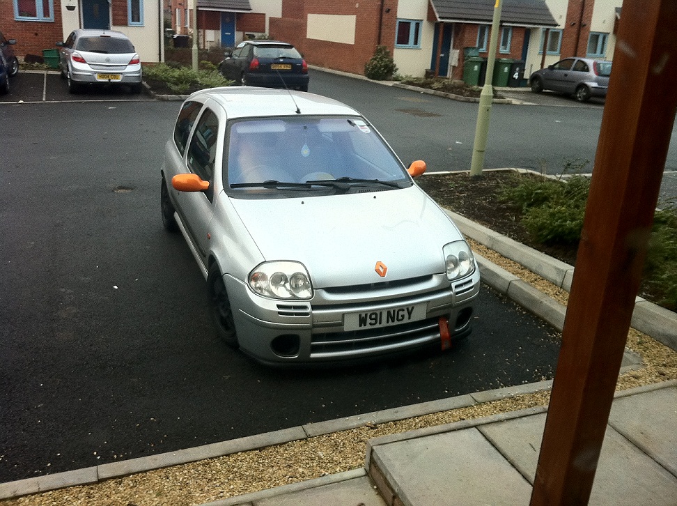

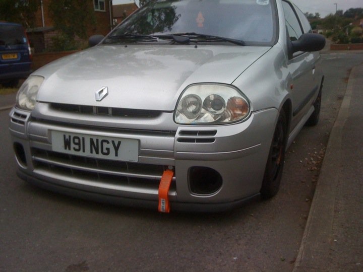

after a few weeks when the kw coilovers were fitted, along with the inside stripped out. also thrown into the mix at the same time was a decat pipe, itg filter and a ktec stealth system. made the car handle a well and the engine sounded a little better, well untill a high pitched squeel aroze from the engine, lucky for me i caught the cam belt tentioner before it let go, so at 88k the belts were changed on my drive by a mate of mine, came down and did it at cost for me + macdonalds :agree: http://www.519automotive.co.uk/
how she rocked after some work
https://www.rtoc.org/files/Technical%...clio/front.jpg
https://www.rtoc.org/files/Technical%...cclio/side.jpg
https://www.rtoc.org/files/Technical%...cclio/rear.jpg

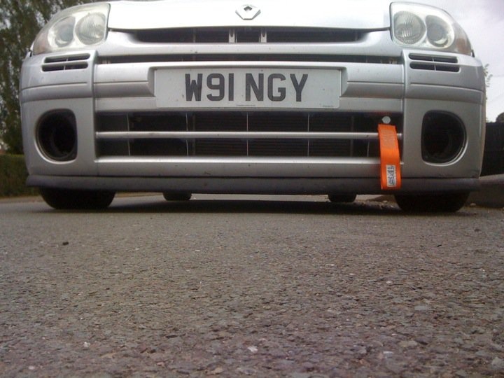

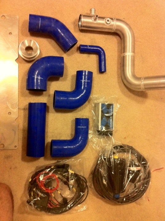

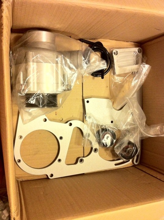

did a few basic things, ph 2 rear lights, cup spoiler, tow strap and painted the wheels, also fitted a bucket seat and dropped the steering rack lower, fitted a recon gearbox as mine had lost reverse. since the pics ive picked up a few bits and changed a few things, im at max camber adjustment up front before the tyre hits on the coilover and i spaced the rear stub axels and gave them some camber,+15mm each side, has made the car feel very safe in the corners but still feels like it needs more camber up front. and the supercharger kit :)
https://www.rtoc.org/files/Technical%...lio/sckit1.jpg
https://www.rtoc.org/files/Technical%...lio/sckit2.jpg
https://www.rtoc.org/files/Technical%...lio/sckit3.jpg
https://www.rtoc.org/files/Technical%...lio/sckit6.jpg
should see about 250bhp but will update as i go, should be on in the next few weeks :smokin:

just out of interest is the idle pulley wheel tensioner ,above the main crank pulley standard on the f4 set up?
and would it fit on the f7,it seems to share the same water pump judging by the pictures,im guessing the crank cover plate is the same also :scratch:
would be a bonus if it did, that would add a bit of tension to my belt set up:D
part number anyone?:)
great car by the way,nice to see something stealth and different on the a clio:cool:
Re: clio 172 (time for some boost)
the onein the pics is part of the kit, it uses a ford idler pully on a custom bracket, ill take a look under the bonet of the clio tomorrow and see what the stock setup is like and let you know

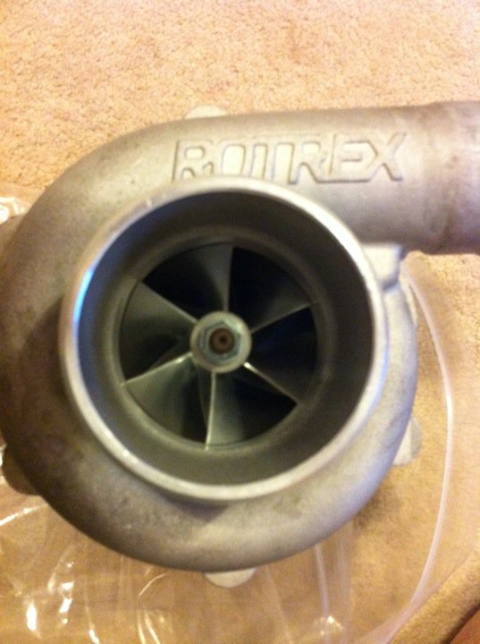

t. and the supercharger kit :) should see about 250bhp but will update as i go, should be on in the next few weeks :smokin:
How much was this little piece of kit if you don't mind me asking?

Andrew Warren
retail for the charger unit is between 1400-1600 i think

so if somebody takes the plate dimesions/ makes a template, and sources the rotrex else where... :cooter:
how much are those rotrex units new ??
That was the price for the rotrex unit
Adey aka Ewok
:eek::eek::eek::eek:
think i will stick with my eaton:laugh::laugh::wasntme:

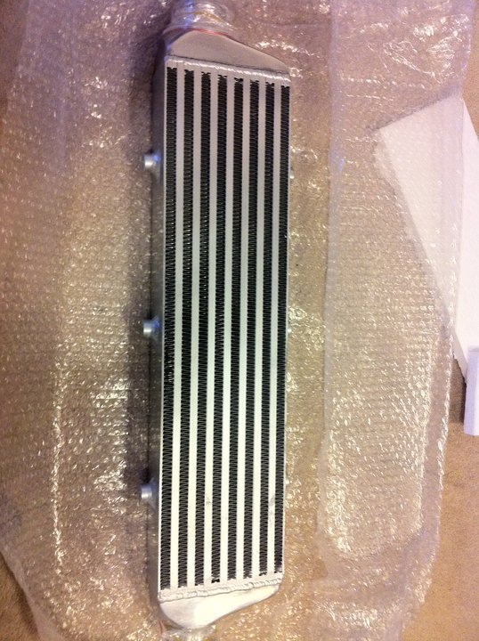

not much going on with this at the mo, snow is killing deliveries of bits and knowing my luck they will be lost. ordered a meggy 225 bottom pully from renault so thats sorted, still waiting on the rs inlet and ptfe gaskets and the injectors, add them to the belts fluid and sensors that are sat at the workshop i cant get too and it equals me not having my supercharger fitted over crimbo :disagree: only thing thats actually got to my door is this
https://www.rtoc.org/files/Technical%...ntercooler.jpg
ling long intercooler, should do the job ok so thats one mor3e lhing off the list. kinda a blessing as we took on a last minute job at work and i managed to nearly chop off the end of my middle finger, aparently lucky not to of lost it tho it was hanging off and the bone is broke so not really in a position to be getting oily and grubby any way and i dnt think i could of got far with one hand.

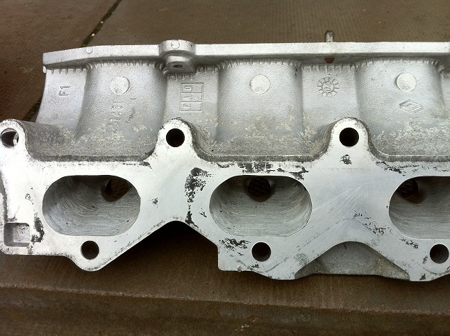

not much gone on the past week, ported rs lower inlet turned up, so i fitted that on tho till im back in work i cant match the upper part, doesnt look to hard, the lower section has just been taken out to the gasket, suprising how different the stock one was to the ported item
https://www.rtoc.org/files/Technical%...nletresize.jpg
vs
meggy 225 injectors also turned up and a friend picked up a meggy 225 keyed pully for me from renault, borrowed the cambelt tools and thats about as far as i got, cant do too much else without the other sc bits so i got bored and painted my wing mirrors and front diamond.

so today saw her start up for the first time, alot done but not quick enough, i really needed to get her to the point of starting this morning so the mapping could be done in the afternoon but due to waiting on yet more parts it didnt happen untill this afternoon. the chap who was going to do it for me is off to autosport tomorrow now so itll have to wait till next week. it gives me some time to finish up some small bits as ive thrown this together in abot of a rush, small things like proper mounting of the intercooler and oil cooler, tidy up of the wiring in the bay and in the car as i relocated the battery to the wheel well in a pikey fashion.
happy to say on a ruff map taken off a 182 she started first time with no leaks :agree: the noise is abit different and act quite loud, will try and post a vid of her if i can. tommorow i will tidy up what i can and take her for a small test drive to double check for leaks and make sure she doesnt throw a belt or anything but it looks like she wont be ready untill the end of next week now :-(
https://www.rtoc.org/files/Technical%...cclio/5pic.jpg
i decided to check the gearbox oil and couldnt feel anything so thought it best i top her up, a bit of a worry was she took the whole 3 ltrs :confused: so not sure how long the box will take the increased abuse
https://www.rtoc.org/files/Technical%...cclio/6pic.jpg
its uber tight under the bonnet now so a few things will be moved in the future, a front mounted fan is defo on the list.
https://www.rtoc.org/files/Technical%...cclio/7pic.jpg
getting there.
https://www.rtoc.org/files/Technical%...cclio/8pic.jpg
how she sits now, had to remove the fog light surounds as they were hitting the oil cooler and intercooler pipework. ive opted to leave the grill out for now as i think the filter needs as much cold air as possible and the side of it is pressed up against the rad. cant wait to get her fully finished and running flat out :agree:

Not sure how it will cope high up the revs if I was to raise the limit, it's a c30-94 rotrex charger, think there good for 400bhp? I run it with a restrictor to limit the boost on it at the mo so it's very responsive as it's pulley size is designed to give its full speed and boost
Adey pm me any details you have on the rotrex stuff and if you get any super rates on them - can get trade I guess but they look expensive :scared:
Seems for the 1st time in my life I will be building / running a sc powered engine and can get the eaton stuff for next to nothing but the rotrex would be an easier conversion and from what I am told a better unit. So suspect the engine will be a miss match of other parts to lower the compression and whatever else I can steal, got a M112 for free off an Aston Martin but also the M62 for beer tokens avaiable but not actually looked at spec yet to match to the 1.8 16v zetec lump.
Got some vag 1.8 20v pistons so they are getting mated to the ford rods and arp the bolts (shot peen the original rods while there) current cr is 10:1
It's nice and tempting to throw a load of cash at it but with 534kg (wet and loaded up) do not need big numbers this year to have some fun. So plan is pmt :laugh:

Feel free to get a template knocked up of those SC brackets me old fruit ;) :agree:
Mart
lol funny you say that, when i get to changing mine with a different material design ill possibly ask around and see whos intrested, no promises tho

I dug out some paperwork for the brackets and it states 6082 Ali as the material?
my damaged bracket shoul dbe back with me in the next few days, the cad drawings are being modded to add extra strength to the part that broke then ill get them sent off for a price to be made in zinc plated steel.

well its been a bit of a bad few weeks tbh, the supercharger has destroyed itself internaly:cry:currently trying to get a replacement but rotrex can be a pain to work with and dont cover oil contamination. the cause is either contamination causing a bearing to fail and **** itself or the bearing **** itself then contaminated all the oil. this then took out the internal oil pump. im not confident ill get another one :( and funds are very tight at the moment so i wont be able to replace it any time soon. i did have the bracket fixed and strengthened but thats just sat in the foot well at the mo as without a charger i have no use for it atall. on top of that the new runabout i got to use while the clio was off the road blew itself up within 3 days lol. back to the multi coloured auto corsa :agree:
if i cant get a new charger chances are ill either break or sell the clio off and start something again over the winter i guess. even with all the joy it gives me to build and drive im getting very tired of having to fix or fund it, kit car with all sandard from the scrap yard parts could be a new direction for me

Anyone interested in the bracket setup from my car? I'll even include the idler pullies and correct length belt. Cars been sold stock to make way for a new project. Will get some pics and chuck up a for sale add in the next few days but pm me if you want them
