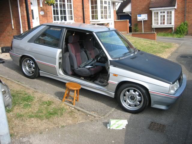

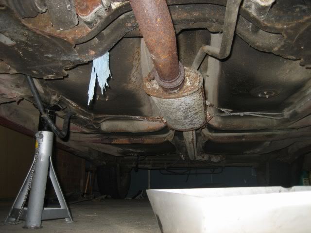

Now that the Red bodyshell was history I could turn my attention back to the Silver 11 and start to make that in half decent order ready for the National Day last weekend in Mallory Park.
The first thing was to have a good look at the Silver 11 & see what state everything was in & what needed doing to make me feel safe driving it. I had a good look all over & found that the bodyshell & underneath were all in surprisingly good condition:
http://i306.photobucket.com/albums/n...t/P1030631.jpg
http://i306.photobucket.com/albums/n...t/P1030640.jpg
http://i306.photobucket.com/albums/n...t/P1030641.jpg
The next step was then to look at the suspension and I managed to source a new set of Old Stock Front Koni Adjustable Dampers & lowering sport springs & fitted them to raise the front up to something higher than the snakes belly fitting that was there!
http://i306.photobucket.com/albums/n...t/IMG_2253.jpg
I also fitted a set of Renault 25 wheels & tyres I had been hanging onto for a while to see how they looked? :scratch:
http://i306.photobucket.com/albums/n...IMG_2256-1.jpg
The car then looked like it was scraping it's @rse on the floor so I decided to again break another cherry with this car & that was my first time at adjusting the rear torsion bars?! :) Thankfully everything worked our there & they were not siezed at all!! :niceone:
I managed to get a picture of the two cars together before the red shell went to the crushers!!
http://i306.photobucket.com/albums/n...t/IMG_2313.jpg
With the car sitting level now I wanted to bin off the Renault 25 wheels I had that had the STUPID small tyres on that made the car look like it was a bleedin rollerskate so I sourced a set of Clio Williams Steel Wheels and had them powdercoated Shiney Silver.
I think you can see the difference between the old and new wheel rolling diameter?! :rolleyes:
http://i306.photobucket.com/albums/n...t/IMG_2384.jpg
It was then the best part of getting some new wheels for any car.... the fitting & pictures before & after?!!! :yeah:
http://i306.photobucket.com/albums/n...IMG_2352-1.jpg
http://i306.photobucket.com/albums/n...t/IMG_2357.jpg
I fitted the tyres with 195/50/15 Kumho Ecsta tyres which more closely match the original rolling diameter of the 175/60/14 original's ;)
I was then ready for National Day last weekend and had a cheeky picture of my two girls together :rolleyes:
http://i306.photobucket.com/albums/n...t/P1030012.jpg
The final step was to fit the new Private plate I treat myself too becasue I'm a bit of a tart like that! :jerkoff:
http://i306.photobucket.com/albums/n...t/IMG_2404.jpg

Wanted to update the thread with a couple of the things I had done over previous weeks.
As usual with old Renault's both front doors are suffering from the dreaded drop so thanks to philg's guide in his thread I got hold of some new bushes & drilled out the hinges on the drivers door and car with an 8mm Right Angled Drill and fitted bushes and 6mm bolts.
Was a little concerned that it was all going to end in tears, :scared: but thankfully it all worked out well!! :D
http://i306.photobucket.com/albums/n...t/IMG_2406.jpg
I also noticed that the engine mount on the gearbox had broken so I got a new mount from E-bay and fixed that. I thought that the mount was the same as a 5GTT but it isn't. :crap:
http://i306.photobucket.com/albums/n...t/IMG_2399.jpg
http://i306.photobucket.com/albums/n...t/IMG_2401.jpg
Yesterday I thought I would make a start in sorting the seats out becasue I noticed that the previous owner had swapped the front seats around becasue the right hand squabs were both buggered and torn.
http://i306.photobucket.com/albums/n...t/IMG_2407.jpg
I took the seat out and stripped it down to the bare shell and found that the metal bracket had broken in the frame :eek: So that made the seat frame useless.
http://i306.photobucket.com/albums/n...t/IMG_2413.jpg
I ended up poaching the best parts from the Red 11's seats & re-fitting them,
