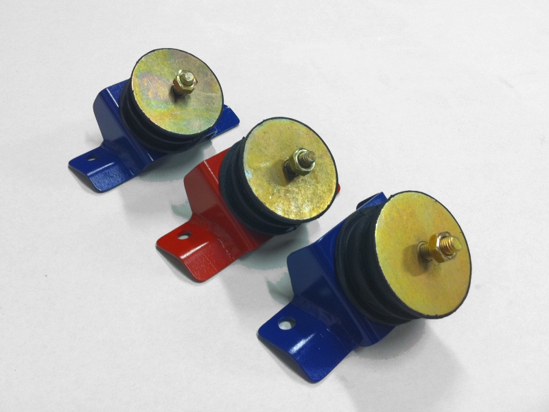

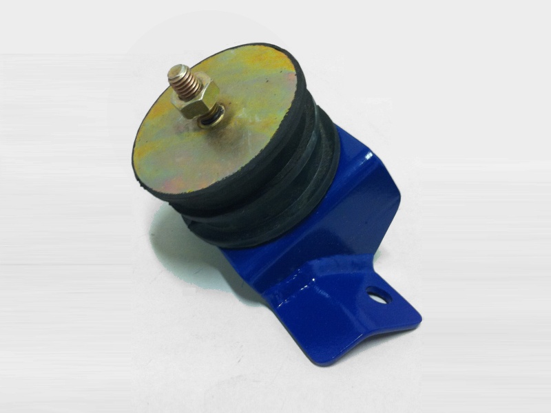

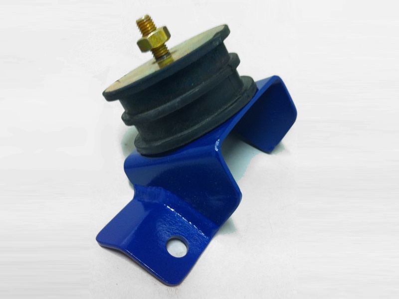

I've been talking about these for long enough, so it was about time I got to work!!
I have made a jig to allow the production of some stiff rear engine mounts. I don't really need to tell you the benefits of stiffening the engine up, because if you don't know how that helps then you probably don't need one! In short though: improved control in hard launching and between gears. Reduced gear lever movement also. The downside will be an increase in vibration and noise, so probably not for cars that spend most of their time on the road.
The mount is very similar to the ones I've done in the past for select folks only instead of the uber expensive uprated VW mounts they instead use a common but hugely uprated rubber mount from a landrover V8. Pro's are that they're cheap to buy and replace in the future. Cons are that they are not as shiney ;)
Some pics attached. They bolt right into the normal location without the need to modify a thing.
If you want one then let me know, I'll just make them as people want them. Some of the steel is a bit on the steep side and they take a good hour to make each one so they need to be £40 + £4.00 recorded p&p.
Any questions, fire away :cool:

Cheers all, I've took some better pictures and added them to the first post. Working my way though the list, thanks to everyone who's interested/ordered one :)

we fitted one of these today to loggs car. goes on perfect without any hassle. tried to rock the engine by hand and it barely moved. these should be nice and stiff under load.

Thanks for the feedback guys, glad they fit up OK.
I think the worst that may have occured during fitting was that the mounting holes may have needed a file, etc. I drilled the mounting holes @ 12mm to allow for some variation (bolts are M10). The original mounts have an elongated hole on the right hand side, possibly indicating that some subframes are slightly different than others. Who knows, but no problems as of yet :)

Got mine fitted, bolted straight on looks the business. Hardly any engine movement compared to o.e :agree:

Pass mate, Van is still off the road for now. Idle is rough & rattles through the van as is, seems fine on idle.

Looks the nuts, fits perfectly and stiffens up the engine massively, thanks Scoff top work fella

i'm gonna have to wait until end of the month until i can order mine, but i do defo want one, obviously dont make it till you see the payment
are they red or blue only?
Re: Uprated rear engine mounts
currently all red but I can do special requests if need be :D
