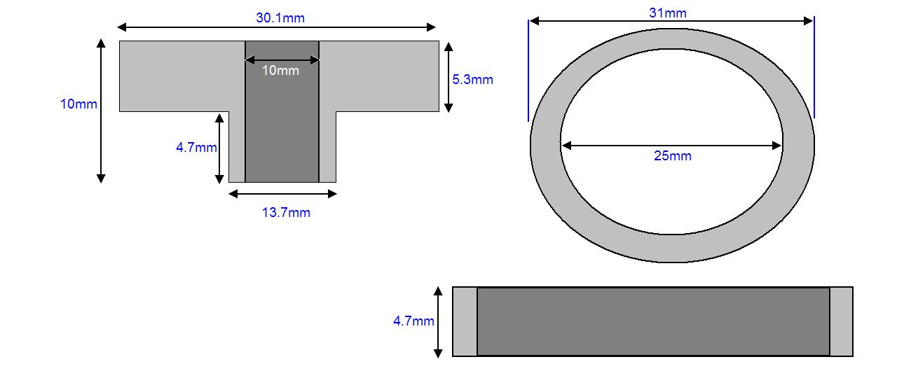

Good one :agree: and what about the centre hole?
Re: F7P Turbo Engine Build
Tutuur
That's a good question mate. I did encounter a few problems when adapting the pulleys, and to overcome those problems I had to measure then draw up these pieces and get them machined:
https://www.rtoc.org/files/Technical%.../Top%20Hat.JPG
2 x aluminium 'top hats' to overcome the bolt-hole size difference, the Suzuki uses a much larger bolt, the F7 is 10mm
2 x rear bushings to account for the fact the end of the F7 cam has a smaller diameter than the Suzuki.
I now have a pair of fully adjustable vernier pulleys that sit correctly on the end of the cam shafts. I still need to drill and fit a dowel pin though, but not a problem.
