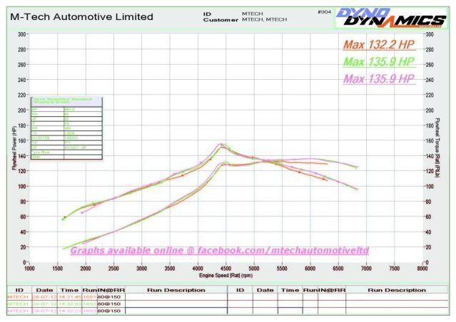

During the day at Blyton I gave T-Cup to the guys from M-Tech automotive and gave it a run on the rollers.
It was at this point that I suspected the old engine out of Trusty might have seen better days as the peak power the car produced was 135.9HP at the flywheel (lets not get into that whole Rolling road figures debate :laugh:). I had a chat with Bill and he reckoned a few horses had bolted the stable the last time he drove it? :scratch:

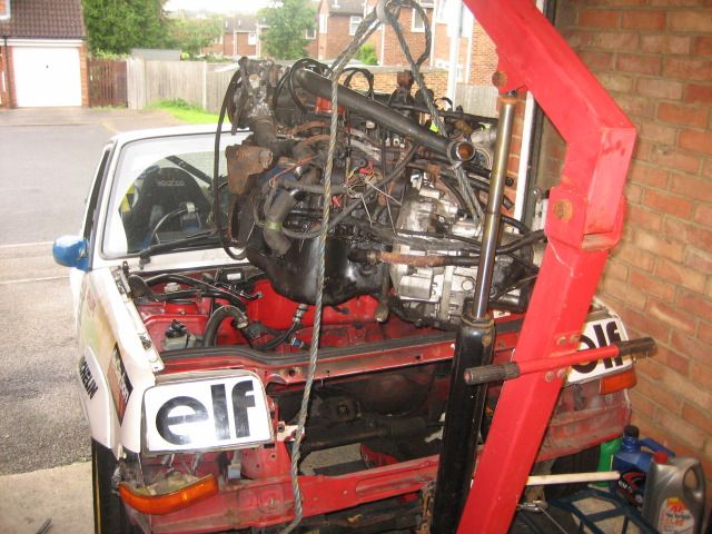

So first thing was to whip the engine back out of T-Cup
http://i306.photobucket.com/albums/n...r/IMG_2919.jpg

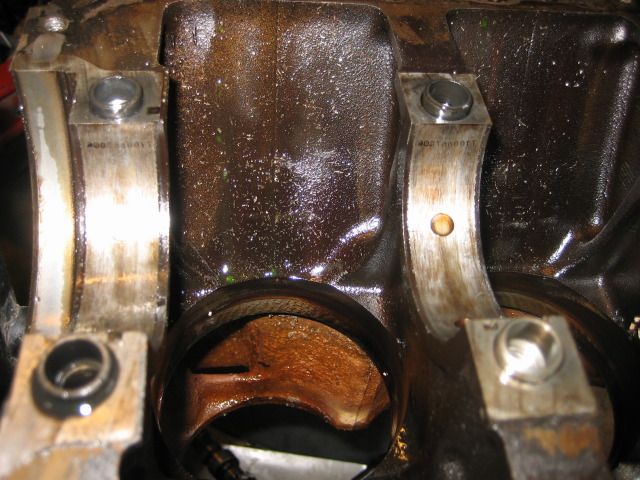

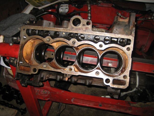

When I disassembled it though, it looked as though their had been something rattling around in the sump at one time that knocked 7 bells of sh1te out of the bottom of piston #1? :scratch:
http://i306.photobucket.com/albums/n...r/IMG_2984.jpg
I need to upload some pictures of the Con-Rod and bottom of the piston, in the picture above, you can see some scratches on the walls of the block, but the piston looked REALLY bad?! :(

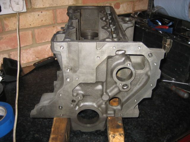

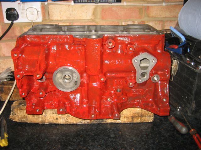

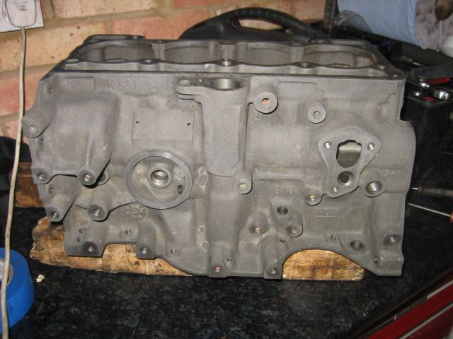

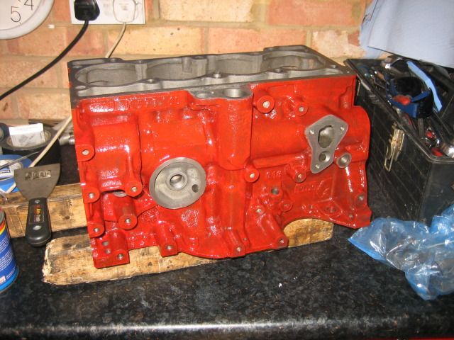

I took the block to Surface Processing Limited in Birmingham to be chemically dipped and stripped of all the nasty paint & rust & it came back looking like new
http://i306.photobucket.com/albums/n...r/IMG_3021.jpg
http://i306.photobucket.com/albums/n...r/IMG_3024.jpg
I then got busy with the old engine enamel and gave it a few coats
http://i306.photobucket.com/albums/n...r/IMG_3025.jpg
http://i306.photobucket.com/albums/n...r/IMG_3026.jpg

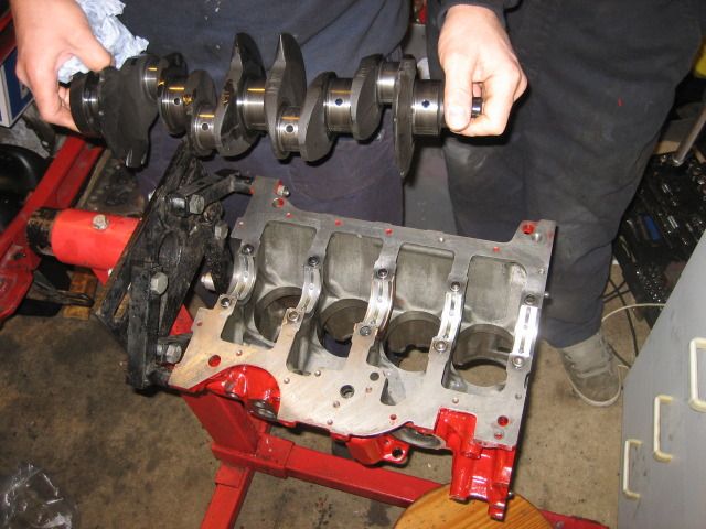

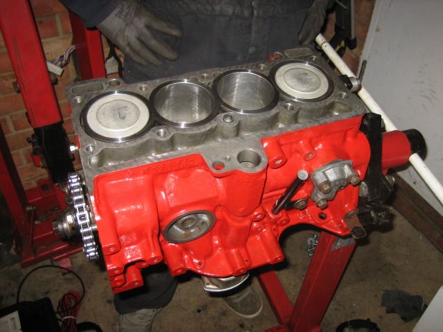

I've then had the crankshaft re-ground, Knife edged, tuftrided, polished and then finally balanced ready to go back in
http://i306.photobucket.com/albums/n...r/IMG_3028.jpg

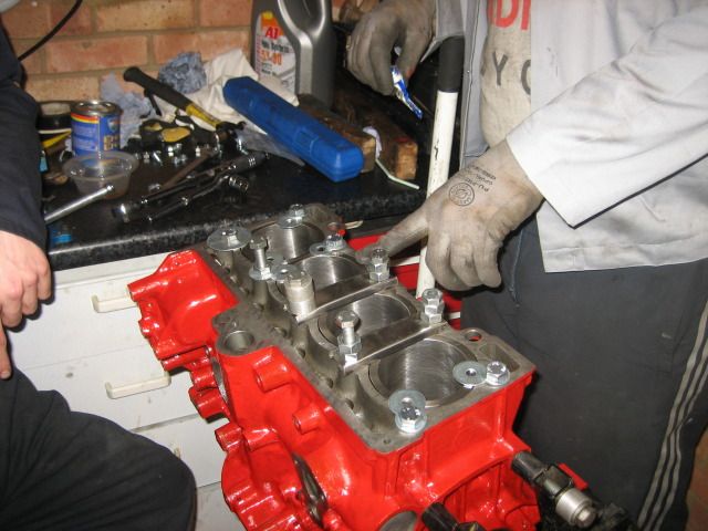

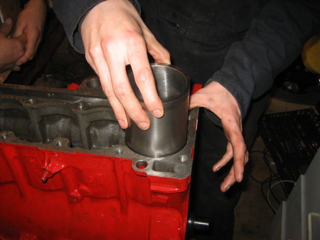

I had Nick Kettle and Kris M come over to see me for the weekend of the Southern Christmas Dooo in December, so I put them both to work helping me put it back together to stave off sitting in the pub ALL day! :laugh:
http://i306.photobucket.com/albums/n...r/IMG_3029.jpg
http://i306.photobucket.com/albums/n...r/IMG_3031.jpg
http://i306.photobucket.com/albums/n...r/IMG_3033.jpg
http://i306.photobucket.com/albums/n...r/IMG_3034.jpg
http://i306.photobucket.com/albums/n...r/IMG_3036.jpg

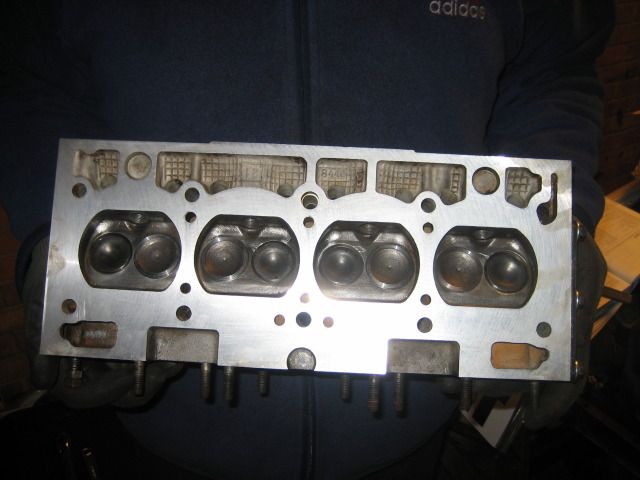

I had the head re-skimmed, new valves fitted and then the exhaust ports matched to the manifold.
http://i306.photobucket.com/albums/n...r/IMG_3038.jpg

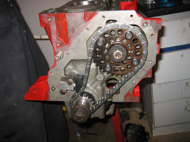

I've now installed a Piper 270 cam (decided against the 285 because I'm not looking for big power, just more useability on track) and vernier pulley.
http://i306.photobucket.com/albums/n...r/IMG_3037.jpg

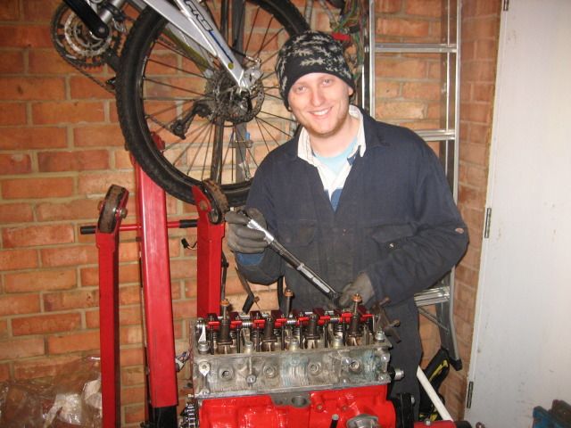

Kris came over to see me again during Christmas (to drink us dry as he'd exhaused his family's supply of booze) :wasntme: and helped me fit the head on
http://i306.photobucket.com/albums/n...r/IMG_3042.jpg

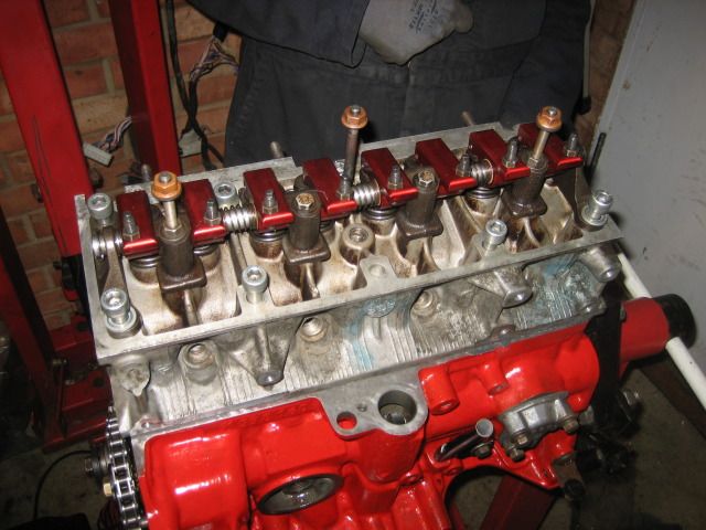

Together with the bit of bling I just couldn't resist, a set of the Alloy roller bearing cam followers that were being discussed on here a couple of days ago. I'll let you know how they turn out?!
http://i306.photobucket.com/albums/n...r/IMG_3041.jpg
Don't worry, I know i've still got to put the pushrods in! :cooter:

steve . why did you knife edge the crank ?????
think about it you have removed the counter balance from the crank that is about the same wieght as the piston assy
:cooter::homer:
i hope you have removed the same wiegth from the pistons and con rods
sorry i cant spell heavy

from which comes these tumblers ???? :scratch:
bonsoir steve .
d’où vienne ces culbuteurs ????
http://i10.servimg.com/u/f10/15/85/07/68/bloc_g10.jpg
Xenon. Look here.. https://www.rtoc.org/boards/showthrea...ghlight=roller
What are the rockers off? They look good.:agree:

Rolling Road Graph from 2012:
