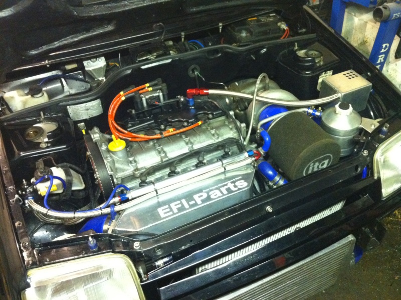

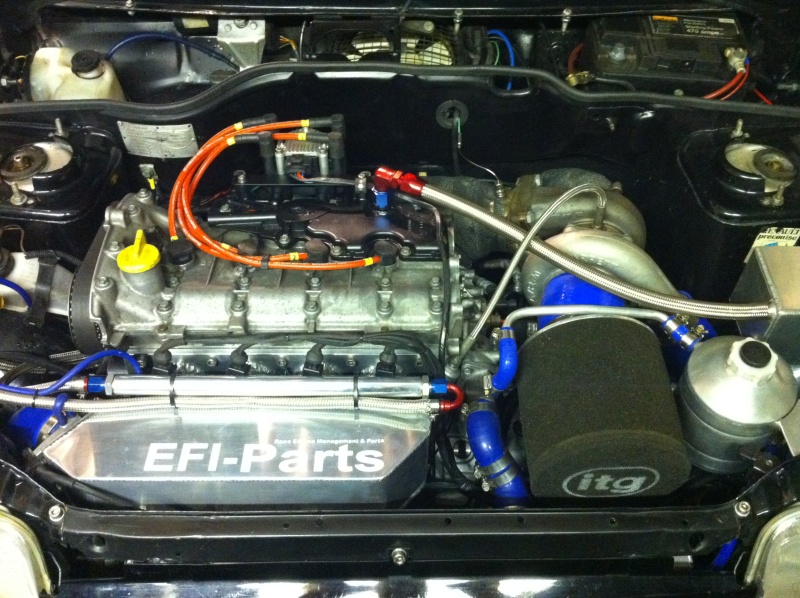

Engine bay mostly done now. I need to get the new rear beam on (thanks Ashy) and general tidying up ready for MOT and a basic map to get it to and from national day.
The clutch is hardcore, driving 'calmly' in and out of the garage is no longer an option !
https://www.rtoc.org/files/Technical%...sion/done1.JPG
https://www.rtoc.org/files/Technical%...sion/done2.JPG
loving that engine bay:p
nice, very nice. looks tidy in there :agree: what sort of gains do you think youll have with the new inlet manifold?

Cheers lads. Adey, no idea mate, I'd be happy with any gain, I'm more concerned with the gearbox being better than last year.

Are those tie wraps I can see :coffee:

nothing wrong with tyraps, F1 would be in real trouble if the FIA banned them :D

I get a right ribbing for using em!
I like to think of them as quick release:coffee:

Brilliant job, well done! Just a quick one though, how come you have the fuel return out from the rail instead of returning at the regulator?
it does you can see it on the left of the picture?
Sorry matt, not sure what your asking buddy. Rail is piped in the usual way. Feeds in on the left and return is on the right :)
hmmm, how do return-less systems work? i was speaking to willday at pod last time i was there and he was running return-less, puzzled me a bit, i thought maybe controlled voltage to the pump, guess not :crap:
Have you seen how the later Clio sports and megane 225 work ? They work like that, just a feed, but in those cases the pump has a regulator built in the tank so there is still continuous flow through the pump but you don't see it. The fuel maps for those engines take in to consideration the fixed fuel pressure.
ah ha, well that makes sense then :)
im guessing they run higher fuel pressure, more fuel efficent im guessing with better atmo?
whens its first outing then? i see speckys has just pulled 704bhp on pump fuel :eek: are you running in the same series?
Sure did, I was there when he did it yesterday :) Fair play to him and paul, it sounds really strong. He won't tell anyone the spec of his turbo so I pretended to measure it while he wasn't watching :laugh: yes, same series.
Rob, yes, but I don't know what the fuel pressure will be. 4bar or so I guess. All the ones I've tuned have used regulators because they've been conversions.
Matt, yes, your way works just as well really. I prefer to have flow through the rail when priming though, it can help with hot starting.
