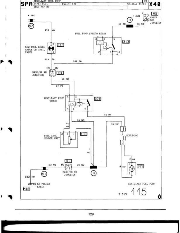

I've had a search of the boards & come across the following wiring diagram:
http://i306.photobucket.com/albums/n...ryfuelpump.jpg
It would appear that the light only comes on after the Aux Pump Timer has counted down?? Is this correct??
Q1) How long does Aux Pump Timer countdown?
Q2) If the light doesn't come on the dash will the aux pump not work?
I've checked the bulb in the dash & that seems ok??
I pulled the sender out of the tank this afternoon & set it to replicate the tank being empty & still the low level warning light never came on??
Anyone got any Ideas of what I should try??

Steve look at thread on 17th may 2009 titled "aux pump" :agree:
Re: Low Fuel Level Warning Light
Tarmac trasher - Nick
You're the man Nick! :niceone:
I'm off to the garage now to find a "metallic object" & try & bridge the connector! :D
Worked like a charm mate!!! Thanks! :goodJob:
