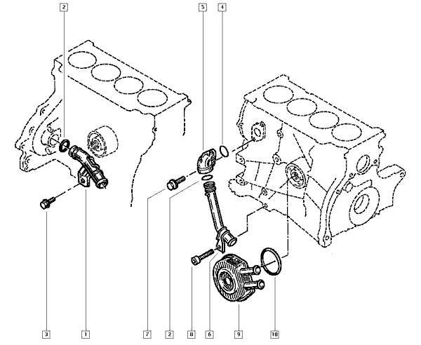

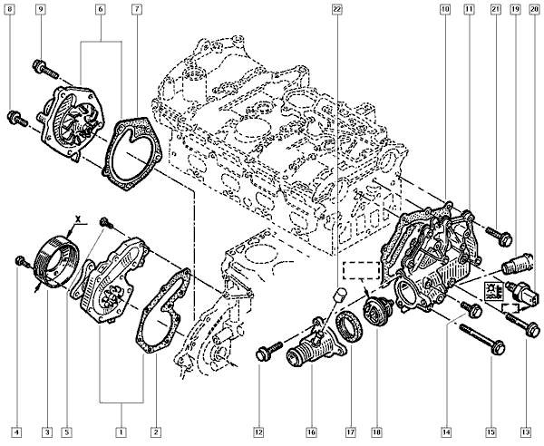

Paul, (saviour) is there any diolagies of the pipe set up?? Been looking for info but had little or no joy. I havent checked the pump (stupid yes) Im hoping its just the setup.
Re: Cooling Issue Still 225 engine.
yup, i'll dig em out after lunch.....also, is yours an R26 or the F1 lump with LSD...just so i put the right info up..
paul b
Just the normal 225 matey 2004/05 i think. I bet the engines are the same??
Paul, massive thanks.
Ok its not a clear circuit so i need to i.d the pipes for my set up. Which ones are the heater matrix flow and return, the turbo flow and return? I presume the fill tank is at the top left in the pic?
Paul i know its a tall ask but have your chaps got that section in the workshop manual ala the clio 172 one that Andy Cooke supplied in the PDF attachment? It would be very easy to follow the pipe routes then. (pint will be awarded):wasntme:
sorry buddy, all that dialogys is on a stand alone Mac.....not linked to email or our internal internet......
the pics I put up are from the renaultparts system, online dialogys for parts only..
pipe 15 is top matrix, pipe 3 is lower matrix
header tank is top left....
guessing pipe 7 is the turbo side of cooling......don't have a car here to look at, sorry..
Ok matey, so need to id pipe 4 and where the first pipe of no. 2 goes to?
Apologies for all the questions.:scared:
