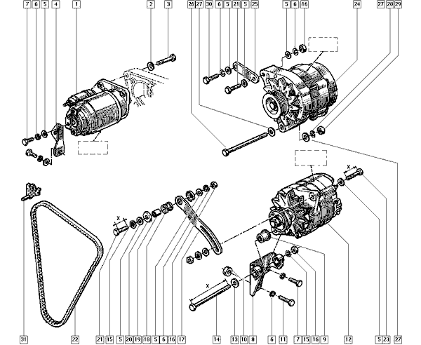

slinger of mud............have you got the little pin that bolts to the pump..item 31 on the pic by the belt..
its to stop the belt jumping off..???
:eek: Hmm ive never noticed that before , id need to go have a look ,and seeing the car is 45 miles away it wont be tonight .
was this part fitted to the ph1 , i honestly think id have noticed that bit today if it was there.
cheers for the heads up ;)
Re: Can almost see the finish line !!
well, i've seen them on all models...even one on my 9....
seen them on 1.2......1.4......turbo and n/a
I can VOR one and get it to ND for saturday morning...?????
hows that for service..or you can sort one tomorrow...sharpish

forgot to post this https://www.rtoc.org/boards/picture.p...pictureid=2287
the black shaded area is just ava logo , the colour printer was broke!!
what u guys think ?
i think the cam could do with a little adjustment ,its just not an easy thing to do while its on the rollers
