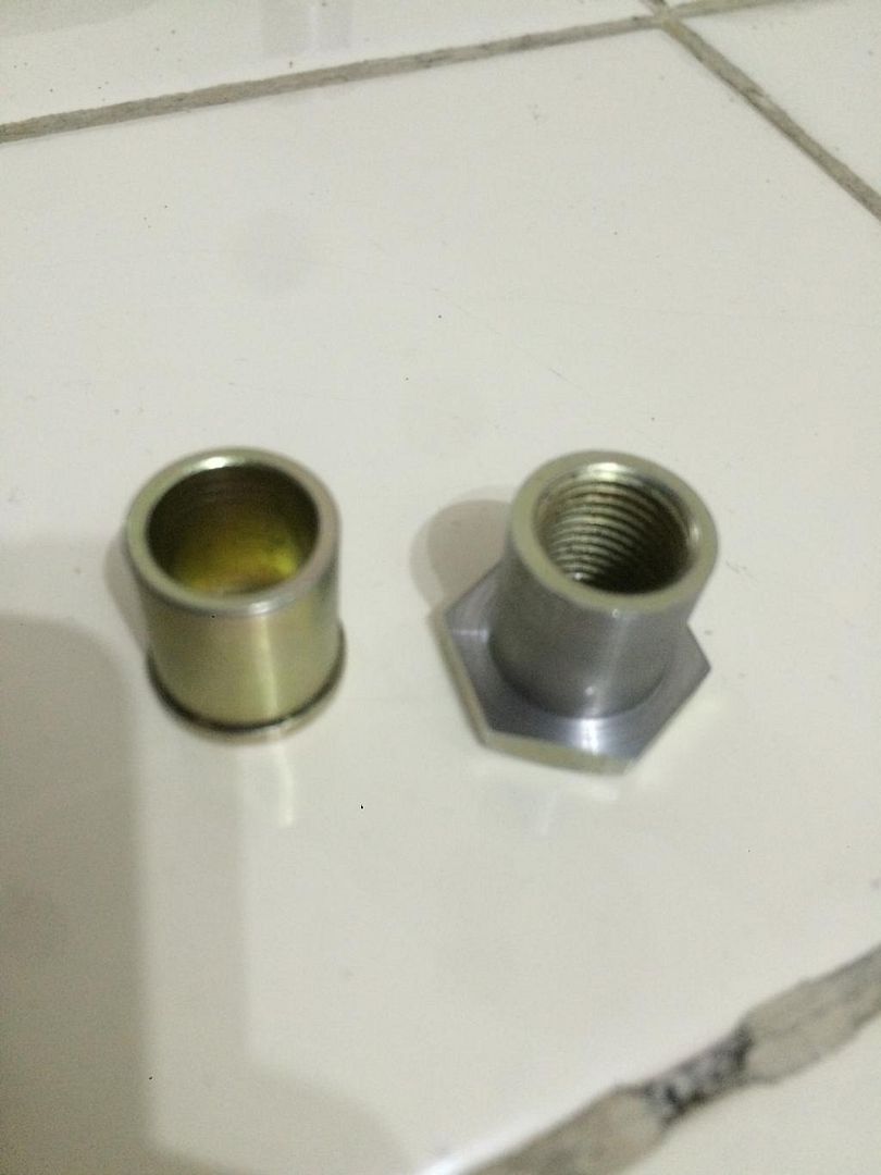

http://i29.photobucket.com/albums/c2...psofc47mwg.jpg
On the left is the sleve that came with the bearings, the right is a sleeved nut I had turned down on a lathe to suit the bearing to give the most amount of grip on the thread of the shock.

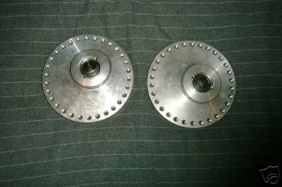

Could do with pics of how others have assembled the compbrake mounts

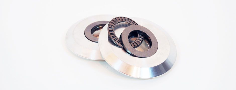

The Top Hats I've got for my 2.5" ID Springs are actually a 'floating' design, with their own needle roller bearing so they can still turn when they're sat up against the Camber Plate base.
http://i196.photobucket.com/albums/a...pshm2urbv1.jpg
I'm not sure how this will work in practice as I haven't fitted mine yet with this configuration, but the manufacture says that they run this style on their rally cars and it works well. They also say that they get 3 x the life of the Camber Plate bearing as it doesn't see as much load.
Time will tell.
