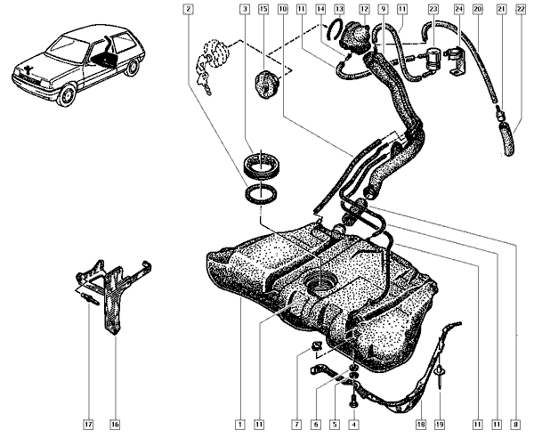

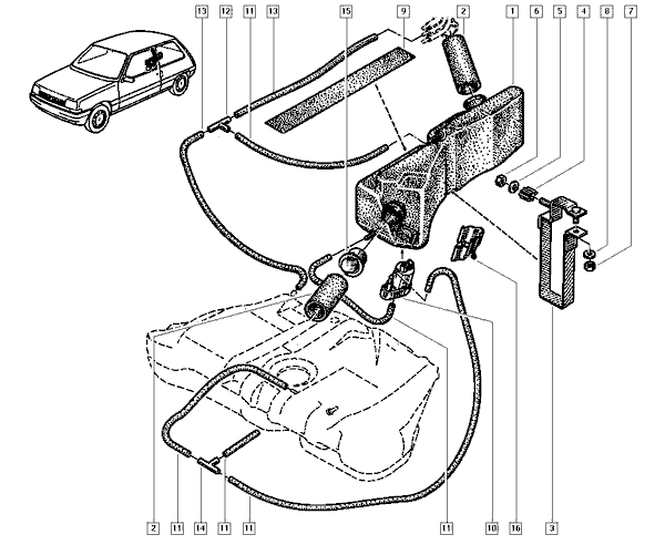

I found Paul B's dialogy photobucket links from here in the articles section:
https://www.rtoc.org/boards/showthread.php?t=372
And then searched through to find the fuel setup. This is why RTOC is worth the money :)
http://i88.photobucket.com/albums/k1...009105_1-1.png
http://i88.photobucket.com/albums/k1...009791_1-1.png

Yep solved it.
When looking from the back of the car. One pipe goes to the left side connection on the sender. And the other pipe on the t piece feeds into the tank. Easy when you can see what your dealing with :)
