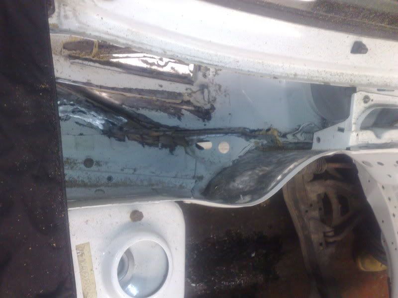

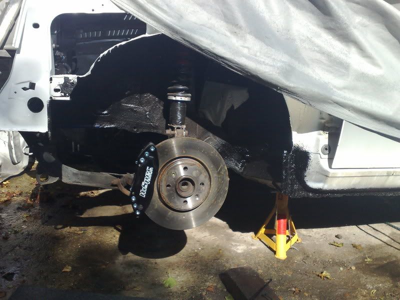

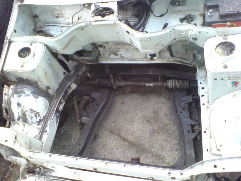

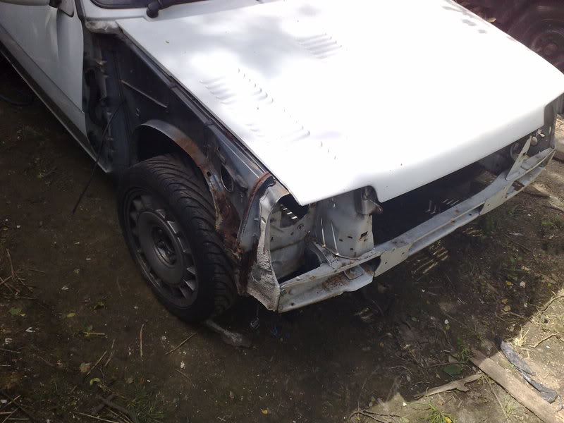

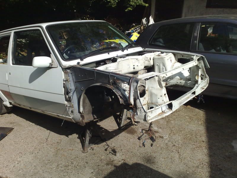

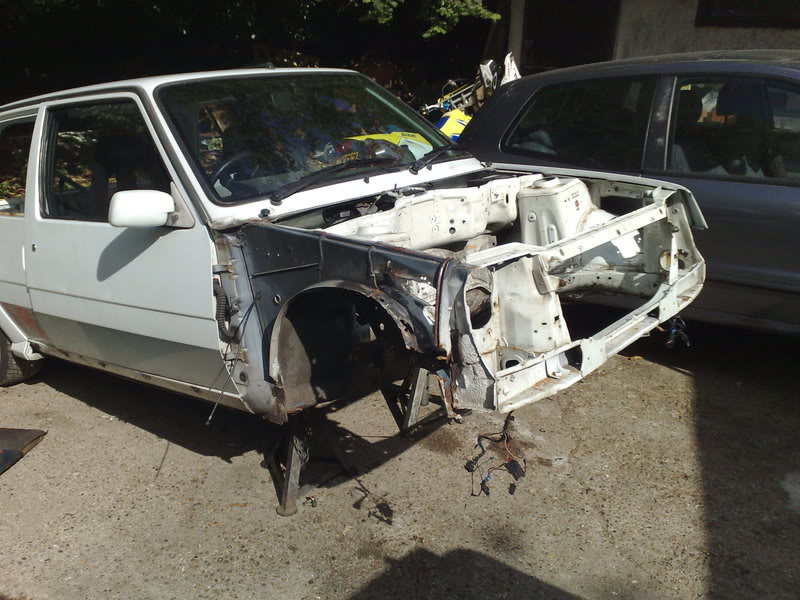

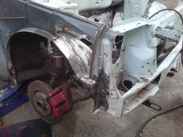

As you can see there was a reasonable amount of rust under the drivers side front wing which needed abit of welding work
http://i33.photobucket.com/albums/d9...DSC00449-2.jpg
The engine bay itself, abit of a mess
http://i33.photobucket.com/albums/d9...o/DSC00392.jpg
http://i33.photobucket.com/albums/d9...o/DSC00393.jpg

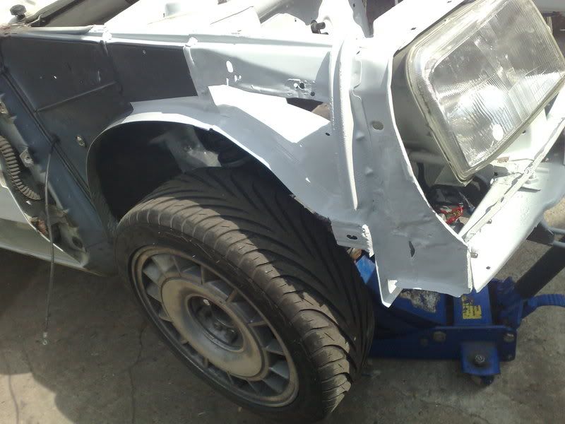

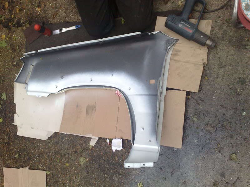

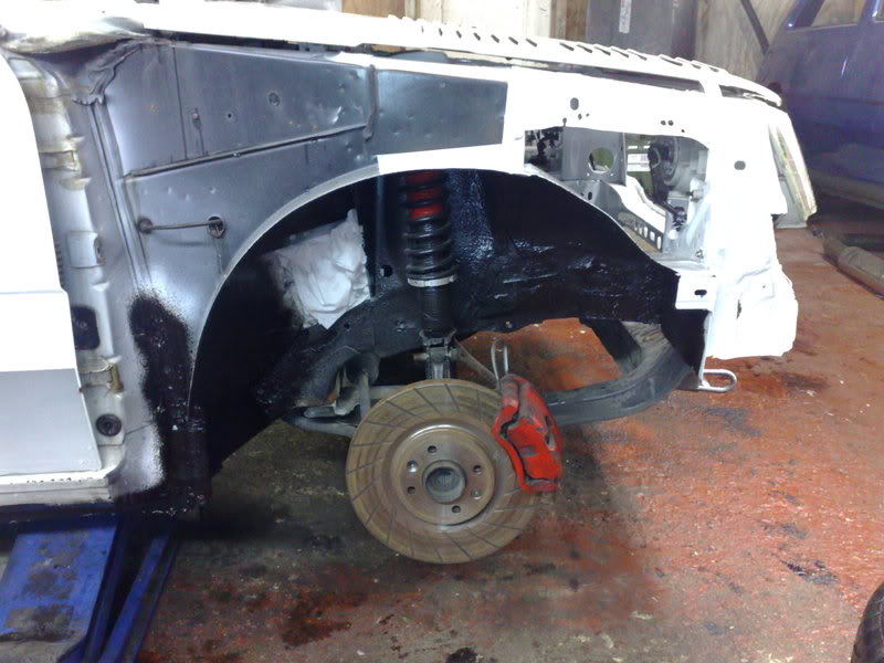

Took the oppotunity to clean off some surface rust that had accumulated on the wing, treat it and protect it
http://i33.photobucket.com/albums/d9...7092008211.jpg

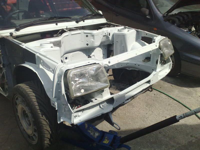

Re: R5 GTT (abit of restoration)

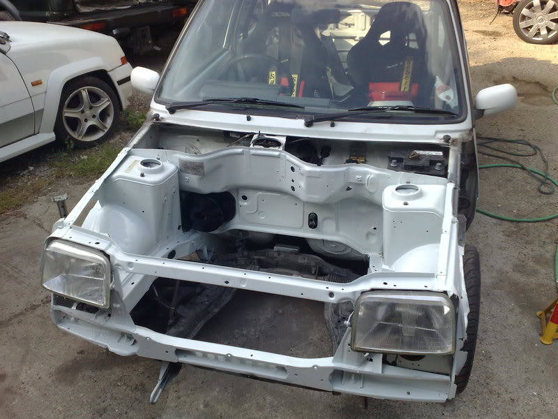

The engine bay was then sand blasted, preped and painted
http://i33.photobucket.com/albums/d9...72008135-1.jpg
http://i33.photobucket.com/albums/d9...72008124-1.jpg
http://i33.photobucket.com/albums/d9...7072008125.jpg

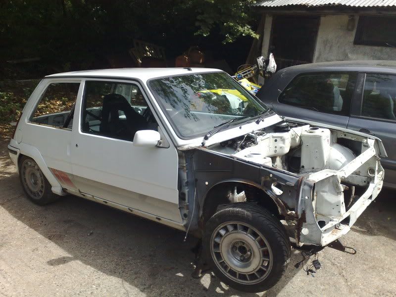

It had by this stage become apparent that two new sills on either side were required, both of which got done before a clean up under the wheel arches before some undersealant.
http://i33.photobucket.com/albums/d9...72008134-1.jpg
http://i33.photobucket.com/albums/d9...6092008202.jpg

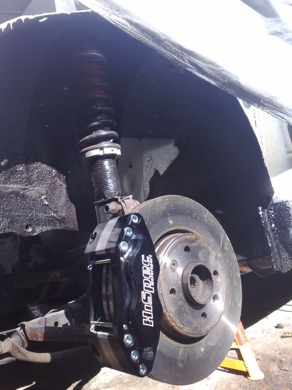

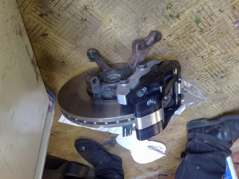

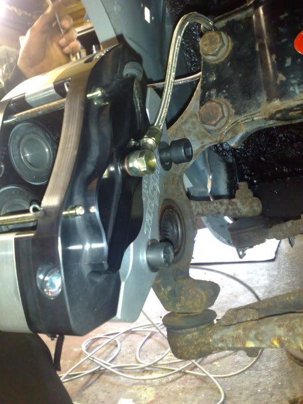

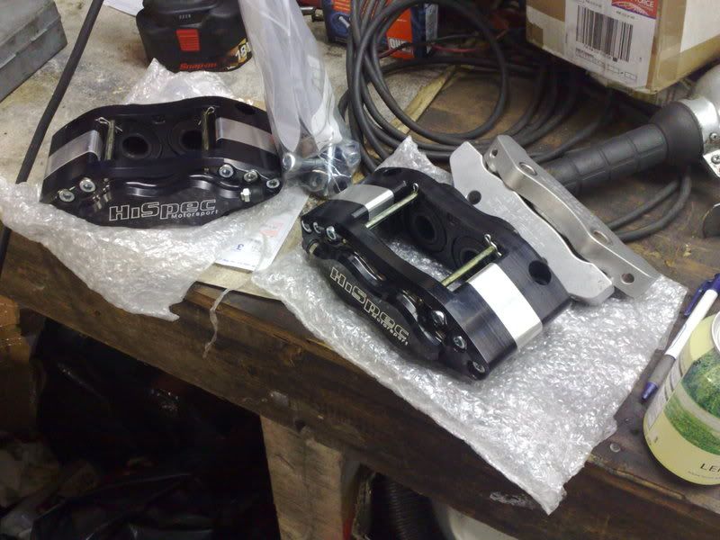

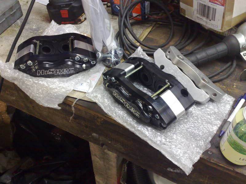

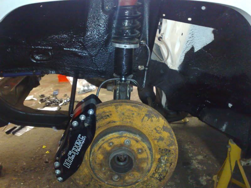

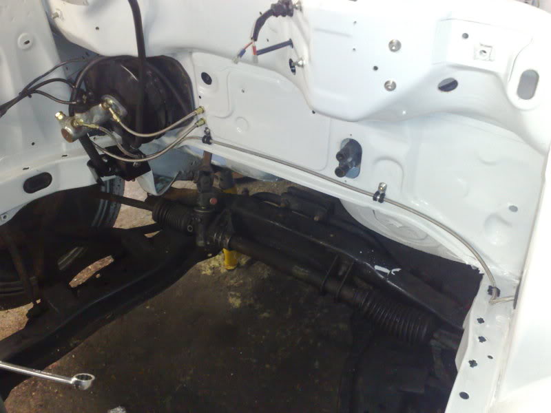

While on the front end of the car, i was taking my options for brakes into consideration, i had to replace my calipers and for good measure my m/c + quickly managed to get my hands on these
http://i33.photobucket.com/albums/d9...6092008206.jpg
http://i33.photobucket.com/albums/d9...6092008205.jpg
I had to play around with them abit as they weren't going to work with the 285mm discs i was using due to there offset. After abit of investigation i played around with discs off a 182 clio which seemed to do the trick nicely!
http://i33.photobucket.com/albums/d9...6092008194.jpg
http://i33.photobucket.com/albums/d9...6092008195.jpg
http://i33.photobucket.com/albums/d9...6092008199.jpg

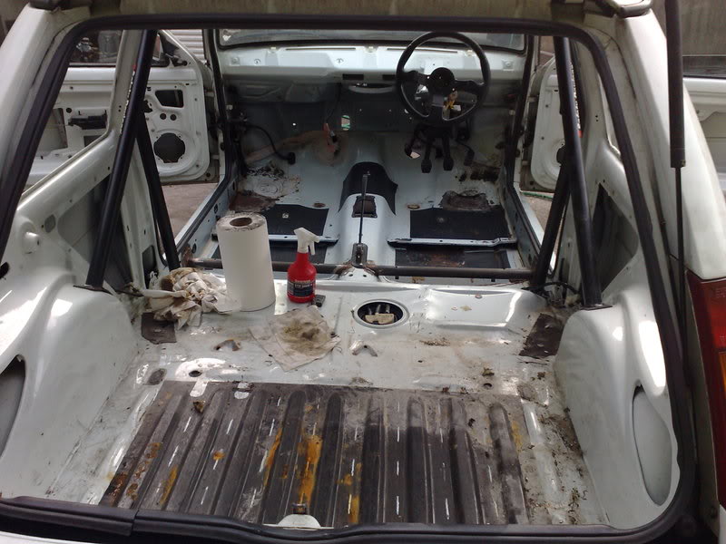

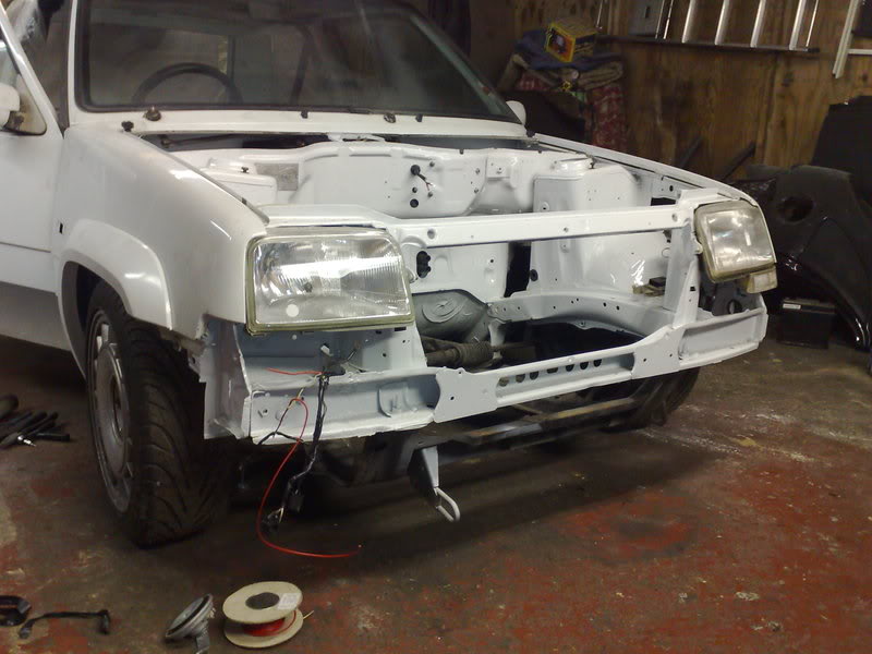

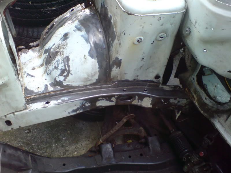

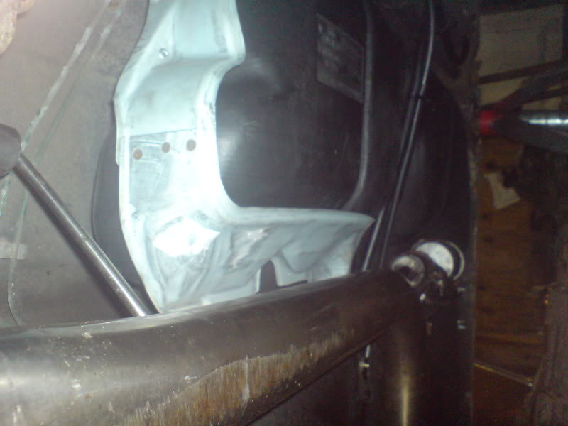

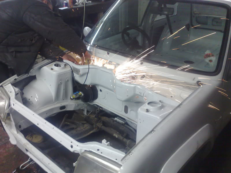

Unfortunatly when the sills were being welded in it became apparent that there was further welding required to the floor, My intention had always been to get the inside of the car tidied up so this didn't pose a major problem. However some of the wiring on the drivers side that runs down the chassis leg did catch fire slightly!!
All in all it was looking abit messy in there
http://i33.photobucket.com/albums/d9...7092008217.jpg
http://i33.photobucket.com/albums/d9...7092008216.jpg
http://i33.photobucket.com/albums/d9...4092008248.jpg

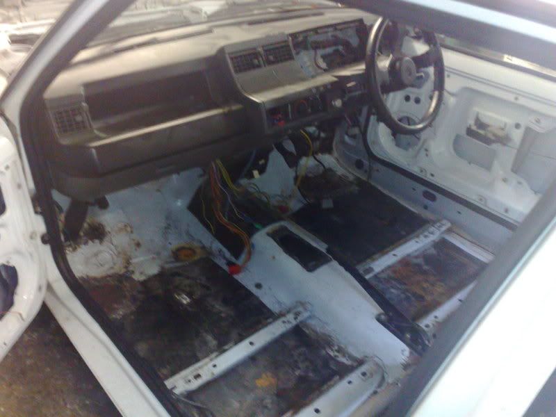

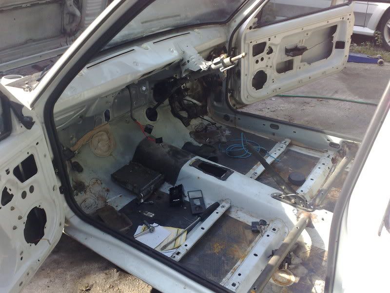

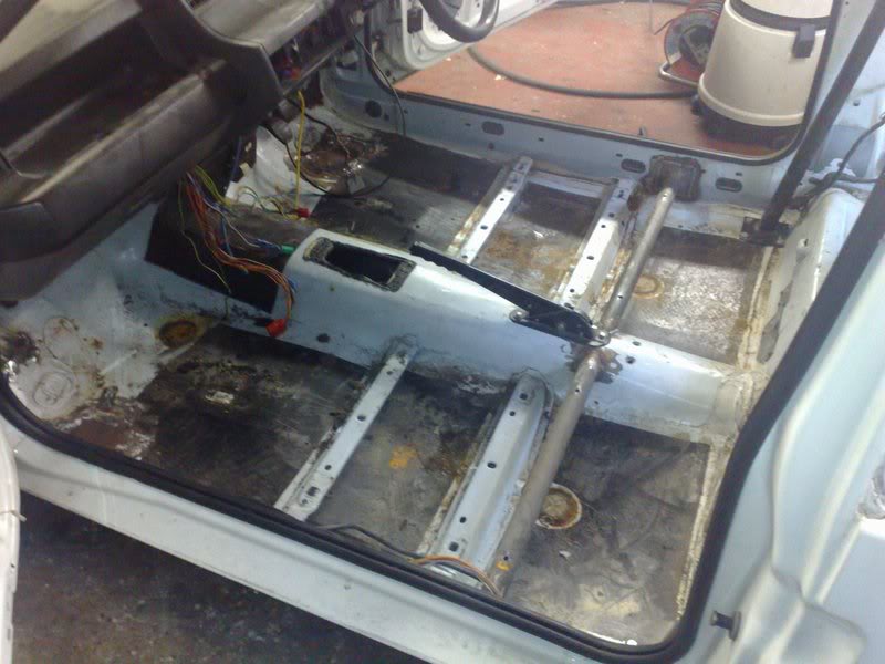

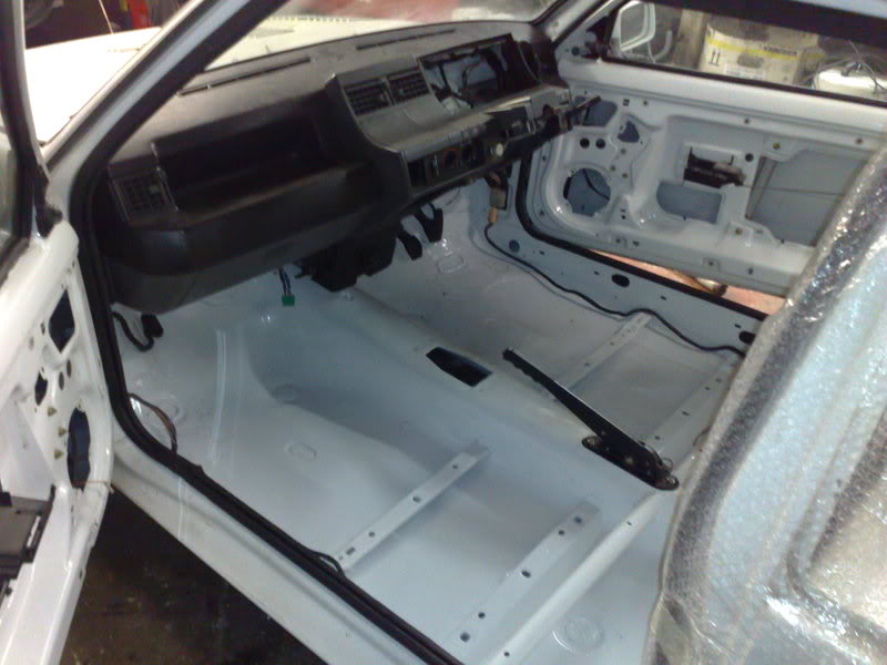

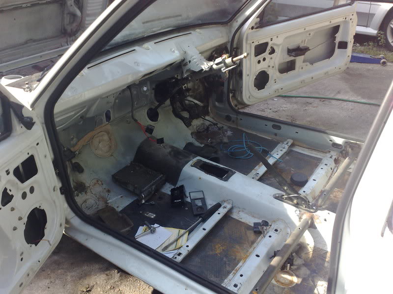

So the dash came out and abit of cleaning was required!
http://i33.photobucket.com/albums/d9...4092008245.jpg
http://i33.photobucket.com/albums/d9...4092008246.jpg
http://i33.photobucket.com/albums/d9...4092008250.jpg

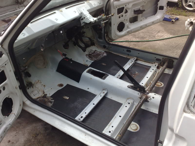

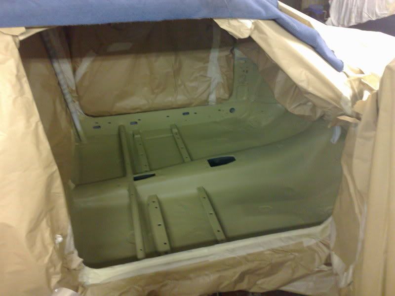

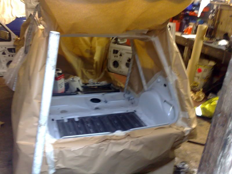

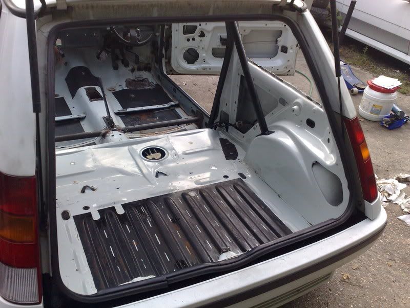

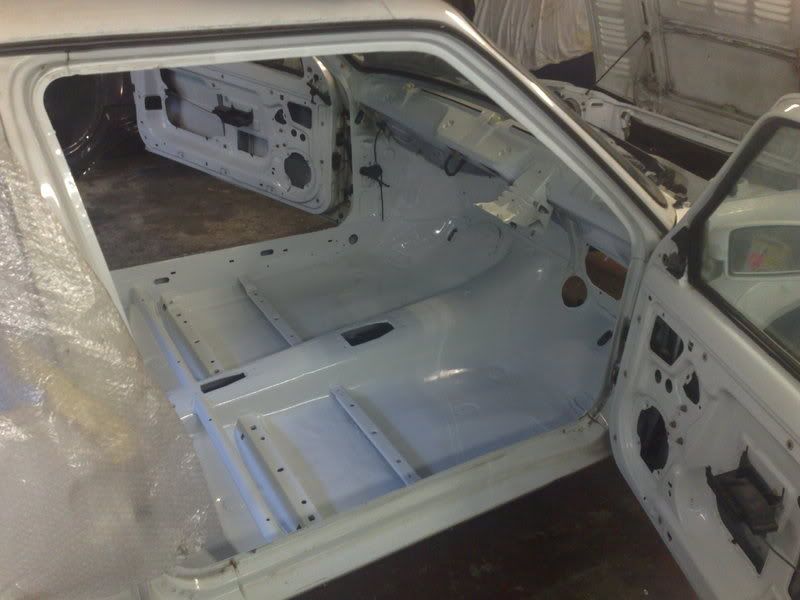

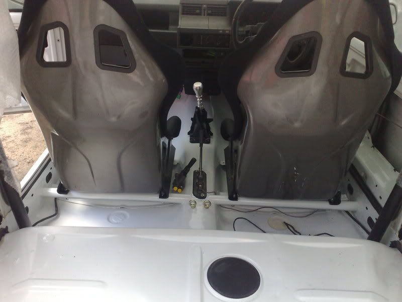

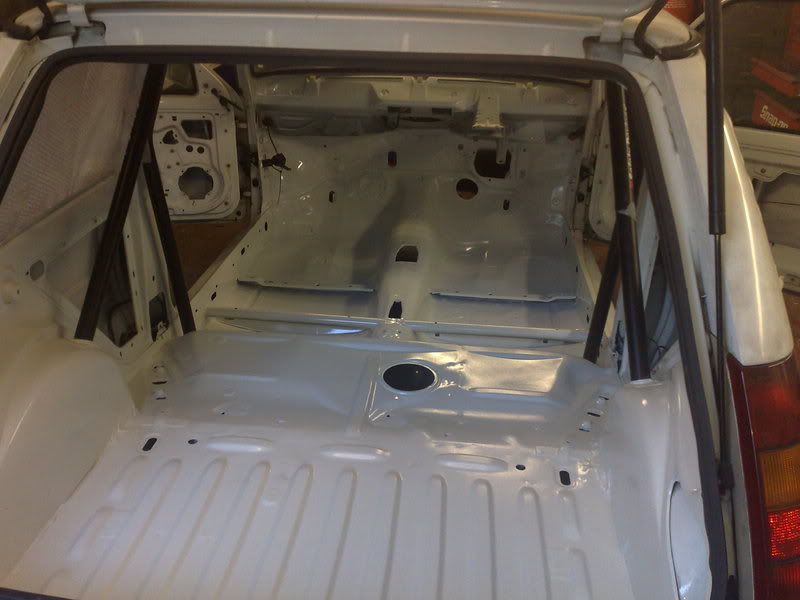

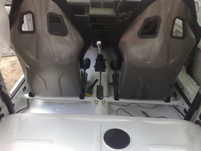

This time me and my friend rob (while i help he definatly does most of the work!) decided we'd have a go at painting the inside ourselves! We did borrow a gun and were advised by a proffesional painter, so we were fairly confident it would be ok. By now the roll cage had long since been welded in.
Back half first
http://i33.photobucket.com/albums/d9...4122008501.jpg
http://i33.photobucket.com/albums/d9...4122008505.jpg
http://i33.photobucket.com/albums/d9...4122008506.jpg

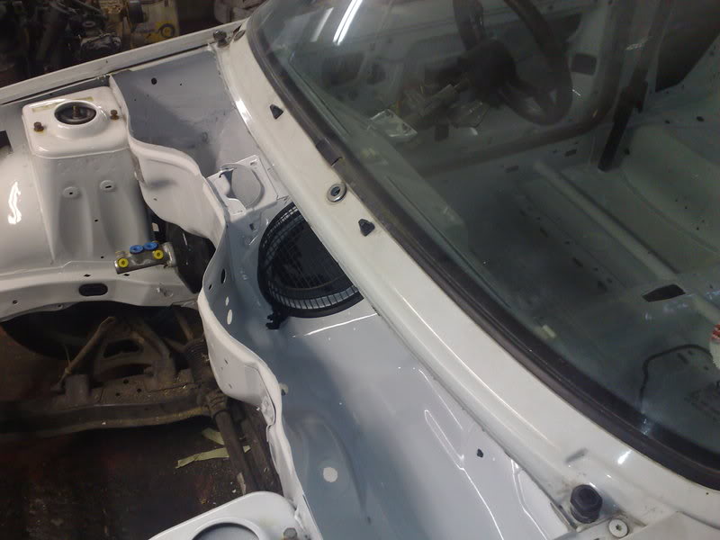

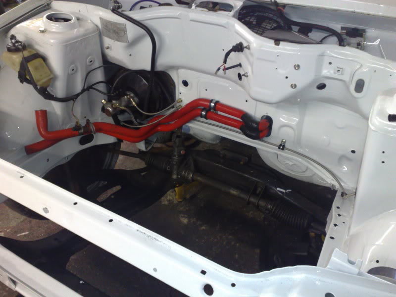

Then the front
http://i33.photobucket.com/albums/d9...8122008512.jpg
http://i33.photobucket.com/albums/d9...4122008504.jpg
http://i33.photobucket.com/albums/d9...0122008516.jpg
http://i33.photobucket.com/albums/d9...0122008513.jpg

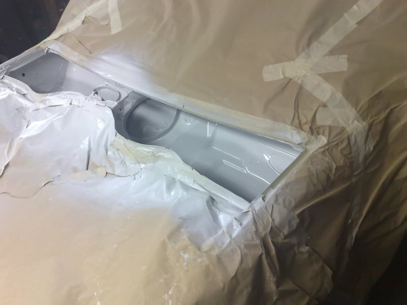

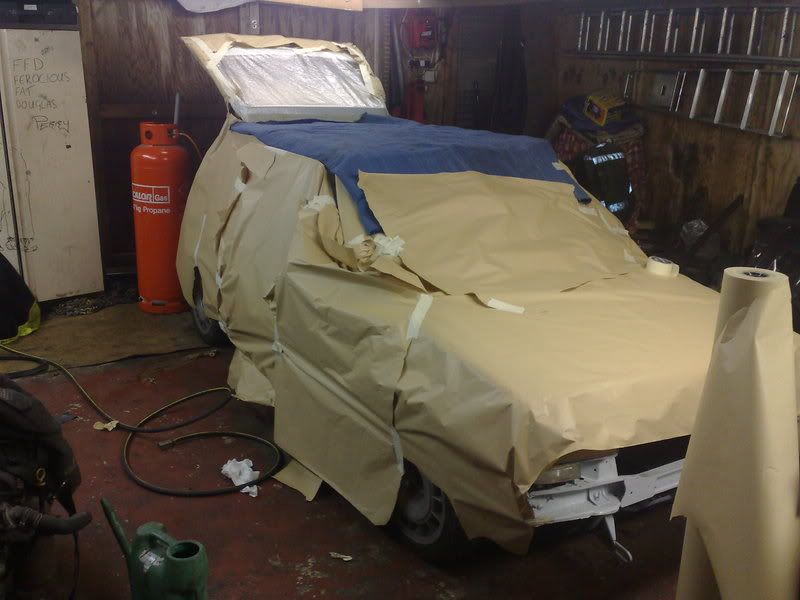

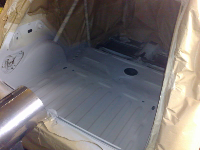

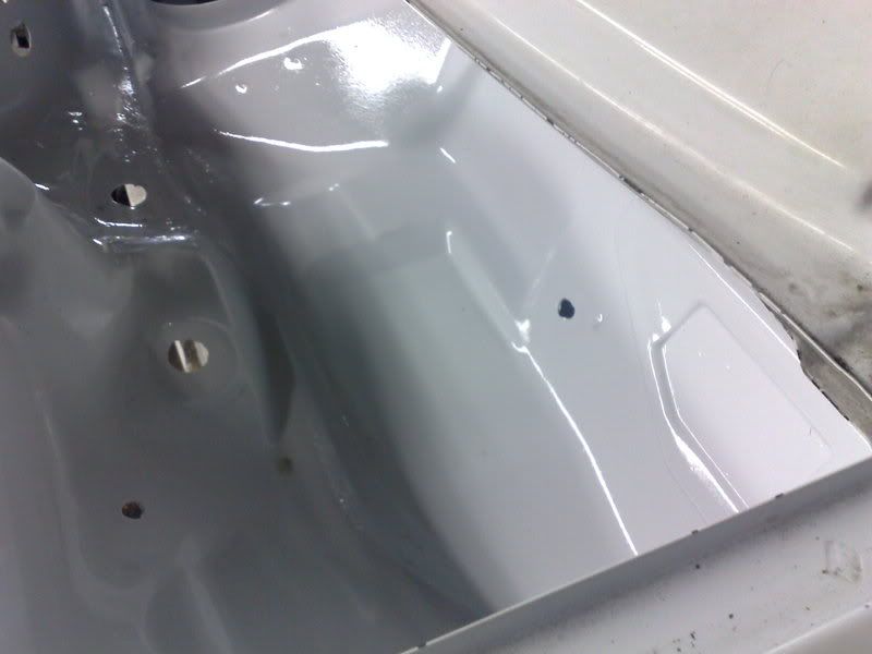

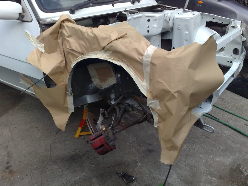

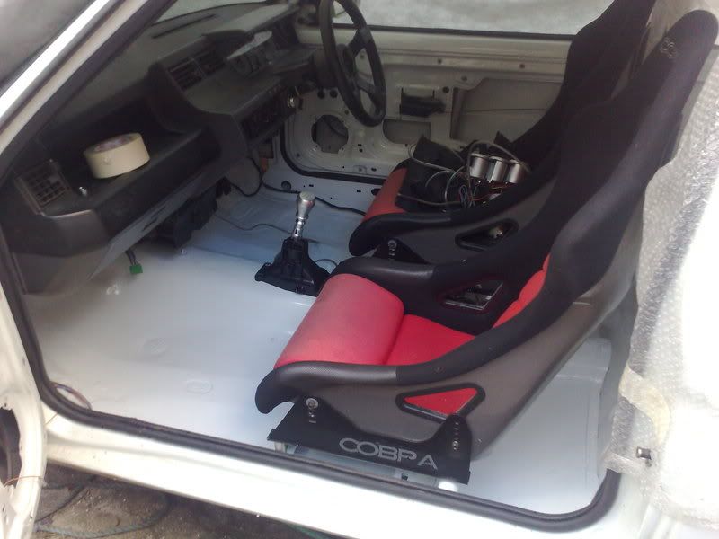

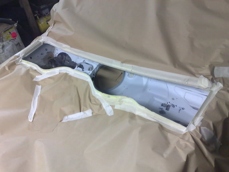

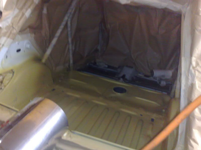

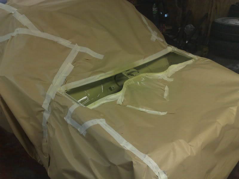

Next (partly seeing as we had the left over materials from painting the inside) the area behind the scuttle pannel needed some work. The sound deadening had been removed, and the wiring was untidy so that go set upon
http://i33.photobucket.com/albums/d9...9122008531.jpg
http://i33.photobucket.com/albums/d9...9122008527.jpg
all prepd and masked
http://i33.photobucket.com/albums/d9...9122008532.jpg
http://i33.photobucket.com/albums/d9...9122008533.jpg
http://i33.photobucket.com/albums/d9...0122008536.jpg
http://i33.photobucket.com/albums/d9...1122008537.jpg
http://i33.photobucket.com/albums/d9...1122008538.jpg

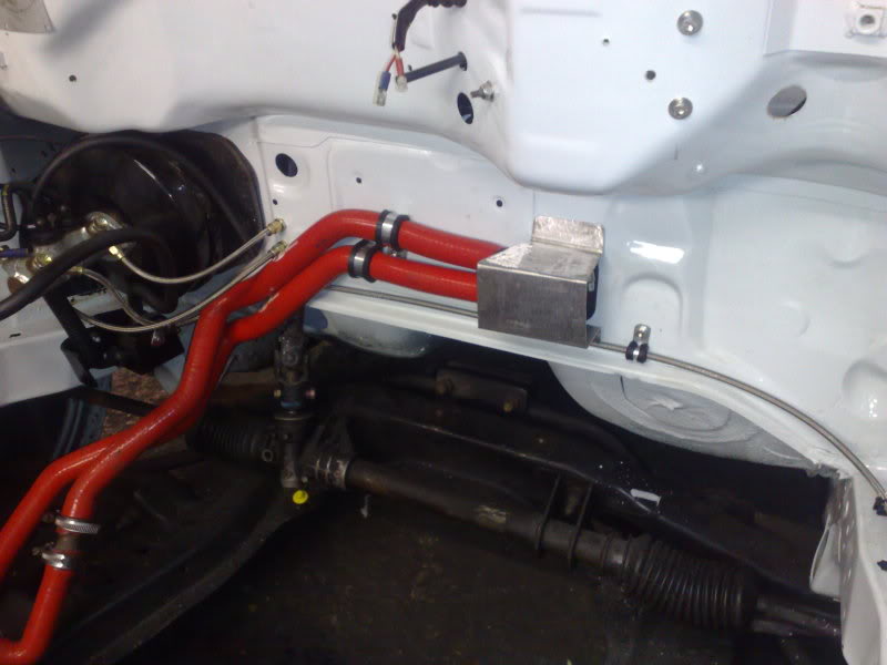

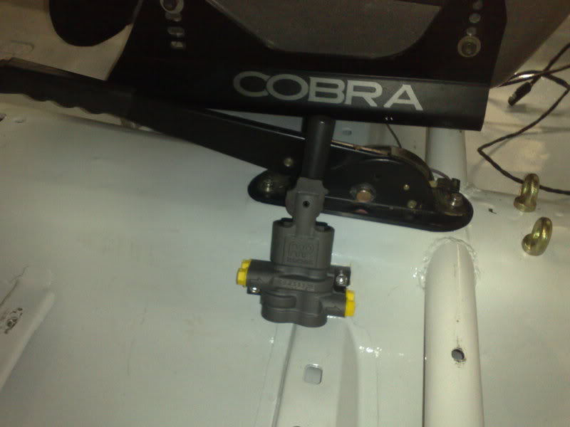

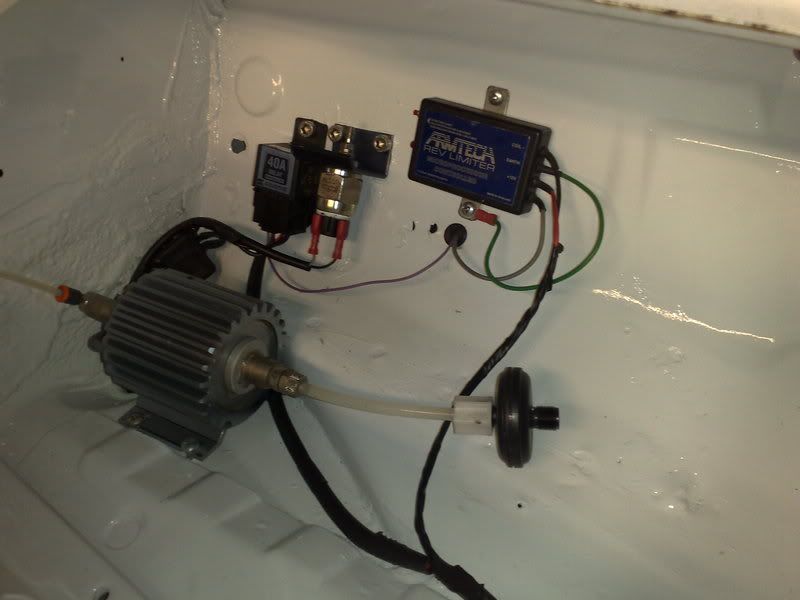

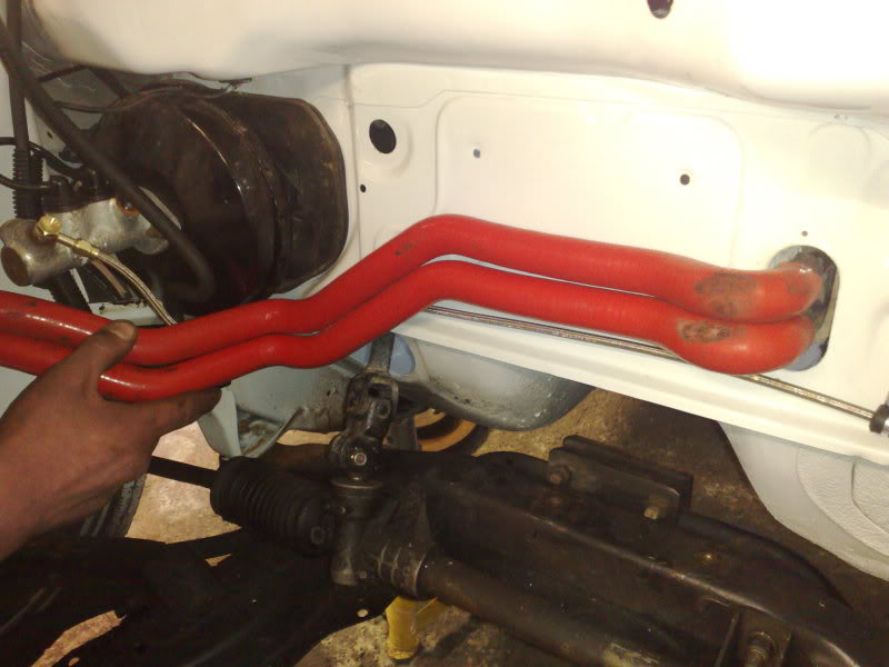

Water injection and rev limiter fitted albeit that the engine is still in the raider :rolleyes:
http://i33.photobucket.com/albums/d9...1122008542.jpg
New section of loom run to replace the damaged lot that went up in smoke! lol

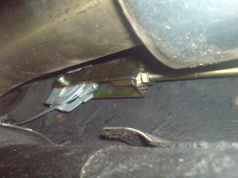

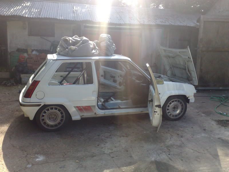

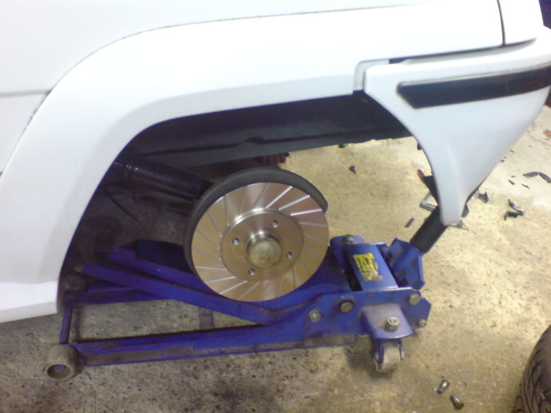

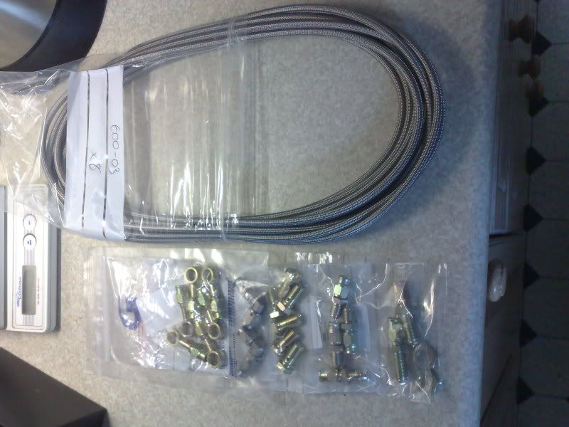

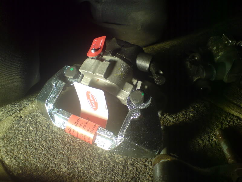

A few other bits that have been going on in the meantime that ive just found some pictures of!

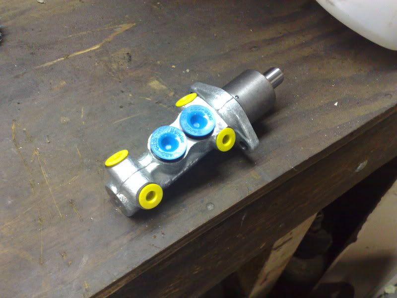

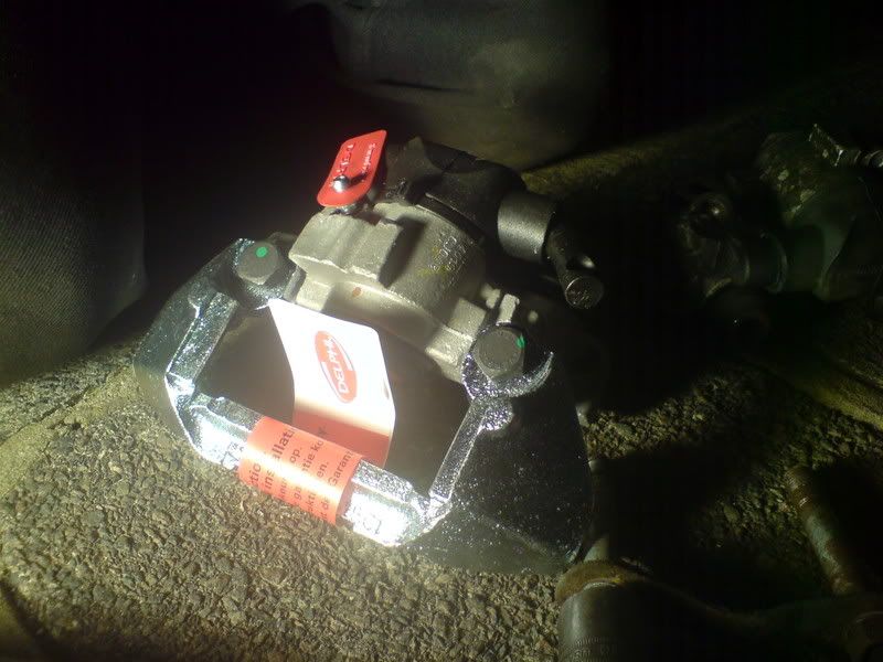

Basically replacing my rear calipers + discs and a new handbrake mechanism along with a new heat shield for the fuel tank! The other one was falling apart!! Most of it will be coming off the car again now im going abit further with it then origionally intended :rolleyes:
http://i33.photobucket.com/albums/d9...o/DSC00451.jpg
http://i33.photobucket.com/albums/d9...o/DSC00820.jpg
http://i33.photobucket.com/albums/d9...o/DSC00842.jpg
http://i33.photobucket.com/albums/d9...o/DSC00840.jpg

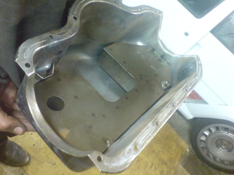

Baffled sump will be on the engine....when i get there far
http://i33.photobucket.com/albums/d9...o/DSC00804.jpg

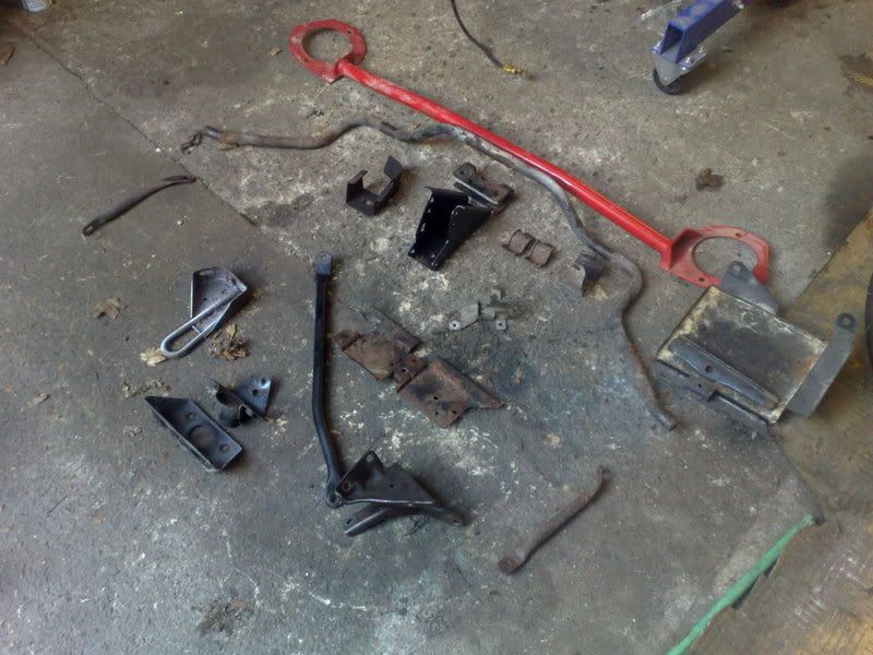

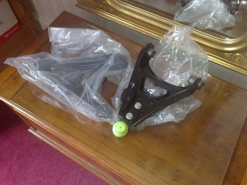

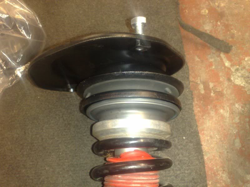

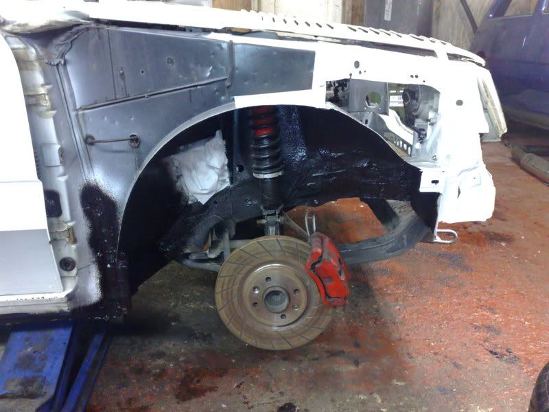

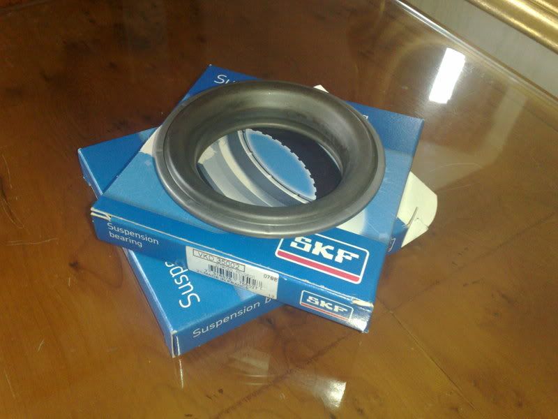

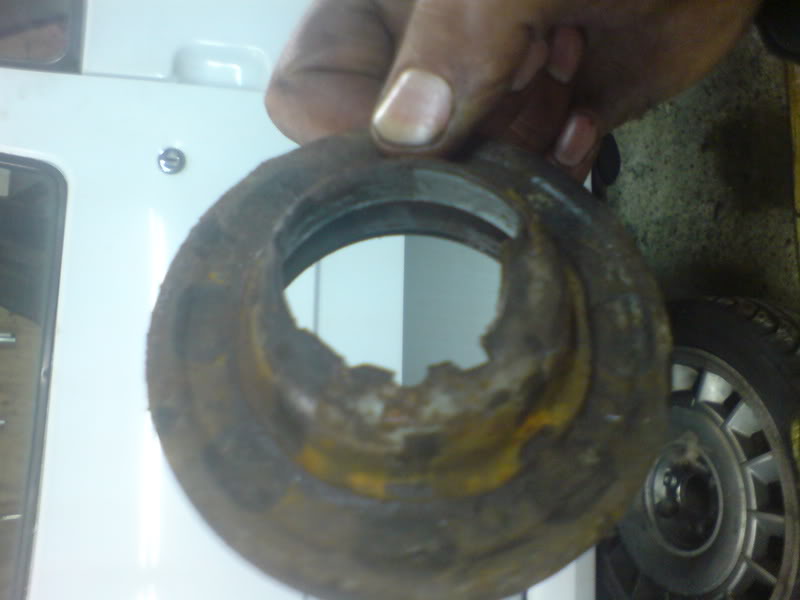

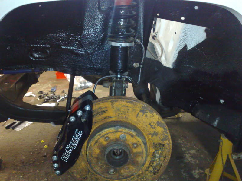

Some of my suspension components have seen better days so along with the new coilovers the rest of it will all be replaced, im gradually getting round to getting the bits together, and a few other bits too! Subframe will be getting powdercoated at some stage fairly soon i hope :) then theres a few new bits to go on there too.
http://i33.photobucket.com/albums/d9...o/DSC00792.jpg
http://i33.photobucket.com/albums/d9...6092008198.jpg
http://i33.photobucket.com/albums/d9...6092008197.jpg
http://i33.photobucket.com/albums/d9...6092008196.jpg

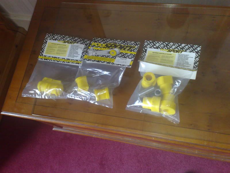

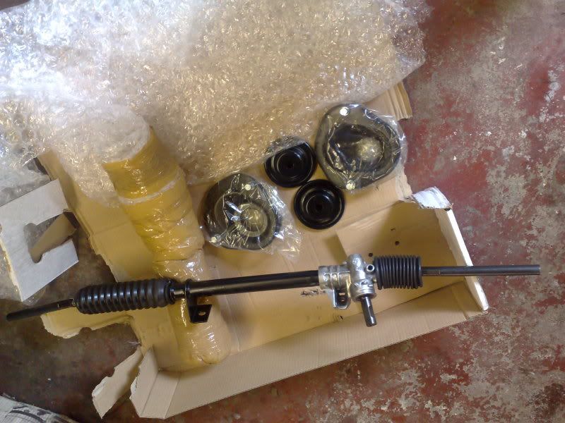

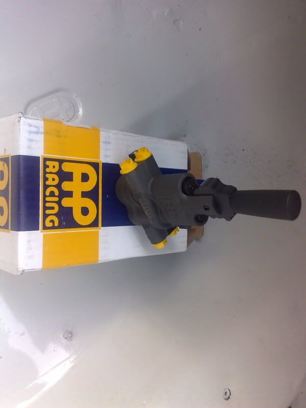

...and my latest bit of kit thats turned up
http://i33.photobucket.com/albums/d9...7012009575.jpg

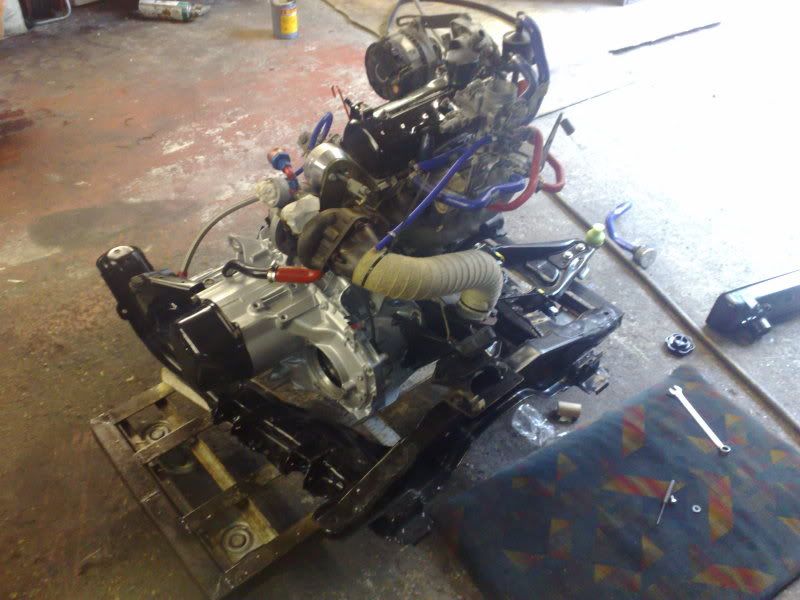

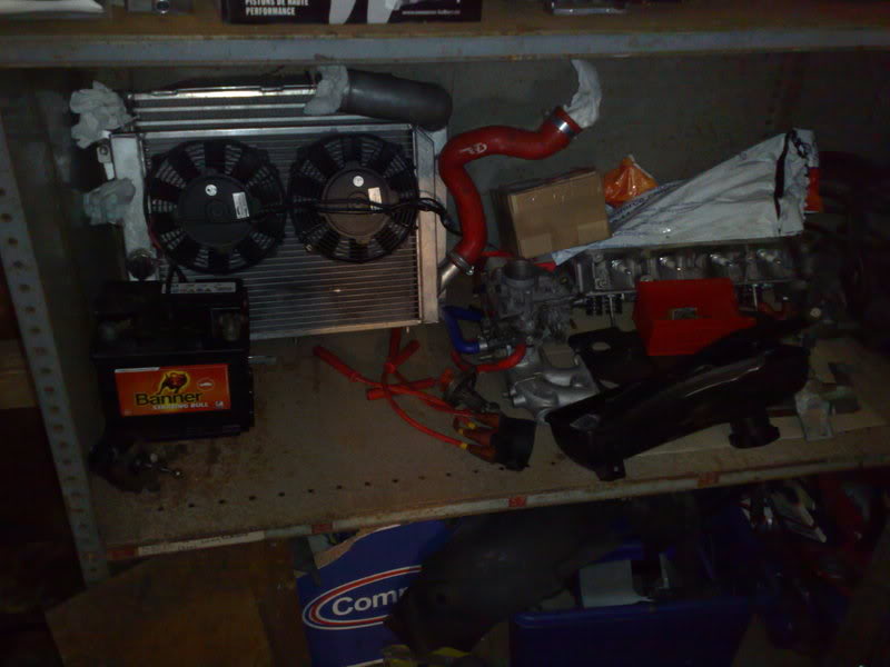

Progress is sloooooowwwww! :crap: and the pictures below kind of reflect that! I have done some bits, and im hoping that things are going to start picking up pace again in the next few months. Im aiming to have everything sorted for national day! Trouble is i often only get one day a week to do anything to it!
Anyway...

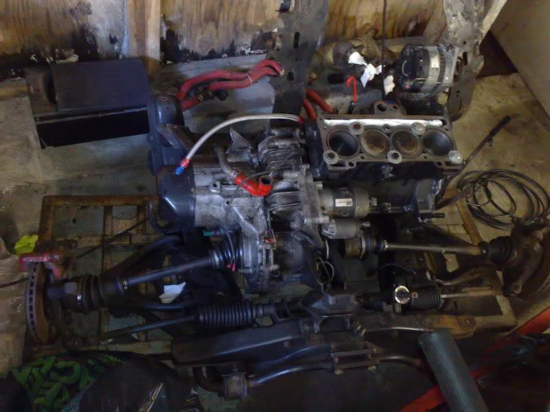

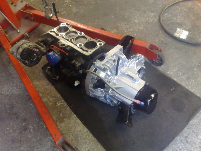

My engines still in abit of a state!
http://i33.photobucket.com/albums/d9...7032009615.jpg
two halfs in fact
http://i33.photobucket.com/albums/d9...7032009617.jpg

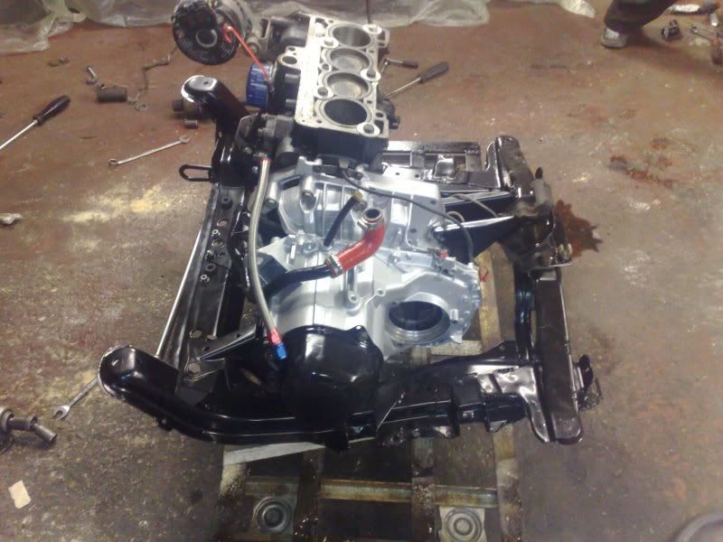

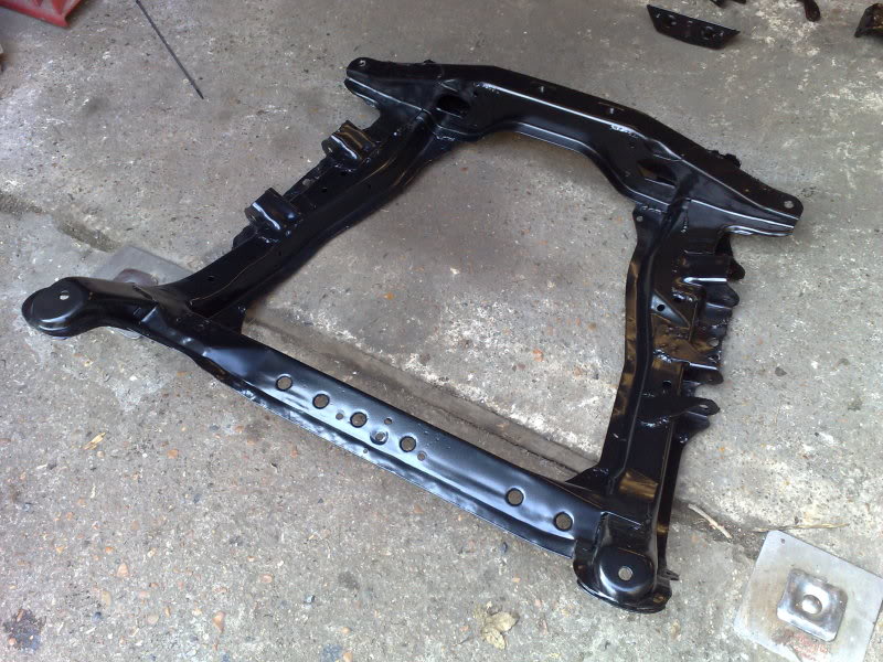

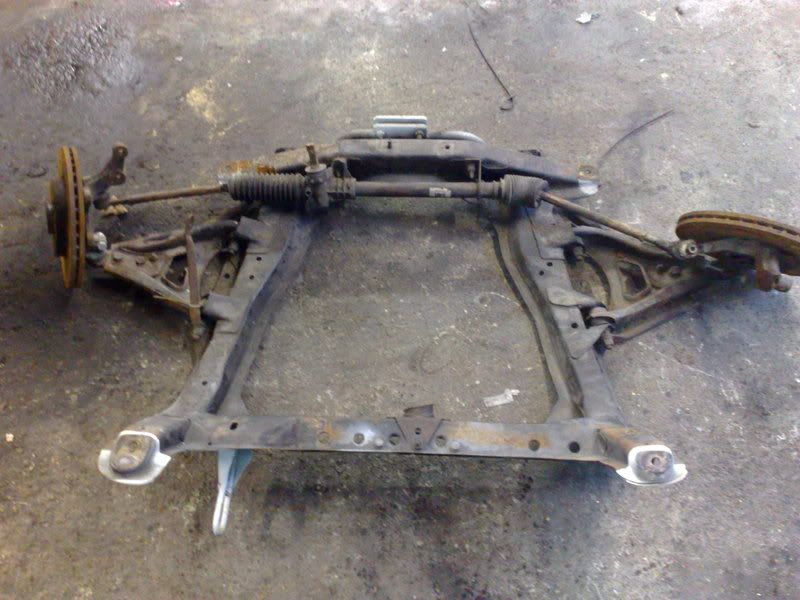

Got another subframe that i'll be getting sorted out to use.
http://i33.photobucket.com/albums/d9...5022009614.jpg

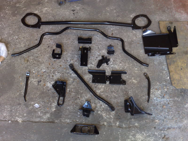

and all of these bits have gone to powdercoating today
http://i33.photobucket.com/albums/d9...8032009620.jpg

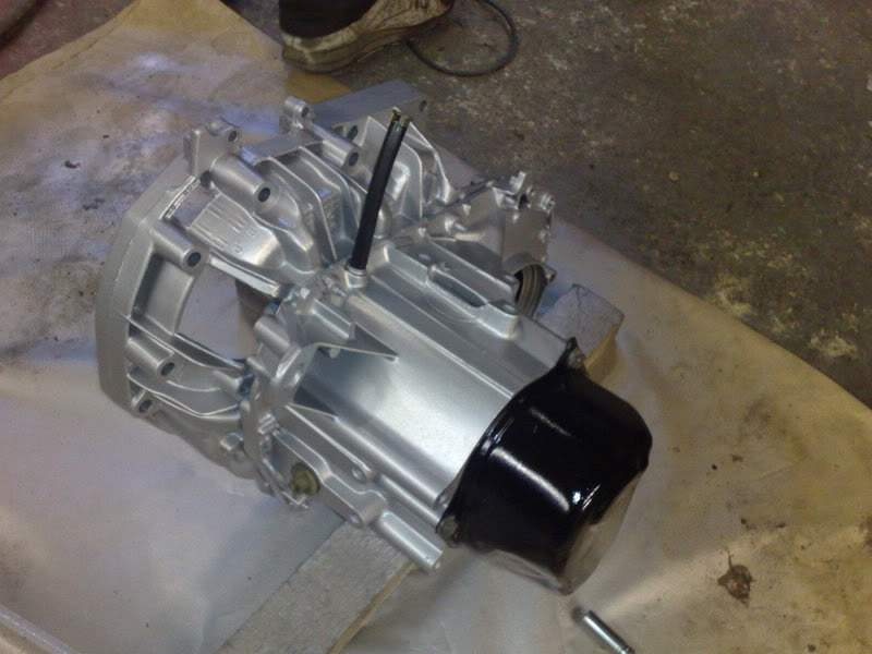

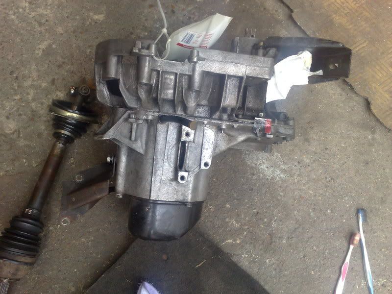

Ive got a gearbox with gripper lsd that will be going in the car, so spent my time at the weekend sorting that out.
http://i33.photobucket.com/albums/d9...7032009618.jpg
http://i33.photobucket.com/albums/d9...32009624-1.jpg

How much did you have to shorten the N/S driveshaft by Bushy?
Matt5
Matt5
Matt5
Thats another hurdle i still need to cross! I got the box with the driveshaft but the guy reckoned it needed shortening more. Where ive got my old box and shafts im hoping it shouldn't be too hard to work out.
Have you got to do the same?
I fitted Dave Clarks gearbox with a Gripper already installed, was assured by the guy who re-furbed the 'box it didn't need shortening....lo and behold....we did need to shorten it........:mad:
Obviously Russel T and Dave are the guys to ask, but off the top of my head it was around 25mm..........
Yeah, i must admit i had 30mm in my head from what id read before. I haven't even looked at the one ive got up against a standard one yet! Should give me a clue as to how much shorter it is though. Quite looking forward to feeling how different it is to drive with the lsd :)
I had mine shortened by an inch when i had the Gripper LSD gearbox, can't think who i sold mine to now.
I recognise the box in the pic's, believe its my mate Freds old one
Some of my bits finally came back from powdercoating last week. Most importantly the subframe as i needed this to get things moving in the engine bay.
http://i33.photobucket.com/albums/d9...2032009642.jpg
http://i33.photobucket.com/albums/d9...2032009644.jpg
Had a few other bits turn up as well. My steering rack looked like it had a slight bend in one of the arms, and most of my suspension parts were corroded (see previous pictures). Aslo got the front half of my brake system as i'll need to run the lines before fitting the engine.
http://i33.photobucket.com/albums/d9...4032009629.jpg
http://i33.photobucket.com/albums/d9...4032009626.jpg
The only actual work that got done on the car was on Sunday. It was progress at least though! :)
http://i33.photobucket.com/albums/d9...2032009646.jpg
http://i33.photobucket.com/albums/d9...2032009647.jpg

Well more has been going on, my mate rob really deserves the praise for any progress there has been to date as he spends loads of his own time on my car and without that it wouldn't be in the shape its in now.
The car has been sat on axle stands for a while so refitted a subframe to get it moving about. This gave the oppotunity to try and do some work in the bay that was required before refitting the engine. Also meant that the new suspension bits had to go together.
http://i33.photobucket.com/albums/d9...8032009655.jpg
All the new brake lines had to be made up for the front of the car
http://i33.photobucket.com/albums/d9...5042009684.jpg
http://i33.photobucket.com/albums/d9...5042009687.jpg
http://i33.photobucket.com/albums/d9...5042009686.jpg
Id always had a clearance problem since fitting the one-piece downpipe and re-locating my header tank with the heater matrix pipes. You can see where the pipes are marked in this picture:
http://i33.photobucket.com/albums/d9...5042009685.jpg
Luckily they haven't gone throught so it was decided to repair them and make a few mods.
http://i33.photobucket.com/albums/d9...5042009690.jpg
http://i33.photobucket.com/albums/d9...2042009693.jpg
The heatshield will be covered by a reflective heat surface, hopefully preventing any further problems to the pipes.
The engine has come together also, hopefully not too far from getting it all back up on the car! ...been a while. (cable ties on the heat wrap is just temporary until the proper ties arrive in the post)
http://i33.photobucket.com/albums/d9...0042009692.jpg
