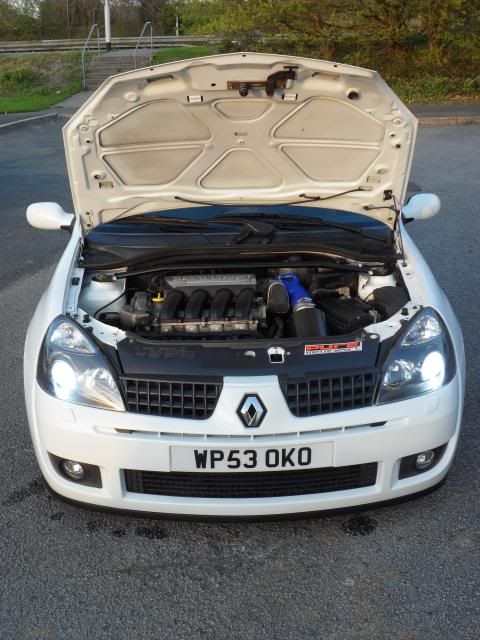

WP53 OKO - Glacier White Renault Sport Clio 172 Cup
Apologies for the amount of photo's I take.. I've copied the entire thread from Cliosport.net so it's quite an introduction :ashamed:
However, that's what projects are all about !?

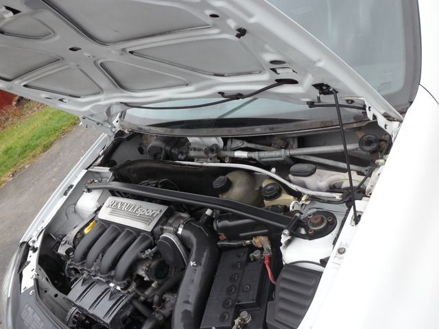

The misses and I have owned a tidy Trophy spec 172 in Flame Red, an immaculate DCI 100 with lots of extras, and a Liquid Yellow 182 (I still miss this car). I enjoyed driving each one of them and said one day I would get myself one at some point, and here we are.
The car's original advert and pictures:

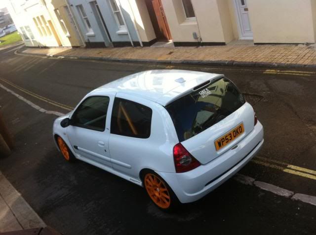

Stunning White with ST Orange Alloys - :scared:
Cammed and Ktec Chipped - Pretty sure it has a Ktec Stage 1 Map, but the cams I highly doubt
Ktec Coilovers
Ktec Matched Inlets
K&N Apollo Induction kit

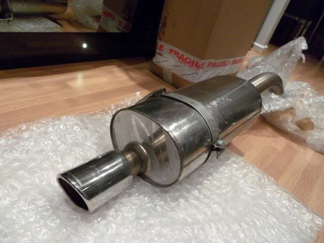

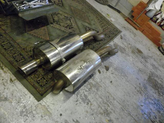

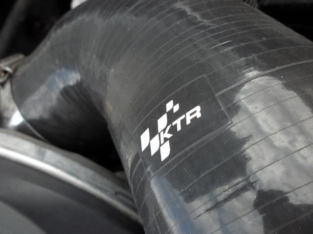

Ktec Stealth Exhaust - Also has a decat pipe
182 Gear Box - This was hardly a selling point - The speedo didn't work !
Show cage - Dangerous
Carbon Fibre Trims - Mirrors, Bullets, Rear bumper strip, Front Fog Surrounds - See thread
Polybushed - All I can see so far is a Powerflex dogbone mount
De-badged boot
"This car sounds AMAZING, like it's on throttle bodies"

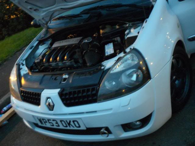

I took the car straight to the garage and set about getting some pics before work began:
http://i191.photobucket.com/albums/z...psba164a13.jpg
http://i191.photobucket.com/albums/z...ps2a317c7b.jpg
http://i191.photobucket.com/albums/z...psc09ca0de.jpg
http://i191.photobucket.com/albums/z...ps47c160ed.jpg
http://i191.photobucket.com/albums/z...ps0c218c4a.jpg

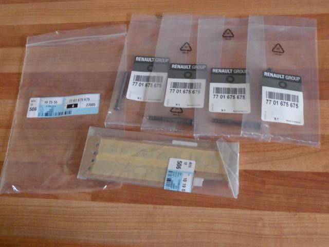

Door pillar badges were missing so..
http://i191.photobucket.com/albums/z...ps59cf58d6.jpg

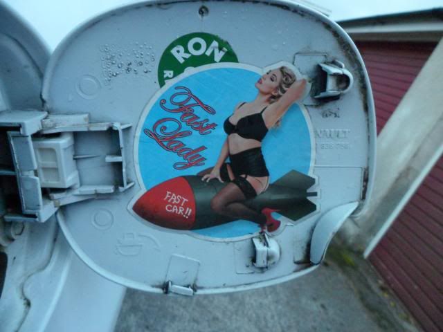

Stupid petrol cap and rear window stickers removed
http://i191.photobucket.com/albums/z...psde450e7b.jpg
http://i191.photobucket.com/albums/z...ps13b36575.jpg
http://i191.photobucket.com/albums/z...ps4d6a13fd.jpg

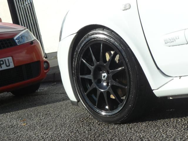

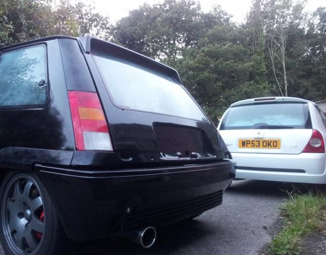

As an emergency measure, borrowed my 5's William's wheels
http://i191.photobucket.com/albums/z...ps34d890a1.jpg
http://i191.photobucket.com/albums/z...ps909d7d9c.jpg
http://i191.photobucket.com/albums/z...ps46e3d459.jpg

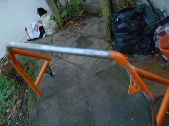

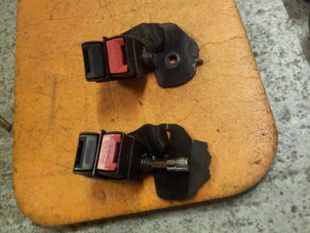

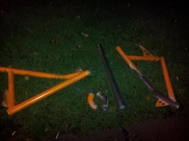

Got a bit dark so drove home and unbolted the "cage" ..... also ST Orange but had started to be sanded down
http://i191.photobucket.com/albums/z...ps87ddc251.jpg
On the new wheels
http://i191.photobucket.com/albums/z...ps7bc24815.jpg
http://i191.photobucket.com/albums/z...psf4adbb32.jpg

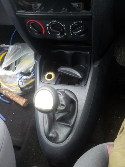

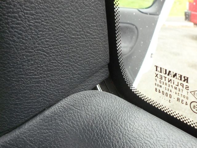

Next set about doing a few bits to the interior
How the centre console was fitted...
http://i191.photobucket.com/albums/z...ps9b49e638.jpg
Unplugged and broken hazard switch
http://i191.photobucket.com/albums/z...ps37ea2699.jpg
http://i191.photobucket.com/albums/z...ps5a3ee01f.jpg

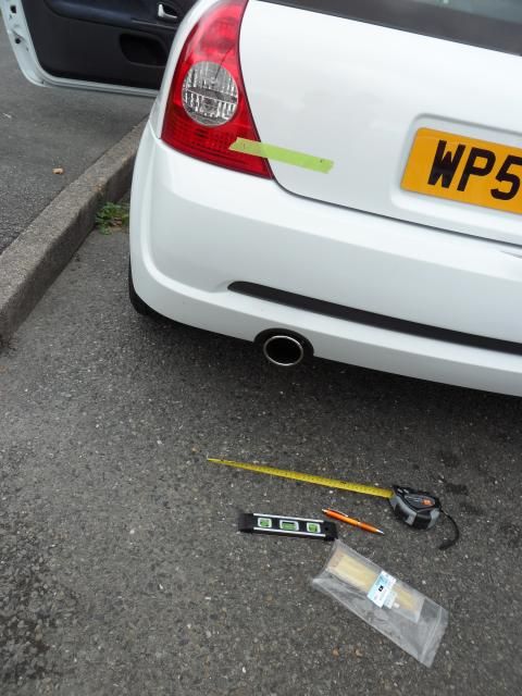

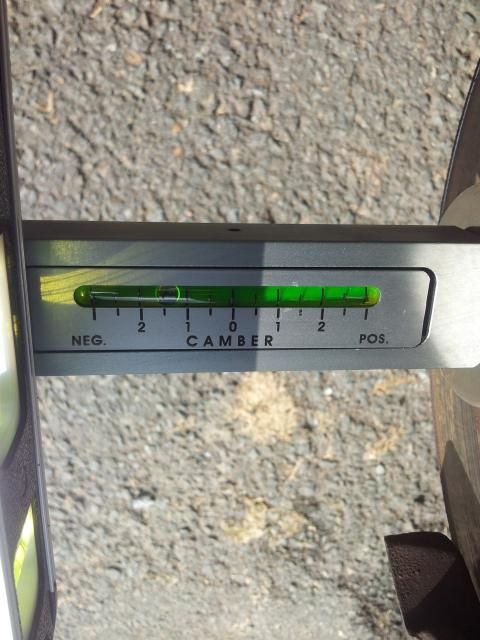

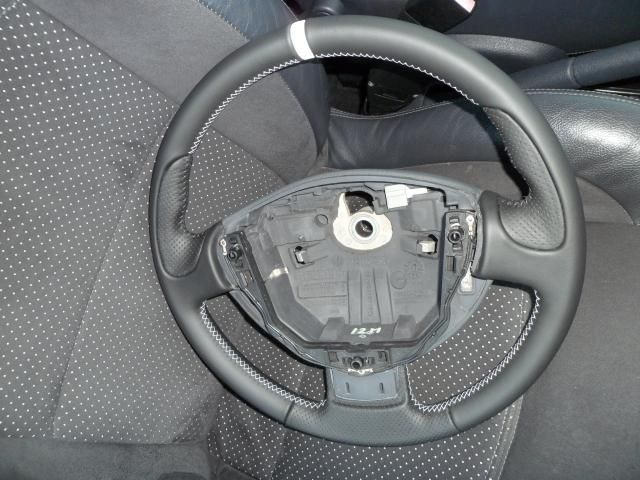

How the steering was... (Ball joint was LOOSE and tracking 3-4 degrees out...) So had this sorted on the finest laser equipment
http://i191.photobucket.com/albums/z...pscfe88be7.jpg
http://i191.photobucket.com/albums/z...ps343add5d.jpg

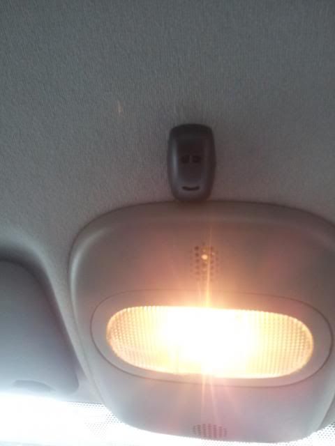

Changed a blown reversing bulb for a reversing beeper, why not
http://i191.photobucket.com/albums/z...psc136cf43.jpg

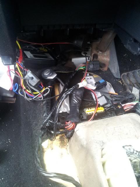

Set about removing all the crap behind the console and dash, Nokia Bluetooth kit etc
http://i191.photobucket.com/albums/z...psb8fb1737.jpg
http://i191.photobucket.com/albums/z...psd3e83247.jpg
http://i191.photobucket.com/albums/z...ps06251390.jpg
Here shows other things that went in the bin (guess the bulb colour)
http://i191.photobucket.com/albums/z...ps679c4291.jpg

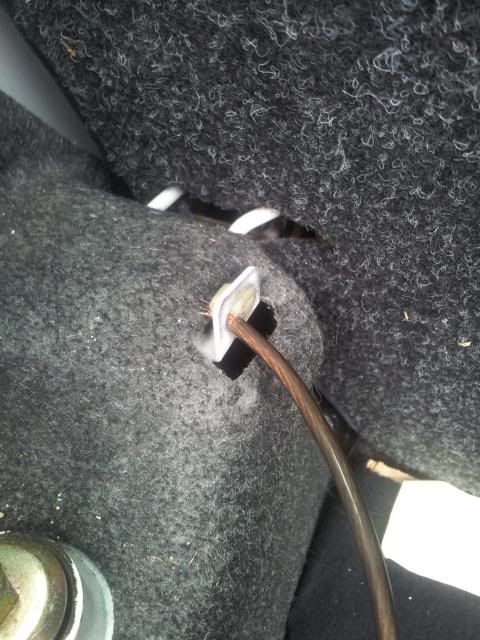

Sub earth
http://i191.photobucket.com/albums/z...ps7b8a0b53.jpg

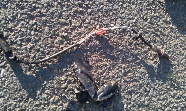

Amp live cable!
http://i191.photobucket.com/albums/z...ps15de87ad.jpg
Loose switch
http://i191.photobucket.com/albums/z...psad3a21d6.jpg
http://i191.photobucket.com/albums/z...psb67f41f7.jpg

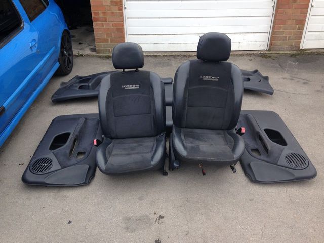

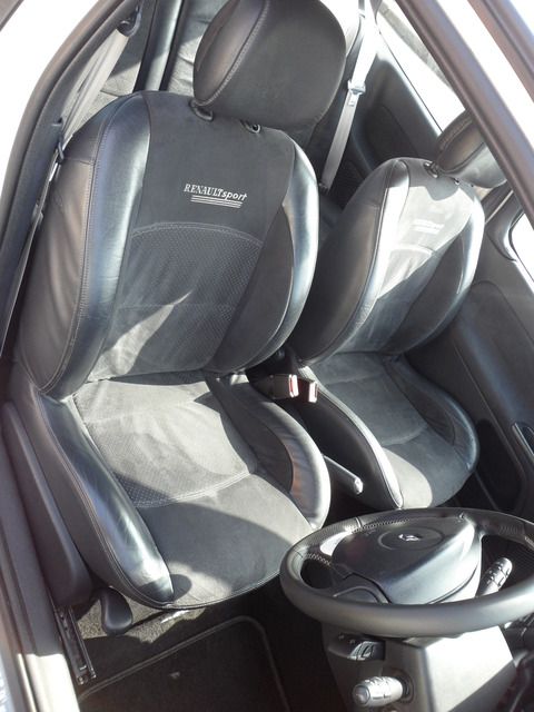

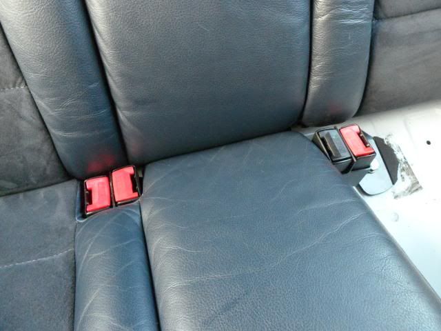

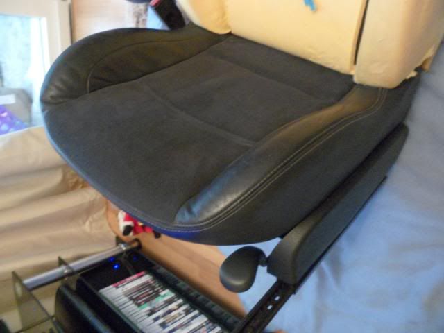

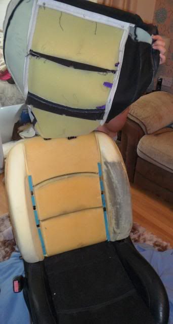

The seats
http://i191.photobucket.com/albums/z...ps7245d921.jpg
You may of noticed the "Carbon" the car was advertised with... It's now in the bin
http://i191.photobucket.com/albums/z...ps7b874a83.jpg
http://i191.photobucket.com/albums/z...psfb7c5daf.jpg
http://i191.photobucket.com/albums/z...ps31b6d584.jpg
http://i191.photobucket.com/albums/z...ps0dcacd46.jpg
http://i191.photobucket.com/albums/z...psd48d8b51.jpg
http://i191.photobucket.com/albums/z...ps94c0980a.jpg
http://i191.photobucket.com/albums/z...ps96271488.jpg

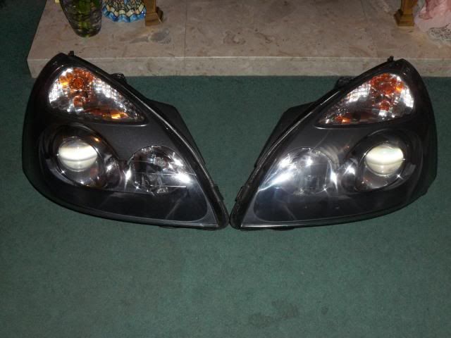

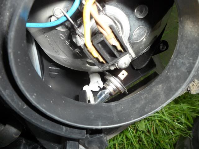

Old headlights... Spare bulb anyone? Not even connected to the adjuster :S
http://i191.photobucket.com/albums/z...psaa6be8d6.jpg

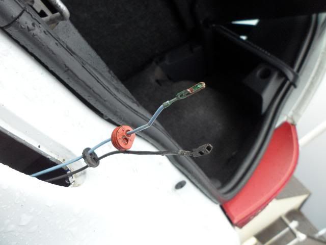

http://i191.photobucket.com/albums/z...ps64ae5fc3.jpg

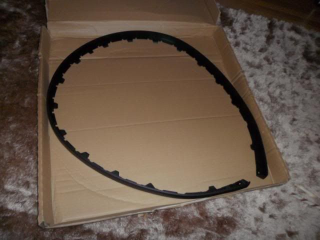

Misses arrived home with a delivery.. Bootlid #2 - Thanks Renparts
http://i191.photobucket.com/albums/z...ps0e195bbd.jpg
http://i191.photobucket.com/albums/z...psc8f13795.jpg
http://i191.photobucket.com/albums/z...ps38de223f.jpg
http://i191.photobucket.com/albums/z...psaa400d65.jpg
http://i191.photobucket.com/albums/z...psc0c2eac5.jpg

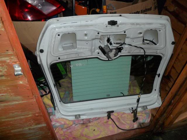

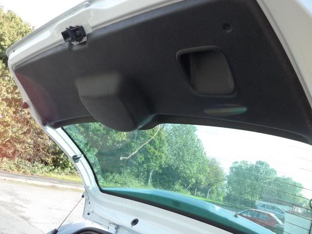

Changed the bootlid
http://i191.photobucket.com/albums/z...ps6a31a422.jpg
http://i191.photobucket.com/albums/z...ps8a1f2c99.jpg
http://i191.photobucket.com/albums/z...ps877bf3cb.jpg

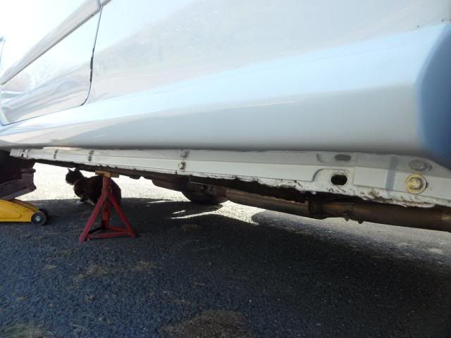

The Cup decided to ask santa for a clutch...
Mean't I could fit my speedo drive box, Millers Fully Synth and an OE non-slipping clutch!
http://i191.photobucket.com/albums/z...ps9d120fd5.jpg
http://i191.photobucket.com/albums/z...pse09a6d22.jpg

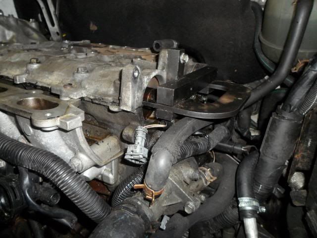

Tool's at the ready here goes..
This job was a complete nightmare working on the floor, barely above freezing temps, on axel stands, and on your own bench pressing it all!
http://i191.photobucket.com/albums/z...psd780d977.jpg
http://i191.photobucket.com/albums/z...psaae12110.jpg
http://i191.photobucket.com/albums/z...ps9a72aef5.jpg

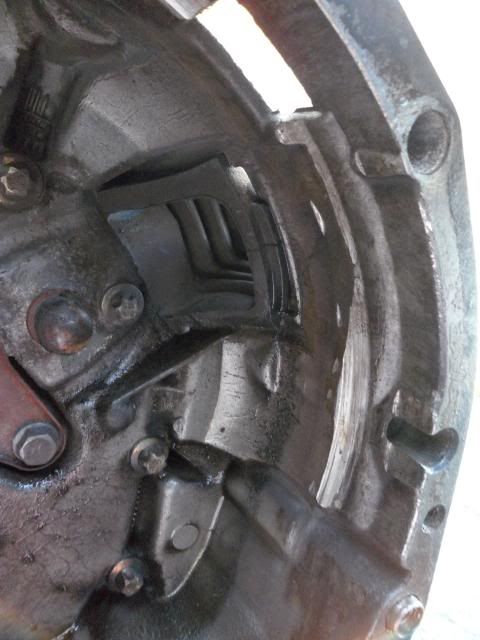

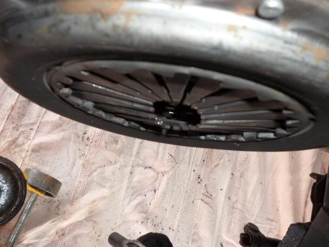

What I found ..
http://i191.photobucket.com/albums/z...ps65749849.jpg
Pressure plate.. bolt stuck in place and cracked casing
http://i191.photobucket.com/albums/z...psa2704dac.jpg
Other side completely broken off (piece was still bolted in the flywheel)

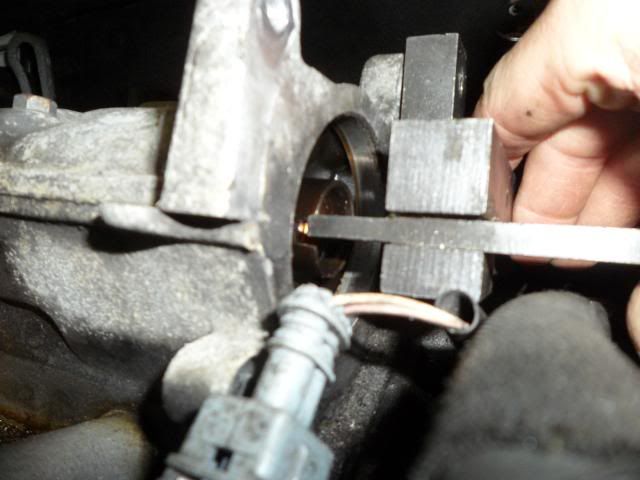

New Valeo Clutch, bearing, pressure plate, grease and alignment tool and plate
http://i191.photobucket.com/albums/z...ps60bfd81c.jpg
Boom! Aligned a beaut, box slide on first time on my own
http://i191.photobucket.com/albums/z...ps3d739519.jpg
http://i191.photobucket.com/albums/z...ps881f5fd1.jpg

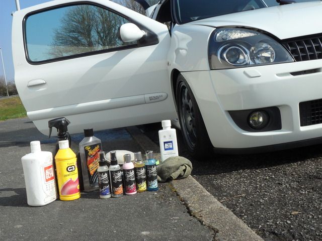

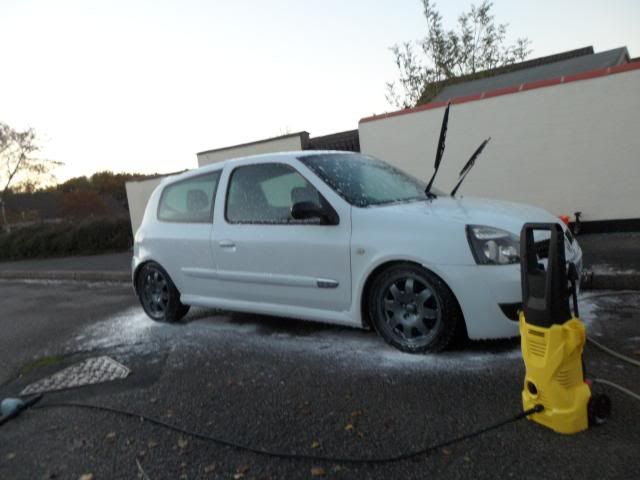

The car was pretty lagged with all the work so a Karcher / Meguiars clean down
http://i191.photobucket.com/albums/z...ps150049b9.jpg
http://i191.photobucket.com/albums/z...psbfcba249.jpg

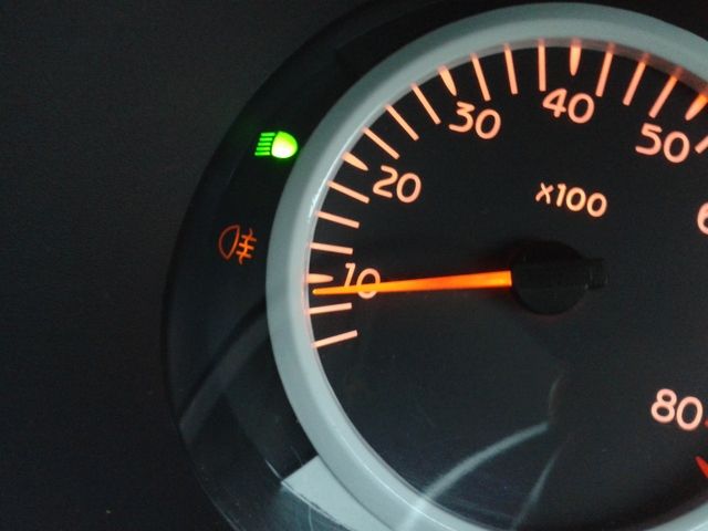

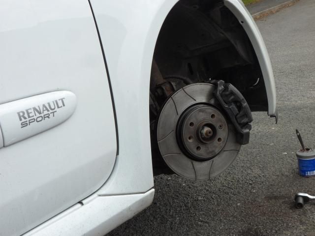

Took it to the end of the street and back, speedo working, auto lock kicked in, and things were feeling good apart from the camber was miles out.

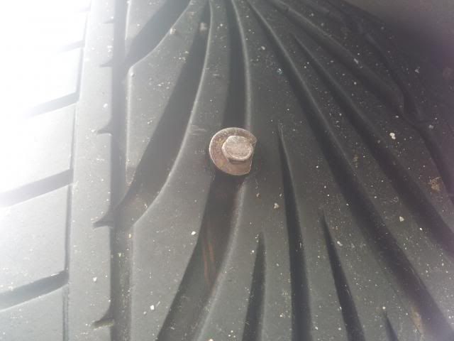

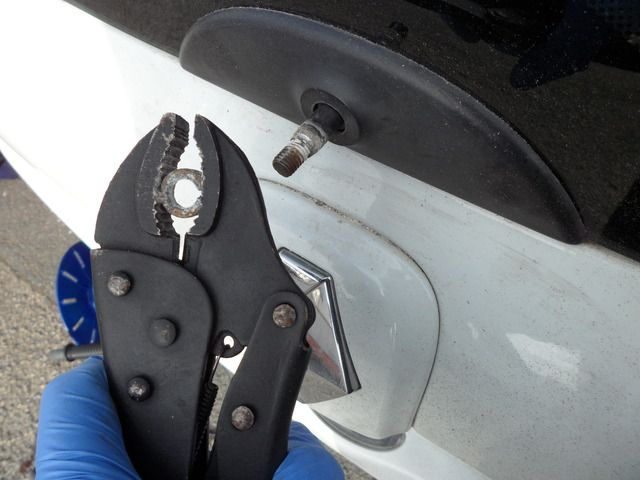

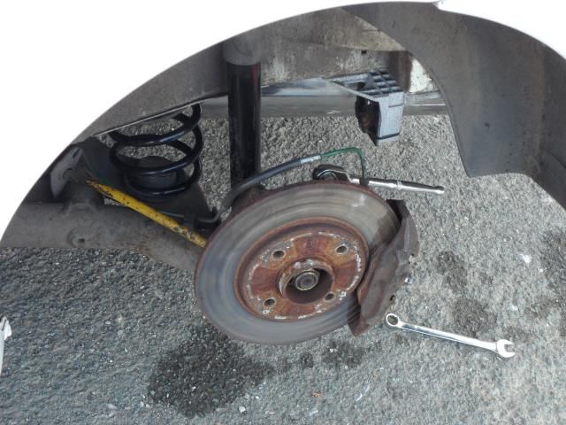

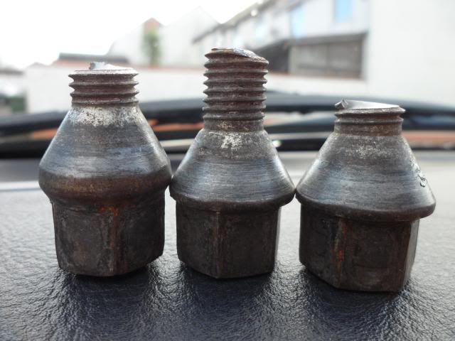

So went to pull the wheels off but the passenger side bolts decided to snap..
http://i191.photobucket.com/albums/z...ps62fda03b.jpg
Sigh !
http://i191.photobucket.com/albums/z...psb2b3f6b6.jpg

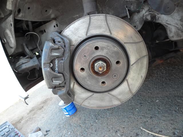

Sorted another Cup hub
http://i191.photobucket.com/albums/z...pse8891fe1.jpg
http://i191.photobucket.com/albums/z...ps2cfe5966.jpg
Plan: New wheel bolts all round!

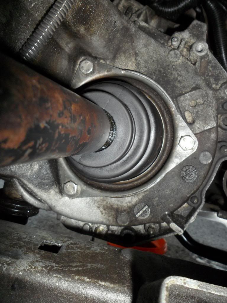

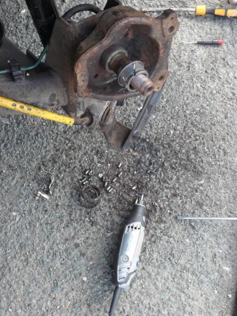

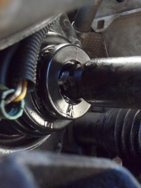

Boot popped off the bearing
http://i191.photobucket.com/albums/z...ps12609e96.jpg
Re-seated but still leaking
http://i191.photobucket.com/albums/z...ps56f62e9c.jpg

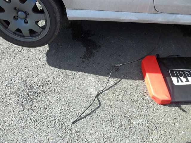

Another gear oil drain !
http://i191.photobucket.com/albums/z...ps1b03108c.jpg
http://i191.photobucket.com/albums/z...psf7cab940.jpg

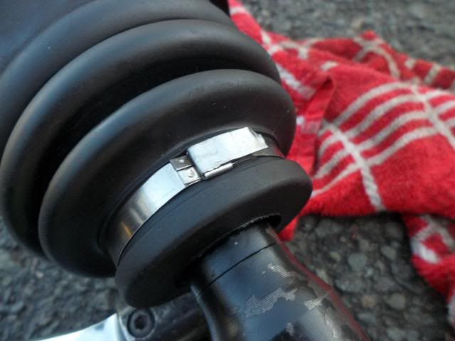

Turned out the boot clip was my issue, no wonder I couldn't solve the leak, should of spotted this after doing the box
http://i191.photobucket.com/albums/z...ps2a1dff0e.jpg
Degreased inside and out, now with permanent clip, pressed on with tool
http://i191.photobucket.com/albums/z...psff895372.jpg

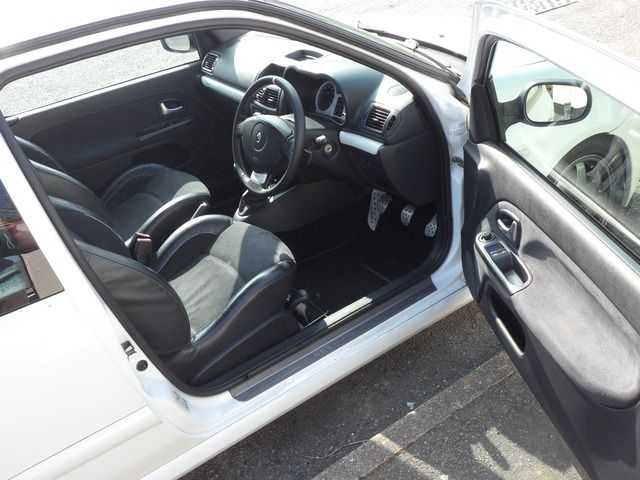

Moving off the mechanical side of things for a minute
The passenger seat wasn't able to used for getting into the back, because of this
http://i191.photobucket.com/albums/z...psbdc864e8.jpg
http://i191.photobucket.com/albums/z...ps69e866a7.jpg

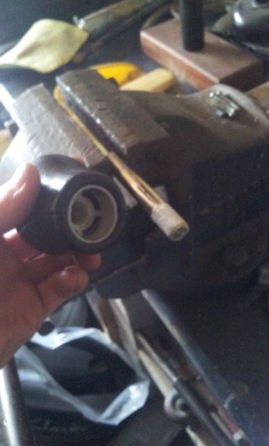

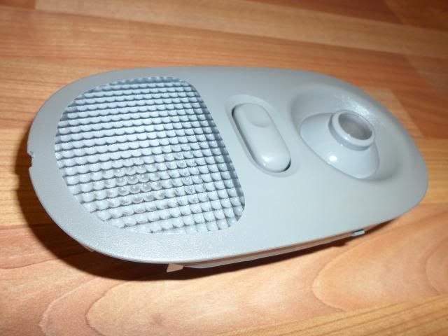

Still had the old seats lying around, and personally prefer the phase two handles, so they got used as donors for a phase 1/2 swap
http://i191.photobucket.com/albums/z...ps2db31451.jpg
http://i191.photobucket.com/albums/z...pse5fb6e9b.jpg
http://i191.photobucket.com/albums/z...ps7fa0a386.jpg
http://i191.photobucket.com/albums/z...pse3456a21.jpg
http://i191.photobucket.com/albums/z...psa6d6de62.jpg
http://i191.photobucket.com/albums/z...ps6985b1ef.jpg
http://i191.photobucket.com/albums/z...ps4aef1c78.jpg
http://i191.photobucket.com/albums/z...ps03e43c2a.jpg

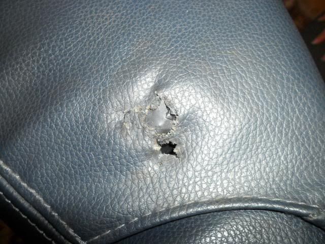

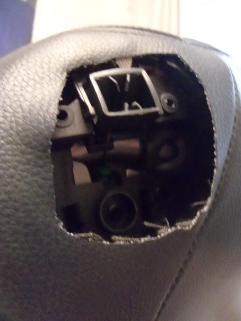

The hole from the old handle, used some black tape behind, then super glue to pull it all in
http://i191.photobucket.com/albums/z...psdf56cebd.jpg
Then used a small patch from cutting out the new handle earlier
Without the flash on this isn't hardly noticeable now its in the car :) Will do the drivers seat in time
http://i191.photobucket.com/albums/z...ps6e25da62.jpg

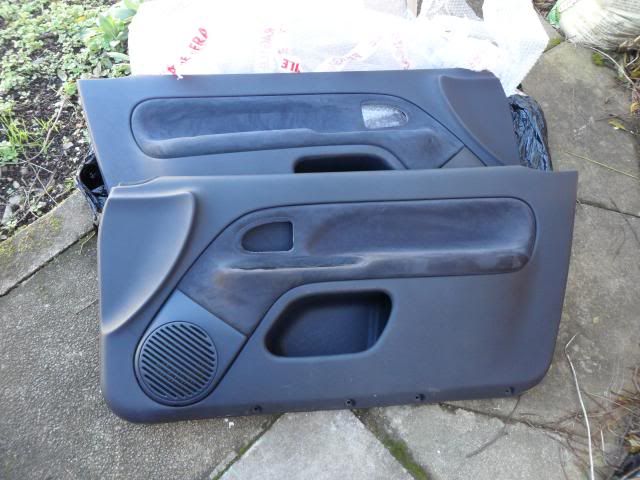

Alcantara door cards
http://i191.photobucket.com/albums/z...ps0a245a00.jpg
http://i191.photobucket.com/albums/z...ps8b0eeeff.jpg

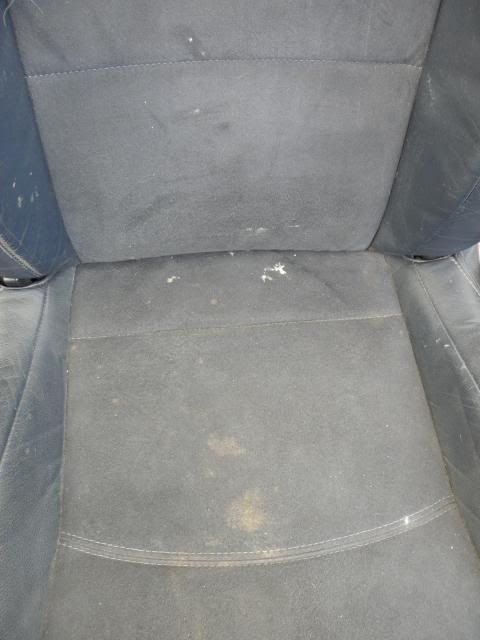

Cleaned these up along with a new set of matching black seat belts
http://i191.photobucket.com/albums/z...psba1673c7.jpg

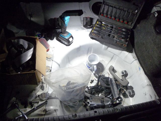

Fitting time, replacement plastics, trims, new clips, parcel shelf etc
http://i191.photobucket.com/albums/z...ps38862ff0.jpg
http://i191.photobucket.com/albums/z...psb211854d.jpg
http://i191.photobucket.com/albums/z...psc13eb10e.jpg
http://i191.photobucket.com/albums/z...ps7a788c26.jpg
http://i191.photobucket.com/albums/z...ps4576585c.jpg

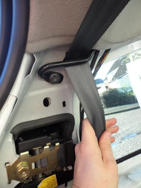

3rd rear belt swap
http://i191.photobucket.com/albums/z...psf82e13ce.jpg
http://i191.photobucket.com/albums/z...ps69a64491.jpg
http://i191.photobucket.com/albums/z...ps55c8840e.jpg
http://i191.photobucket.com/albums/z...ps700ea9e5.jpg

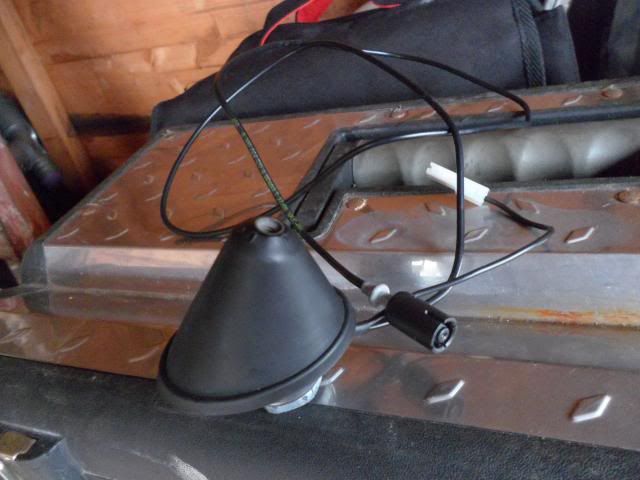

Found some more carbon wrap hidden away.. BIN!
http://i191.photobucket.com/albums/z...pse55a74c4.jpg
http://i191.photobucket.com/albums/z...ps48b6ecaa.jpg

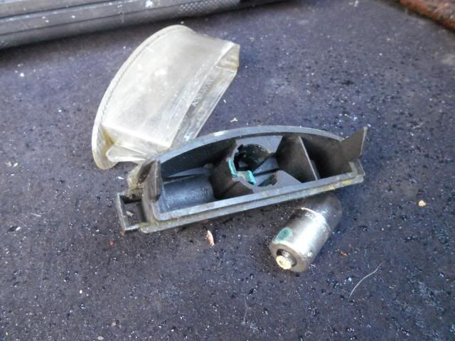

Some other bits which were bugging me, why do people do things like this?!
http://i191.photobucket.com/albums/z...pse9c375ae.jpg
http://i191.photobucket.com/albums/z...psda6be27c.jpg
http://i191.photobucket.com/albums/z...ps1675d42e.jpg
http://i191.photobucket.com/albums/z...ps67d11285.jpg

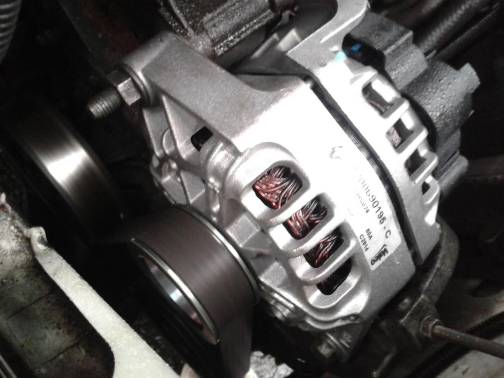

Cam belt kit
Dephaser
Aux Belt
Cam shaft seals
Oil and Filter
Rocker cover resealed
Sump removed and resealed
and a couple of other issues put right he found (like the aux belt fitted the wrong way round and a tensioner)
http://i191.photobucket.com/albums/z...ps0d18d231.jpg
Re: WP53 OKO - Glacier White Renault Sport Clio 172 Cup
http://i191.photobucket.com/albums/z...psdb31fdec.jpg
http://i191.photobucket.com/albums/z...psa804630d.jpg

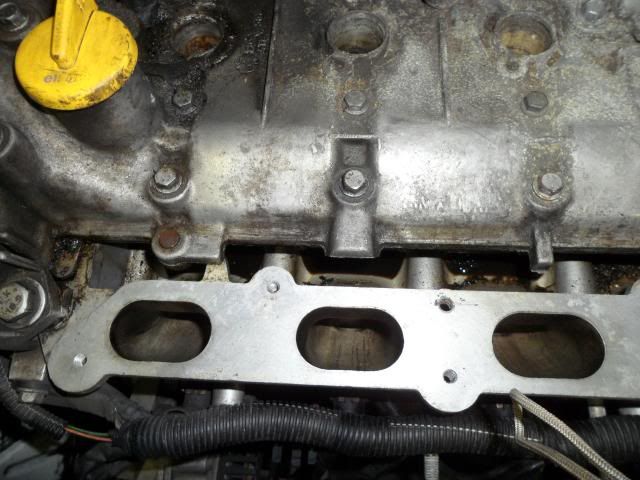

Note the oil collected from the leak..

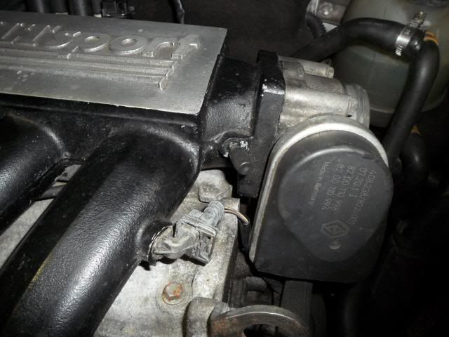

Re-coiled inlet plenum threads and replaced the bolts as they were all wrong and threaded!
http://i191.photobucket.com/albums/z...ps66871e57.jpg
Timing before
http://i191.photobucket.com/albums/z...ps7bc4bb03.jpg
Leaky cam seal!
http://i191.photobucket.com/albums/z...ps3ab89f59.jpg
Not seated correctly from the last belt change
http://i191.photobucket.com/albums/z...psf92ad41b.jpg
http://i191.photobucket.com/albums/z...psb6e4990c.jpg
Timing
http://i191.photobucket.com/albums/z...psd96e3cb2.jpg

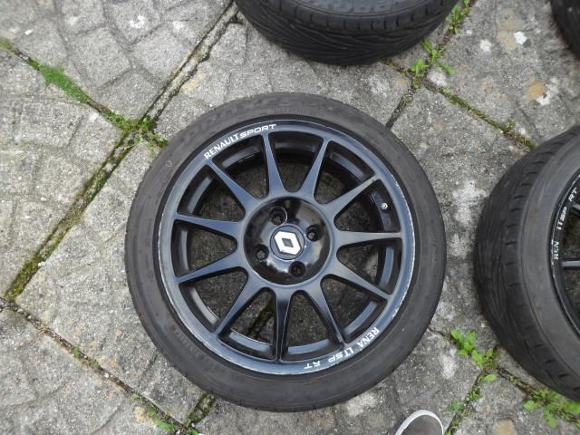

Cleaned up the wheels
http://i191.photobucket.com/albums/z...ps6723d9cd.jpg

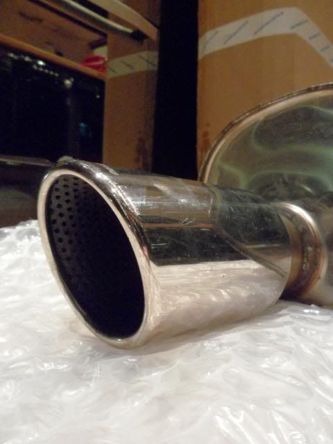

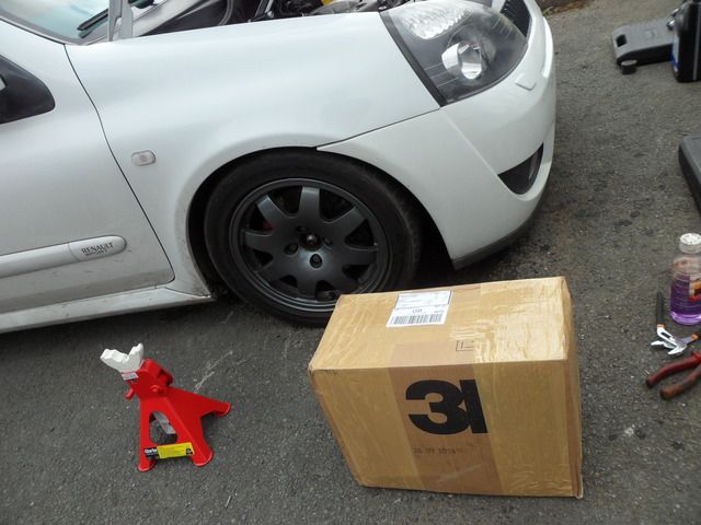

Deciding I wanted to change the exhaust, and opted for a K-Tec recessed exhaust system..
Hit pot luck when someone showed interest in my stealth system, as he wanted rid of his recessed one, so an exchange later...
http://i191.photobucket.com/albums/z...pseb45b63d.jpg
http://i191.photobucket.com/albums/z...ps67d64f3b.jpg
http://i191.photobucket.com/albums/z...ps5ab1d175.jpg
http://i191.photobucket.com/albums/z...ps6c405587.jpg
Picked up some other goodies for the job:
Renault Red Centre Mount (got through 2 non genuine ones already!)
Renault Manifold to Cat Gasket Kit
Renault Cat to Centre Gasket
Genuine 182 Surround
Mikalor clamps
http://i191.photobucket.com/albums/z...ps25cec530.jpg
http://i191.photobucket.com/albums/z...ps3b0e71cc.jpg

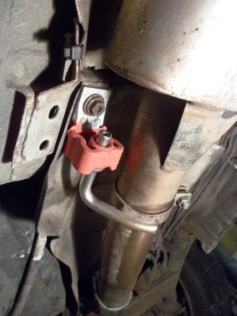

Off with the stealth.. where I found my exhaust rattle/knocking, heat shield collapsed and sat on top of the backbox / rear beam section
http://i191.photobucket.com/albums/z...ps0c76302c.jpg
http://i191.photobucket.com/albums/z...ps4d9448e0.jpg
Washer and nut.. Sorted
http://i191.photobucket.com/albums/z...ps034cfebd.jpg
http://i191.photobucket.com/albums/z...psa4ef0026.jpg
http://i191.photobucket.com/albums/z...ps3b6dae4e.jpg
http://i191.photobucket.com/albums/z...ps9191a658.jpg

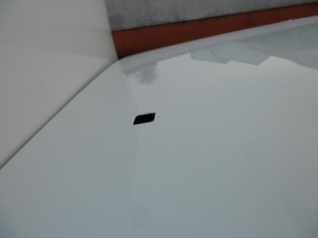

Got a new Dremel, couldn't be without one of these for doing stuff like this
No more tippex'd? touched up tatty bumper..
http://i191.photobucket.com/albums/z...ps2d497183.jpg
http://i191.photobucket.com/albums/z...ps03317941.jpg
http://i191.photobucket.com/albums/z...ps389989f0.jpg
Bumper back on and done!
http://i191.photobucket.com/albums/z...psd28b9949.jpg
http://i191.photobucket.com/albums/z...psb59b7819.jpg
Wasn't going to do the downpipe/cat on axel stands so dropped down to a mates garage
http://i191.photobucket.com/albums/z...ps70c7fb47.jpg
Nasty DIY decat and cheap / bent / glued gaskets
http://i191.photobucket.com/albums/z...ps48c6c963.jpg
http://i191.photobucket.com/albums/z...ps4303b936.jpg
http://i191.photobucket.com/albums/z...psf9e97244.jpg

Skoda Fabia splitter group buy
http://i191.photobucket.com/albums/z...ps0e139ab3.jpg
http://i191.photobucket.com/albums/z...psff869ce5.jpg

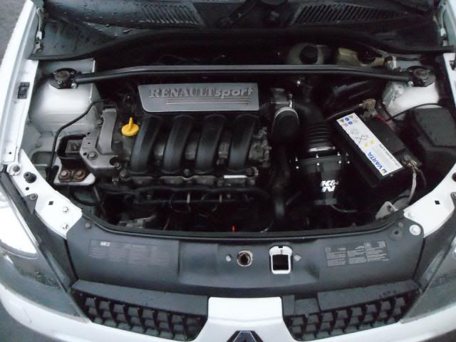

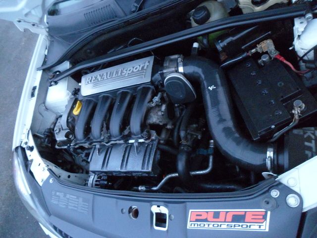

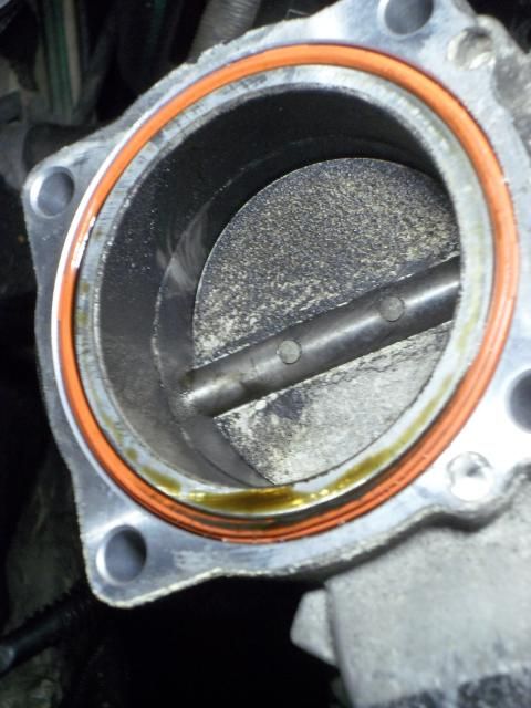

Gave the bay a wipe down, refitted the K&N Apollo plastic cover, and removed a couple of bits to tidy it up
http://i191.photobucket.com/albums/z...ps0f3dd7c9.jpg
http://i191.photobucket.com/albums/z...psa69aac6d.jpg
http://i191.photobucket.com/albums/z...psc6d80544.jpg

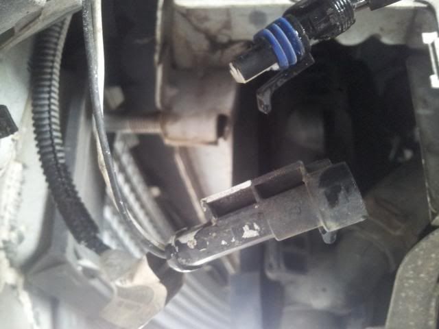

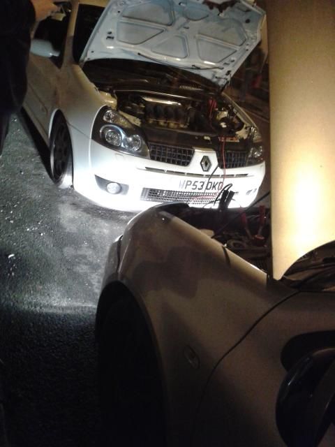

Things were going well.. until I had no starting motor one morning.. knew exactly why and found this predictably blowing in the wind..
http://i191.photobucket.com/albums/z...ps49fa8612.jpg
Renewed the connection with a spare bootlid wiring loom I had (the heated rear screen connection is identical, even has the same colour wire and plastic plug), took the opportunity to extend it a little while I was there

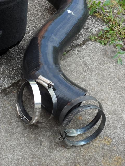

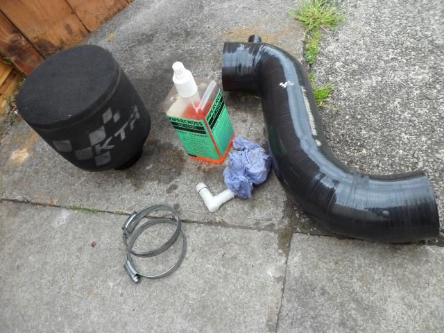

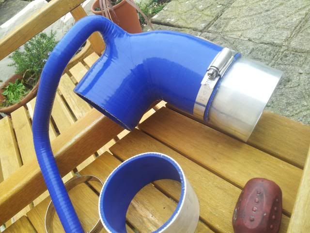

Didn't rate the K&N since the exhaust change, so going to a BMC CDA, a big one..
http://i191.photobucket.com/albums/z...ps7f64bad4.jpg
http://i191.photobucket.com/albums/z...ps80f1dcbe.jpg

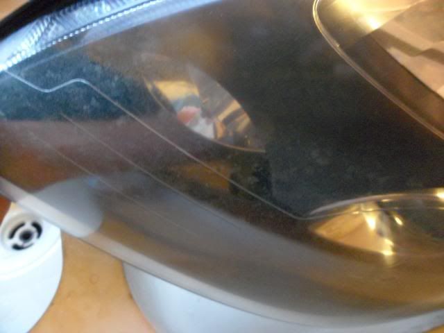

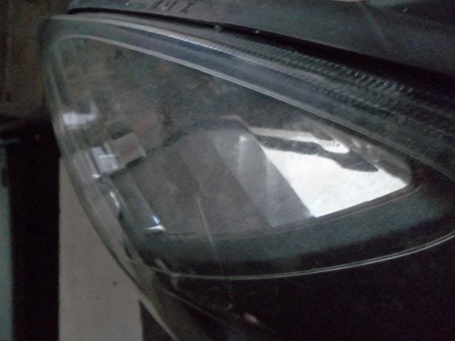

Went over the xenons with the 3M kit as I did them off the car last time around
Was able to give them some good pressure this time (left first stage, right finished)
http://i1310.photobucket.com/albums/...psbf3d45a1.jpg
Done
http://i1310.photobucket.com/albums/...ps161f7f38.jpg

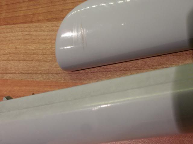

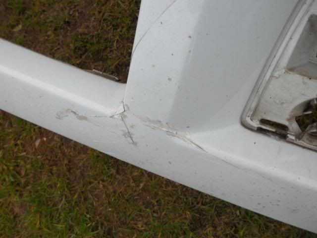

Old mirror caps (foam tapped on..) and some honest photos of what I was hiding regards the front bumper !!
Fell to pieces from poor repair work
http://i1310.photobucket.com/albums/...ps475a2b09.jpg
http://i1310.photobucket.com/albums/...pse0280883.jpg
http://i1310.photobucket.com/albums/...psa44504a8.jpg
http://i1310.photobucket.com/albums/...ps8ad34b2d.jpg
http://i1310.photobucket.com/albums/...psad8d928a.jpg
http://i1310.photobucket.com/albums/...psdd87149d.jpg
Spent the rest of the evening removing the old bumper speed clips and bolts, the bumper was obviously pulled off without undoing the bolts at some point.. nightmare..
New bumper (now actually bolted on to the car)

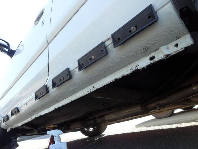

The sideskirt had been forced off/on at some point, used to annoy me seeing this every day..
http://i1310.photobucket.com/albums/...ps5bb69867.jpg
http://i1310.photobucket.com/albums/...psc999690f.jpg
Here's why... typical Clio jacking point error... probably the same time the wheels where taken off to be painted orange .. !
Got cleaning, mole grips, long nose pillars, hammers etc
http://i1310.photobucket.com/albums/...ps44d45a31.jpg
http://i1310.photobucket.com/albums/...psae25a70a.jpg
http://i1310.photobucket.com/albums/...ps1957daf2.jpg
http://i1310.photobucket.com/albums/...ps5655cbe4.jpg
http://i1310.photobucket.com/albums/...ps8bf18a9d.jpg
New bolts, lock nuts and washers, fresh!
http://i1310.photobucket.com/albums/...psd52a5c2a.jpg
http://i1310.photobucket.com/albums/...ps732c897f.jpg

Oh and a wash, standard !
http://i1310.photobucket.com/albums/...ps509771b6.jpg

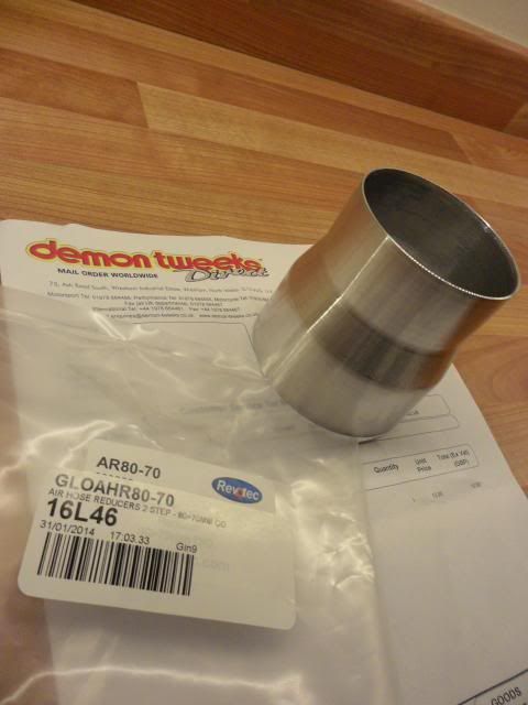

Wasn't happy with the blue induction / reducer adaptor set up, thought I wouldn't be happy with anything other than the BMC CDA, until I tried this out..
KTR's induction kit, in black, which fitted the bill perfectly :)
http://i1310.photobucket.com/albums/...ps1f119e6a.jpg
Gave the filter a good clean with some spare pipercross foam cleaning fluid, and replaced the worn looking jubilee clips
http://i1310.photobucket.com/albums/...psf377753c.jpg
http://i1310.photobucket.com/albums/...ps4e245a9f.jpg
A tight fit, battery did need to come out
http://i1310.photobucket.com/albums/...ps50be82c8.jpg
http://i1310.photobucket.com/albums/...ps6d406586.jpg
http://i1310.photobucket.com/albums/...ps221ad0f8.jpg
Really does sound the nuts though..
Has a slightly less deep note than the BMC but an almost TB type note to it, and really opens up on 5K !
http://i1310.photobucket.com/albums/...psd364382c.jpg
http://i1310.photobucket.com/albums/...ps2a563a25.jpg
The engine was becoming a little unhappy in the mornings, engine code of pre-cat lambda sensor.
Went for a direct to OE plug Bosch fitment one, came with the plastic fitting clip and pre-greased
http://i1310.photobucket.com/albums/...ps0e0b7be2.jpg
http://i1310.photobucket.com/albums/...psedcf8c82.jpg
http://i1310.photobucket.com/albums/...ps2c6d33bd.jpg
This old one was unbranded, had been cut and wire joined (obviously cheap universal one)
Rattled like mad once it was removed!

Whilst I was there, replaced an exhaust mount bolt as the other one turned to cheese..
http://i1310.photobucket.com/albums/...ps4c97ce6c.jpg
Had an intermittent problem with the left indicator bulb.
After time with a multi metre, some forum help from CS.net with pin outs, was down to a pin in the plug dislodged from the slightly

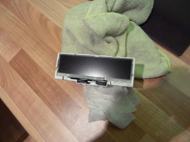

Bit of experience with stripping the clocks, will come in handy for an White LED conversion one day... !

Replaced a rear seat belt buckle that gave up
http://i1310.photobucket.com/albums/...ps0e60649b.jpg

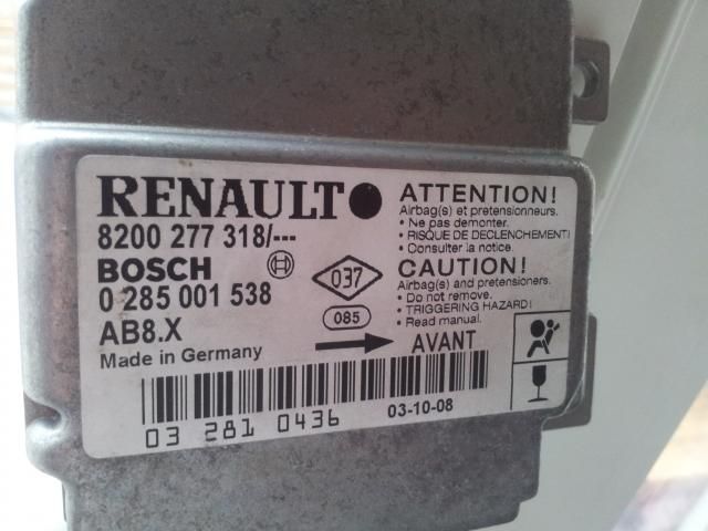

Got another Cup airbag module after having an airbag light since having the car due to a defective module
Thanks to Dan@SJM for sorting the configuration out!

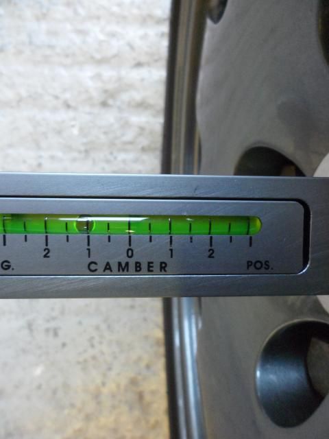

Reduced the camber due to the other Nankangs scrubbing out rather quickly
Down to 0.5 degrees now and towed to match, less silly slow wheel spin pulling out of uphill junctions
http://i1310.photobucket.com/albums/...ps46246181.jpg
http://i1310.photobucket.com/albums/...pscef931f0.jpg

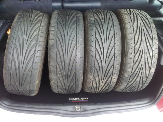

New set of T1R's to match the rears again

Thanks to G_172 from CS.net for getting these brakes to me within a couple of days:
Brembo Front Pads
Brembo Rear Pads
Brembo Rear Discs
Renault Rear Disc Spacers
Replacement Rear Hub Nuts
I also have had an as new set of Brembo Max Front Discs sat around for a while collecting surface rust so dug these out while I was there
http://i1310.photobucket.com/albums/...psc67ae58a.jpg
http://i1310.photobucket.com/albums/...ps13c7eb65.jpg
http://i1310.photobucket.com/albums/...ps4d0a15c3.jpg
Decided to also get hold of a rear pad fitting kit..
A good thing to as mine unbelieveably had NO SPRING RETAINING CLIPS FITTED!
I have no idea how the pads have stayed in, made me feel a little sick..
http://i1310.photobucket.com/albums/...ps64ca74ae.jpg
http://i1310.photobucket.com/albums/...pse1501183.jpg

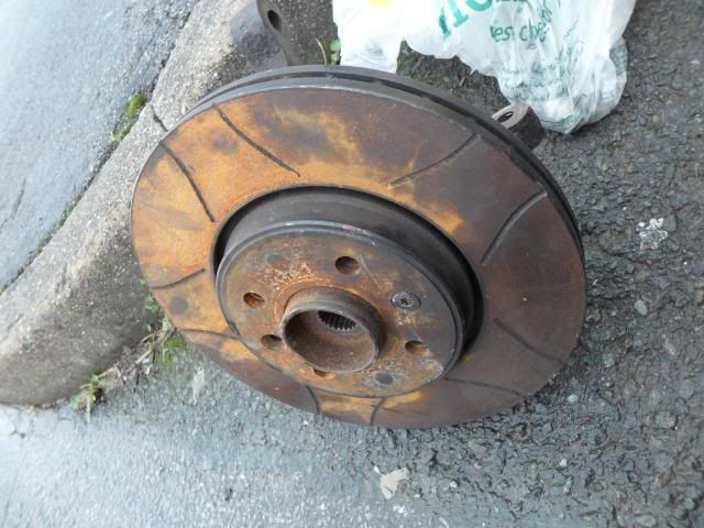

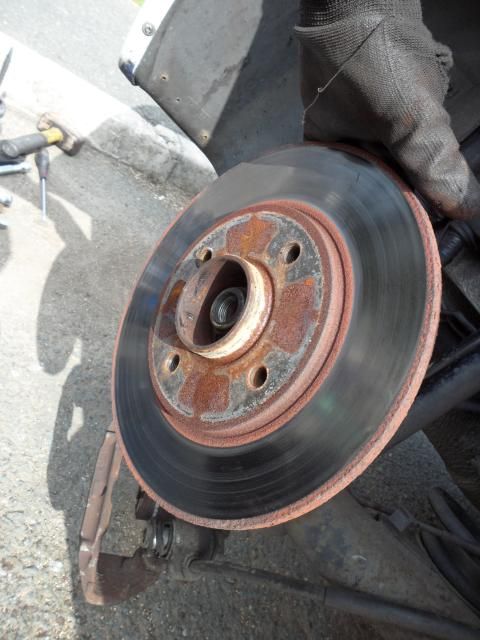

So... old, worn, bumpy feeling, scoured, and warped feeling brakes
http://i1310.photobucket.com/albums/...psd496a2bf.jpg
http://i1310.photobucket.com/albums/...ps1474bfd3.jpg
Passenger side I had to use a lump hammer to remove for 25 minutes, hard, didn't feel great, then the bearing let go of itself
http://i1310.photobucket.com/albums/...ps3710c0a7.jpg

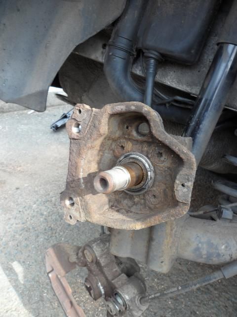

Spent some time cutting the remainder of the bearing off.
The reason for this side being such a pain was probably because the disc spacer was missing!
http://i1310.photobucket.com/albums/...ps4060f01b.jpg
New bits
http://i1310.photobucket.com/albums/...psf3d2ea58.jpg
http://i1310.photobucket.com/albums/...ps34b7813f.jpg
http://i1310.photobucket.com/albums/...psc8c55fc4.jpg
The drivers side almost fell loose as soon as the nut was off
http://i1310.photobucket.com/albums/...ps69a1766a.jpg
Reason... this side had a spacer fitted
http://i1310.photobucket.com/albums/...ps17f63da1.jpg
However.. note the rubber seal bulging out.. seized rear caliper
http://i1310.photobucket.com/albums/...psc3feea48.jpg
http://i1310.photobucket.com/albums/...ps6a4abcf4.jpg
http://i1310.photobucket.com/albums/...ps8b271659.jpg
Spent some good time cleaning this up while it was extended out fully with small wire brushes and good glass paper and smoothing then whacked in a seal of copper grease to get it going again
http://i1310.photobucket.com/albums/...pse8753467.jpg
Old pads were very brittle and worn from the heat of the caliper no doubt
http://i1310.photobucket.com/albums/...ps9be190d1.jpg
http://i1310.photobucket.com/albums/...ps4446a7a5.jpg
http://i1310.photobucket.com/albums/...ps77625a69.jpg
http://i1310.photobucket.com/albums/...psea336672.jpg
Caliper sliding like a dream now and working the best it has been since I've had the car, brakes in a straight line!
With the rears finally in good working order, moved on to cleaning up the front discs
http://i1310.photobucket.com/albums/...ps8b9efd92.jpg
http://i1310.photobucket.com/albums/...ps80259832.jpg
http://i1310.photobucket.com/albums/...psc0abe4c8.jpg
New pads and caliper to carrier bolts
http://i1310.photobucket.com/albums/...psace4972b.jpg
http://i1310.photobucket.com/albums/...ps359d196f.jpg
http://i1310.photobucket.com/albums/...ps0ab91aef.jpg

The pictures do them a bit of a favour TBH.. I'm undecided really, originally planned for Trophy colour but may go slightly darker much like the Williams ones are, or high pearl silver, or even maybe White... However mixed opinions on those two colours!
Tyre dressing was Meguiars :) The clear Hot Tyres or something stuff I think it's called, had a couple of bottles for nearly 3 years now and going strong!

Updaaaate! Flippin' brilliant Chris. I love this thread so much :o
It amazes me every time I come to read this thread that there are still places that you haven't touched on this car, and also how many things you're still coming across that are broken, damaged, dirty or ill-fitted from the past!
That steering wheel is absolutely beautiful and is styled perfectly for this car, what an improvement on the tatty original. And I love the freshening of the dials and clock/radio displays. Like an OE upgrade rather than a chavvy mod.
I can't wait for the next instalment. :agree:
Edit: btw, what is that rectangular CS thing clipped into the recess of the glovebox tray?
Trevhib
I'm not sure why I do it tbh :laugh: more of a personal car diary I guess!
I have lots to do still but at the moment this cold weather isn't fun without a garage :(
The square thing is a clio sport membership card lol.. its the only card I would leave in the car ;)

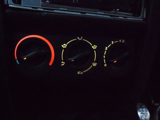

Heater controls... have been putting this off... removed the orange bits where possible
http://i1310.photobucket.com/albums/...psx6ov96e6.jpg

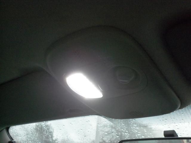

Footwell lighting, wired off the interior light so they fade out once the cars started

Replaced the rear wiper arm as it seized after washing and broke off

After all this, my driveshaft made me feel like the world was about to end...
http://i1310.photobucket.com/albums/...ps9gmn8amx.jpg
http://i1310.photobucket.com/albums/...psfpnhf4wz.jpg
Thanks to ALS Performance Parts for a decent replacement (Bottom)
http://i1310.photobucket.com/albums/...psow9tm8yg.jpg
http://i1310.photobucket.com/albums/...pstkaesg1k.jpg
http://i1310.photobucket.com/albums/...psyyp706nn.jpg

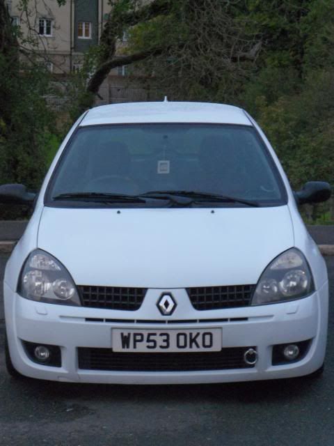

Very minty fresh fella, epic amount of work and attention to detail thats gone into this car, nicely done! Looks awesome on the turini's :agree: :cool:
Wheels look fantastic, they suit the car so well.
Chris, I can't think of what else you could to the exterior to improve it from a styling perspective. It's perfect from my lay point of view and the best looking Clio I've ever seen. :)
What are your remaining jobs/tweaks for the rest of the car?
Trevhib
V6 spoiler?
Nice attention to detail getting the wheel decals in the correct position opp valve.
Hoolio
V6 spoiler?
Good shout :) Although I personally prefer the smoother roof-line of the current setup, others might like the V6 style :agree:
Mr Raider
:agree: Thanks mate, really happy with the colour combo
Trevhib
:smokin: cheers Trev, I have put together around 5/6 to do lists from the start, made what I consider a final one now, A4 sheet, which is a bit of engine bay painting and maintenance bits, then body work in places, dents and chips alongside a mirror cap I've scuffed being in a rush :cry:
Nothing that will be much different looks wise in the scheme of things :smokin:
Hoolio
V6 spoiler?
Indeed, I worked it out to be between the L and the I on the Speedline to draw a line, then line that up to the right hand side of the spoke, opposite the valve
Trevhib
I do like the V6 / Trophy spoiler however cannot justify £300-400 plus paint for one, plus my car is a Cup so the spoiler stays! :cool:
