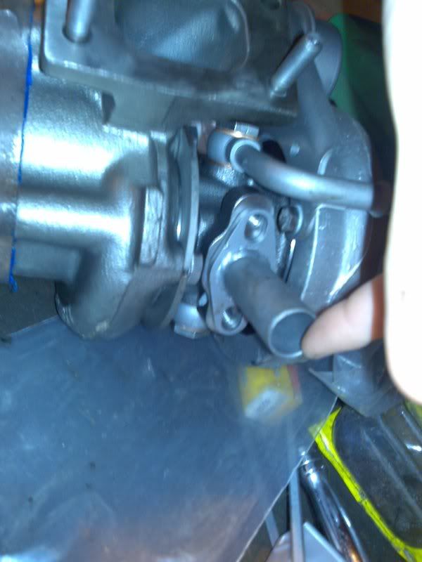

Its a completley different connecter than the original t2, the t-piece that comes off the t25 is way to thin so i cant clamp a hose round it

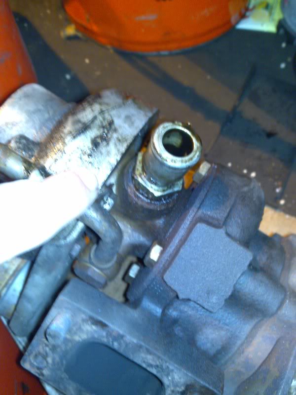

You can see by the pictures, the internall diameter is fine, but if you look at both tubes, the new t25 one is thin, but the t2 one is thick so the hose fits it, need to get this sorted asap as car is takin up a work ramp.
