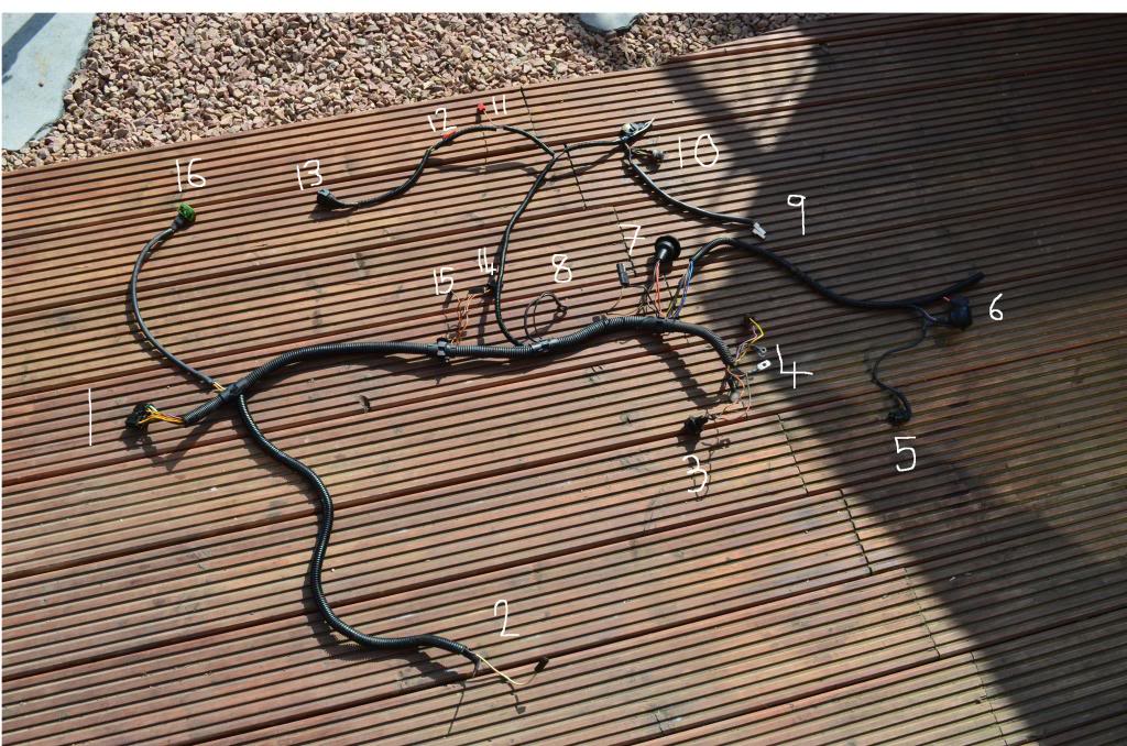

I have had my 5 turbo to bits recently and I took my engine loom out to give it a good clean during the rebuild.
I thought it would be a good idea to take a pic whilst its out and see if we can label all the connections.
I must admit, without it being in the engine i can name a few but not all..lol....so help would be handy :)
http://i1203.photobucket.com/albums/...t/Ren5loom.jpg
1 - Connector to rest of loom (connector of death!)
2 -
3 - Radiator fan
4 - Alternator connections
5 -
6 -
7 -
8 -
9 -
10-
11-
12-
13-
14-
15-
16-
Just by looking I cannot be 100% on the others.......so if you know any, fill it in against the number above.:agree:
2 - back of starter
3 - Radiator fan
5 - perc fan
6 - relay
7 - rad fan power
8 - front block earth
9 - perc fan buttom of carb
10- perc fan sensor
11- bulk head resistor I think???
12- bulk head resistor I think???
13- perc fan solenoid
14- oil pressure not sure which way from picture
15- oil level not sure which way from picture
16- reverse light switch
Please check

Cheers Mike :agree: Impressively quick reply.
I have had a little mooch about on here and I have a list of all the connections on that loom etc and it seems your spot on..as ever :)
Perhaps a mod could pop this in the articles section if they think its useful?

this is a great thread.. ive just took mine out to replace with a new one, and thought (hope i remember where they all go) cheers:agree:
Re: Engine Loom
Can any one ID the colour of the wires against each number? My loom is in bits with most of it missing.:crap:
