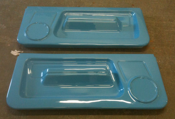

something like these :)
http://www.phoenix-autosport.co.uk/i...dc_painted.jpg
way ahead of you but these still need the molds making and fixings sorted etc.. etc... , cost will be far higher for them than a refurb of card ones though as they will have a higher material cost and take a lot longer
