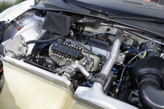

It's interesting how pretty much all top flight race teams use enclosed air filters in their cars. Look at WRC for example:
Skoda:
http://www.trt.hu/photos/trt/skodaepites_08.jpg
Ford:
http://www.ultimatecarpage.com/image...-WRC-03_12.jpg
Citroen:
http://www.automobilesreview.com/img...hybrid4-10.jpg
Given their enormous budget, the fact that there are no rules governing the choice of air filter and that packaging a well designed air scoop and box into the engine bay is considerably harder than simply bolting on a cone filter, I'd say there's a good case to ensure the turbo is getting a fresh air supply from outside of the engine bay.
