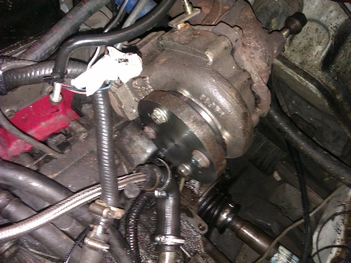

Re: I hate to admit defeat, but in this case I've been well beaten... **UPDATED**
Right guys... Decided that I'd get an adaptor plate made up to blank the front of the turbo off so that I could run the car with no turbo fitted... as below.
https://www.rtoc.org/files/Technical%.../blank_off.jpg
Just been out for a drive and there’s no smoke at all At last.... :wasntme:
So I guess I've just been really unlucky with my turbos...?? :confused:

[quote=Ashy;213660]https://www.rtoc.org/files/Technical%.../blank_off.jpg
