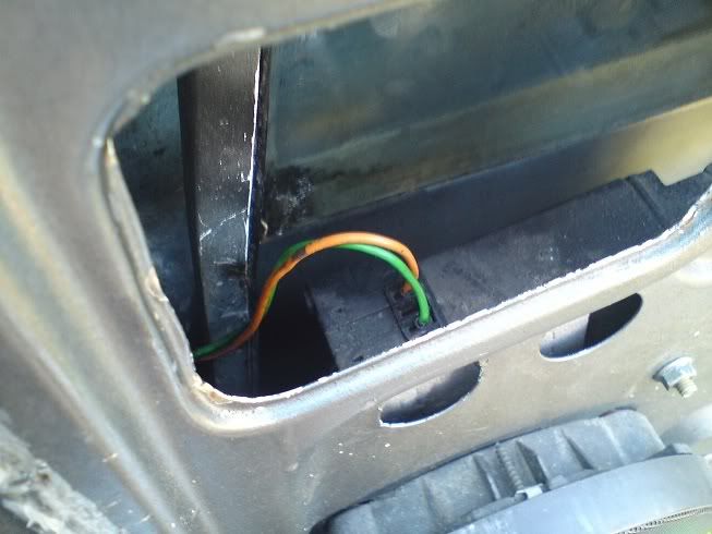

Hi I took the door card off today and had a look at the motor, I presume it's this that needs testing...
http://i18.photobucket.com/albums/b1...s/DSC01146.jpg
Took the connector off to test the voltage and its reading just over 11v, should be fine right?

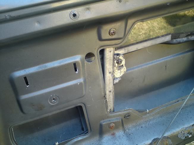

I have tried so hard to manually force the window up, I've free'd it about an inch or so, but it just won't go... anymore straining from me and I think I'd crap myself. I lubed up the runners, take it this one is the main one to be concentrating on...
http://i18.photobucket.com/albums/b1...s/DSC01147.jpg

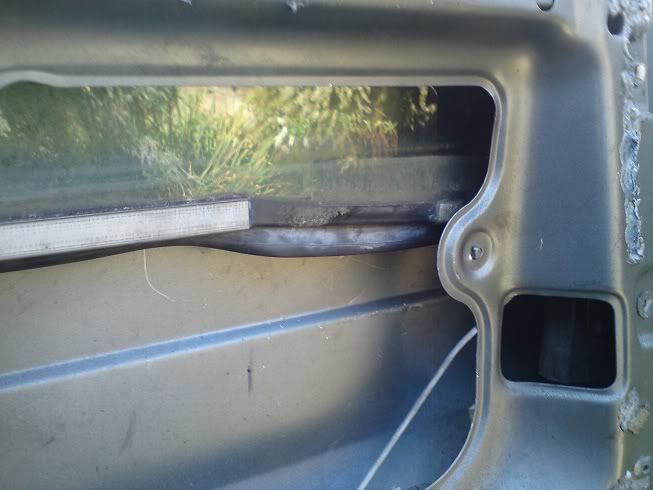

I'm about as stuck as my window now, anything else to try!? Does this look right to you...

Is the voltage across your battery 11V?
That's too low.
Anyway, with the probe showing 11V at the window motor, press the window 'up' switch and see what the voltage drops to.
Re: Me window won't go up!
I couldn't remember whether that voltage was whilst I was pressing it or not, so just went out to try again. Now, without pressing the button, the voltage is zero.
When pressing it it started off around 6.5v and basically kept (very slowly) going down, it got to about 5.5v then I just stopped :crap:
I checked my battery and as I said I think it's dying atm, the voltage across that was only 7.7v. I'm gonna have to get a trickle charger as the car is going to be parked up for over a month.
