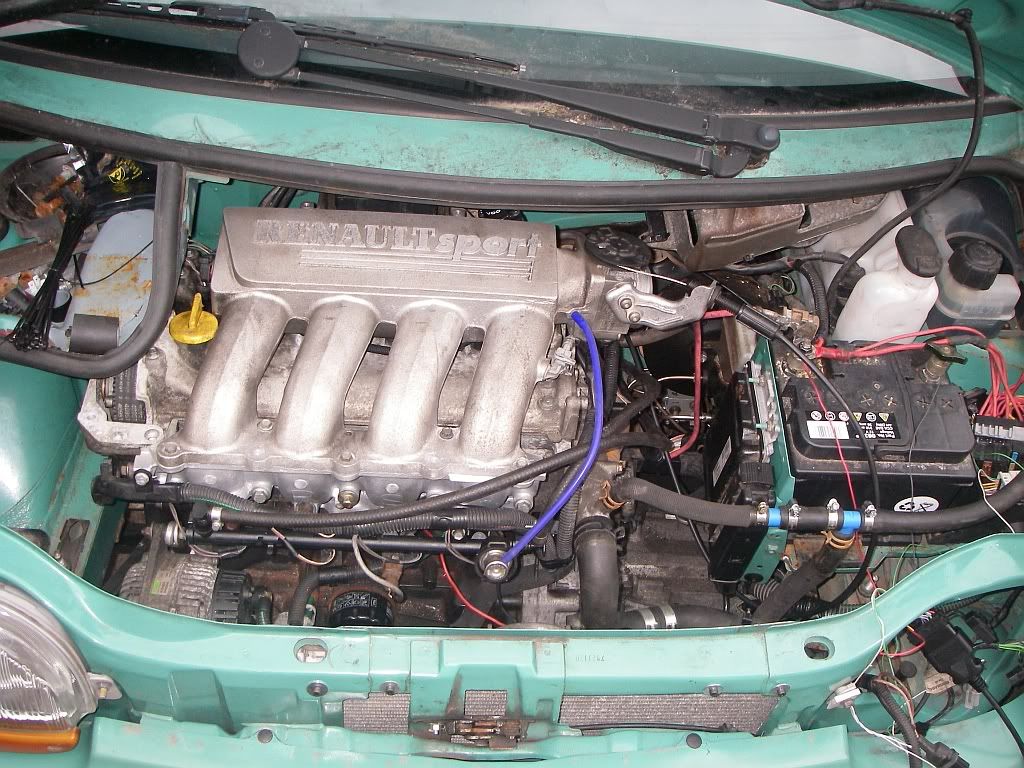

Hi Brooky,
that sounds interesting, but there isn't much room on the Twingo, it' all brakes, battery and ECU in that space.
http://i567.photobucket.com/albums/s.../assembly2.jpg
I don't have space up front for an intercooler, so I'm hoping I can get CC to fit in that gap :)
Andy

Should atleast ditch the battery!
Pretty curious about the mani though!
Installed. It's been in ages and this is an effort to turbo it. :agree:
I think there is a lot of space to be gained by relocating the battery (cheap option), or fitting one of those super slim ones (more expensive option I guess). Maybe if the battery is relocated the ECU could be laid horizontal without wiring alterations?
It's not a huge amount of space to gain, there is a bit of stuff packed in that area, fuses, header tank, washer bottle, wiper motor, servo, master cylinder (and reservior) and rear brake pressure limiter. At the moment I think I can fit most stuff around what's there, although I need to have a think about the air filter. I have a couple of those race batteries kicking around, so could swap one in, and that could gain space fir my filter.
