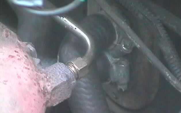

2. If you havn't already disconnected the matrix from the pipes you need to drain the system and remove the pipes, located on the bulkhead behind the turbo.

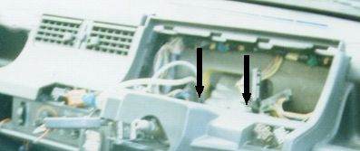

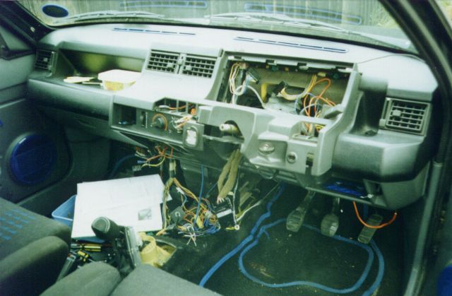

With all this removed you're probably wishing you had never started. Your interior will be looking something like this:
https://www.rtoc.org/articles/i/matrix/smint1.JPG

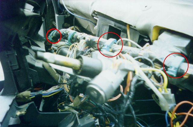

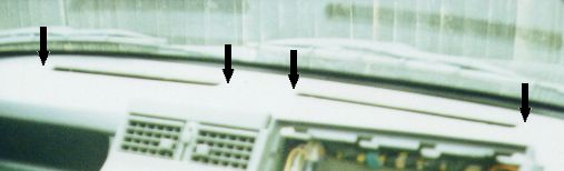

16. Unclip the facia: there are clips at the right and left sides of the facia that you should be able to unclip by lifting each side of the facia. There are then four clips. These are located under the long air vent holes at the top of the facia. You need to lever something in there to prise them off. I used a part of some mole grips. Be careful not to damage the facia though.
https://www.rtoc.org/articles/i/matrix/clips.JPG
17. Remove the heater tubes that channel the air to the vents. These will go from the heater box in the middle to the vents at the sides. You can reach these from under the facia or through any gap you can find. They might also have cable ties around them holding the wiring looms and these need to be cut. This part might need to be done after the next if you don't have enough room.

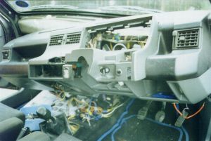

18. You now need to work the facia forward. Keep checking none of your switch cables or control arms are in the way. It will probably still feel quite stuck, I know mine did. The wiring looms all run behind the facia and should be cliped to the facia via lots of plastic green clips. I had clips at the top of the instrument panel area running all the way along to the passenger side of the car. They might need quite alot of pressure to get off. If you can pull the facia far enough forward you should be able to get a hand then arm in through the various holes and gaps that are now present in your interior. I managed to drop the left side and pull it out far enough to remove the clips.
https://www.rtoc.org/articles/i/matrix/smint2.JPGhttps://www.rtoc.org/articles/i/matrix/smgrnclp.JPG
Once you have all these clips undone. With a little persuation you should now be able to remove facia from the car.

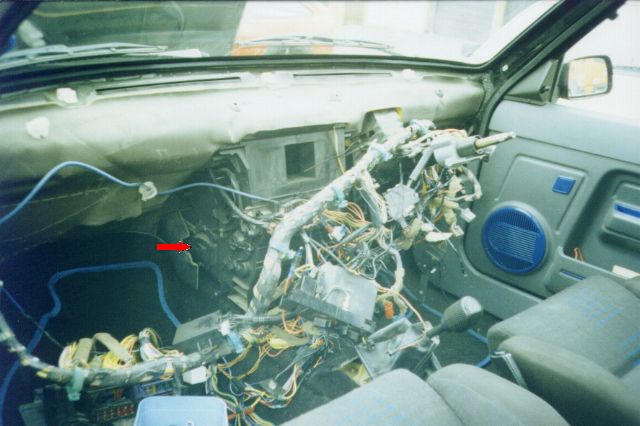

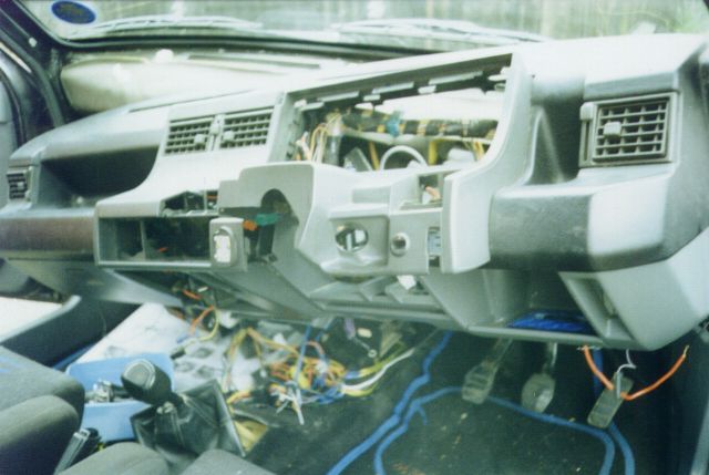

You will now be looking at something similar to this:
https://www.rtoc.org/articles/i/matrix/smint3.JPG
The matrix is indicated with the arrow.

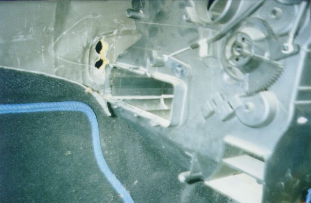

19. In the engine bay where the pipes attached to the matrix there is a metal surround and rubber block. I don't think these need to be removed, but it may make it easy for the heater box to be pulled out in the next step.
20. You will now have easy access to the heater box inside the car. The casing is attached to the bulkhead. You need to undo these screws and pull the box forward until the pipe connections on the matrix are clear of the bulkhead. Undo the plastic clips securing the matrix in place (four I think) and slide the matrix out of the casing, and so leaving it looking like this:
https://www.rtoc.org/articles/i/matrix/smbox.JPG

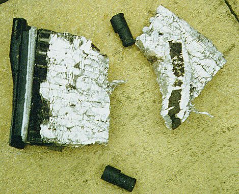

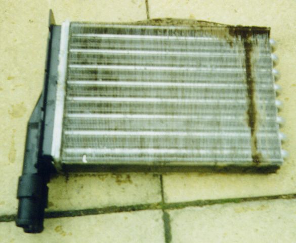

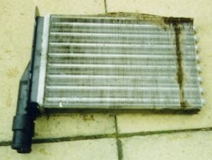

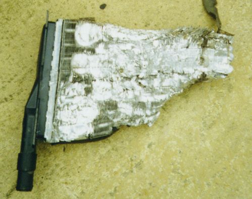

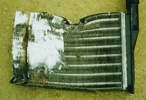

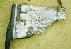

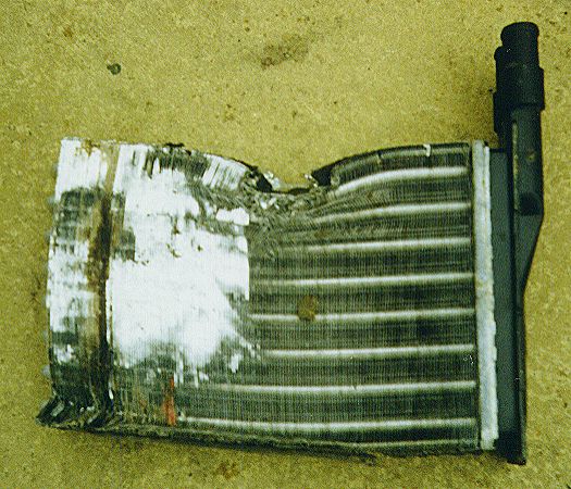

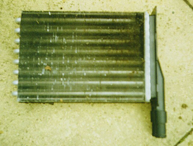

25. FINAL STEP: Destroying the old heater matrix. It's caused you all this hassle and frustration, it seems only fair that you show it the error of its ways:
https://www.rtoc.org/articles/i/matrix/smmatrx1.JPGhttps://www.rtoc.org/articles/i/matrix/smmatrx2.JPG
You can see the rust marks where the leak was, doesn't look much.
https://www.rtoc.org/articles/i/matrix/smmatrx3.JPGhttps://www.rtoc.org/articles/i/matrix/smmatrx4.JPG
https://www.rtoc.org/articles/i/matrix/smmatrx5.JPG
