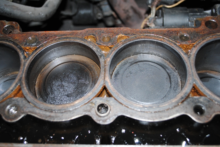

Right guys need help again...
So I've whipped the head off and I'm still unsure as to whats wrong (although ive got a couple of theory's)
So with the head off the looking into the Pot that was giving the hiest compresion reading you can see honing marks on the liner. This makes me think this pot was recently relaced as theres no honing marks on the other 3. This would lead me to think the rings were gone on the other 3 hence the smoke and low comp reading.
However, on the other hand i we assume that one liner was replaced recently I have concerns over whether the head gasket was sealing against the block as it doesnt look like it has been cleaned properly and is badly corroded see pic....
https://www.rtoc.org/files/Technical%...urbo/bores.jpg
Whats your thoughts?
Also thinking of putting some oil in each pot and seeing if it leaks overnight... Would this be a good measure of how worn the rings were?
Any ideas welcome.
Cheers Ashy.

See what I mean about the corrosion? the old head gasket came off in 1 pice, looked brand new.... The residue and corrosion on the liners and block must of been there before the new gasket was fitted...
I'm really not sure its the rings... The smoke is just so white as if its water vapuor.... theres minimal crank case pressure and the catch tank is bone dry.... :confused:

have you checked the head for flatness? as that corrosion looks terrible:crap:
Do you have a flat pane of glass lying around?
oil the cyl heads mating face and then place the glass on top, give it a gentle press. if its totally flat obviously the oil will make contact to all of the glass:agree: if banana'd there will be no contact in a certain area.

I've got plenty of spare heads, pistons, liners and blocks for that matter so building a new lump up wouldn't be an issue and tbh i'm not trying to do it on the cheap the truth is I don't want to waste time rebuilding it if its not necessary.

done the petrol test, within 10 mins pot 2 was empty! Other 3 are unchanged.
Looks like i need a set of rings too... :crap:

so its hone, rings, lap valves, clean and back together then ! mornings work :D :cry:
I'd be checking those liner tops for pitting. Maybe the block was sat outside without a head for a while.
Re: Head Gasket or Rings? **UPDATED**
Aye, should have everything i need to re-buid it over the weekend... I just really didn't want to have to remove the sump... Cant be bothered with the sealant, such a crap design.

chemical metal and some sandpaper = flat liner tops.
he did say cheap....
