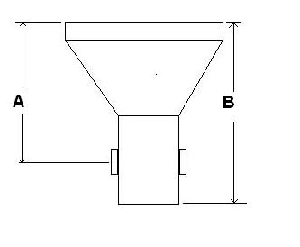

Would anyone have one of these lying around they could take the dims off I would like to see if I can mate it to my clio 172 engine.. which is the same as a R5 engine in terms of gearbox fixings..
Here are the dimensions I'm after to see if it will fit..

I've got mine out of the GTA on the floor at the minute .Pretty sure they are exactly the same .I've also got a scale drawing of the UN1 bolt holes in the bell housing ....and I've got a spare bellhousing you could borrow if you wanted .
Attachment 5739
Re: R21 turbo, gearbox dimensions...and will it bolt to a 172 enigine?
cheers.. I'll get the engine out and see if the drawing looks anything like (I'll print it on a3 it shouldn't be too far off) and then give you a shout..
on the drawing is the black outline the bell housing or the actual gearbox? I was confuse because of the position of the flywheel in relation to it..
1 Attachment(s)
It's the blue holes that are UN1 . The black outline was something Japanese we were trying to mate it to .Here's a new one with some dims for ref/scale .
I'm just in Heanor so not to far if you need to have a look :agree:
The 3 smaller holes mid right are starter mount and you are looking at it from the front of the engine .
Attachment 5740
