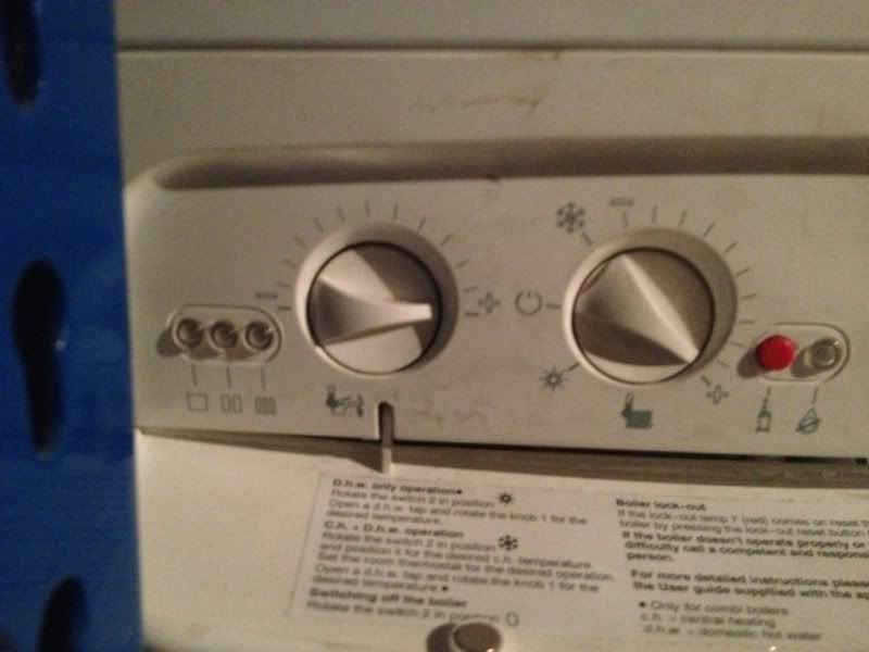

Is there anything else i can do/check, as there is only really one button (reset button) to press ?
There are 2 dials with different modes to select but i don't want to cause more problems.

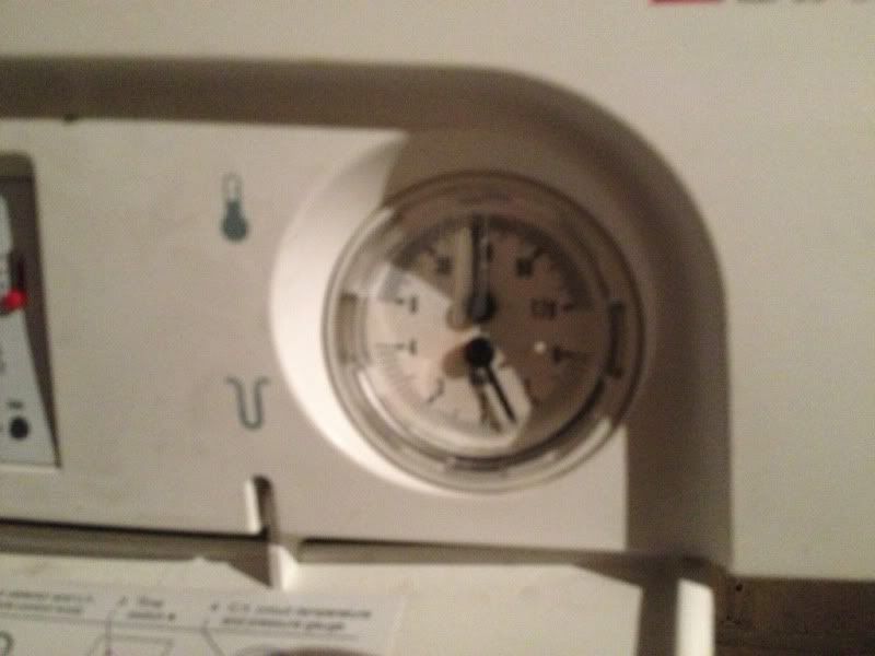

Its sitting at 1 bar which it has always done :scratch:

I think 1 bar might be about the minimum for a combi. If it drops further at peak times such as early evening and weekend mornings that might stop hot water working, for those periods at least.

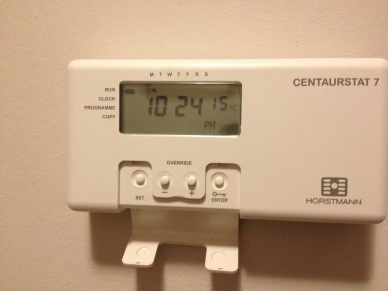

Biggs. Do you have a wireless room thermostat? Just thought it may have lost connection to the reciver.
