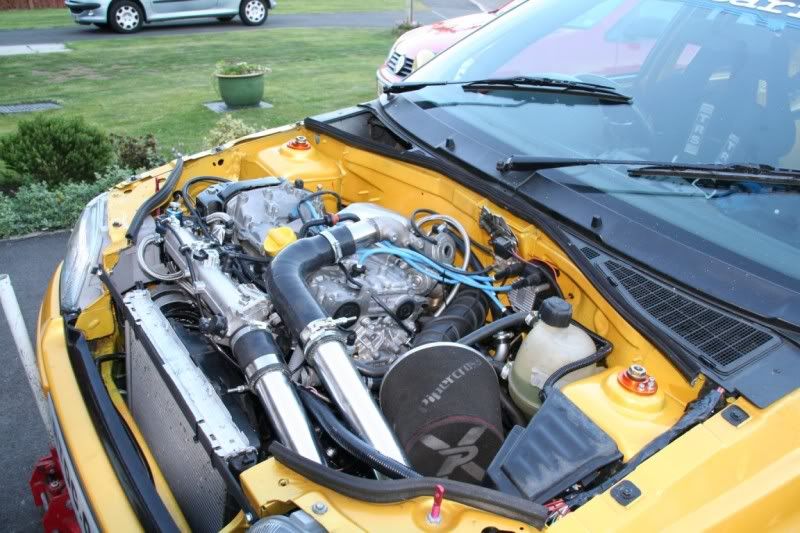

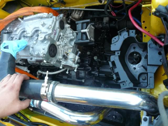

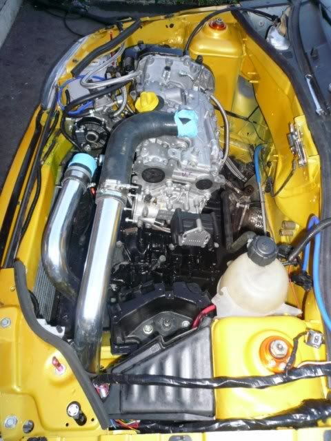

Well, a little pissed off with the way i have had to route the pipe work for the cooler, i didnt think the altinator would be on the way, so there is more pipe work that i would want. But its looks OK i suppose. i may as well have got a twin pass now :(
Excuse the blue pipes forgot to pick up the black stuff Friday so will replace when i tighten them all up this week
Got my boost controller Apexi AVCR :) Yummy. should let me control the boost the way i want and able me too control the booost from inside the car with the press of a button
Water pipes fitted, Just need to finished them off onto the turbo and get a new 172 rad, the one i have has been sat on :( you can see by the photos.
I hope this will be alive Tuesday, then it will be Tidy up the engine bay time.:D

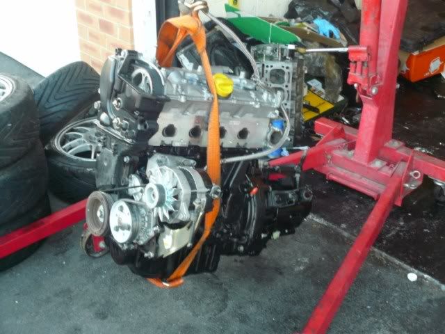

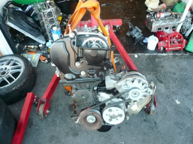

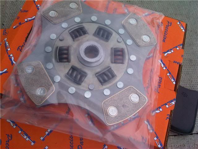

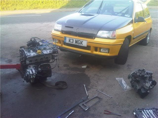

We had a small oil leak that was so little and annoing it couldnt be found, we assumed it was the crank seal as the oil was from between the box and the block, as the clutch started to slip, So out came the engine and all, and i decided to get a Helix Paddle Clutch at a very good price. Once the engine was out there were no signs of any oil on the clutch or in the box its self, we did notice the sump was weeping, so we replaced the oil crank seal and the sump gasket too make sure, re sealed the end cap too. Refitted and Spot on no Leaks or Slippage of the Clutch Happy Days.
I am having some issue with turbo surge now tho, if you load the car up in 3rd or 4th between 2200rpm and 3500rpm the car just holds back its defo turbo Surge,

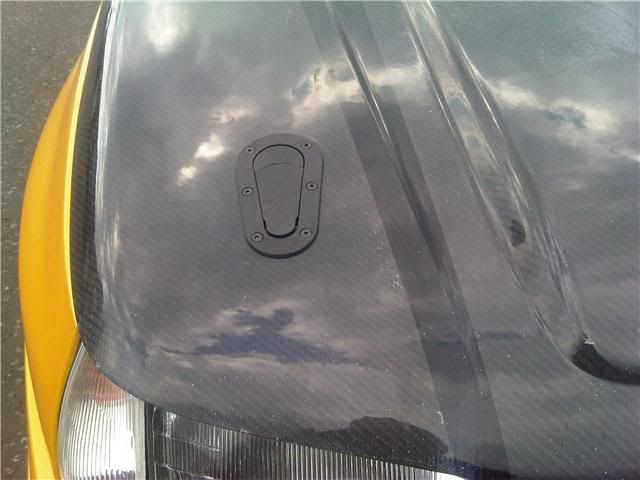

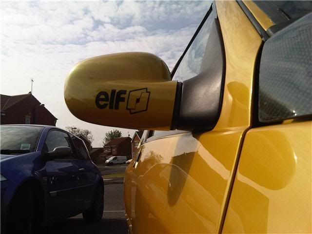

new bonnet aeros and mirrors
Today we went to York Raceway, What a waste fo time that was 3 runs in 5 hours! Rain Wetness and just a utter gash setup. we mannaged a 15.33 13.11 and a 12.88 pretty disapointed but the car has "ching wang chang" tyre and a Marshall, These were just tyres on the wheels when i got them, as the other wheels we have are not road legal

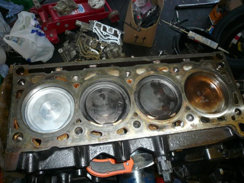

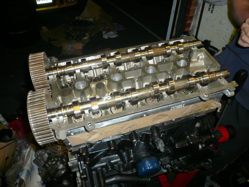

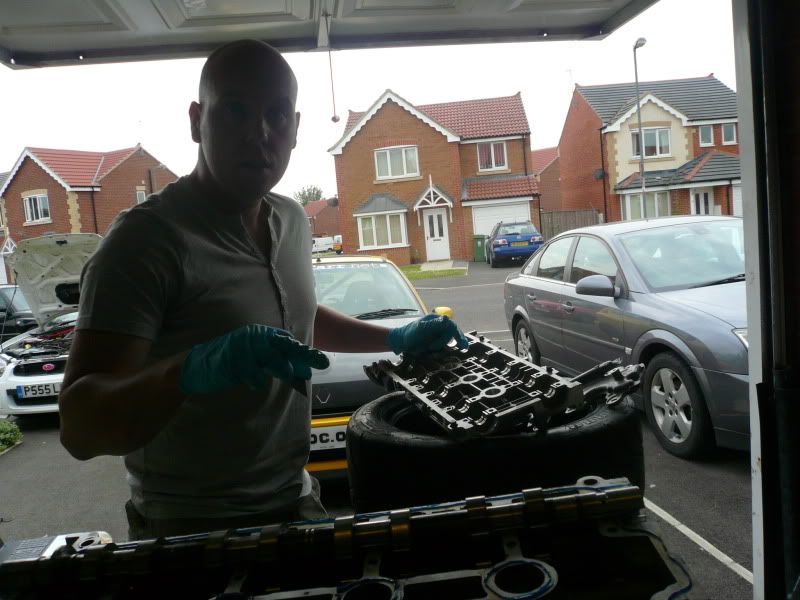

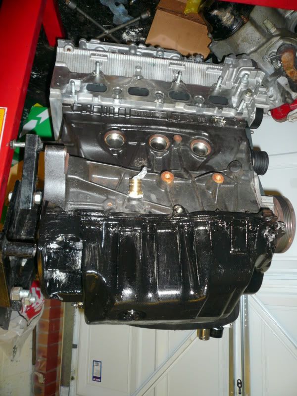

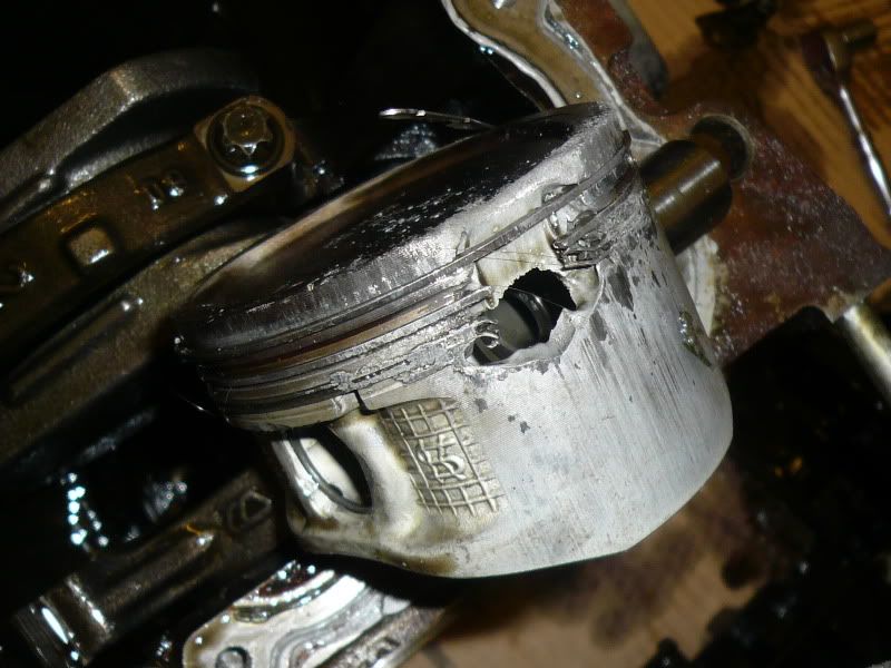

Well, After our little mishap at Rockingham, and melting a piston due to a fuel pressure reg issue ( opps )
Two weeks later were ready to rock and roll again, still bits too but a lot closer to drop in this weekend ;)

New Bearings Main and Big End
New Piston and Rings
New Seals
New Gearbox :) Clio 182 Trophy :)
Lets hope a new start
