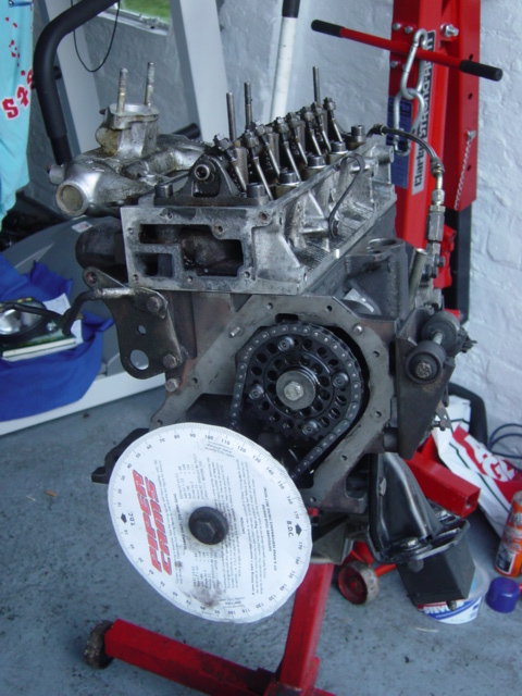

Some instructions to time the cam by Scoff:
Essentially you TDC the engine, but be sure to use the TDC that has the distributor pointing to No.1 spark plug lead (since the engine will also be at TDC when it's pointing to No.4 spark plug lead).
Bolt the timing disc onto the crank pulley and install a pointer (made from a bit of wire clamped behind a bolt head or something). You now have a pointer pointing at "0" on the timing disc and the distributor arm is pointing toward HT lead No.1.
Rocker cover off, use a DTI (dial test indicator, or some other device capable of denoting rocker lift) you need to rest the DTI on the inlet valve of pot No.4. Zero the DTI.
You need to turn the engine over slowly by hand, in the correct direction of running, IE clockwise when viewed from the water pump/crank pulley end.
Peak lift for a BP285 piper should be at 112deg (some older ones were 110deg). Make a note of the angle on the timing disc once the DTI stops rising. Keep turning the engine slowly. Make another note of the angle once the DTI reading starts to fall again. The real peak lift angle will be half way between the 2 notes you've just made.
Repeat the test a few times, it's hard to get an accurate reading, take an average of all your results.
Note: Do not take an angle measurement if you turn the engine backwards! Slack in the timing chain will cause erroneous readings, if you turn the engine backwards for any reason, be sure to turn it forward slightly to remove any slack from the timing chain.
If the reading vary's from 112deg by more than a couple or 3 degrees then it's worth while correcting it with the vernier.
It's also worth noting that base cam timing isn't always the best setting for all applications! If you want a poky responsive engine at low rpm then try a upto 4deg of advance. The oposite applies too, if you want to make torque at high rpms (sometimes boosting peak HP) then you might like to try upto 4deg of retard. The trade off is that it will always feel flatter at the other end of the RPM scale.

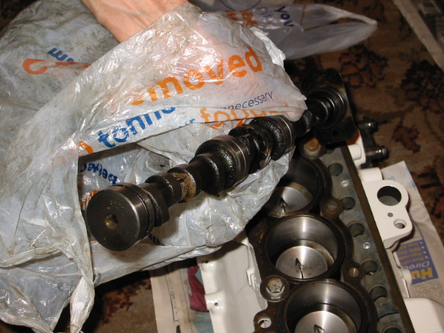

Changing the cam by Sparkie's RTOC Profile https://www.rtoc.org/boards/images/bu...iend-small.gif
Many people have done this themselves, but I'm not sure many people have done it like this....
cam change with head on? many people talk about it, not many people do it.
basic instructions are...
1) bumper and bonnet off.
2) carb off (or carb top, depends if you have a strut brace or not).
3) distributor off and drive gear out.
4) rocker cover off.
5) undo tappets and take pushrods out.
6) take off alternator belt, crank pulley and crank pulley carrier.
7) undo exhaust 'Y' clamp from back of block.
8) undo front engine mount to subframe bolt.
9) unclip radiator so it sits slightly forward.
10) with a single magnetic 'pick up' pen lift each cam follower out of the block so that it rests at an angle on the top of the 'hole'- it should rattle around alittle- there is space under the head for you to do this!!
11) once all followers are 'loose', then jack engine up from sump plug till the engine mount thread clears the subframe.
12) if you have got a perc fan remove it!!! the hole into the inner wing is where you will feed the cam into!
13) once you have a little daylight on the timing cover, remove it, then the tensioner- make sure you don't loose the metal plate at the back of it - it likes to slip into the sump!!! turn the timing marks to face each other.
14) undo the cam bolt, and the two smaller locating bolts.
15) check to see that the followers ain't dropped back - I bet they won't have!
16) start to slide the cam out, and jack the engine up slightly until you can feed it the through the antiperc fan hole.
17) replace cam with new one.
18) put it all back together again!!
Ian S RTOC Profile https://www.rtoc.org/boards/images/bu...iend-small.gif
