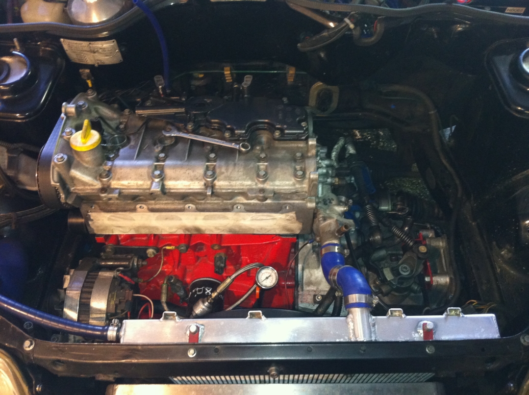

First up, the old 02J before I pulled it out:
https://www.rtoc.org/files/Technical%..._old_setup.JPG

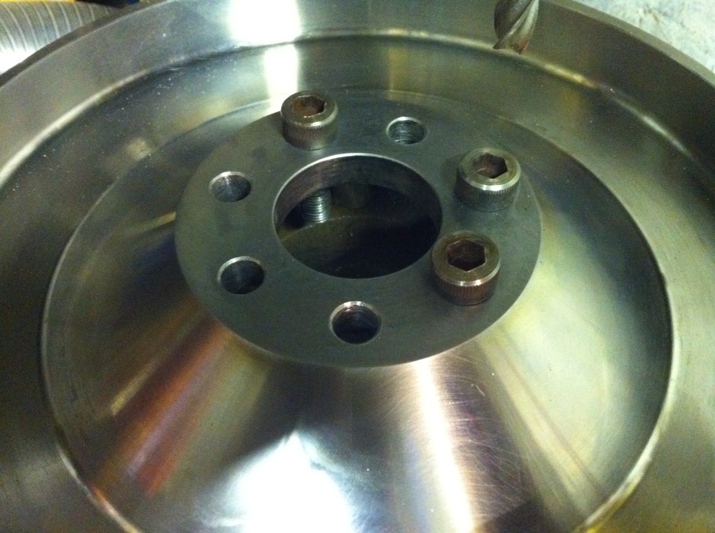

I ordered a new 240mm billet flywheel from the USA, unwrapped it and set about welding it up. I milled off the weld to form a blank:
https://www.rtoc.org/files/Technical%...d_flywheel.JPG
Then I drilled the renault crank stud pattern to fit it to my engine:

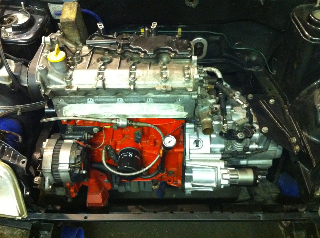

Gearbox installed and a new solid gearbox-to-chassis rail mount manufactured and fitted:
https://www.rtoc.org/files/Technical%..._installed.JPG

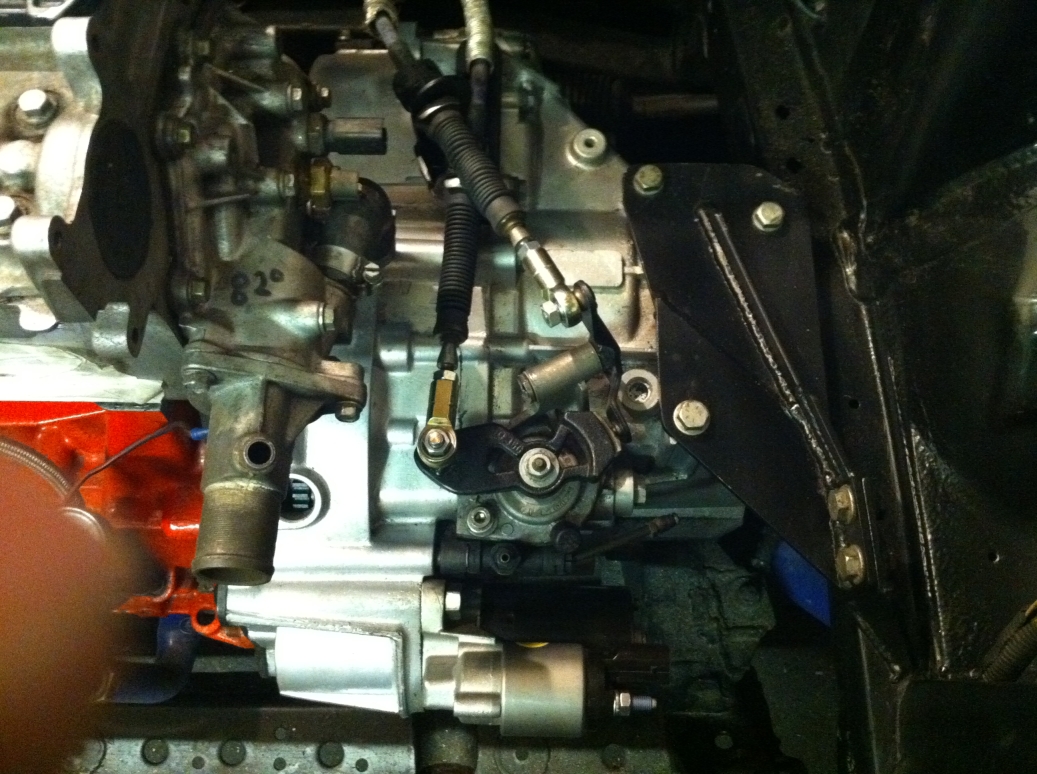

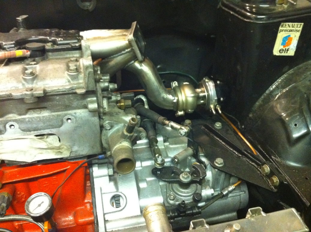

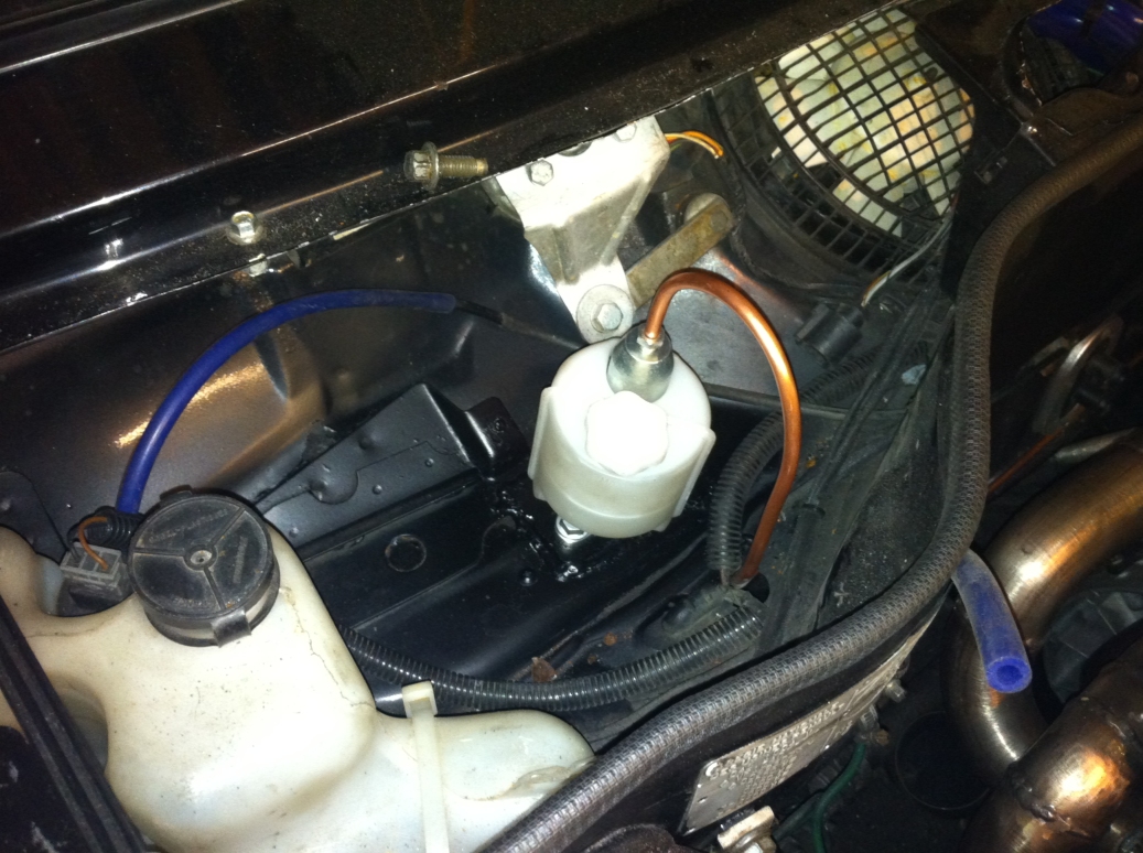

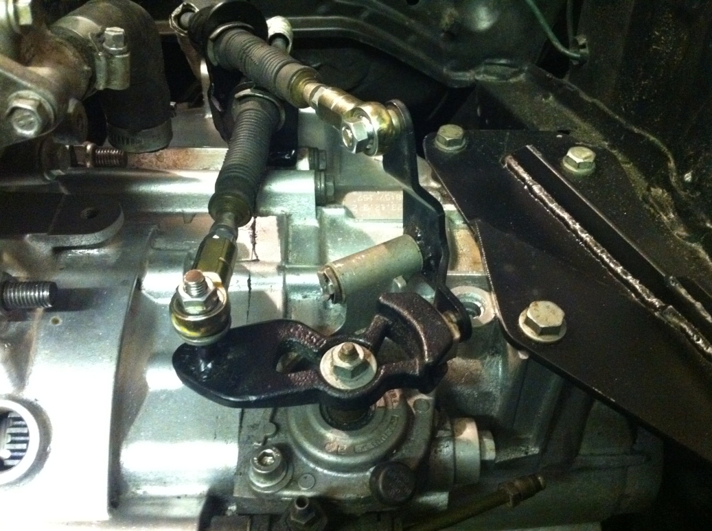

Since the new gearbox is 6 speed I had to make some new gear linkages. I couldn't be bothered removing the old 5 speed cable shifter out of the car so I modified the 5 speed cables to accept some 8mm rose joints and then made it all fit onto the 6 speed mechanism:
https://www.rtoc.org/files/Technical%...r_linkages.JPG
Rear engine mount was made and the lot was bolted down again:

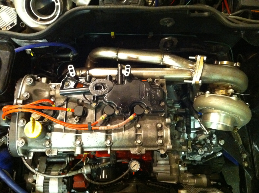

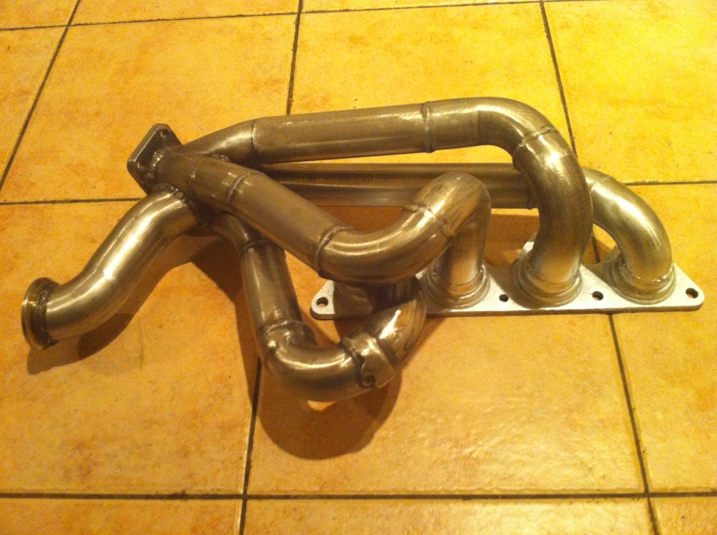

Because the new gearbox is so large compared with the old one it ment that nothing else would fit back into the bay. I needed to make a new exhaust manifold and downpipe to clear the bigger casing. This gave me opertunity to improve on the manifold design. I won't bore you with the details, but it should work a lot better:
https://www.rtoc.org/files/Technical%...t_manifold.JPG

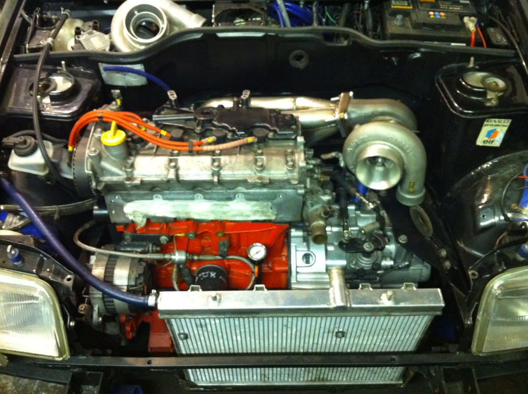

I also decided to chop up the front of the subframe and move the cross member down 120mm or so to mount the radiator lower down. This should give me adequate clearance for the new inlet manifold and larger plenum.
You may also notice I've chopped about with the bulkhead a bit, to give me more room for the new exhaust manifold. I was sick of not being able to get spanners onto stuff at the back of the engine, so that needless "boob" in the bulkhead got, er, mastected.
