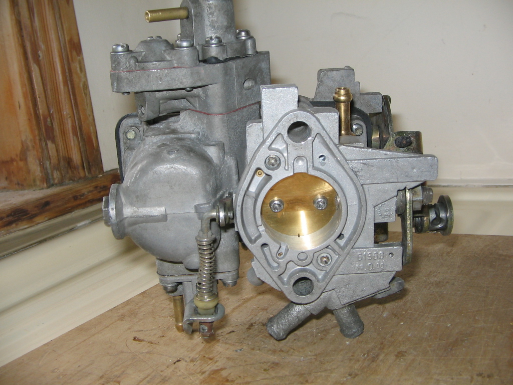

Can soemone please measure the height of the cylinder of the accelerator membrane?
I have found 3 pieces with 3 different heights. I think it is important to get the correct one for the 5mm drill setup.
http://www.renaultclub.hu/Jimmy/accel_membrane.jpg
http://www.renaultcllub.hu/Jimmy/accel_membrane.jpg
http://www.renaultclub.hu/Jimmy/acceel_membrane.jpg

I pulled the carb off again today and checked sizes and this is what I found:
Main Jet - 120
Air Corrector - 125 (changed for a 110 as, the end of the 125 was a bit burred)
1st Stage - 100
2nd Stage - 110
Put it all back together and reset the idle mixture. Still running rich everywhere really
Light throttle - low 12s to high 11s
gentle squeeze to mid throttle - flashes briefly (less than 0.5 sec) to mid 13s then drops to low 12s to high 11s, sometimes as rich as high 10s
WOT - high 11s to low 12s initially then getting even richer with 4th gear at 6000rpm holding high 10s to v low 11s.
I checked the orifices using my micro drill bits as go/no go gauges. I think I need a smaller main jet? Boost is currently 15 psi by my el cheapo boost gauge.
