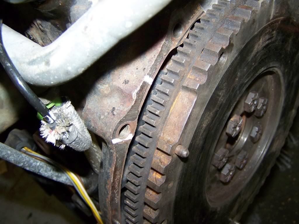

Here's a pic of the auto flywheel with the 2 teeth missing..
http://i168.photobucket.com/albums/u...i/100_0968.jpg

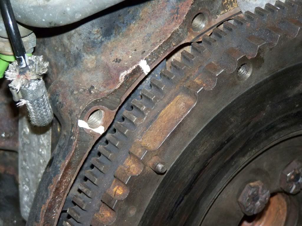

Now i marked where the cut out was on the auto flywheel for the tdc sensor to read, i marked it with 2 tippex lines, the 2 lines basicly show the where the 2 teeth where missing on the auto flywheel..
You can see the gap is different on the 172 flywheel roughly 1 tooth out..
http://i168.photobucket.com/albums/u...i/100_0964.jpg
http://i168.photobucket.com/albums/u...i/100_0962.jpg
http://i168.photobucket.com/albums/u...i/100_0971.jpg
Scoff told me i need to move the sensor accross the same distance as it is on my markings, but the trouble is im not sure which way the sensor needs to go, towards me or towards the bulk head (as u look into bonnet)..

I'll have a stab :)
Flywheel rotates anticlockwise
with the teeth where they are the sensor will see the gap late
to get the sensor to see the gap at the right time you need to move it towards the bulkhead.
anyone agree? :laugh:
Re: Setting Up The Fly Wheel Sensor On A 480 With 172 Flywheel
Yep agree.... bulk head. You could always check timing after with light to get it perfect..

As the guys say the sensor needs to move toward the bulkhead. if it's an older sensor you can put it loosely into a vice and hammer the metal "through" the plastic body of the sensor so that the plastic is then free to slide up and down the metal bracket (it'll still be quite stiff). Newer sensors don't work so well with this method because they fall to bits when you hammer them!
Looking at it shows its about 5 or 6 degrees retarded though, so actually just swapping the polarity of the sensor wires (red and white) will advance it by the same amount (1 tooth's worth) to bring the timing back in line, so if you're feeling lazy, do it that way ;)

Yes I'm sure, swapping the wires advances by one tooth just like it does with the GT turbo and pretty much anything else that uses a toothed wheel and a vr sensor ;) But, the proper way is to move the sensor of course.
If its a new sensor then maybe you will need to re-jig the bracked, maybe drill a fresh hole to the right of the black plastic so that you can bolt it on closer to the bulkhead.
By the way, you need to move it by the same amount as the difference between the 2 flywheels, or roughly that. A few mm either way won't make any difference. It will actually run fine as it is right now, it'll just feel a bit flat to drive with 5deg of timing retard.

So shall i measure the gap this side in the photo, ive marked where i think i should measure..
http://i168.photobucket.com/albums/u...100_0964-1.jpg
Or do i measure the gap starting the other side :confused: Sorry for so many questions mate just want to get it right..
Thats ok, measure that gap and move the sensor the same amount toward the bulkhead, it'll run fine :)
